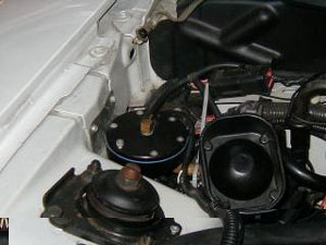

   To recalibrate a non-adjustable Fuel Management Unit (FMU) you must first remove the 8 Allen bolts.
The cover maybe stuck on, so you might need to pry it off with a screw driver. A blue gasket should come
off with the cover. If not, remove it and throw it away. Inside the FMU you will see a large metal disc,
probably taking up the entire FMU. Remove it and set it aside.

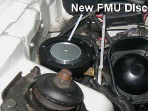

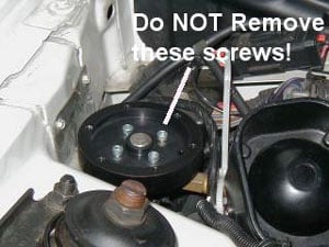

The Vortech re-calibration kit came with a hollow, circular disc that fits around the 4 small screws at the
bottom of the FMU with the groove facing down. DO NOT remove the 4 screws at the bottom of the
FMU! If you do the whole FMU will have to be replaced. Place the metal disc inside the circular disc.
Take the new, blue gasket that came with the re-calibration kit and place it on the FMU, aligning it with the
holes. Replace the cover and bolts. Tighten to 2ft/tq.
