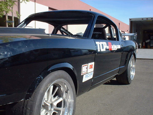

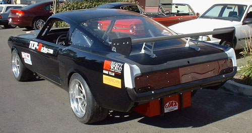

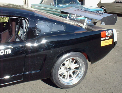

| Our project 1965 Mustang Fastback racecar
is nearing completion. We are awaiting the
assembly of our engine, drivetrain and safety systems
then it is off to the track for our shakedown run. Our
rear-coilover suspension has been installed but revisions may
be made prior to being put into production.
