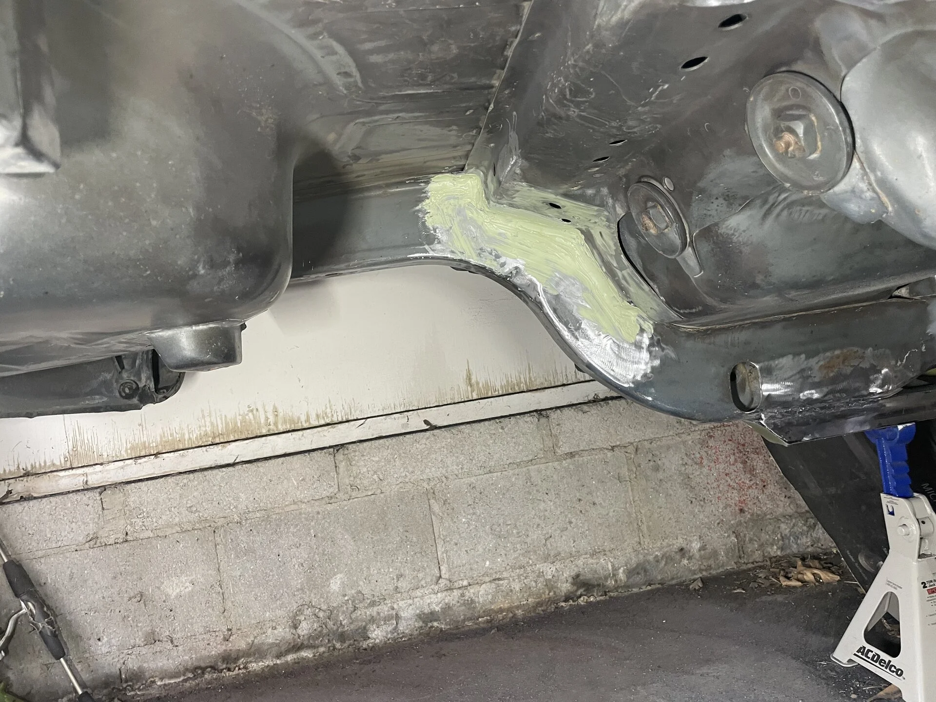

Got my filler ready.

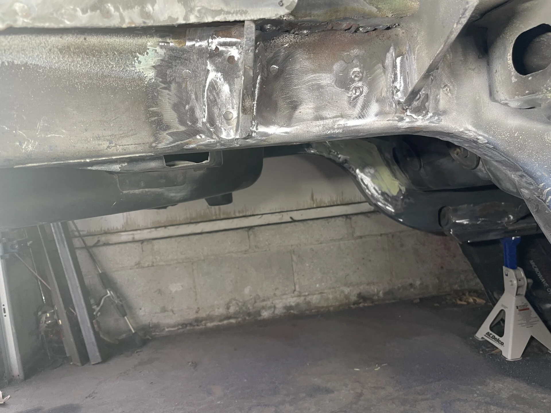

I spent an hour or so making the welds like I wanted. It’s all dressed. Except for that little bit on the welds for the shock tower! I just noticed that making this post. Oh well, five minutes work there.
Then I mixed the filler and spread it on the inside of the frame rails. Then I waited…….and waited…..and waited for it to harden. This is when I checked the temperature. 58*…….dammit.
It really needs to be 65* or above for the filler to harden, I felt like it was. I was wrong.
So tomorrow is supposed to be over 70*. I’ll sand the filler down then. All that’s left for this part is to get the filler in to make the joints smooth and pretty. If it’s warm enough tomorrow I should be done with this in less than an hour. Then I’ll spray a little etch primer just to protect the metal.
