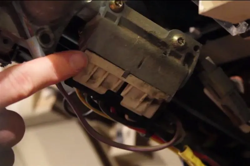

I'm leaning toward swapping out the pump with a 155 or 190 LPH Walbro. Is there any point in swapping out the fuel pump relay underneath the MAF meter? That would be cheaper and easier, but I'm not sure if that's relevant.
