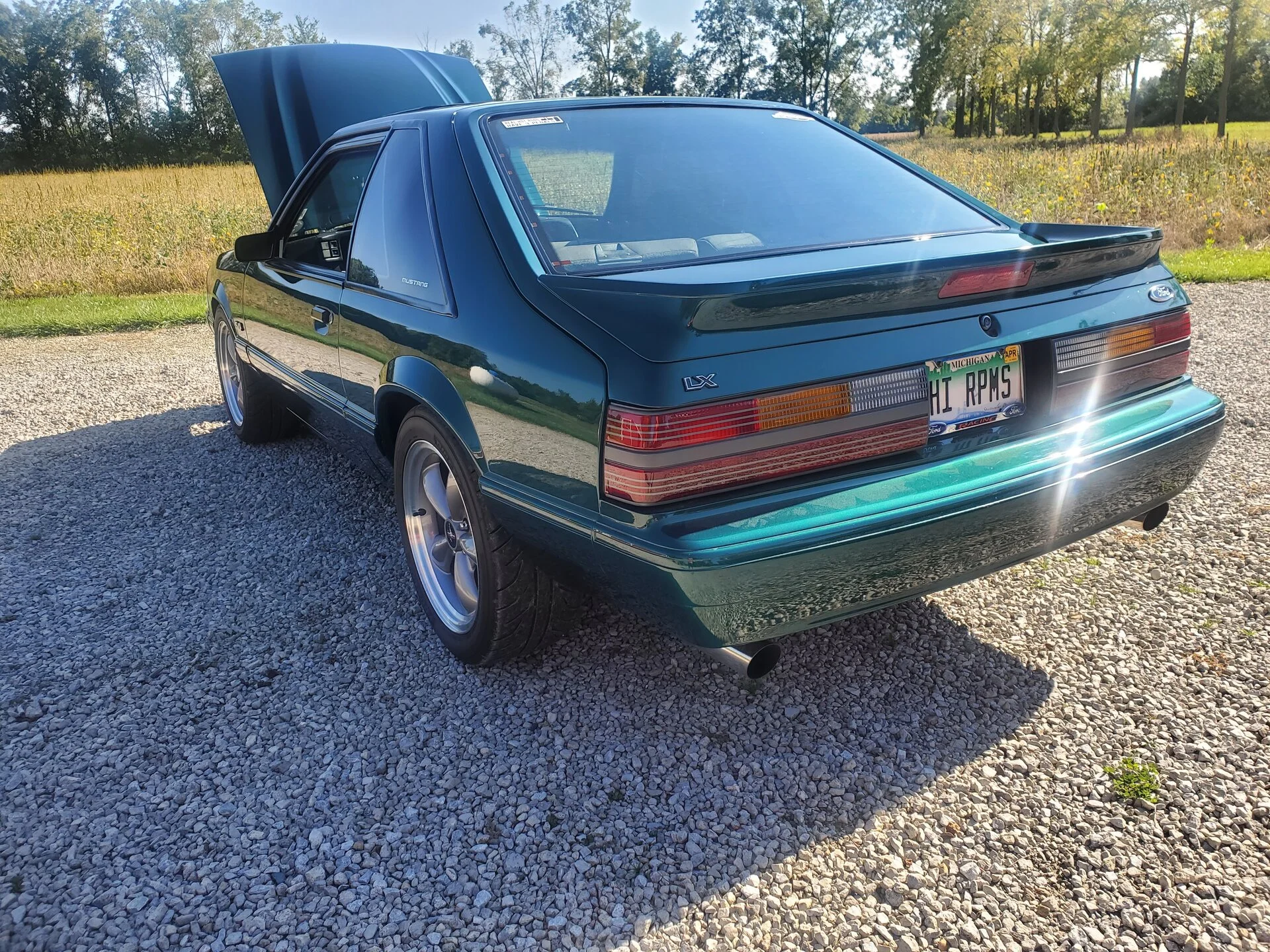

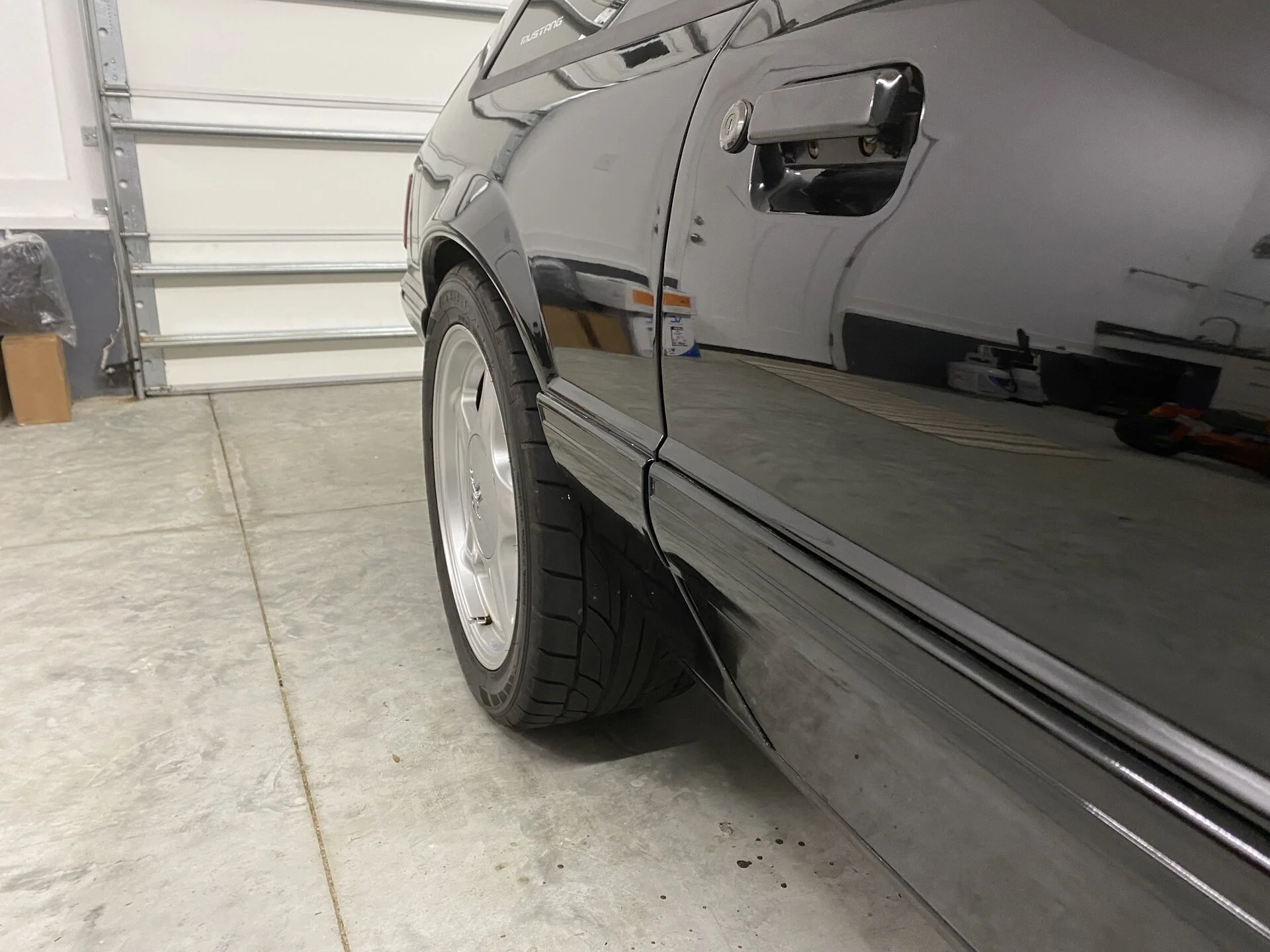

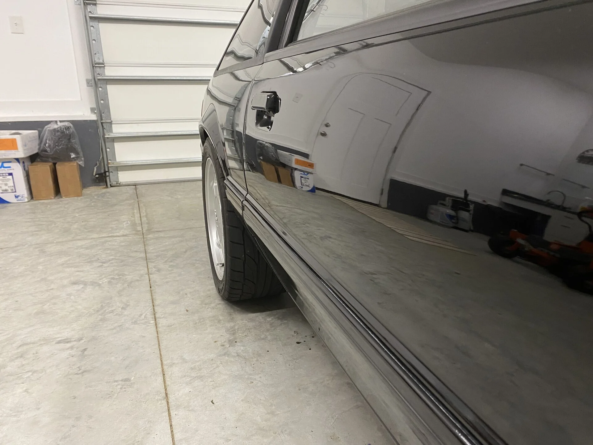

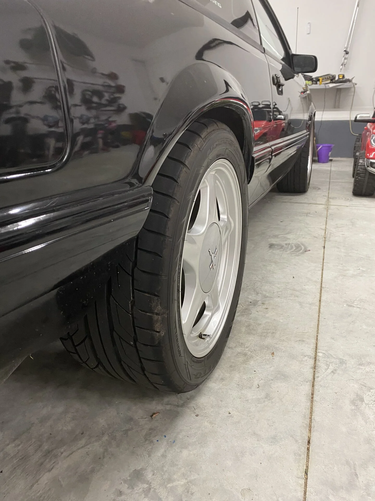

I have 17x10’s in rear with Bilstein quad shocks. But I used longer ARP studs and a Baer 1/2” spacer. 3DA67A2F-4C35-4859-9A9C-B54624F5C37C.jpeg 19C4AEEE-92BF-4BD7-A53F-551D4CB3C95A.jpeg
I dont mind hammering the inner fender near the quad shocks but Id like not to roll any fenders
If you don’t mind beating on the inner fenders it’s doable. I’ve read about some guys not rolling the outer fender, but I’ve never personally seen it done without rolling them.

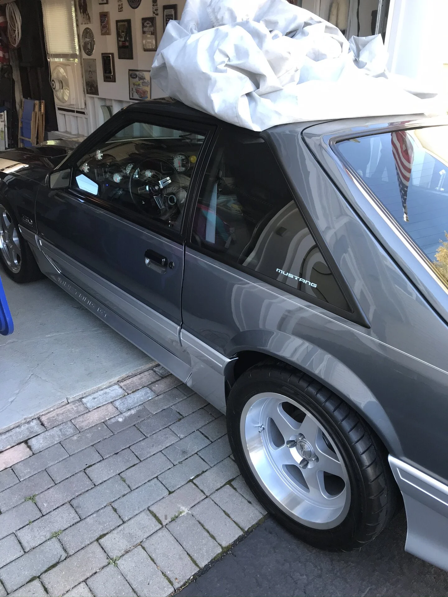

Here’s my 9” wides with 275s. Don’t look pushed in to me. If they were out any further the tire would rub the fender unless you rolled it.
