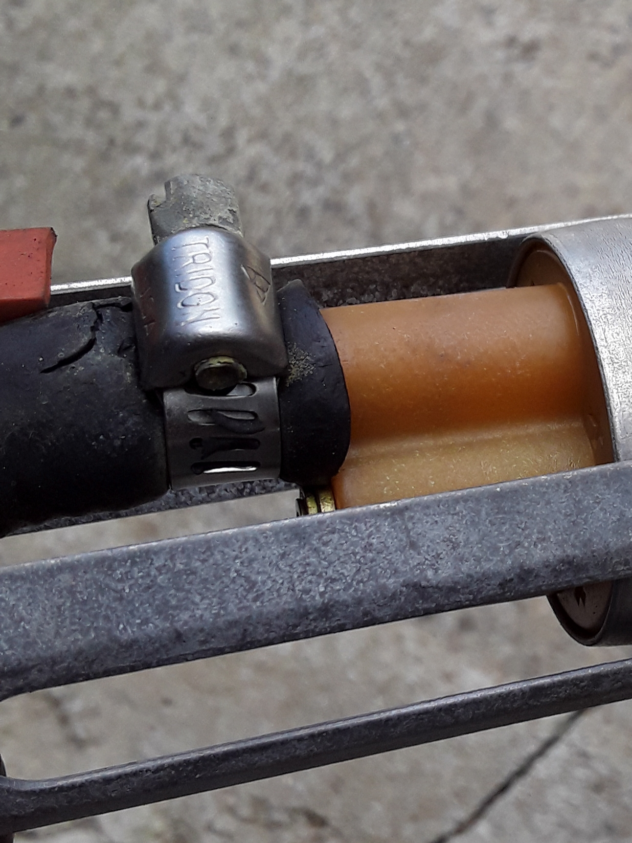

I honestly have no idea if I need it or not. The car was built nearly 10 years ago and the guy said it had a 190lph BBK pump in it. There's really nothing stock on or in the motor. Allegedly it made 284hp to the tires without the nitrous but the previous owner hasn't gave me the dyno sheet yet for proof. It does/did run strong for a 302 until the pump started failing. Then it has a ZEX dry setup with 125 jet. I ordered the 255lph Walbro. The previous owner said anything over 190lph would be better than the car running lean if I used the nitrous. I'm going of him and all of you because I know nothing about efi.Do you actually need a 255 fuel pump? DO your mods support that much fuel? If not, i would use a pump more appropriate for your power level, otherwise all you do is circulate the fuel repeatedly while heating it up, and with stock fuel lines you will increase the pressure in the feed line before the FPR. This can stress all those fuel line connections, and rubber lines, which is an issue if this is all original parts and you aren't upgrading. Last thing you want to do is pop a fuel line off. If you are stock(ish) the most i would get is a 155.
