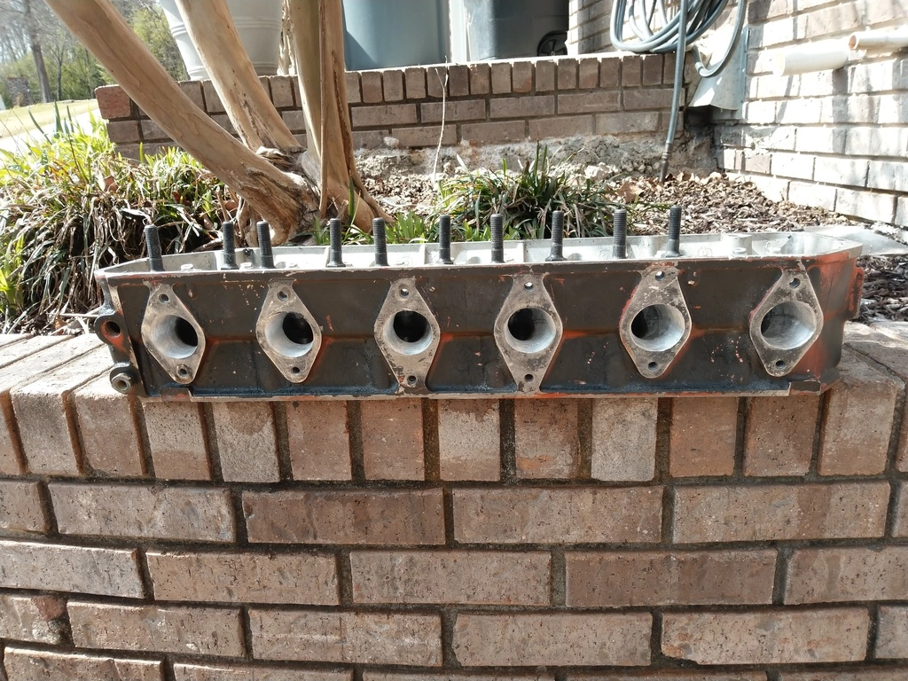

6 hours....After 6 solid hours of grinding, (and the compressor never shutting off) the head is ported.
It don't look like much, but these ports are actually 1/4" larger in diameter than they were when I started. Both the intake and exhaust side have been modified,...The obvious intake opening, and the exhaust port was just smoothed, and blended.
The head, pistons and rods are now at the machine shop,....I should have that stuff back within a week.

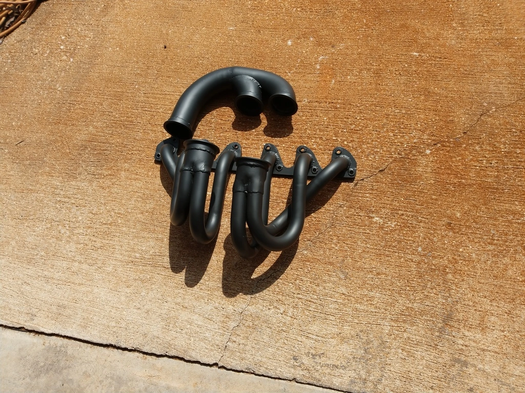

The header is done and back.
240.00 to basically paint them black.... Except this is a ceramic coating. I rarely spend money on having things coated, especially considering that there are such good paint alternatives,...the only reason for this was the potential endurance of the finish.

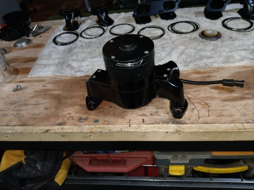

What this you might ask? Looks like your everyday Chinee electric water pump for a SBC if you ask me. This has been the Monsters pump since he was born. For whatever lain-brained reason, I decided that I was gonna relocate it. That led to me taking the thing apart because I was gonna re-drill new outlet holes, and block off the existing ones...I.I.I don't know why I decided to do that, but suffice it to say that this thing has been in a dozen pieces since the engine came out of the car. When you take the top off you release the four brushes that are held in place by the shaft on the motor. When i found that out, it was of course the hard way, and they shot out of their respective guides,....
Ever taken an electric gizmo apart, and had to deal with those stupid brushes that need to be kept in place by little pieces of wire? Well, imagine having to deal with 4 of those bastards...to say that I was a little frustrated by the reassembly is an understatement. After trying several times to get each respective brush put back in its slot, I attempted to put the thing back together. When that didn't go so well, and after several attempts, I let out a really loud Charlie Brown AAARRRGGGHHH!!!. ( CB aint got sht on me when it comes to screaming out really loud AAARRRGGGHHH's)
My wife came to the basement door after hearing me, and asked if I was OK..............I told her I was mad.....She said what else is new and shuts the door.
I finally get the thing back together and tested....needless to say, I am not relocating the thing, nor am i redirecting the water through new outlet ports. It will go back very near to where it was, albeit hanging from a different mount bracket.

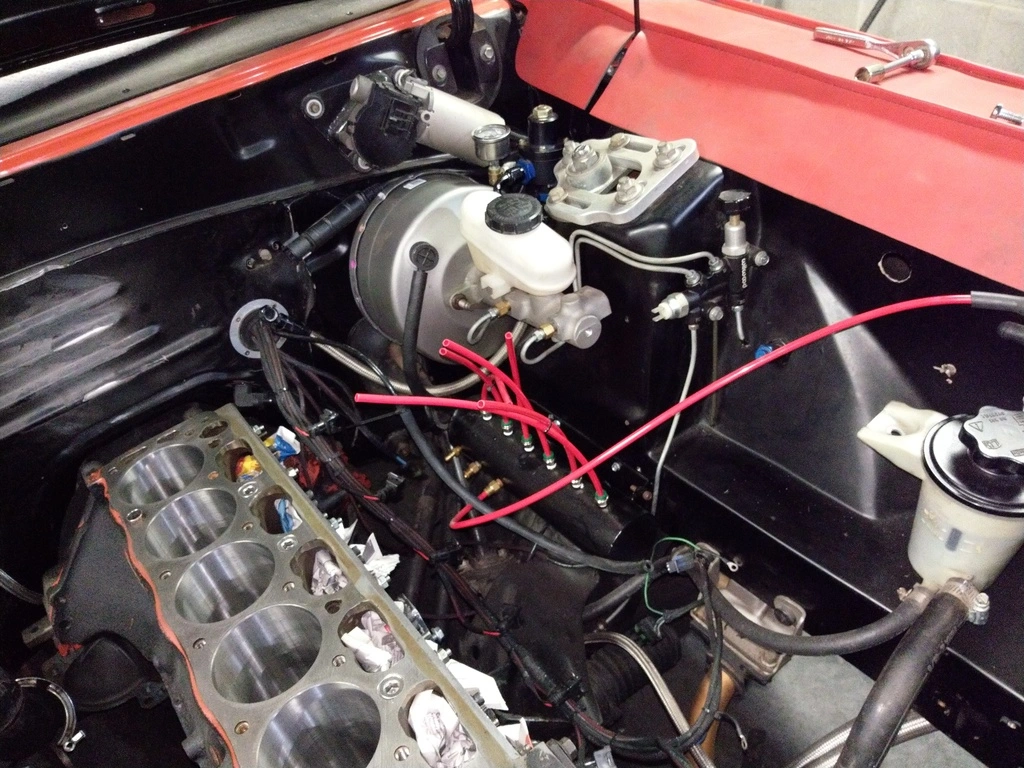

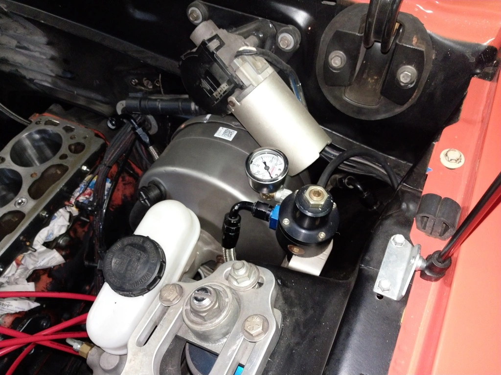

I put the master cylinder in place, and modified the lines to fit the new longer booster.
It's a beautiful day in the neighborhood.
I remounted the regulator. Despite the new fat fcker of a booster, everything fit exactly where it did before.
Brakes need to be bled still.

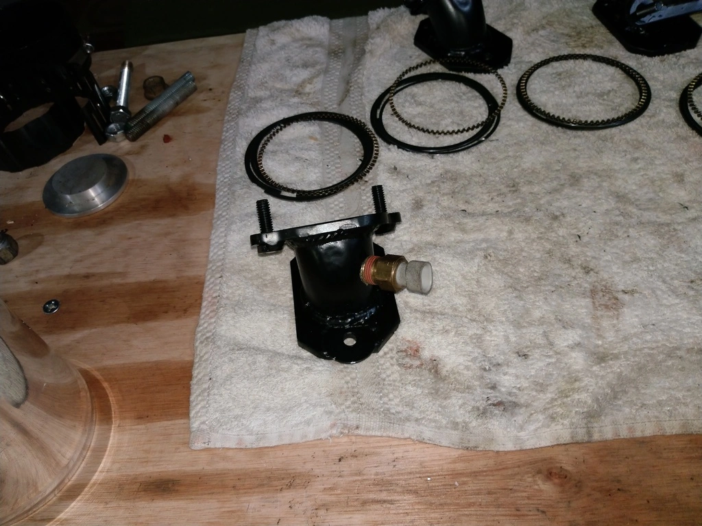

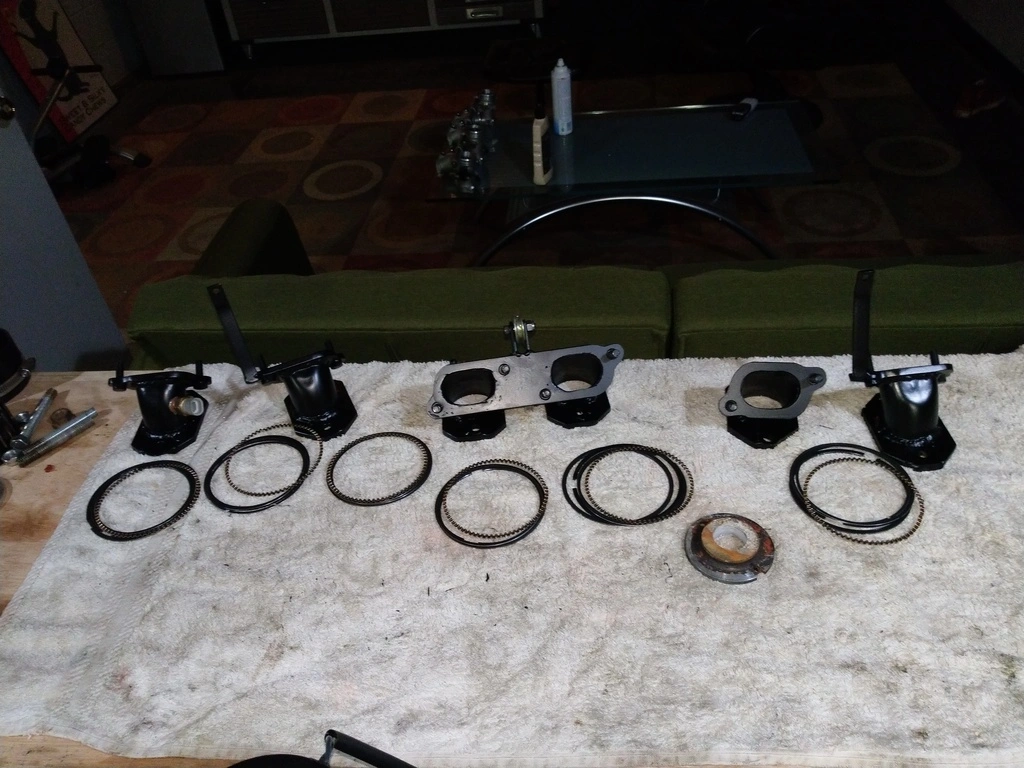

I painted all of my "manifold-lets"

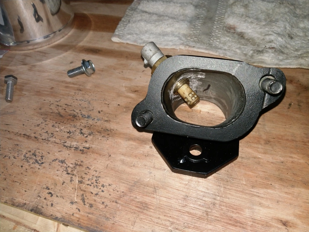

and drilled and tapped #1 for the IAT sensor:
IDK if the sensor sticking in the hole will hurt the airflow to this cylinder,....but I didn't want to put the thing in the airbox, and have to disconnect the thing and not have it while trying to dial in the ITB's when I get the engine running again.

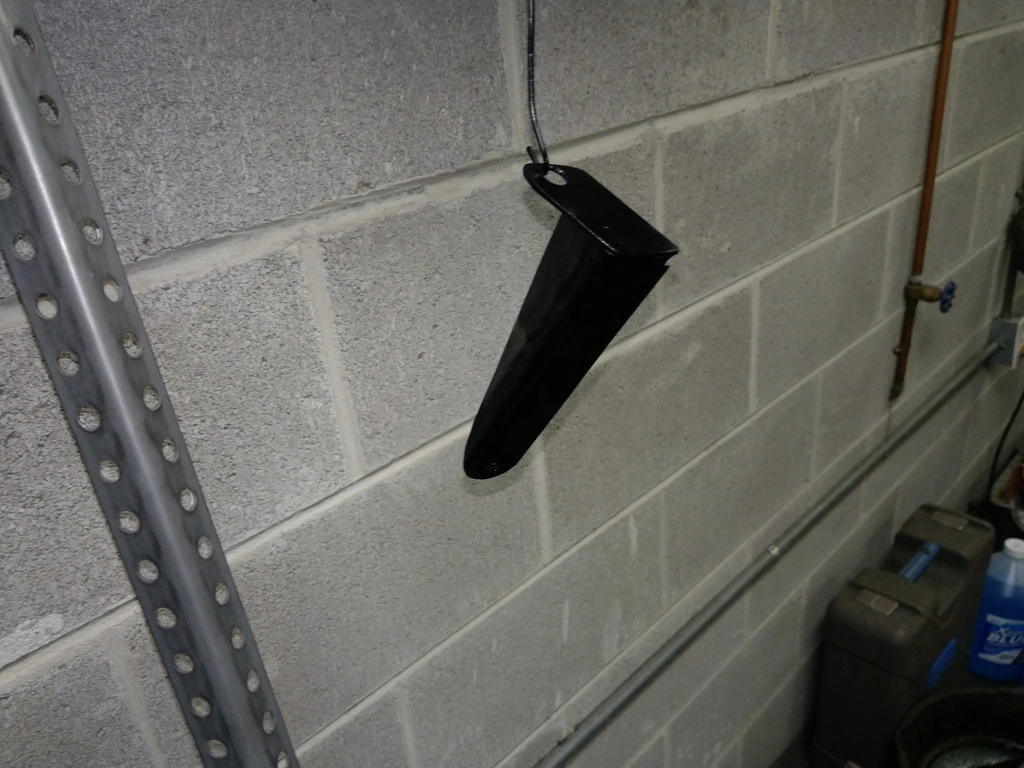

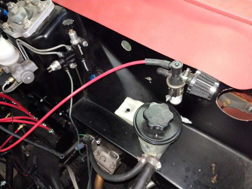

Now that there isn't the old intake manifold to mount to, the PS reservoir had nothing left to hold it up...
It's just kinda floating there...
So I made a little "L" braket finger looking dealy bobber to mount to to the fender apron.
Yes..... says the finger.

I wonder if you can use a fitting or modify the IAT mount to move it out a bit. The tip with the holes is the sensor so it seems like you probably have 1/2" or so it could come out of the air stream or so it seems to me.
Take a piece of 1/2" rod, 16" long, either wood or metal and tape a cloth streamer about 3" long to it. Drive down the road at various speeds with the rod stuck way out the window and watch the streamer as it responds to the airflow. That's what your ACT is going to do to the airflow inside the manifold section. The next question is not so simple: what will be the reaction of spraying fuel on the ACT do to the accuracy of its readings? The ACT in the 5.0 Mustang manifold is upstream of the fuel injectors, it isn't a very useful comparison to make for what you are doing.
You're right. I didn't think of that. Guess I'll have to drill the airbox, and put it there, and plug the hole in the #1 riser.
