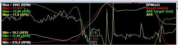

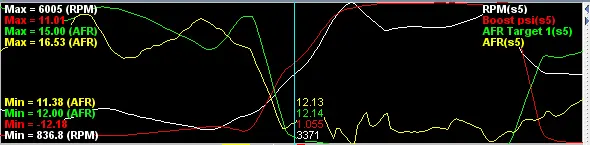

Mike I looked through the log and I don't really see any changes that need to be made, I did tweak a few settings but overall the ve table is dialed in. What you saw as two AFR spikes are most likely some kind of misfire. when looking at the log if you tap on the field marker for AFR and set the smoothing to 5 you will see what I mean.
same log time with smoothing what I adjusted the tune with
removed smoothing to see if there was an underlying problem which revealed what I believe may be a misfire.
