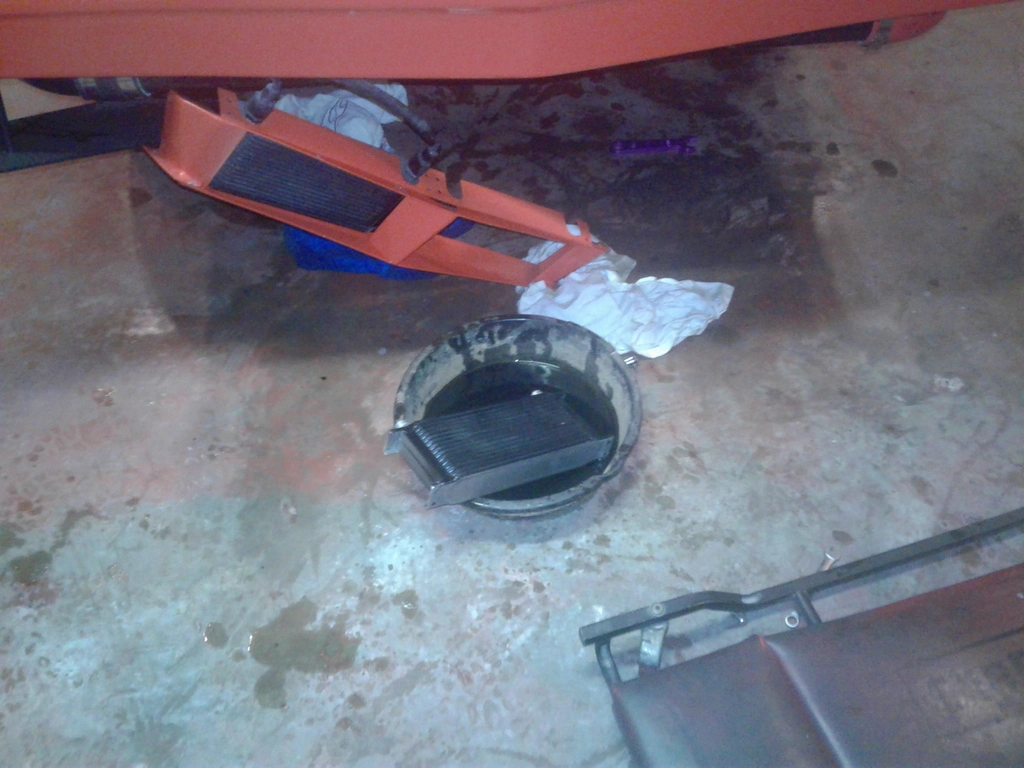

Either a line is broken, or the cooler has ruptured. The shroud that houses the cooler is actively dripping oil, It's obvious that alot of oil has also ran down the lines that go to the filter on the driver side of the engine, and when oil dripped off it hit the tire and it in turn painted the inner fender.
I check the dipstick,......nothing.
I jack the car up in the air, and remove that tire. I remove the lines to see if there an obvious break or cut in the line.....
The only thing I see is that one of the push-lock ends has pushed significantly forward. It has moved out of the hose one full barb. This end was attached to the cooler.
The cooler doesn't look like it is broken, but it is so covered in oil, you can't tell sht anyway.
So I'm still haunted by a freaking oil leak...This time a big,...giant,...freakin oil leak.
I don't know if I ran it completely out of oil,......I guess opening a drain plug will tell me that story. I don't remember how long after I heard the pop if I flogged the car. A couple of times at least, I'm thinkin.' Let's hope it's still got oil in it.

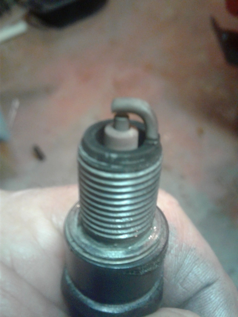

I pulled all six plugs...They're freakin' perfect.

Dammit man. Can't catch a break can you? Those plugs do look perfect so your tune is good, we just need to get the acceleration enrichment dialed in so you get nice crisp response without any blips.
I don't think you hurt anything those engines are darn near bulletproof.

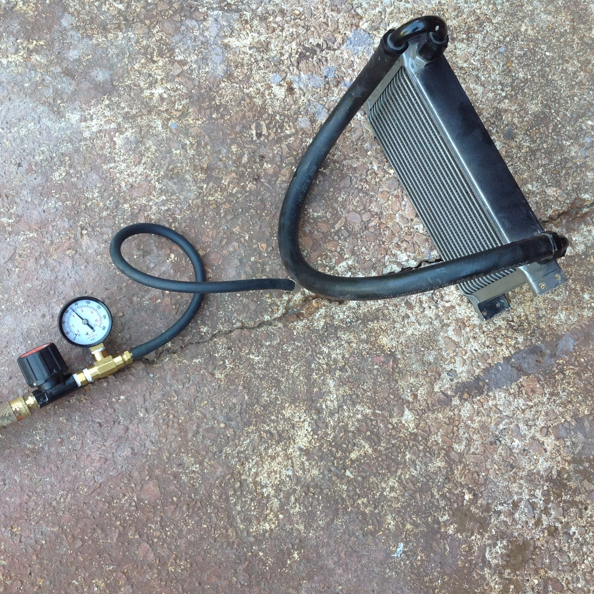

The second thing I know for sure is that the oil cooler did not rupture, and it'll hold 100 p.s.i. Of air pressure.
I backed it down to 70 p.s.i. For this pic, so it wouldn't blow my rigged up pressure testing barb out of that linked hose.
I also now know for sure that the problem is these pieces of sht.
Specifically, that black hose. The constant drip that was always hanging from the pump/filter has to have always been coming from that loose fitting. Evidently despite their rated 300 p.s.i. burst rating, they either don't like heat, or they don't like oil, ( again rated to handle both) or it was simply a hose end failure...

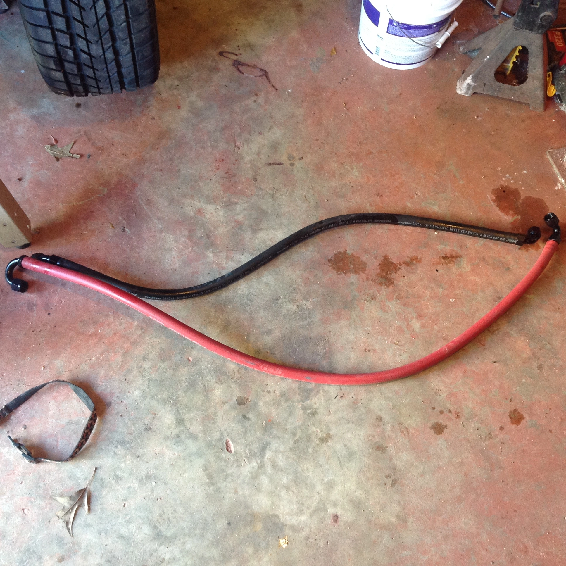

Well,...There is braided stuff where there was rubber stuff. Braided hose does NOT wanna go where the old junk was though. It is far less supple and refuses to bend. Originally I ordered all Summit branded junk, and they ended up back-ordering the hose on me.
Perfect,......I'll just pretend to change out the stuff. WTH do I need hoses ends for w/o the hose to put them on?
The next day (Cause I get all stuff from Summit in one day...I'm so close) I substitute the Summit branded hose for Russell. It got here yesterday.
It works,..but the Summit end goes together very tightly.
The Chinese oil cooler got hurt in the change out though...trying to thread the hose ends onto the junk chinee-aluminum -10 nipples while hanging from the bumper caused a cross thread incident on both ends of the cooler. After several attemps, and alot of "through gritted teeth" Mutley cussing
I get it to go on there.
