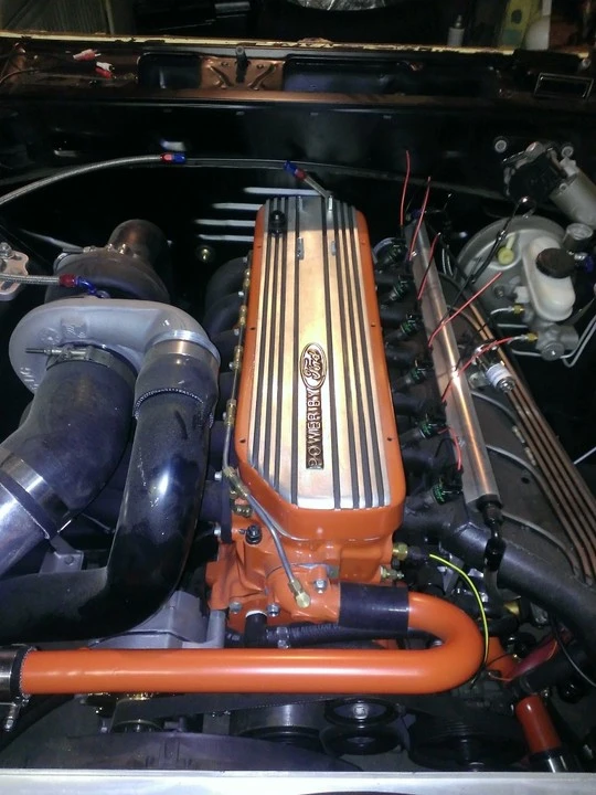

This is what I have been thinking about today. Aside from the mountain of dust piling up on the engine, the fact that I chose to mount that ugly-assed EDIS-6 coil on my valve cover has always been a point of contention for me.
I decided that I was gonna change that.
That first required I place a phone call to Taylor wire to inquire as to whether or not I could get the wires I need w/ the EDIS coil sockets in a custom/longer length so I could relocate the damn coil pack in the first place. It got located on top of the valve cover because the wires that I bought weren't long enough to allow me to place it anywhere else ( or at least I thought I couldn't back then.........I don't even remember anymore). The phone call ascertained that I could in fact buy the wires in a semi-finished state w/ the EDIS sockets on one end made permanent, and the boot end customizable ( which is opposite if you've ever bought a trim-to-fit Taylor wire set before).
Dude said that I could name my length, and he'd make me 6 wires all that long, and I could cut them down as I saw fit for the bargain basement price of 85.95 before shipping, which is almost what I paid for the set that will now become scrap. Just for my information, I asked him just how long I could have them made, before there would be a drop in the wires ability to conduct the energy from the coil to the plug. He said 10' was the maximum.
10" eh? Maybe if I was putting the freakin' thing in the trunk.:rolleyes:
I think I'll be OK, I'm only having him build me wires half that length.
The good thing here is that I'll be able to get that damn coil pack off the valve cover, and plug those 4 holes w/ some 1/4" rivet or something similar, and the coil will be free to roam wherever I see fit to relocate it to. I have a place set aside for right in front of the intake manifold between the radiator and it that I think will work fine, and I'll set about building the mount bracket to make that happen.
