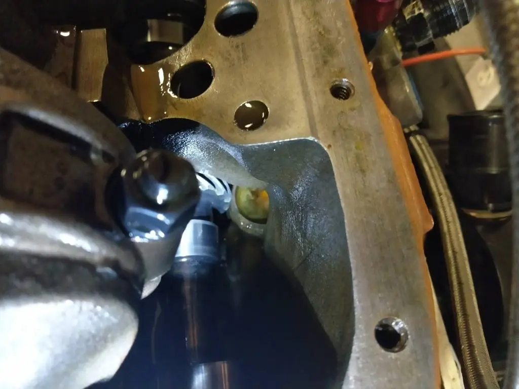

Decided that I'm gonna use the distributor hole as my vent port from the pan. Instead of removing the pan and drilling and welding a fitting in it, ( and risk warping the sealing flange all to hell and back) I'll just remove the expando freeze plug that's currently in the hole, and make a disc out of steel that was the size of the old dist base that i can drill and tap for a -12 fitting.
I'll put one of the old hoses that used to run water to the rear radiators ( that are now laying on the floor) back into service as a vent hose and run it high up on the driver side apron, and cap that thing with a breather.
I'll take all that crap off of the valve covers, and put the grommets back on, and stuff a breather in one of them, and an oil filler cap in the other. The tapped plug in the middle will just have to be I guess.
Now all I gotta do is figure out how I can justify spending 300 bucks on the evac pump ( that has 10 seconds run time on it) and the oil water seperator that works...(until it gets plugged up) as more sht that I'll never use again that sits in a drawer in my garage.

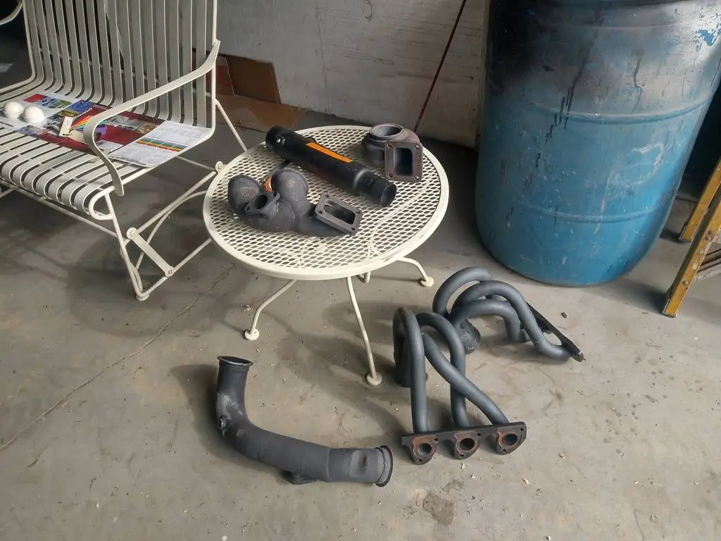

I get to the powder coater and show him what I need ceramic coated. This is the same guy that coated my headers earlier this year.
I have the merge pipe, the turbine housing, the down pipe, the headers, and the charge tube that needs done. The headers have been hurt by wrapping a couple of tubes, and where they made contact with a wrapped tube, have turned orange. They needed to be redone.
Last year the guy charged me 270.00 to do the headers. This time he's charging me 270.00 again,.........to do everything.
Again,..it seems like free to me.
I leave the stuff with dude. I'll have it in a couple of weeks.

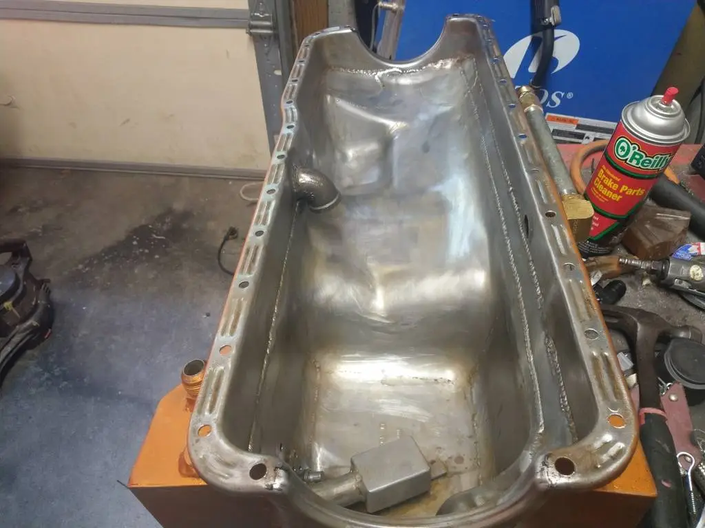

I get back home,...I gotta deal with the crankcase vent. The voice inside my head says,..." You got the engine out,.....you may as well pull that pan to see what kinda funk is in there..at the very least, it'll be piece of mind"
So I remove the pan to find.........nothing. The pan is clean.
It did serve to give me piece of mind,...it also did two other things.
#1. Now that I could see firsthand, I came to realize that the distributor hole would be a disaster as a choice to vent the crankcase......Why do ya spose?
The disc you can barely see is the bottom of the expando -freeze plug. Removing that thing would have exposed the future vent hose fitting to an oily distributor cam gear centrifically
flinging oil directly out of that hole.

#2. So,..despite Hot Foxes advice,..the pan got the fitting instead.
It's a 90. Pointed down, and between crank throws lined up the the #3 main. It's high enough to be out of the oil, and on the down side rotation of the crank. Any oil that makes it up that tube will gravity drain right back into the pan. Hopefully this works.

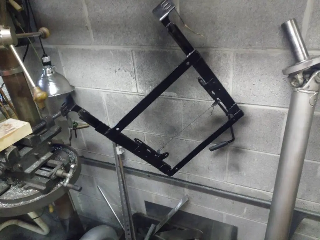

I removed one seat, and was able to get one bracket completely built and painted
I used the old pro car seat adjuster sliders, and was able to make it fit beautifully. The adjuster lever had to be cut, bent, and welded to pas by the front seat bolt.mthe pic makes that look all bent to hell, but it's an opto-illusion....it's perfect.

Now that the pan is off, I can see that there is a substantial hole (3/4") for drain back in addition to the few tiny little holes that I posted a pic of earlier.. Putting a direct path pressure hose into that valve cover should allow breathers to eliminate the pressure while giving whatever oil remains in that line a path to drain back into the pan. All I know is that I'm done with trying to figure a way to keep oil in the engine after I put my foot in the pedal.

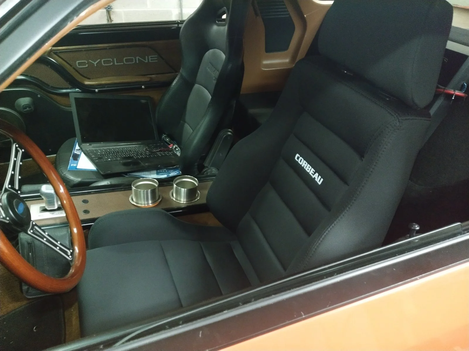

I got home tonight, and bolted that bracket to the Corbeau, and put the thing in the Monster.........
It's like I'm Granny Clampett, sitting up in the high rocker.
That'd be me sitting next to EllieMae....hulling pole beans....
I probably sit 1, maybe 2" higher than the Scat seats that were in there...I'm gonna have to modify the car to make these seats fit....as in cutting and welding the front seat mount...
It don’t look like it when you look at these two pics, but trust me when I tell ya, that corbeau is way higher than the scat seat.
It didn’t make no sense..
So I took it back out and removed the bracket and sat both seats side by side....they even looked about the same ride height.......
Until you set in the scat,...then moved your butt over to the corbeau.
It’s the difference between foam densities...one offers no support, and is mama bear soft. the other is papa bear hard, and barely gives.
I need to fix that by creating a “ just right” baby bear ride height.
The good thing here ( for me at least) is that the bracket is modifiable. I went home at lunch and cut the front mount tabs off of the bracket, and lowered the front till I couldn’t go any lower because of the seat slider adjustment lever stopping it. I’ll get another inch of front drop at least, and if I do something with that adjuster bar,...I’ll be able to put the seat on the floor.
