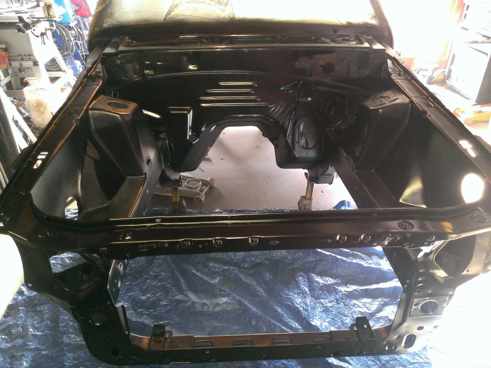

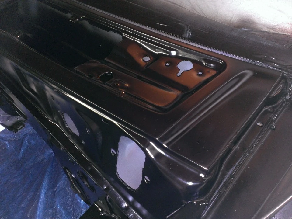

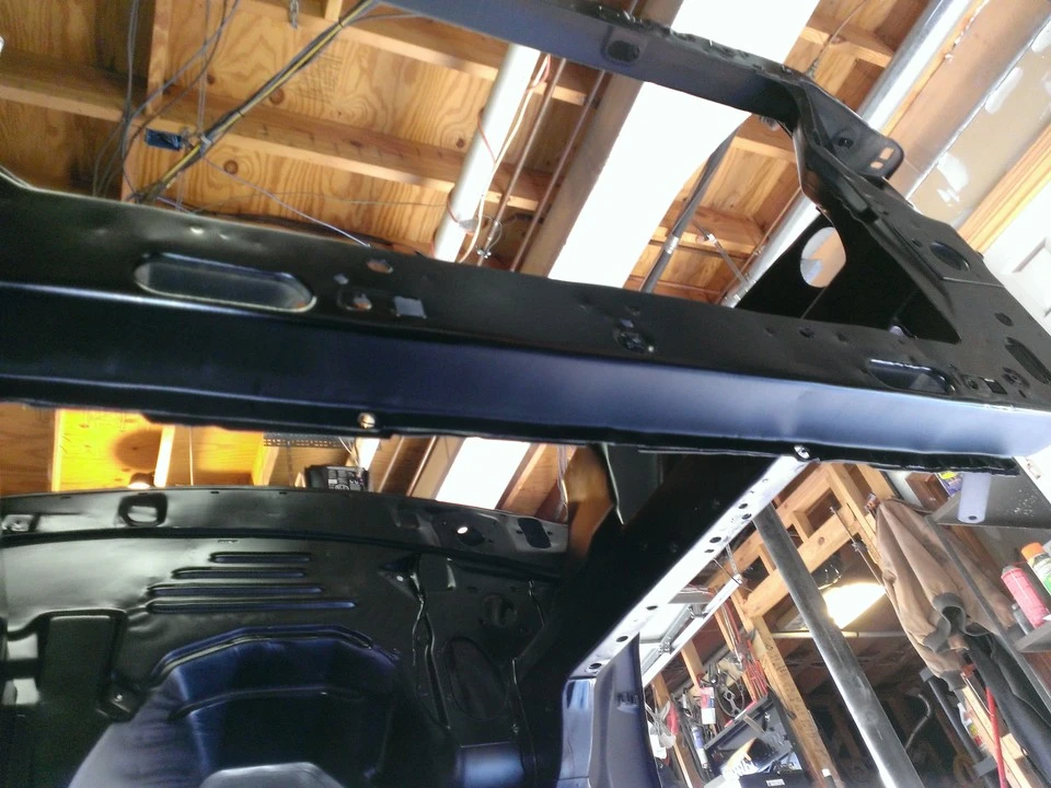

Well.
For better or worse, it's done. As stated earlier I give this work a 70. ( Below my standard, but acceptable)
For one thing, The primer lied to me. It said that the panels were "good enough".
The black paint told me they weren't even close.
I dry sprayed the right front fender apron, so it has texture equivalent to bed coating ( shoulda just spray bombed the damn thing with that sh it.) But I didn't.
I didn't spend enough time w/ a block, and used way too much scotch brite and my hand instead. The results don't show up in the pics,..but if you were standing next to me,.....you'd see it.
Hopefully the obnoxious 6 banger sitting in the middle will take your eye off of the engine compartment.
This is hardened stain black paint,...and it should be much more durable than anything that comes out of a rattle can. After a couple of days,..I'm gonna start bolting junk back on i.e M/C,..K member,...struts,..spindles, brakes all stuff I've had sitting waiting for this step to be done.

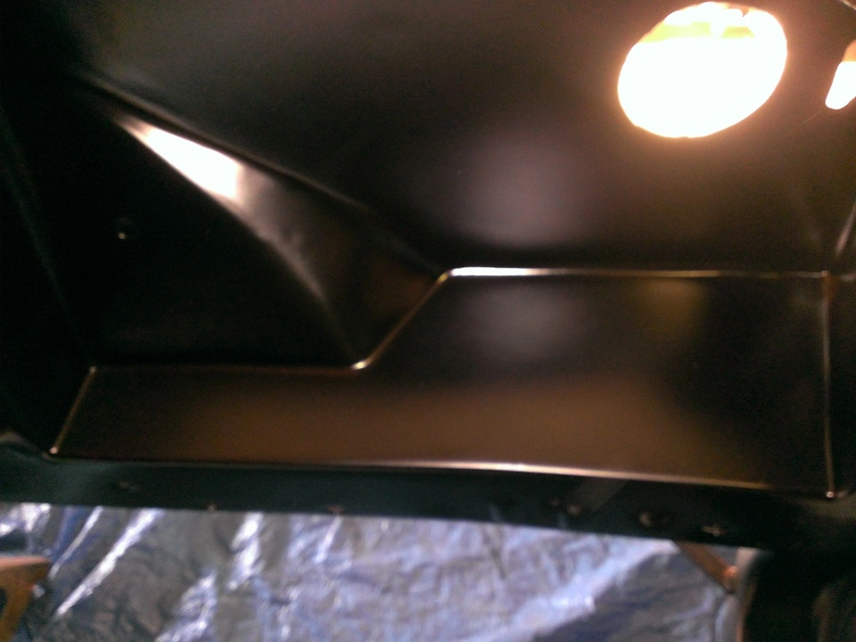

The paint is still curing in this photo, and hasn't flattened yet. It's not tacky per se' but I wouldn't touch it just the same. You'll notice all of the white specks on the paint,........it's dust.
The neighbor decided that now that there's paint fumes and a cloud of overspray floating out the over head, that now would be the time to fire up the riding mower, and then run over every mound of bare earth he has in his yard. I'm thinking that once it's dry enough to handle, this stuff'll wipe off,....but then again....... it could be stuck just the same. (which will be par for the course on this particular job).

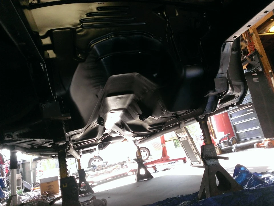

Ck out the bottom of the radiator saddle.
There's something to be said about buying a car from an octogenarian,......saddle is perfect as the day it left Dearborn.
