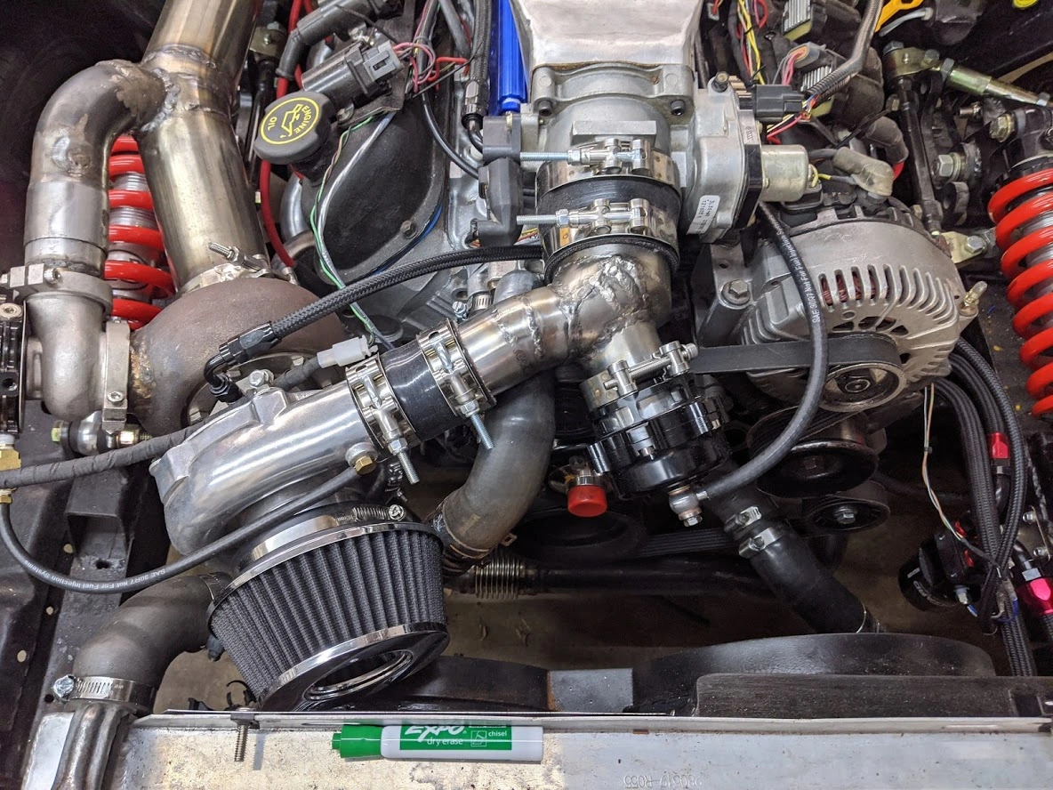

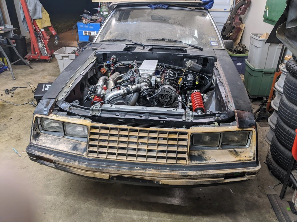

Here is the world's shortest charge pipe with BOV. Water/Meth injection coming soon.

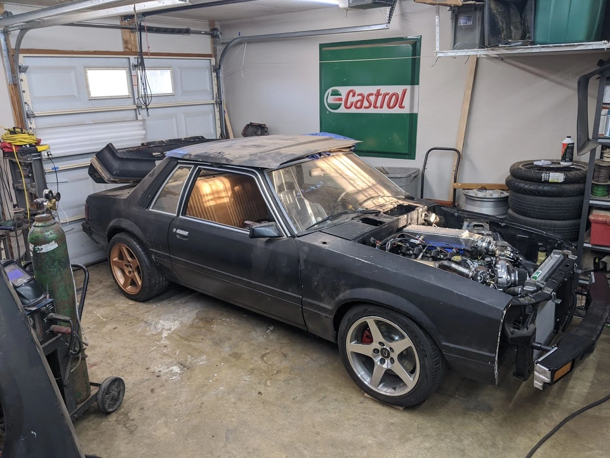

And here is my dirty car.
It runs although I seem to keep forgetting to record a clip of it. It even moves the wheels (on stands)!
Fenders might need some modification to clear the tires and then I can start wiring the lights.

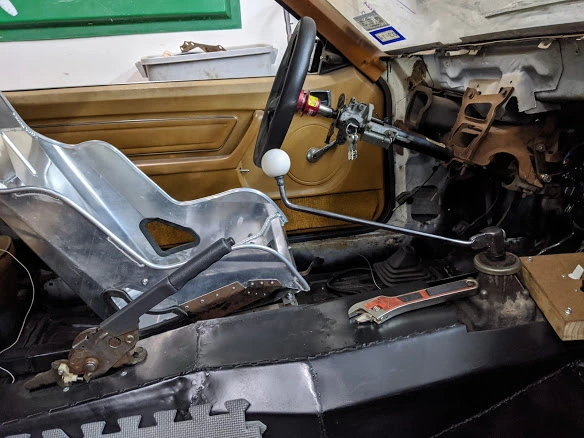

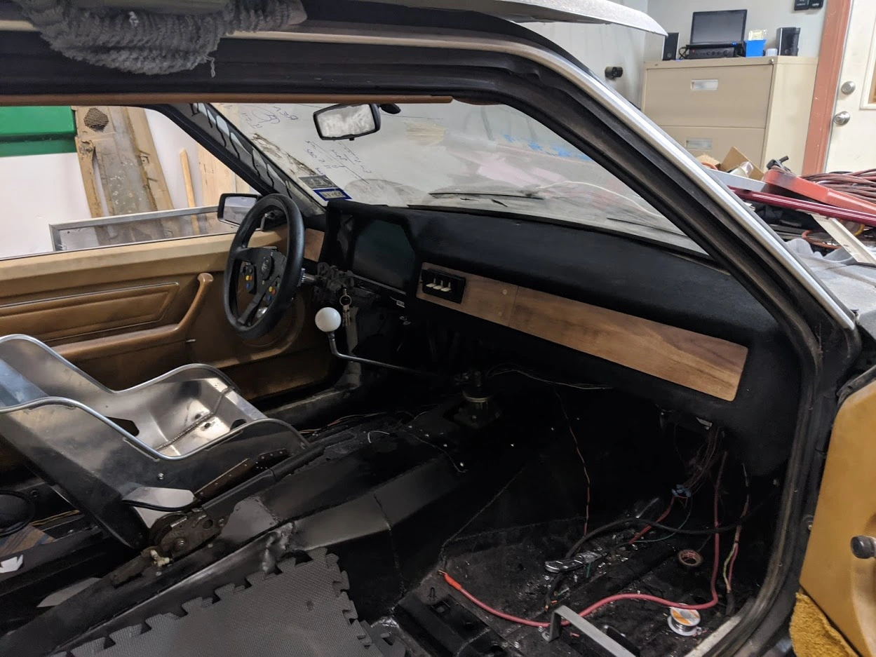

"This is the only shifter I have made for this car"
The throw isn't short but it'll be fine, side to side is a short distance but overall this setup feels solid.
The setup here is the nub of the old truck shifter with a steel rod salvaged from an old table saw heated and bent with a bolt welded on the end for the shifter knob.

Seems a bit long. Stock shifters are ahead of the steering wheel (further reach than steering wheel), and yours is quite a bit farther back than the wheel. Are you a T-rex?
As someone once said "doin it anyway!"
But it really is comfy for me. That might change once I'm actually driving but for now it stays.

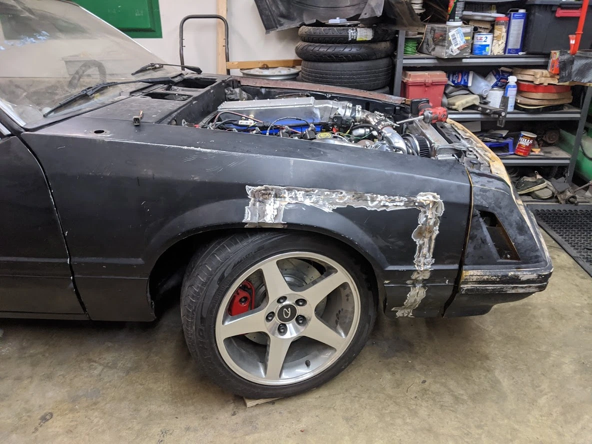

Last night started the great light wiring project. Pulled the wrap off the front and rear wiring and clean it up in anticipation of re-installation. Now, you can't install lights into something with no bumper which wants fenders to locate it so that was the weekend project.
Fenders got the chop chop. I moved the front half of the arch 1.75" forward to clear my tires through turning. Tig brazed as much as I could in hopes of minimizing warping. I foretell hammering and filler in my future. As I was cleaning the areas for welding I found lots of bondo so if filler is whats needed to make these pretty I can live with that. Bumper received love and care in the form of reattaching studs and posts back on to the header panel.
Nuts and bolts were getting cleaned and painted so the bumper is just sitting in place but oh boy was I happy to see the bumper back on the car even if it's weathered as can be.

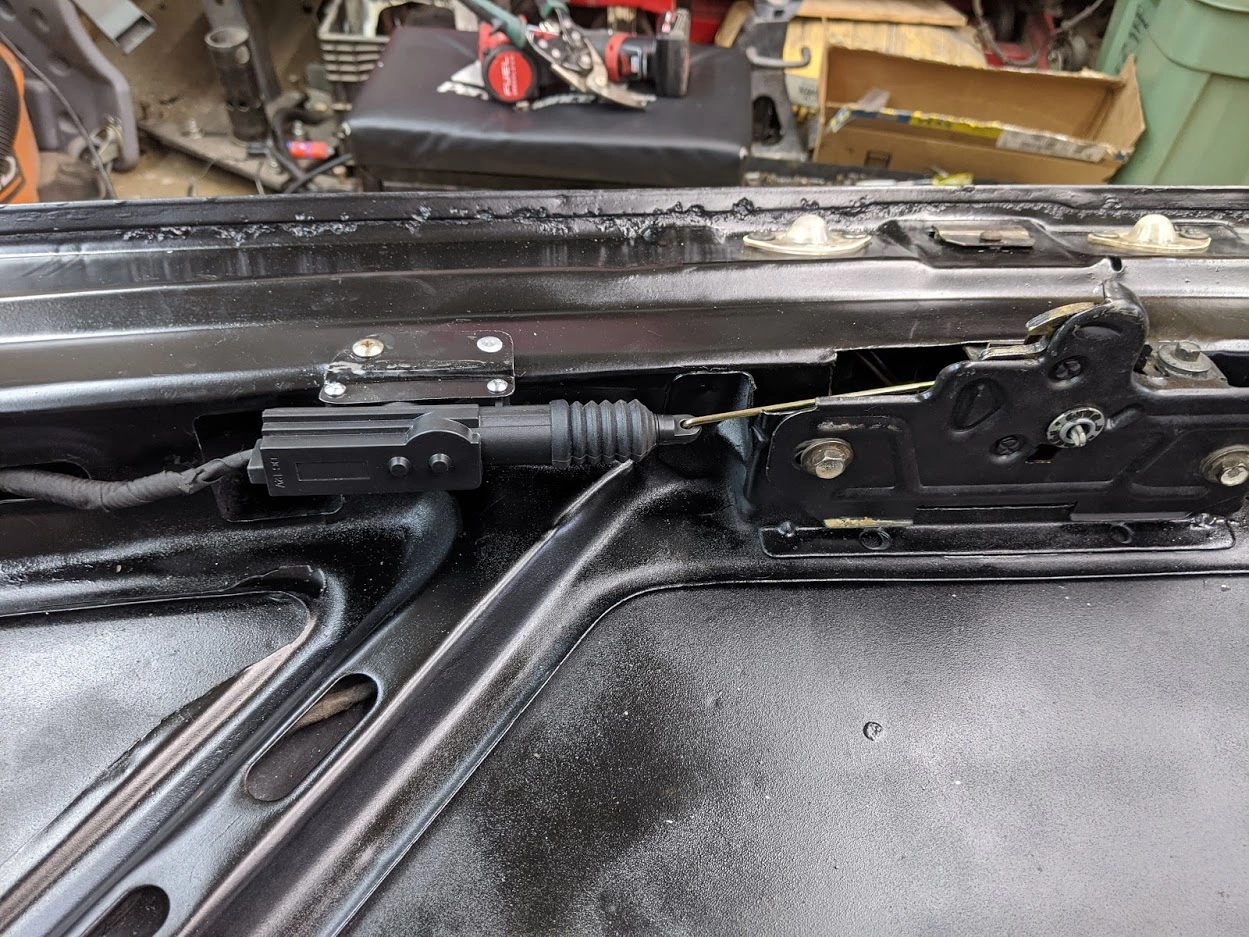

I'm in wiring purgatory right now. Front light harness is good, the rear lights are getting 4 new sockets. I figured while I was relooming wires I'd add some features in I'd like such as a electric trunk release.
It was after I removed my trunk lid I noticed all the rust on the lip so I cleaned it up and primed and painted it. I have no qualms with drilling holes in a rusty trunk lid. To make the actuator work I brazed a bolt onto the release mechanism and then notched the trunk for the actuator motor and the linkage. Overall a quick project that keeps all the original functionality.
