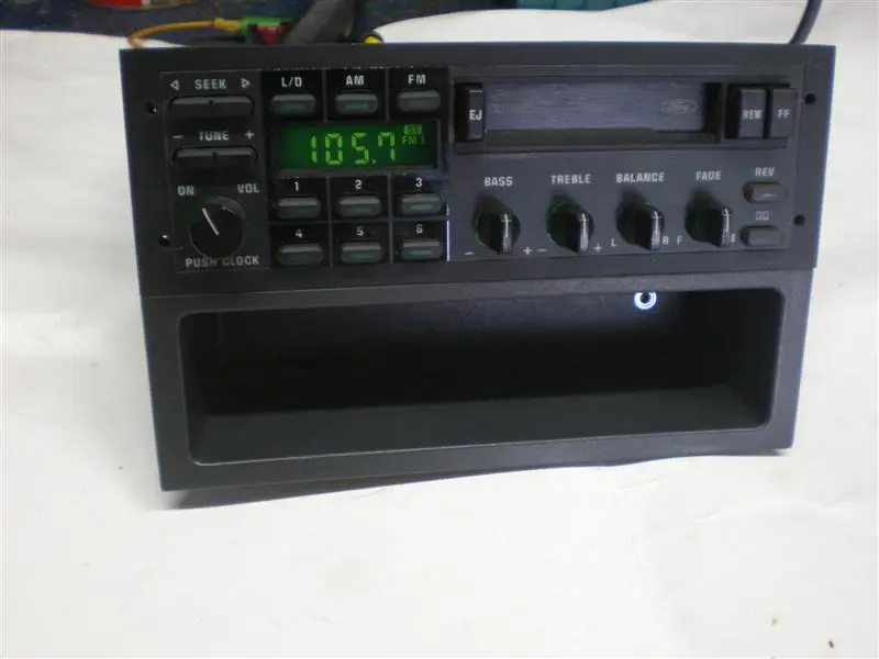

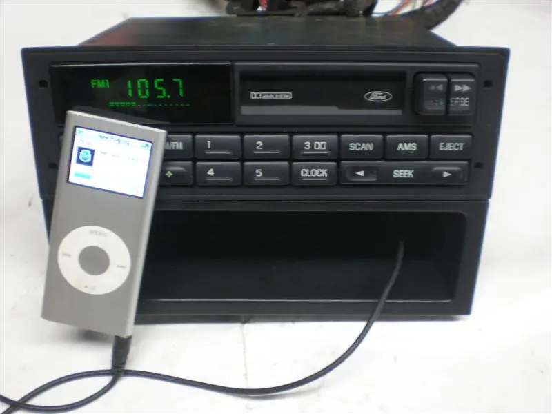

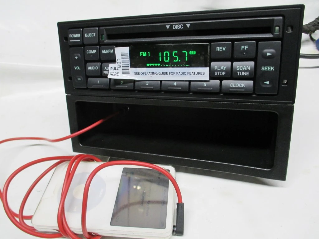

hello!new to the forum here but happy to help out with any questions you may have on fox radios.Im "the guy"who sells the fox body radios and cd players on ebay,with the ipod input installed into them.couple pics of my work.started doing this when I got my 88gt and wanted to put the stock radio back in.i currently have a new 93 cd player installed and have the eq setup also,both with ipod inputs installed.let me know,thanks.
I guess it's worth asking.. You willing to share how you add your aux input to the radio? Or is that a trade secret that's part of your ebay business? That's cool if it is since, you figured it out, but since many on here are DIY types I'm sure I'm not the only one interested in knowing what needs to be connected where?
rooster6969
May 8, 2014
46
I get that question a lot and believe a bunch of people could handle the install of an input if I told them but I cant give that info away.It does have much to do with my business of selling the radios.the other part is the multiple questions that would be asked or people even ruining their radios because it can go south pretty fast when you start soldering on the circuit board.i have dealt with all kind of problems in the past 5 years of doing this and was self taught.i appreciate the question and hope to help you out in anything else,thanks.

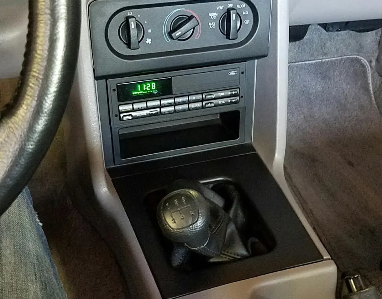

I know this is an old post, but it helped greatly in my decision to install a newer factory radio into my 1991. I got a non-premium standard Cassette deck from a 1995 Escort. It has the correct trim for correct fitment into the fox mustang. Ford F-150 & bronco also have the correct trim just FYI. The OP was correct on it needing a second ground for the night illumination to work. On the grey plug, wire 7 is not in the plug on the 87-92 mustangs because it is not used. All you have to do is add a wire to your current plug (i cut the harness off the car i removed the radio from at the Pick your part & took out one wire and added it to my connector) I then connected it to wire 3 which is also a ground. Works perfectly. Night lights and dimmer. I used the Cubby from my factory 91 radio and just switched radio bottoms, I also found a non cassette only am/fm that also worked, thats pictured. Kind of like the look of the non cassette.

That looks great with the non cassette/cd version. It makes sense as many no longer even have cassettes or CDs these days
