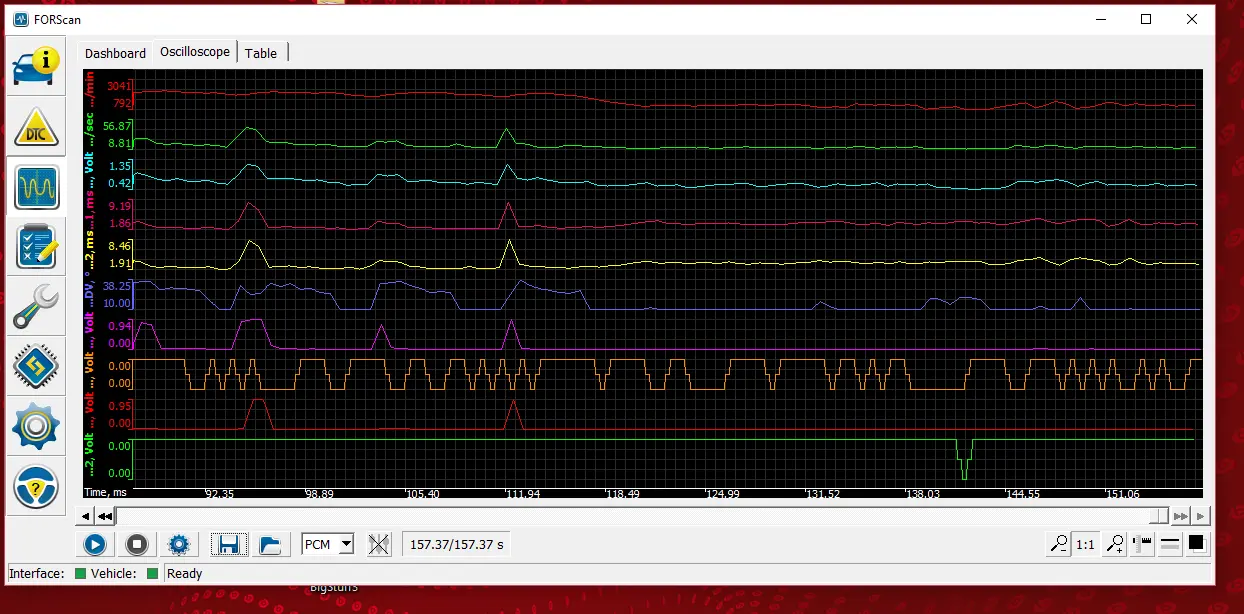

Once you get the adapter you can view almost anything on the car while its running and also save the files and upload on here for us to see. I will be more than happy to help walk you through using the software. Its super easy and will give you a lot of information. Lets just say once you learn how to add PID's and read them it will change everything you know about troubleshooting cars. My parents own all fords and I have found problems they didn't even know was there until I hooked it up ran a few test and found them. My dad was about to start throwing parts at it but the software pinpointed the exact issue. It gives you the codes like a obd1 and 2 show but also shows the history of cleared codes and gives you what each code is and what the problem could be. Its pretty much a ford manual built in with datalogging capabilities, which in my opinion is priceless and saves you the headache of throwing parts at it. The picture below is just a couple data logs I have from tuning my mustang.

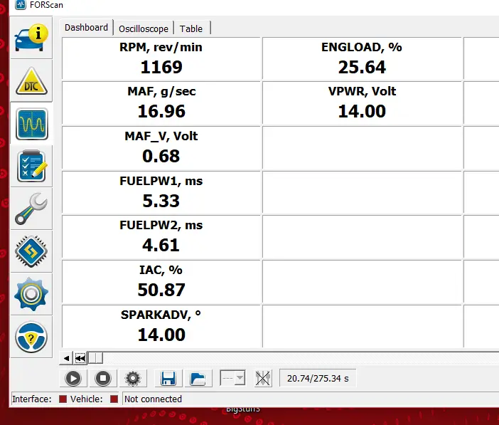

Thanks you all adapter should be here tommorow.
In the meanwhile I bought a $50 Walmart OBD and he capture live data. I’ll post that this evening
Good news is I bought a new sigh “autozone” IAC. That actually fixed my problem with the cutting off and stalling but here is the catch now at idle the rpm surges 300 or so Rpm and drops back down every ten secomds
Also while driving and shifting the rpm will get stuck then drop. And I can felling it while driving it a little.
So I figuring that the new IAC is bad? Although it did fix my problem.
And they sell a IAC with black vent. Is that one better?
