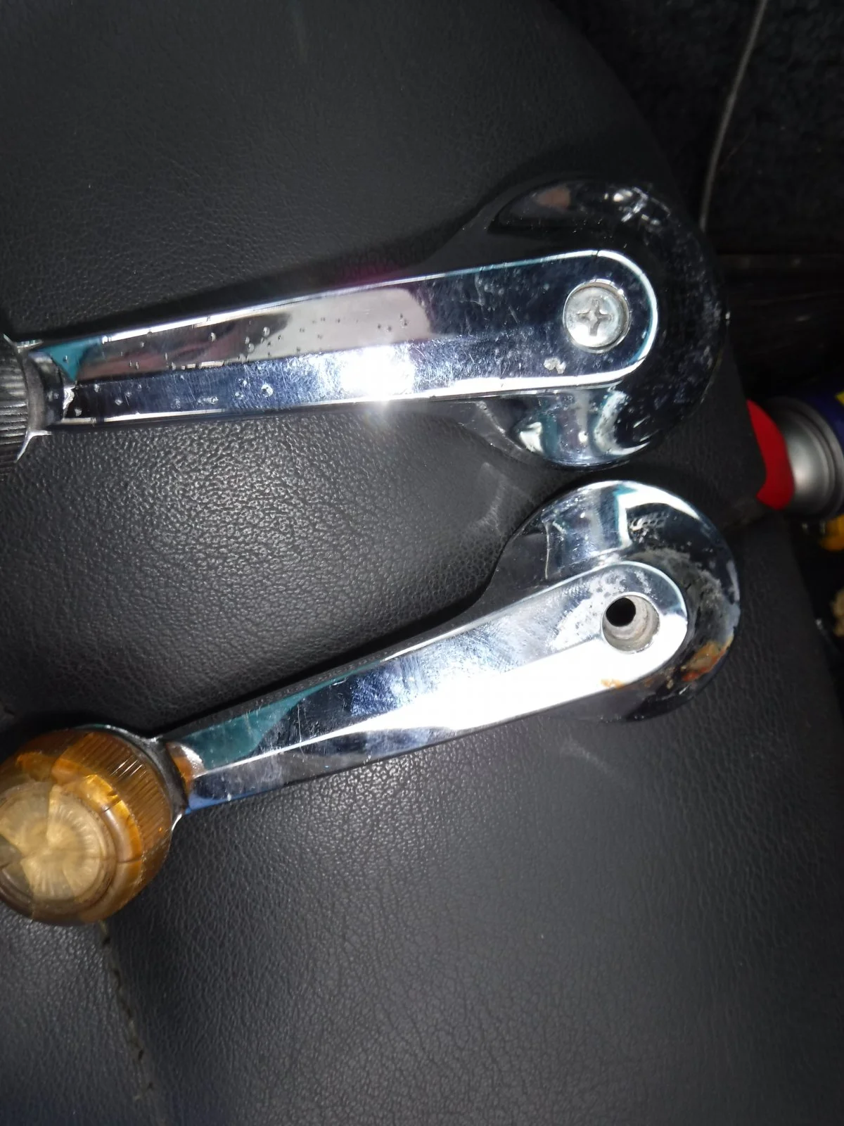

Window Cranks
The 79 knob sure looks similar but is larger for sure. I found another on flea bay so I can have matching set.
The cracked knob is about to fall off old one anyway

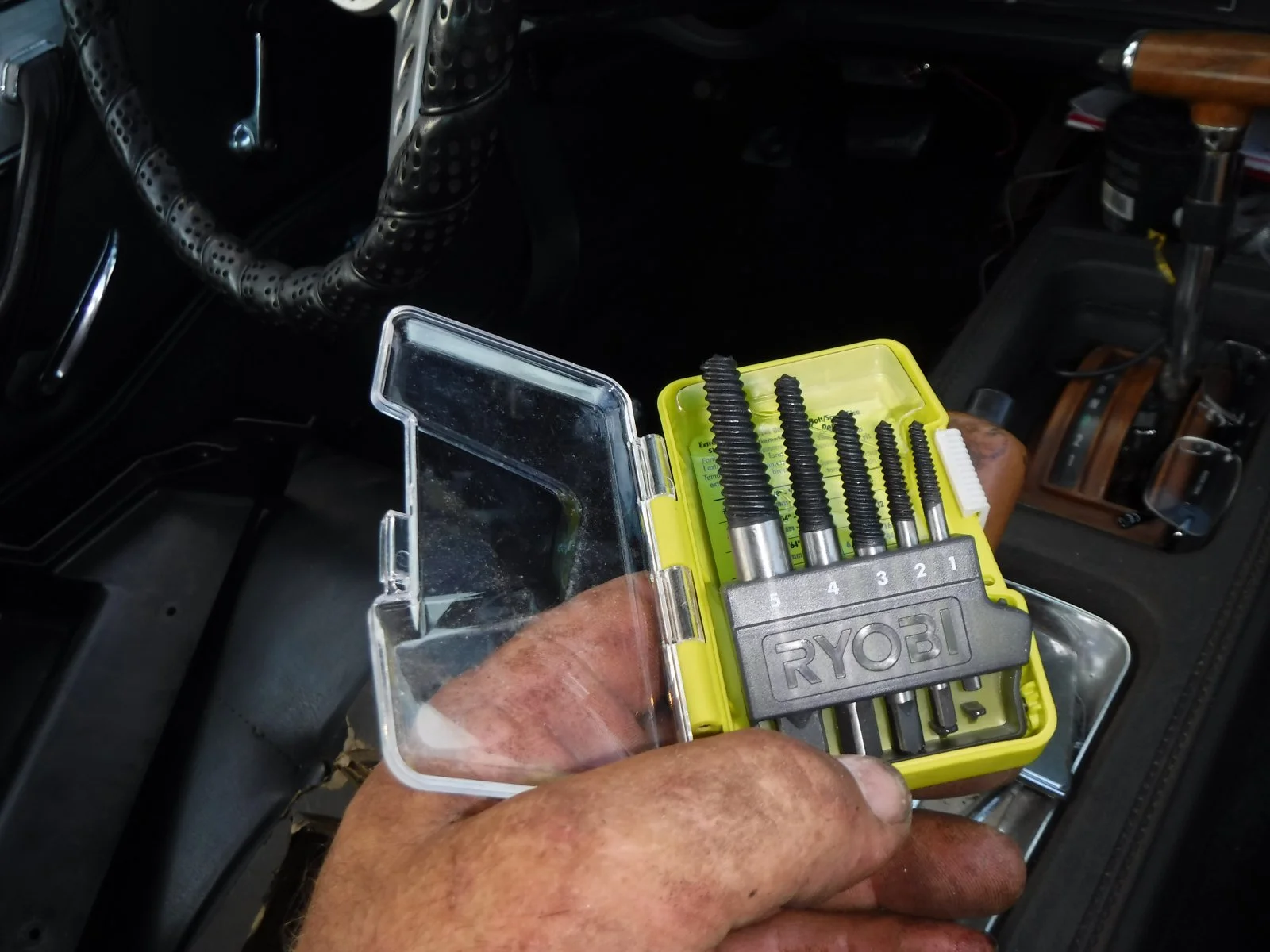

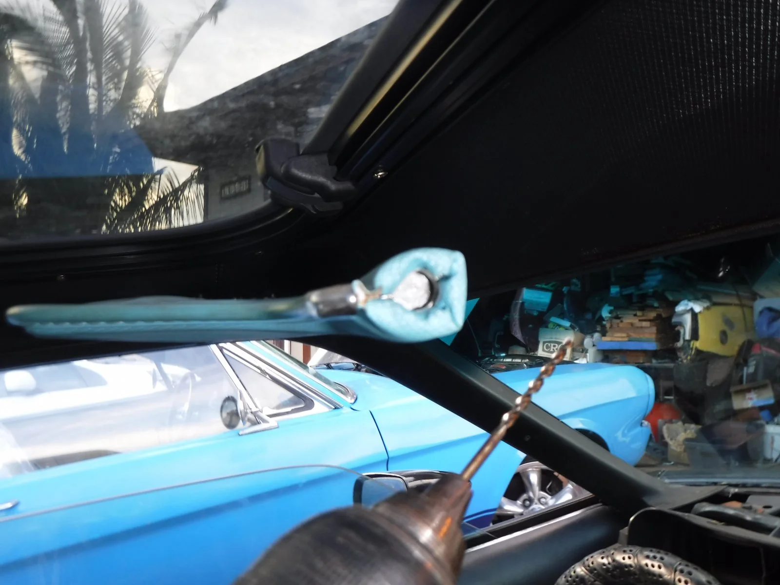

Viser sun shade new Tips

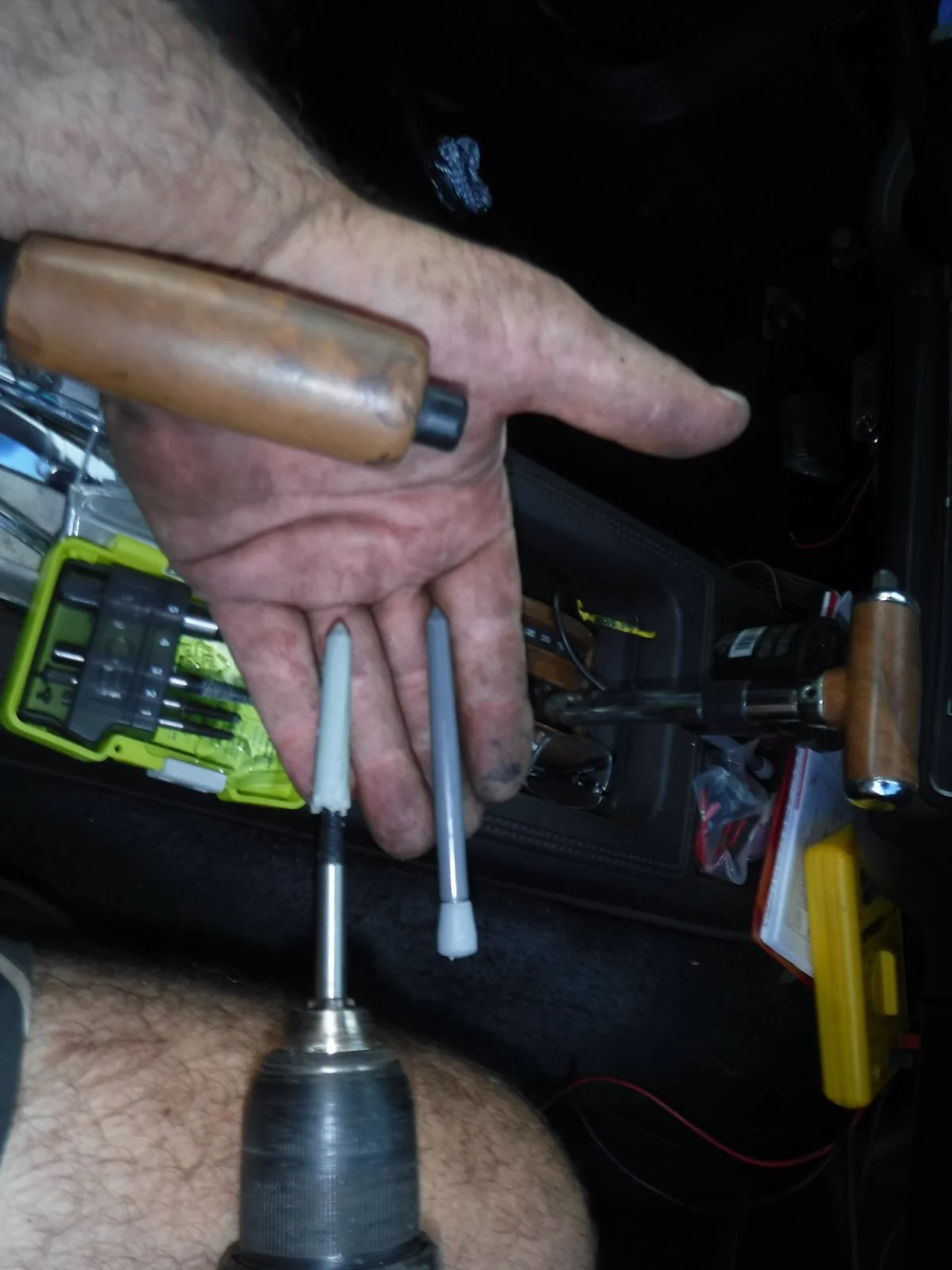

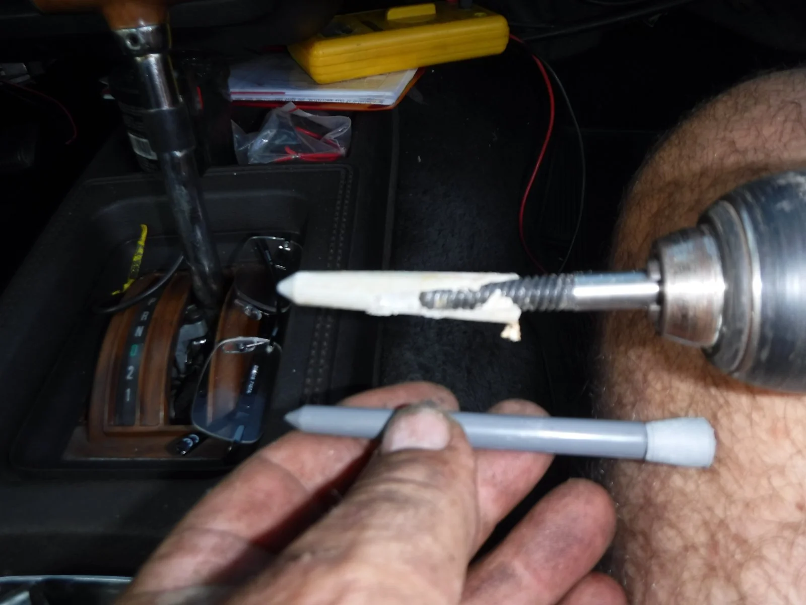

New windshield needs working visors. Tips are busted off.
My plan is to drill them and use a broken screw extractor easy out.
It All worked easy, they weren't just broke off but frozen into the visor.
Had to do both sides. New tips from Classic Reproductions.

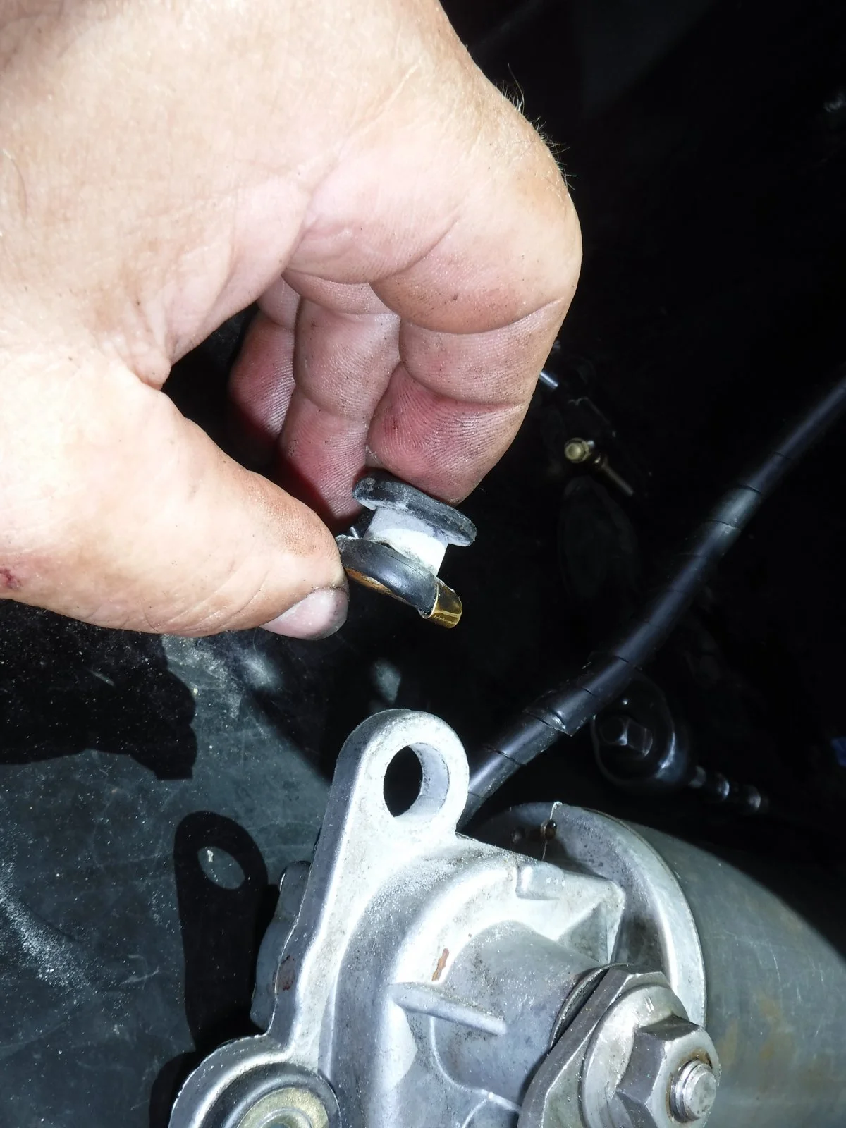

Wiper motor repair
Once again new windshield needs wipers that work. Its not asking too much right!?!

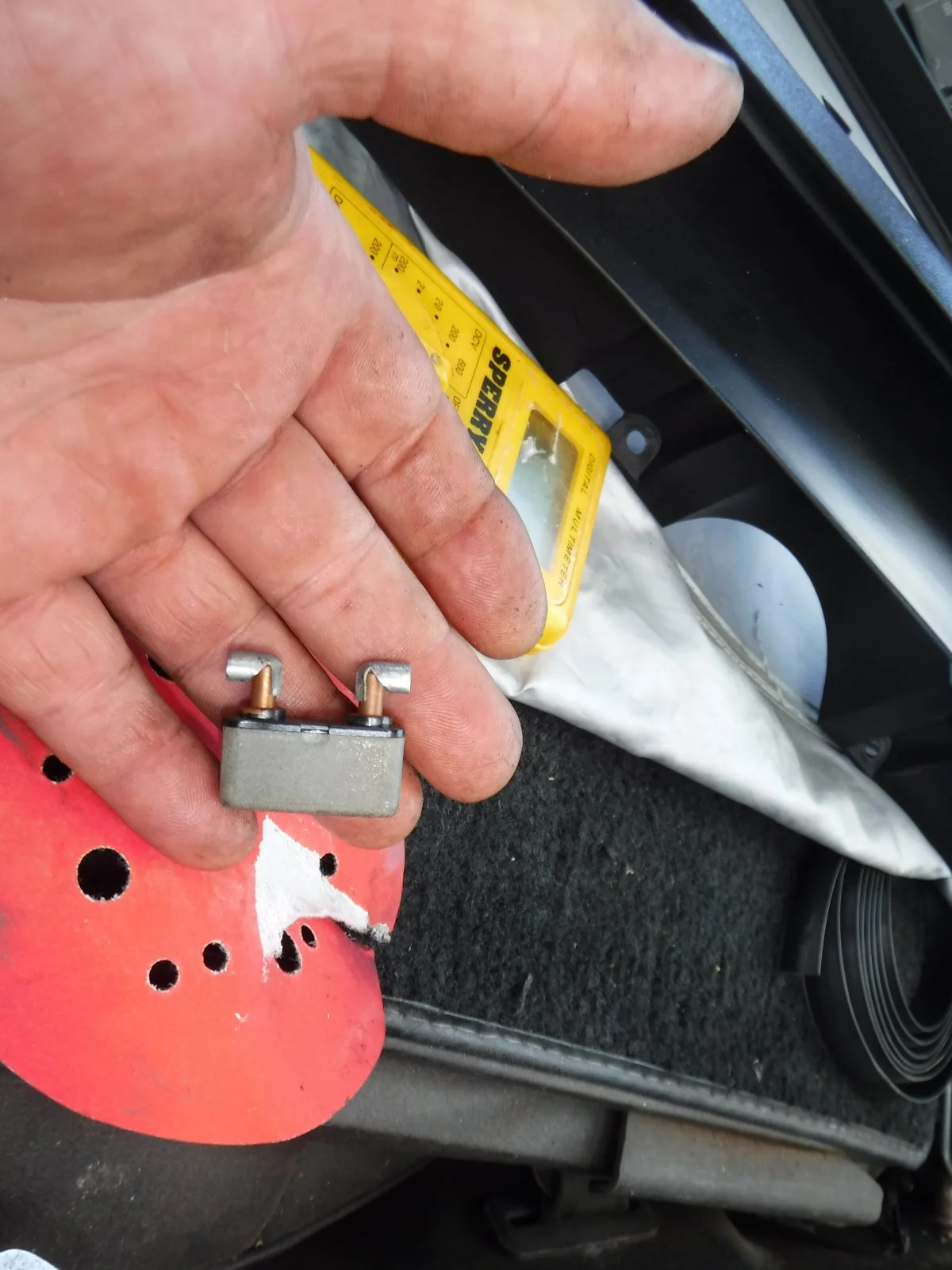

Nothing happens when you hit the switch. So check the fuses, but no fuse just this 6 amp breaker fuse thing.
Was so oxidized that the ohm meter couldn't read it through the corrosion. Sanded the prongs and then put it back and had power to the switch plug.
Still don't work
Meter won't read thru steering column wiper harness. Some dedicated clicking of switch on and off and the two speed switch came back to life on the meter reading. (yeah I got lucky).
Wiper still don't work though.

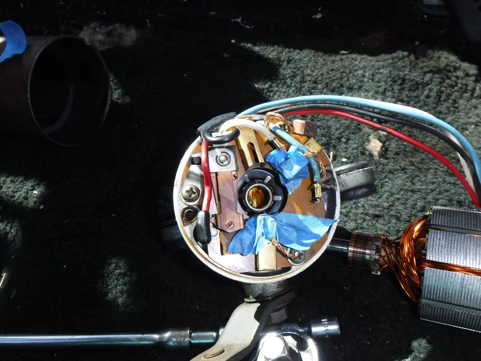

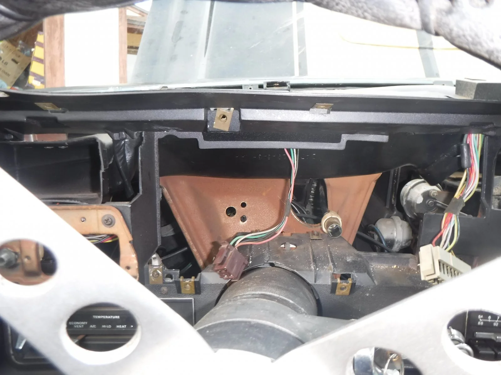

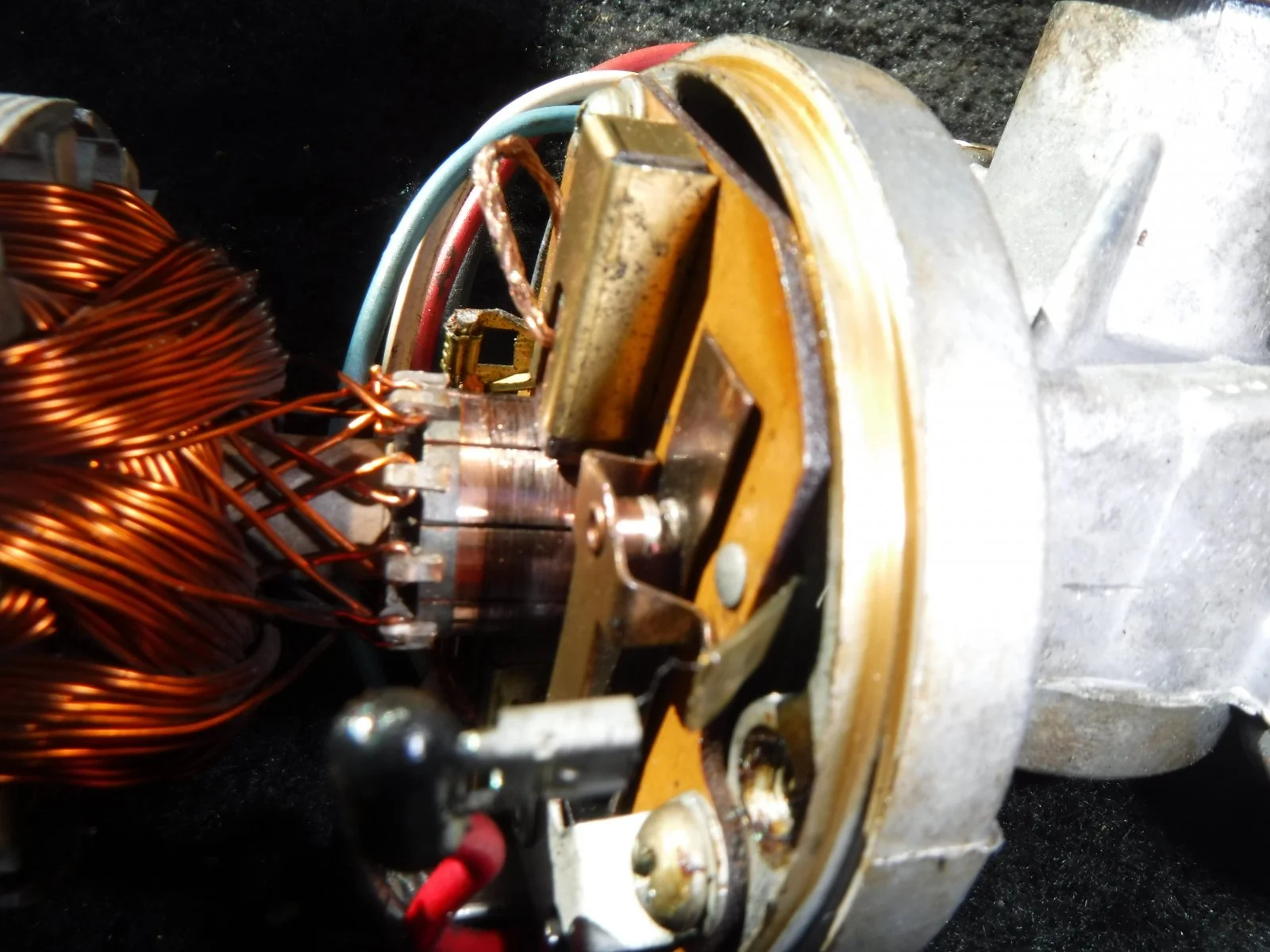

Pulled the gauge cluster but couldn't see the wiper motor. So I went from the bottom.
Pulled the drivers seat and the steering column plate and could see my objective.
Unhooked the wiper harness and tested for power to there, and after some more wiggling of the previous steering column plug
It read ok.

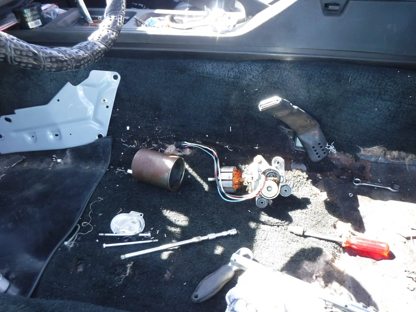

Pulled the motor out and bench tested it, nothing. So I took it apart, Had to chase the springs around. Found out trans was stuck in the old grease. Disassembled the little trans and cleaned and re-greased it. cleaned the brushes and amateur of carbon and taped the brushes back in to reassemble.
Bench test, it runs. put it back in car. test without wiper blades on and it won't park. Took it back apart and cleaned the parking points system contacts, both sides.

Put it all back together and it parks the wipers in the up position. I put the lever arm on backwards.
Fix that and it all works. Yes!
But the next morning it did not work again. took it out and it bench tests great.
Much swearing delete
Chased it down to the bolt ground contact washer thing completely caked with white powder.
cleaned all surfaces and put it all back together for the XXX time,
Now it all seems to work again at least till tomorrow.

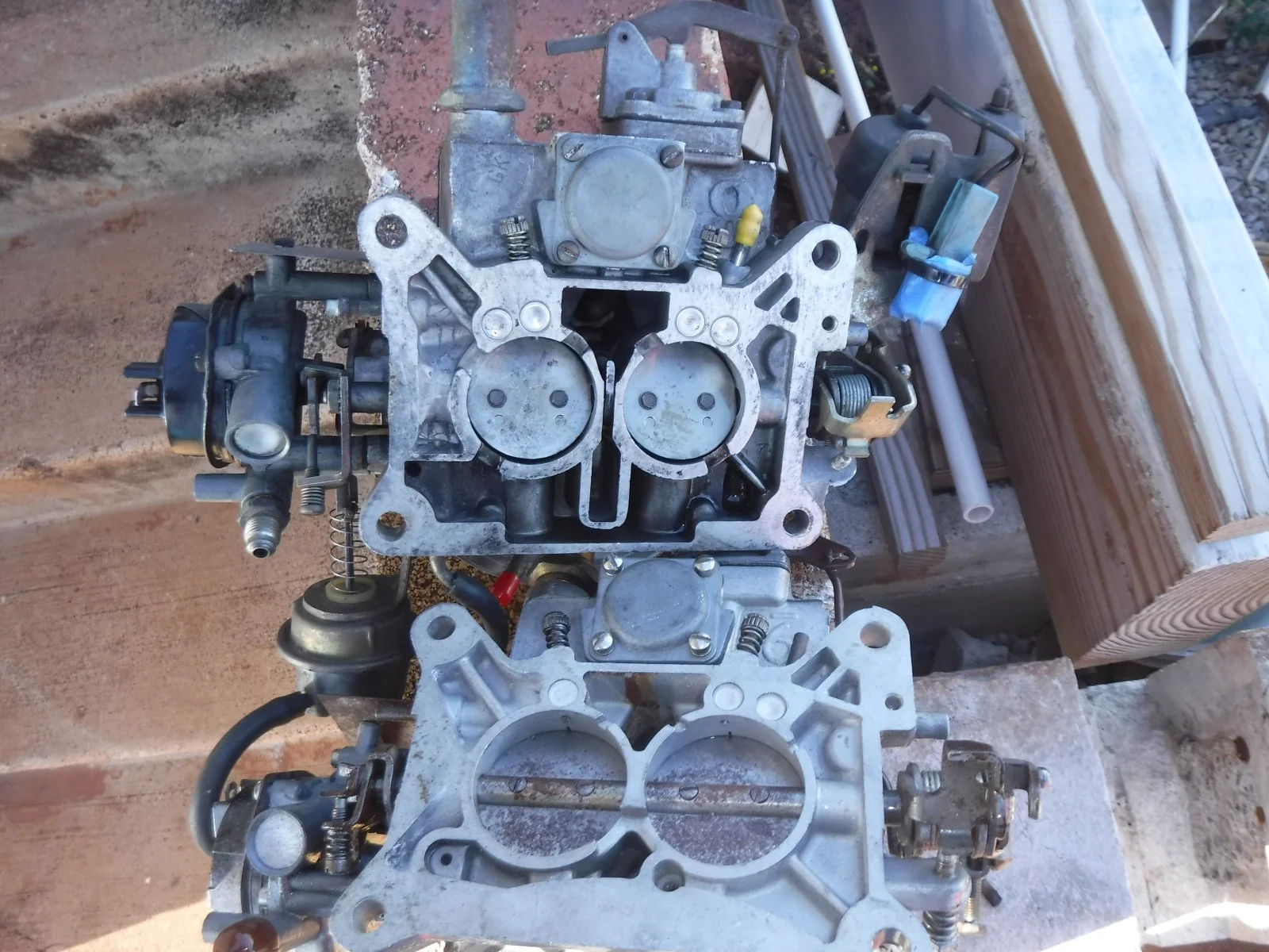

First up carb swap to a bigger two barrel. Just got to rebuild it and carb kits are scarce out here.
1.08 287-CFM vs, 1.21 356-CFM

Are the ports in the manifold big enough
Mmm, a good question. never considered it might be too big for the '66 2 barrel manifold. Carb seems to be correct for 1969 F-100 390ci.
Should just quit messing around and get a real carb/ manifold for her.

I guess 2barrel and 4barrel aren't measured the same.
Time for boring technical stuff.
.............Coutesy of "The French Town Flyer" from the FORDSIX.com website...................
Remember that four barrels are flowed at 1.5 "hg. So these flow numbers do not equate to 4V flow. To convert divide by 1.41.
So, for example, a 190 2V would be equivalent to a 135 4V.
A tri-power using 3 of these 190s equals a 404 cfm four barrel.
This means the largest MC2100/2150, the 1.33 (at 424 CFM) is equal to a 598 CFM four barrel. I can't quite get my mind around this. Maybe someday I'll understand.
............................Courtesy of RGuest3 on CJ-8.com.......................................
Here is what I found, and I am quoting here.
"Sometime during the 1950’s, engineers found that a passenger engine with a four-barrel carburetor would not maintain a vacuum of 3 inches of mercury at wide-open throttle; and by some convention 1 ½ inches of mercury was chosen for rating 4-barrel carburetors. The ratings for 1-barrel and 2-barrel carburetors were left unchanged.
To convert from one system to another (with a very small percentage of error) is relatively simple. Simply use the square root of 2 (1.414).
Thus to convert a two-barrel rating into a four-barrel rating, divide the two-barrel rating by 1.414.
To convert the four-barrel rating to a two-barrel rating, multiply the four-barrel rating by 1.414."
By using this method described above, here are some comparisons:
2V cfm < Equivalent Flow > 4V cfm
* ( Flows Like )
MC2100 - 1.08 Venturi 287 < / > 203
MC2150 - 1.21 Venturi 351 < / > 248
Holley 2300 - 2 Barrel 500 < / > 354
Holley 390 - 4 Barrel 551 < / > 390
Holley 470 - 4 Barrel 665 < / > 470
You get the idea. Plug your carb into the equation and see the difference.
Summary --- I'm trying to switch from a 200cfm to a 250cfm when talking in 4v talk. Might be wasting my time barking up this tree.
