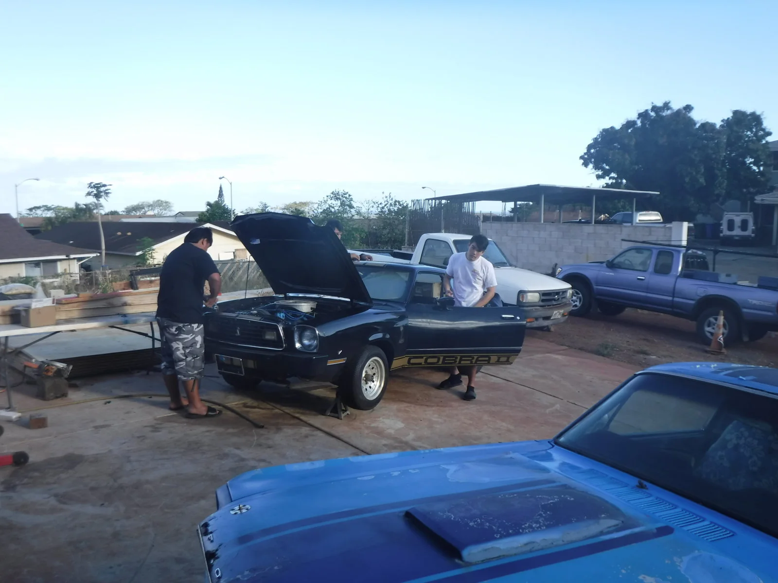

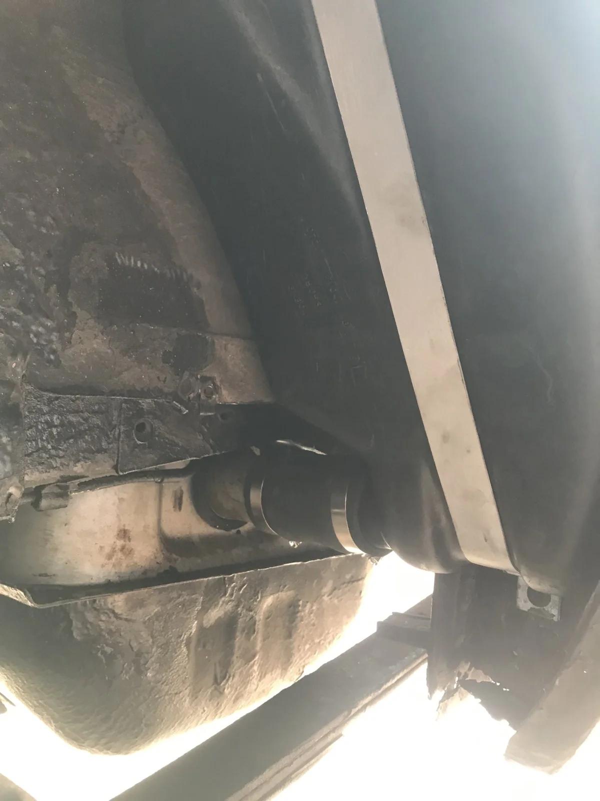

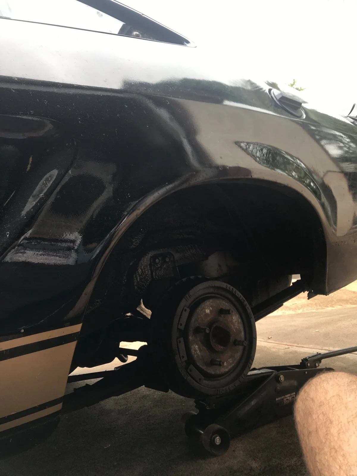

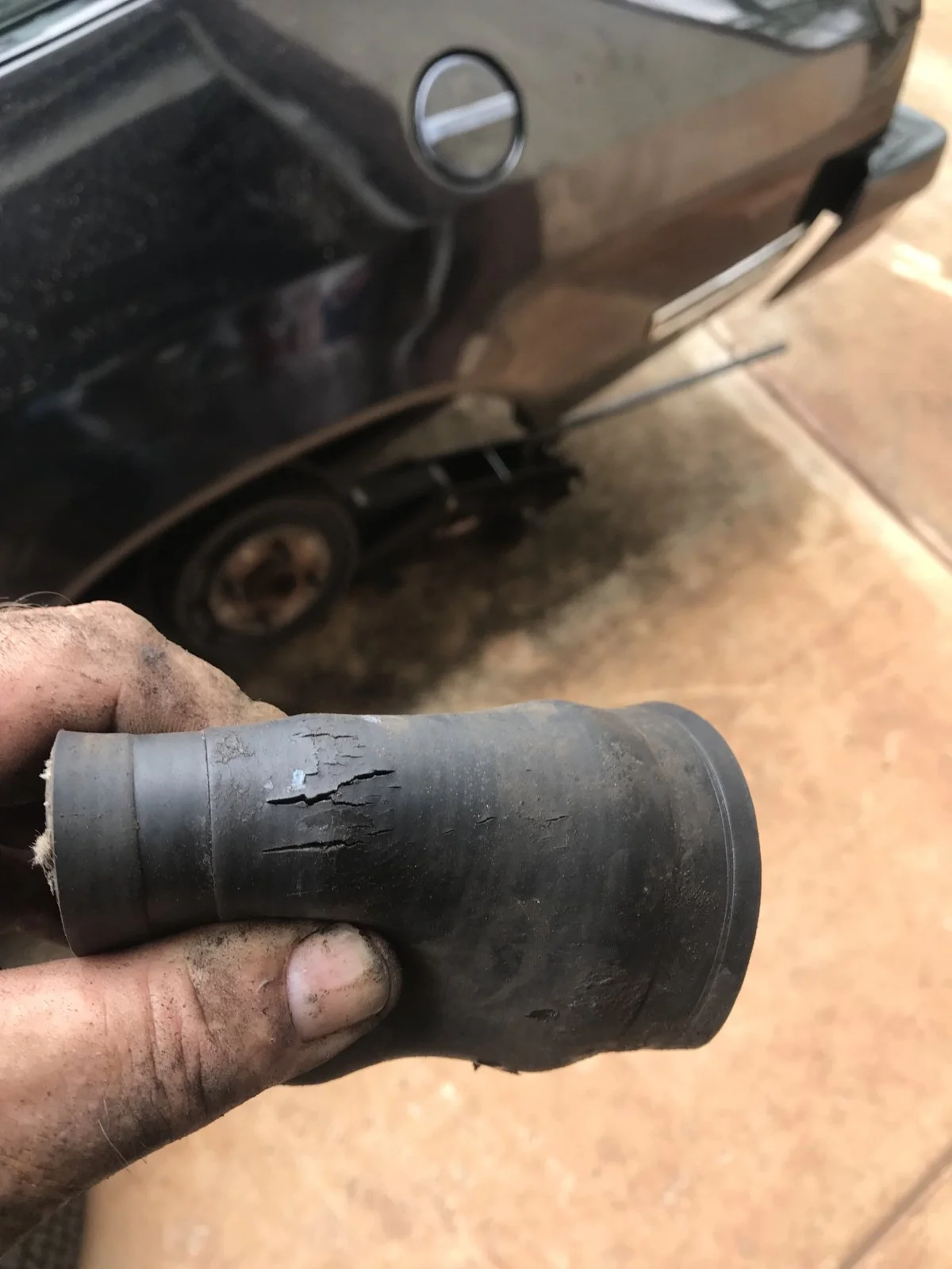

Fuel system has a leak, so jack it up and pulled the inner fenderwell.

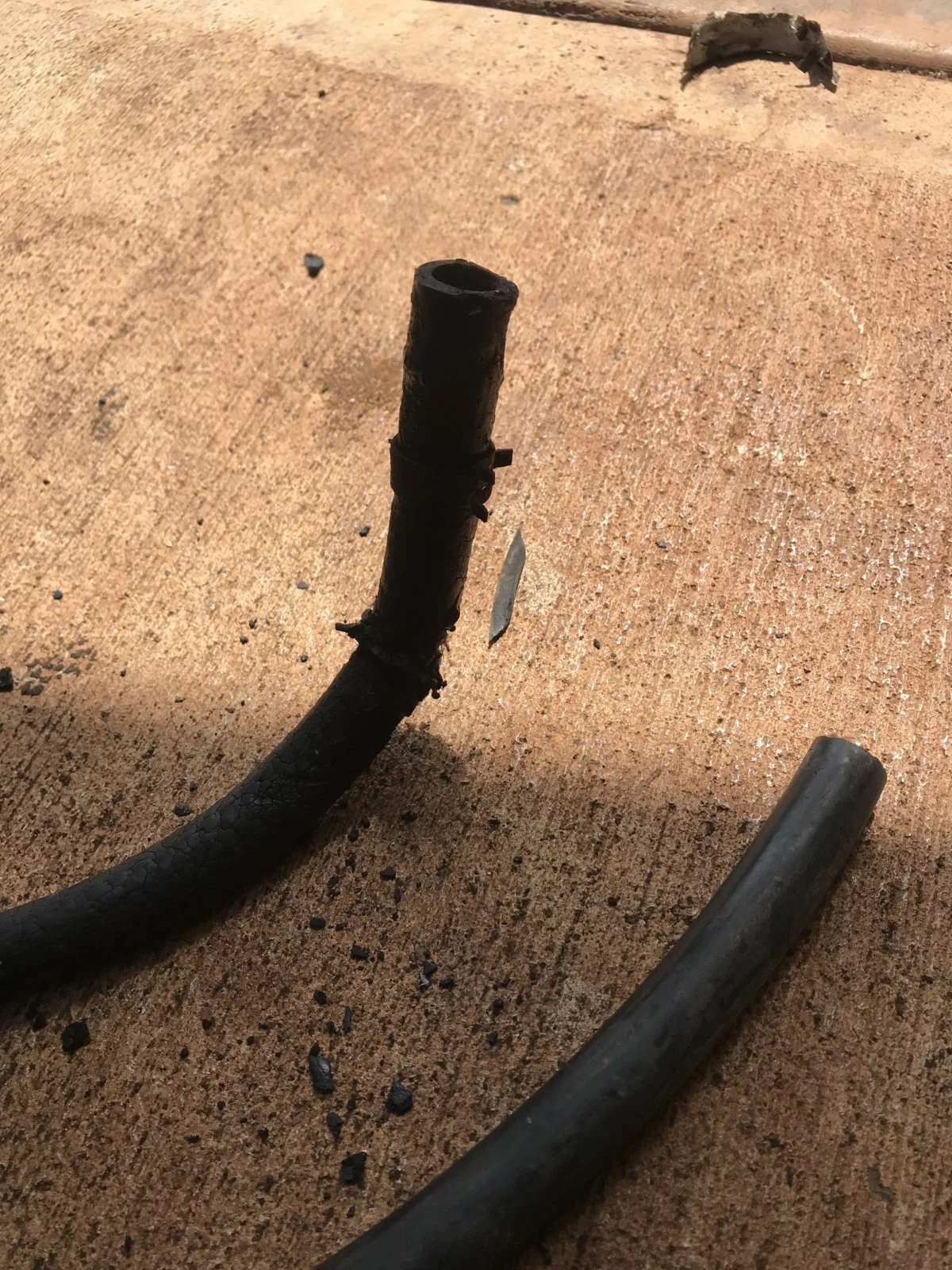

Pulled this hose and its cracked.

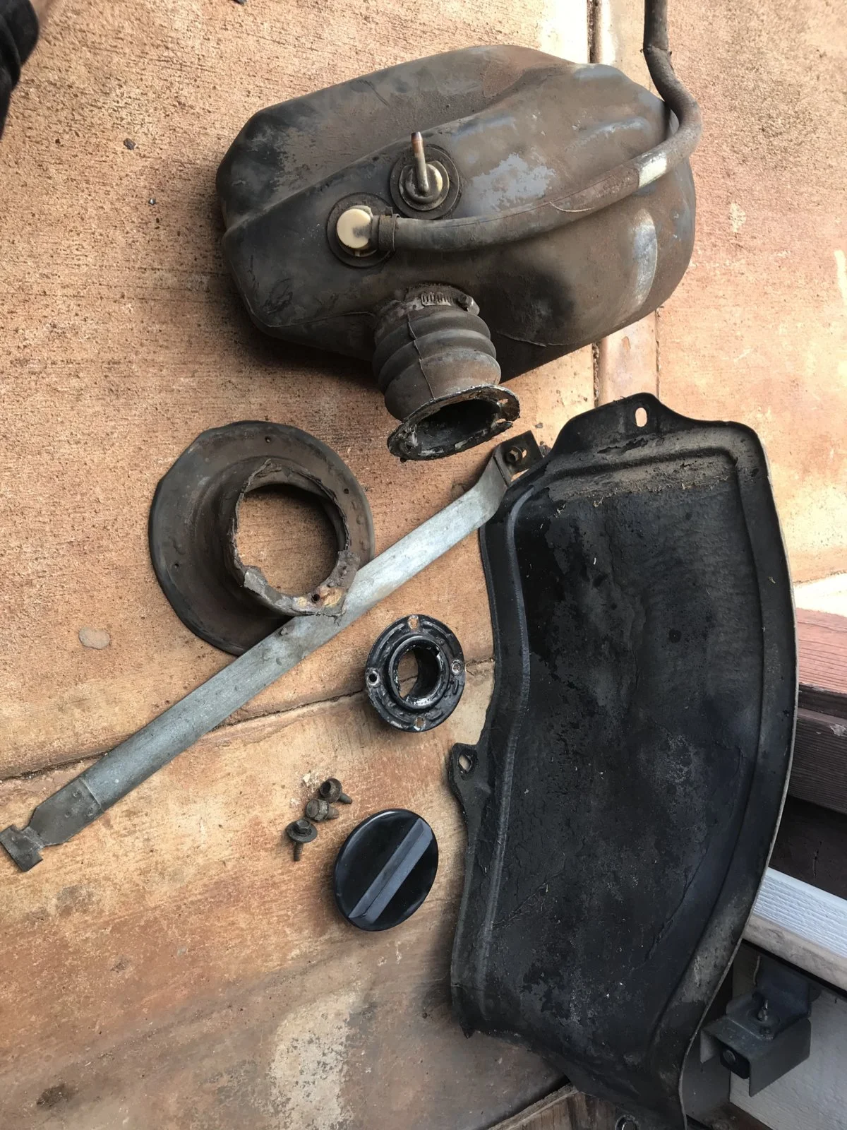

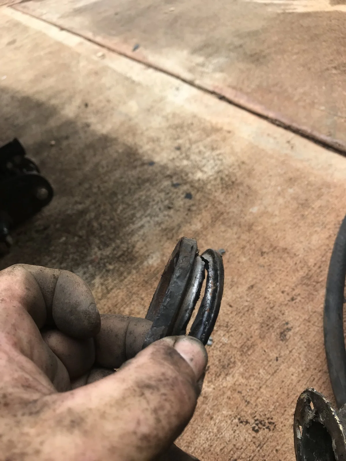

Pulled the rest for inspection and the seal into gas tank is also cracked
No wonder when i filled it the first 3 gals leaked on the ground.
Please nobody smoke right now that includes you vape pen guys
Don't want a cobra II flambé

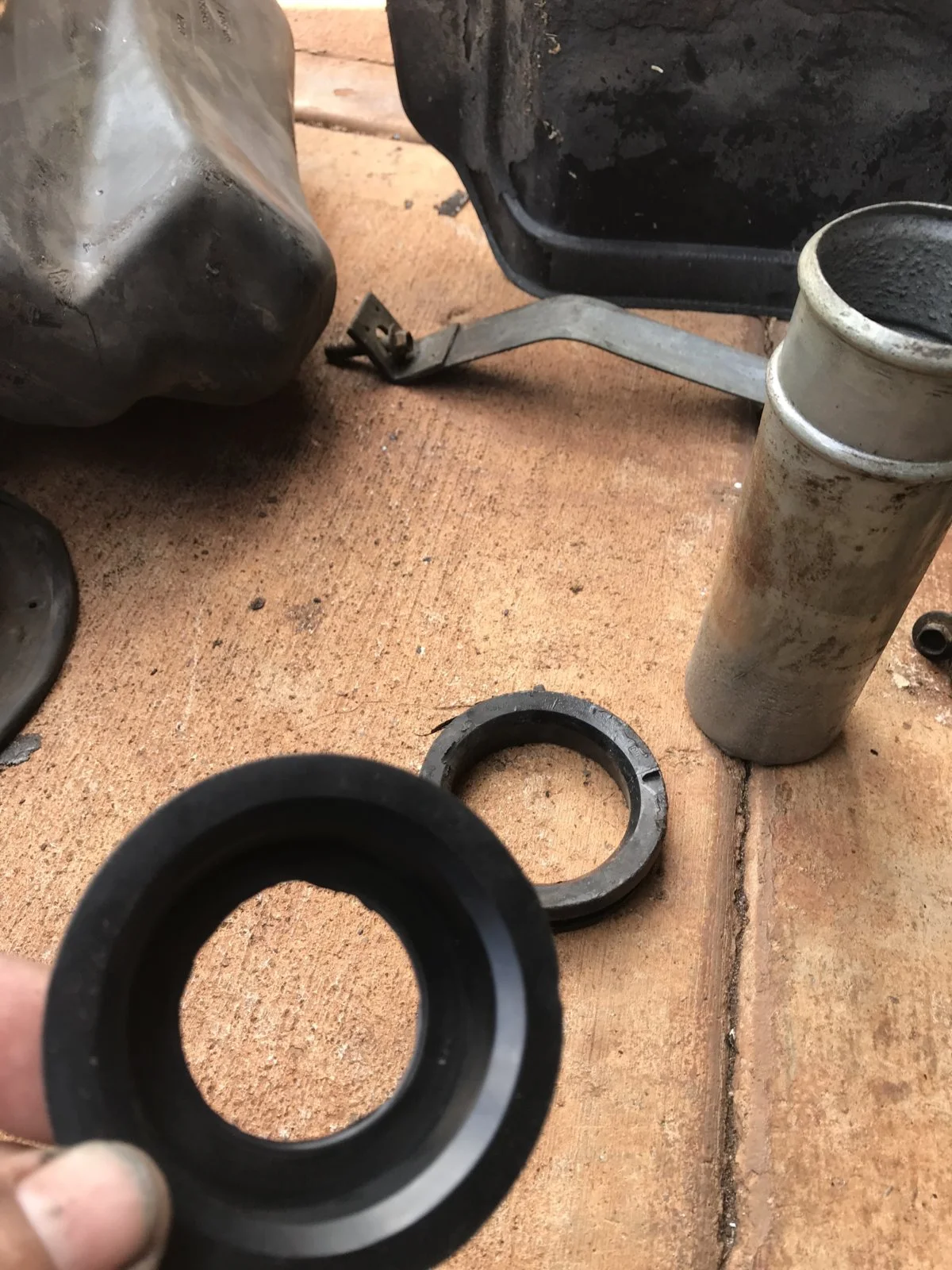

I got a new tank filler seal (Classic Auto Reproductions).
A quick peek in the tank with the headlight and it looks good for 45 yrs old tank.(note brass float)
I did the Por15 tank seal kit 10 yr ago
Both Vent hoses are crumbling too. So put new ones.
Auto parts guy sold me a piece of 2.25 inch Inside diameter hose by the foot for filler connection.
Spot welded the old capture nut back on for accessory tank strap.
And I think most this corners problems are solved. Don't be looking at the rusty quarter panel corner though.
