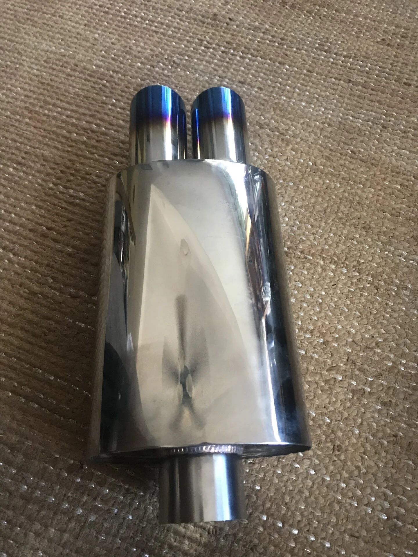

Back to exhaust.

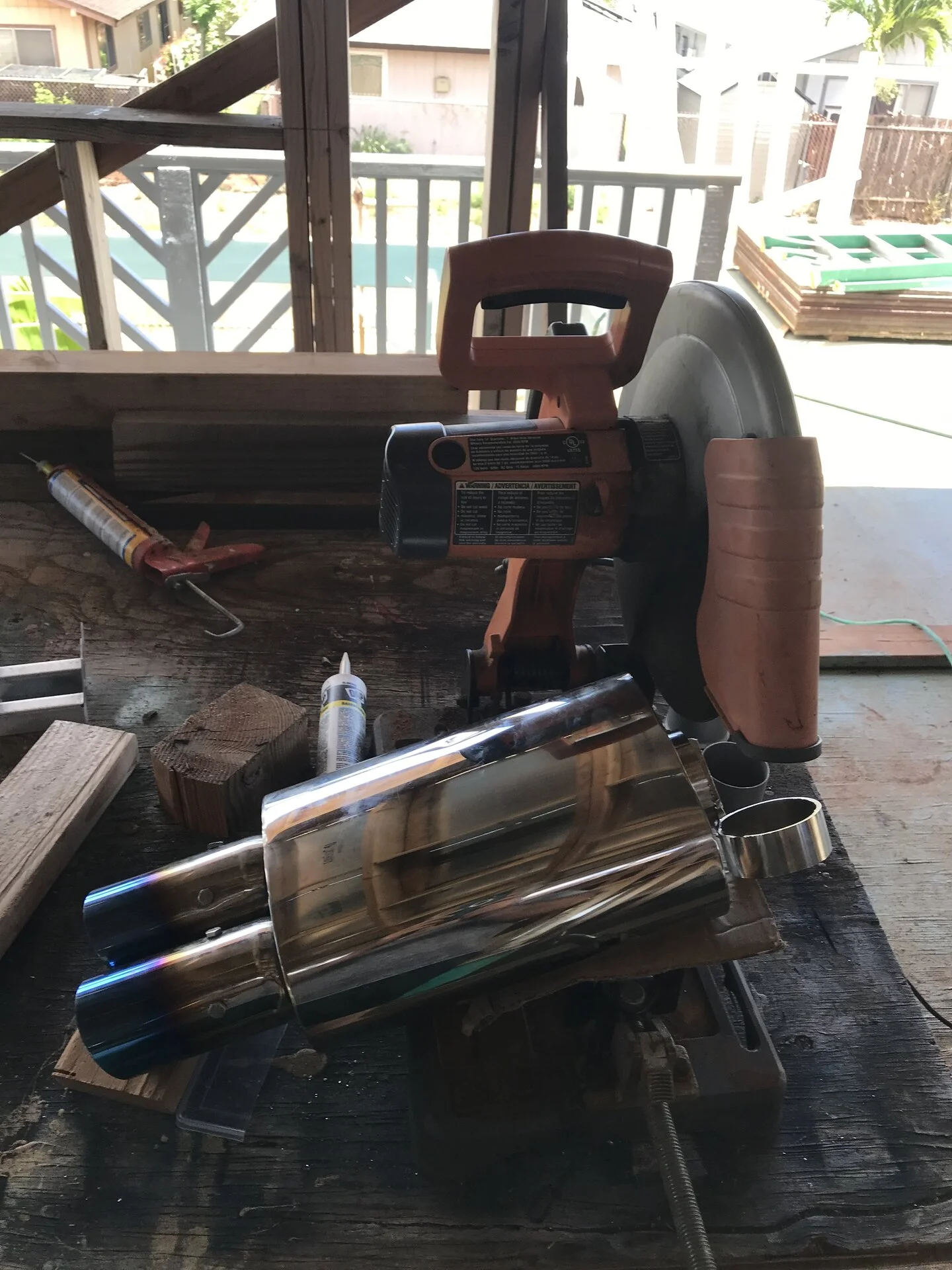

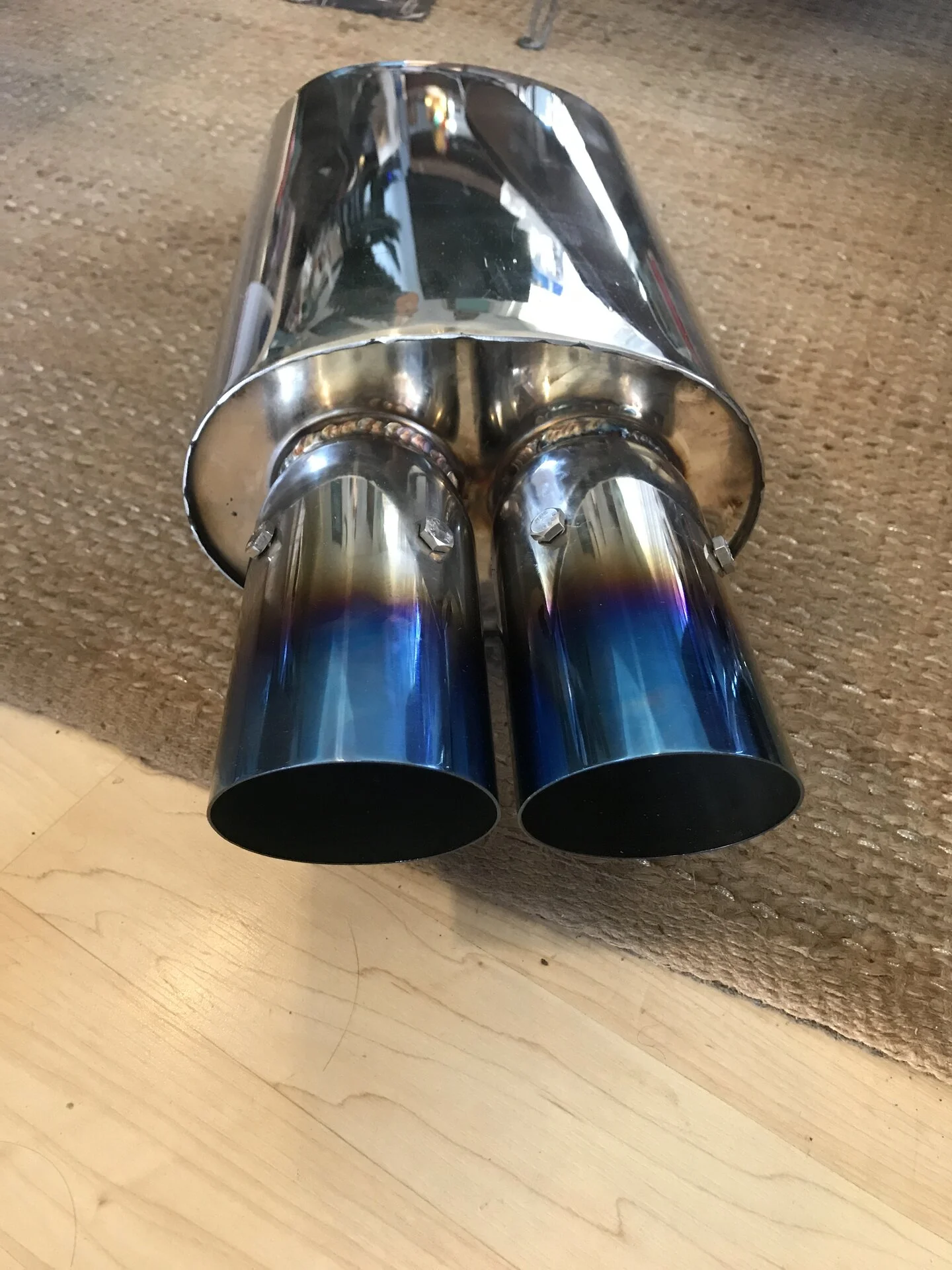

This sure is a cute little muffler for being so cheap.
I hope It doesn't just rust into nothingness or self destruct instantly. for the price IT might and you couldn't be that surprised.

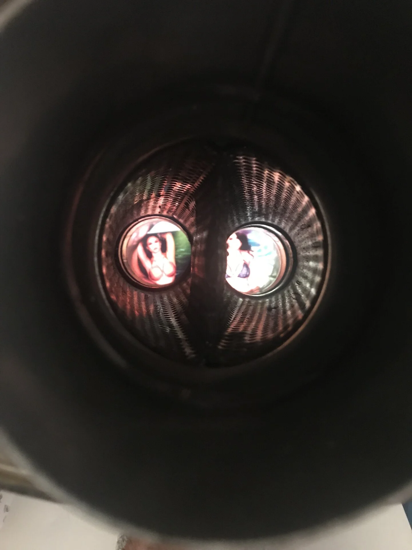

A quick peek inside.
Not much inside. Its mesh and muffling material are very thin. Makes Cherry bombs look fluffy inside.
Alrighty then, looking better already! This is what the exhaust sees, thats why it improves the flow.

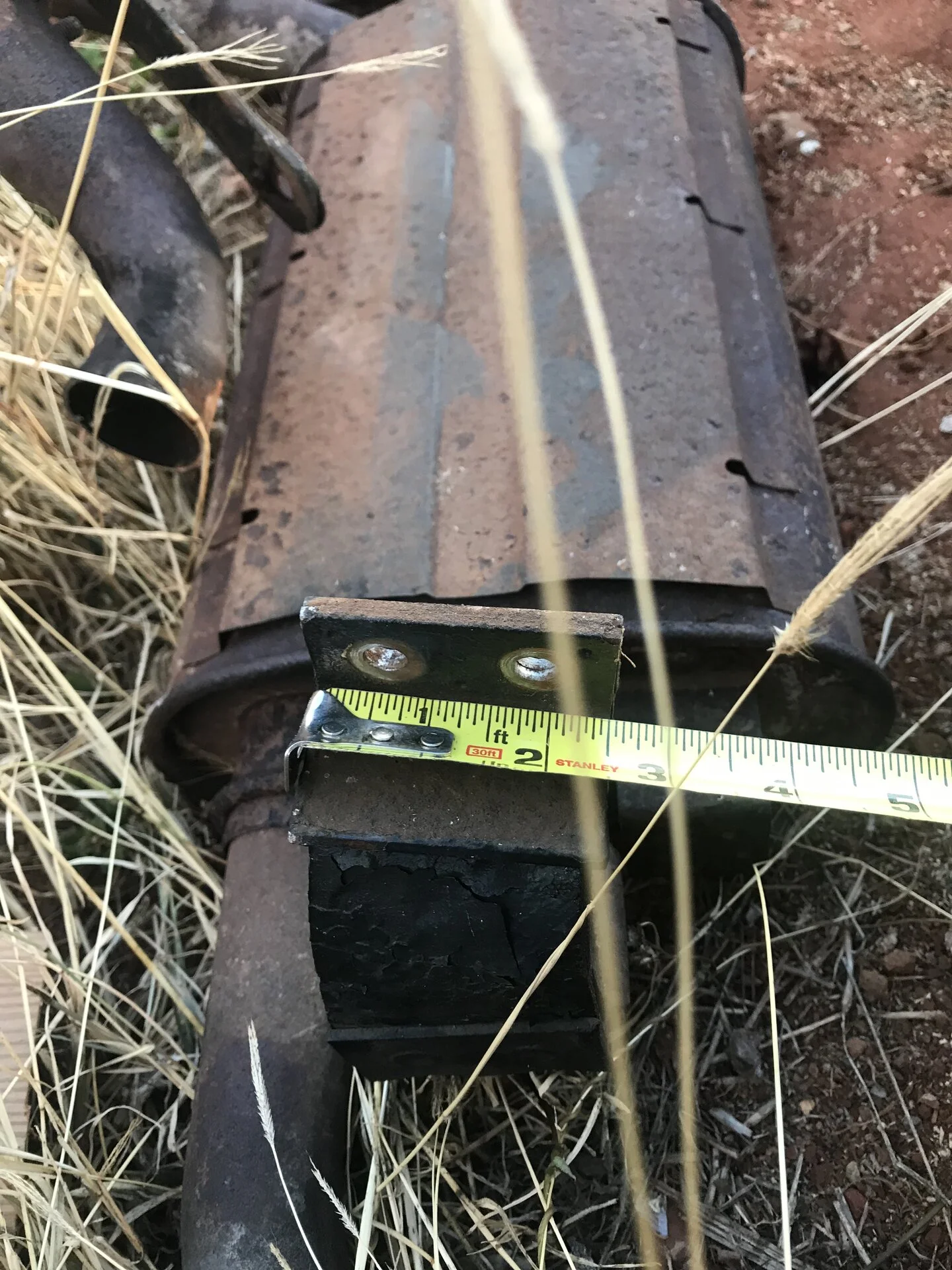

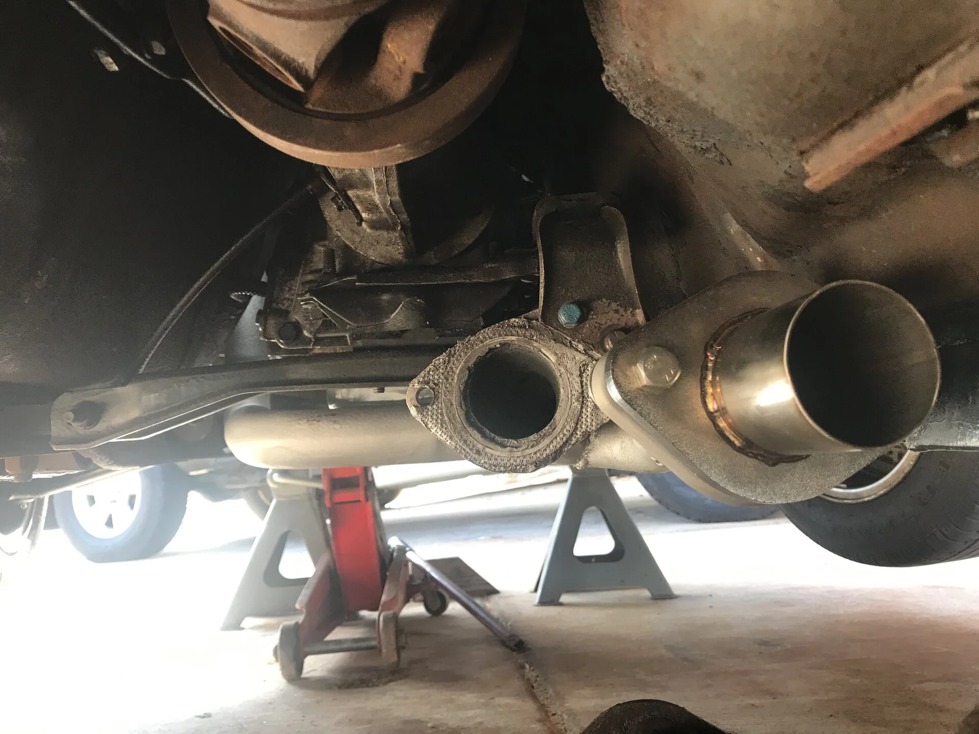

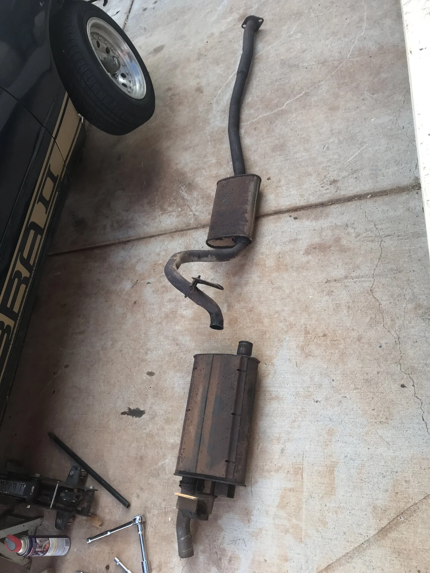

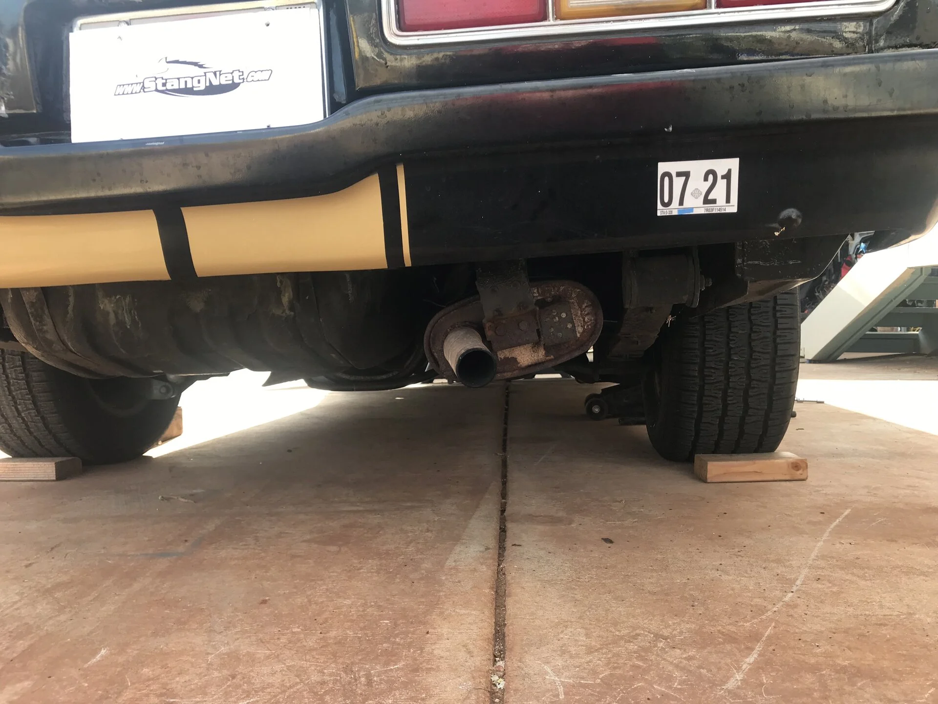

Last look old one. Inch and 7/16 tail pipe courtesy of Midas. I think that muffler was for V6 or I4, just seems so small for V8
Its hard to see cuze its so small+cute. (not a CT)
With a couple of bolts removed and a sawz-all cut.
Midas muffler and stock catalytic converter?

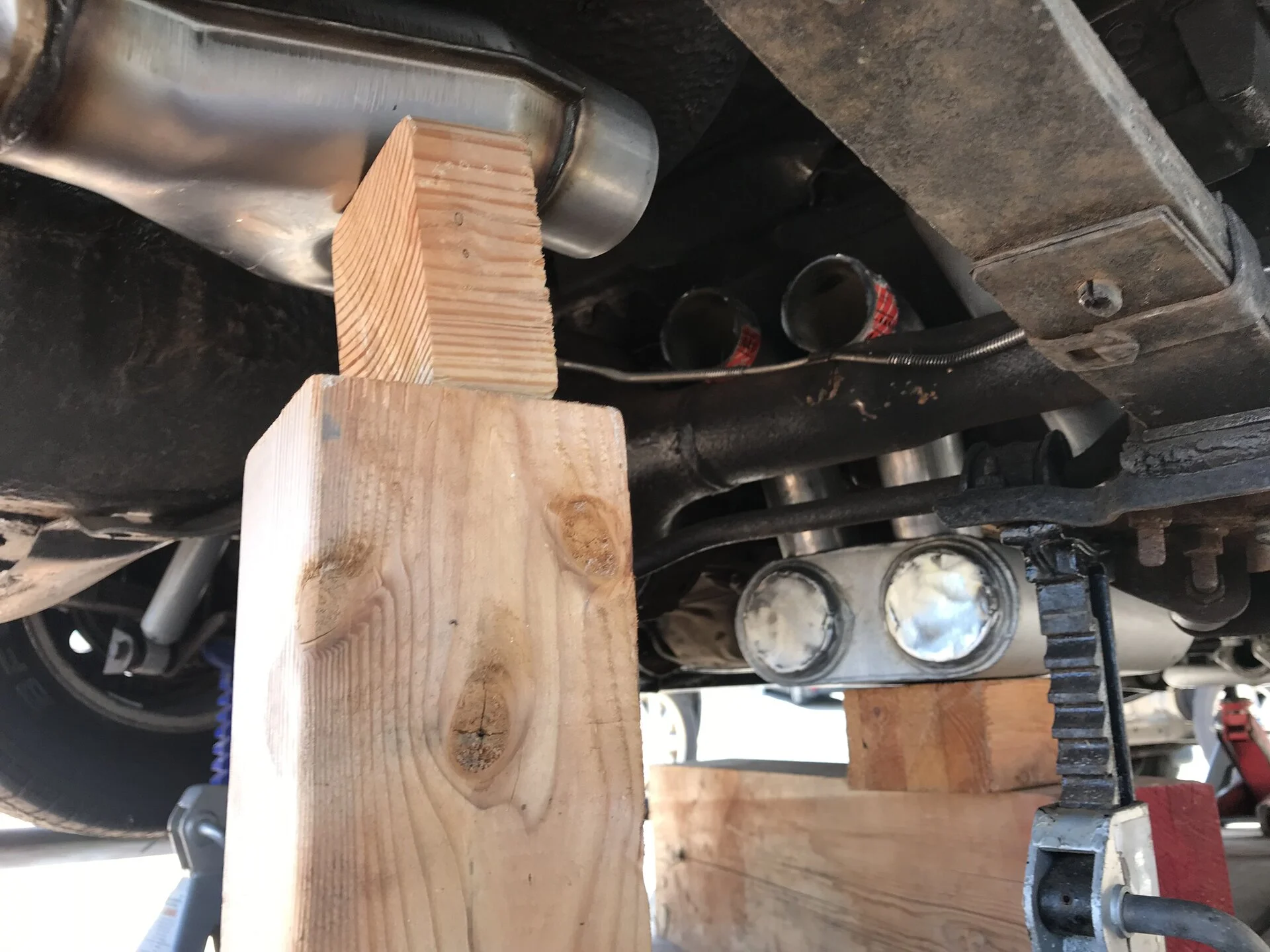

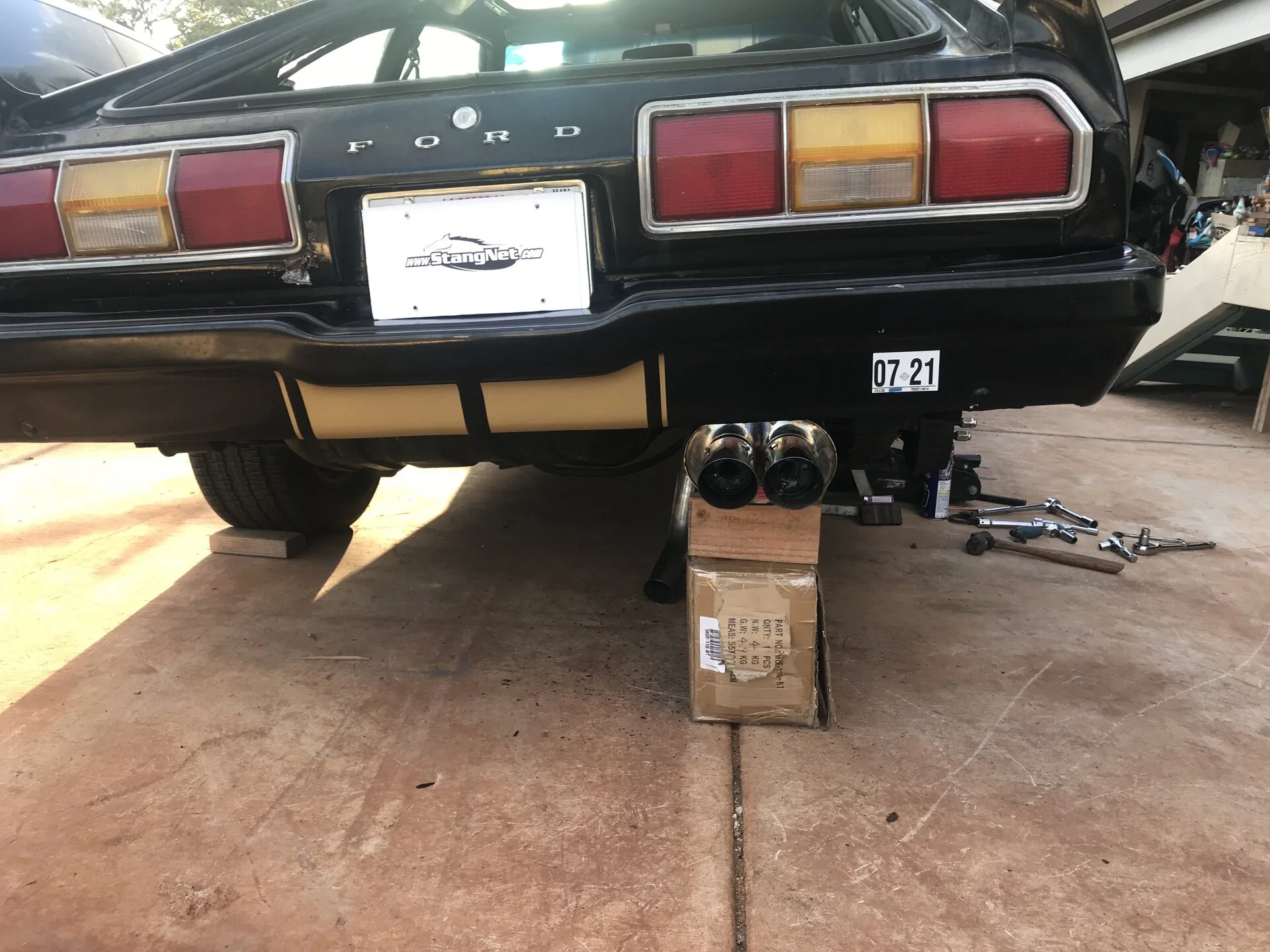

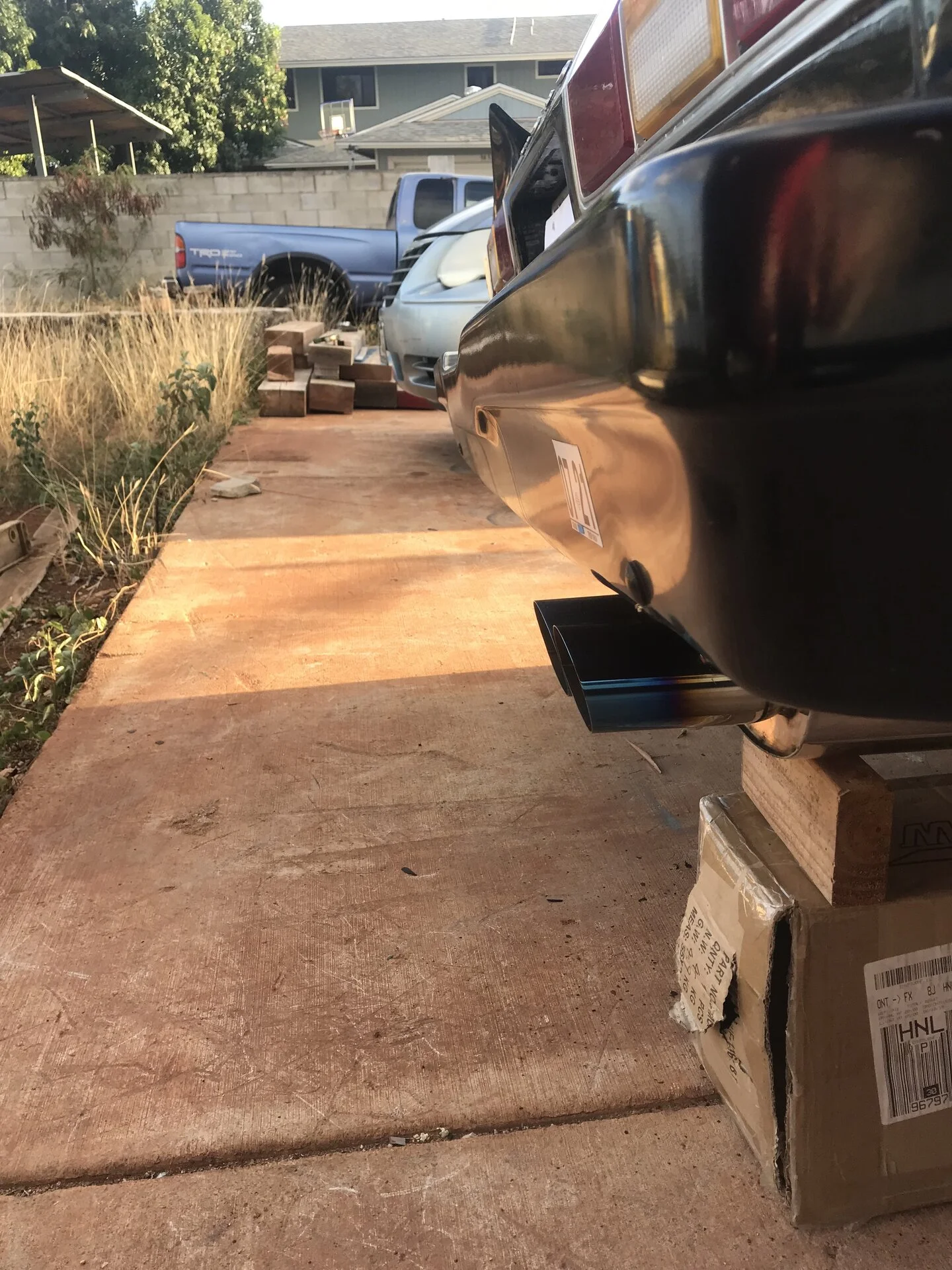

On to the shaky box and block of wood mock up. Don't like when they stick out too far but don't like lots of exhaust grunge on the bumper either.
How far out do you like it?

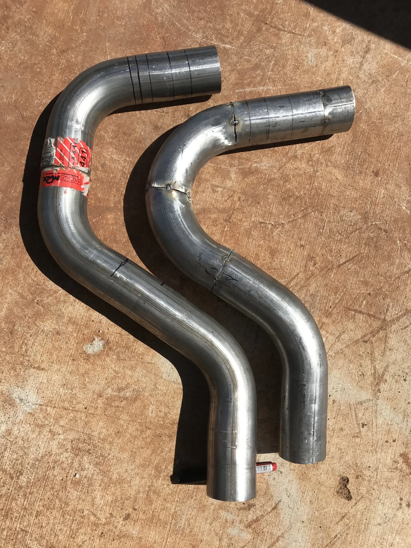

Well... I know where the rear muffler goes and got the x pipe in , but everything in-between needs to be folded spindled and mutilated to even kinda fit.
Maybe if I cut each part in thirds and throw the middle third away....
Been spending time holding parts up looking at them trying to imagine how to shorten them.:scratch:

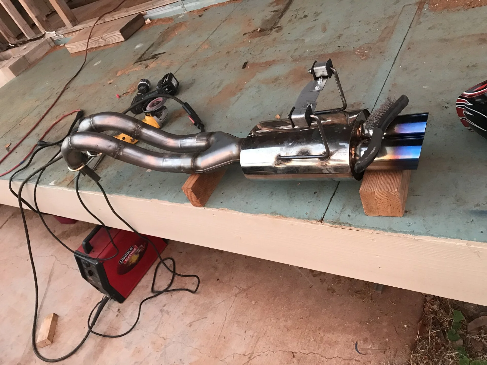

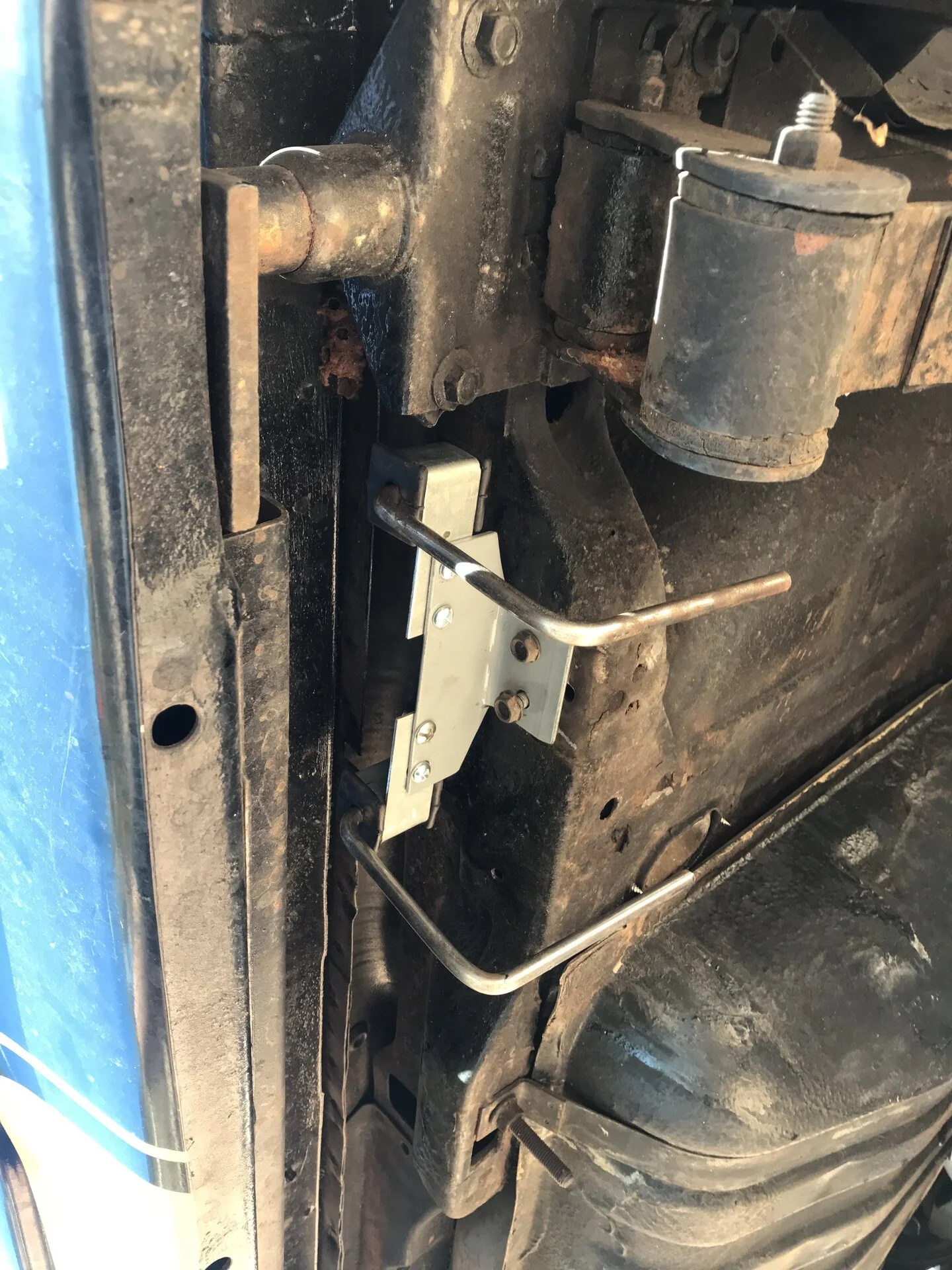

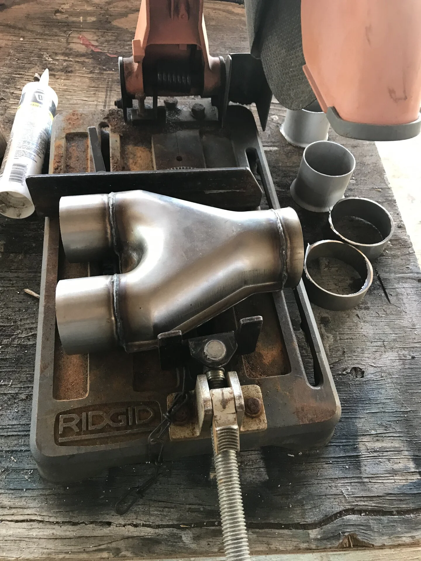

Took a mesurement.
Made a bracket that bolts to stock location with stock bolts. Sorry Sideways.:eek:
Hack this off for an extra inch and a half of shortening.
Chop this off for another little bit.
.....Tac it all together.
............Then in the car.

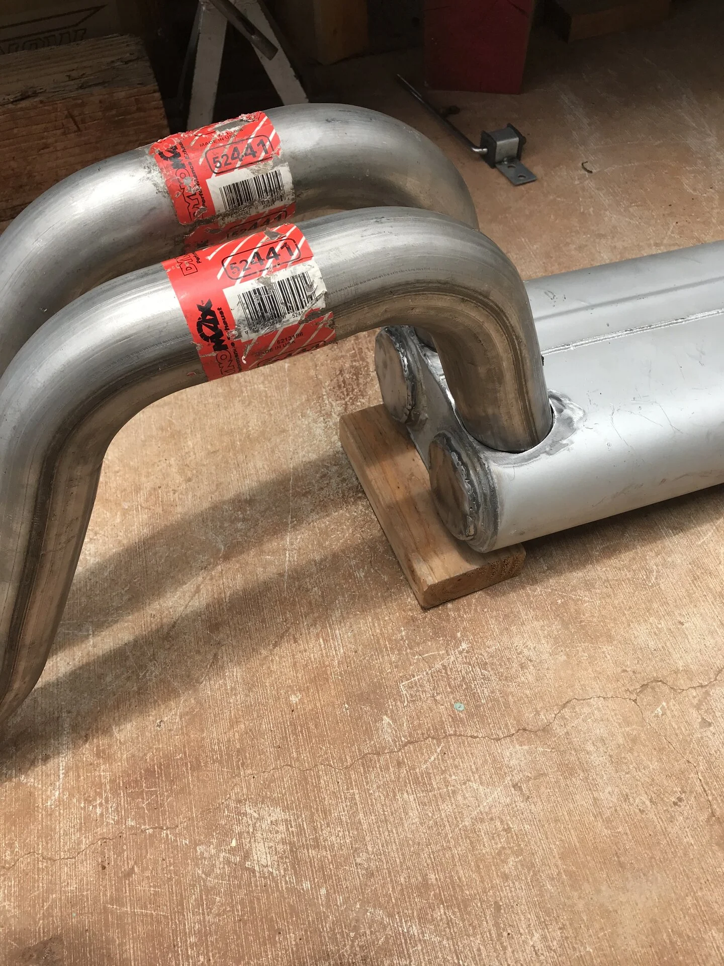

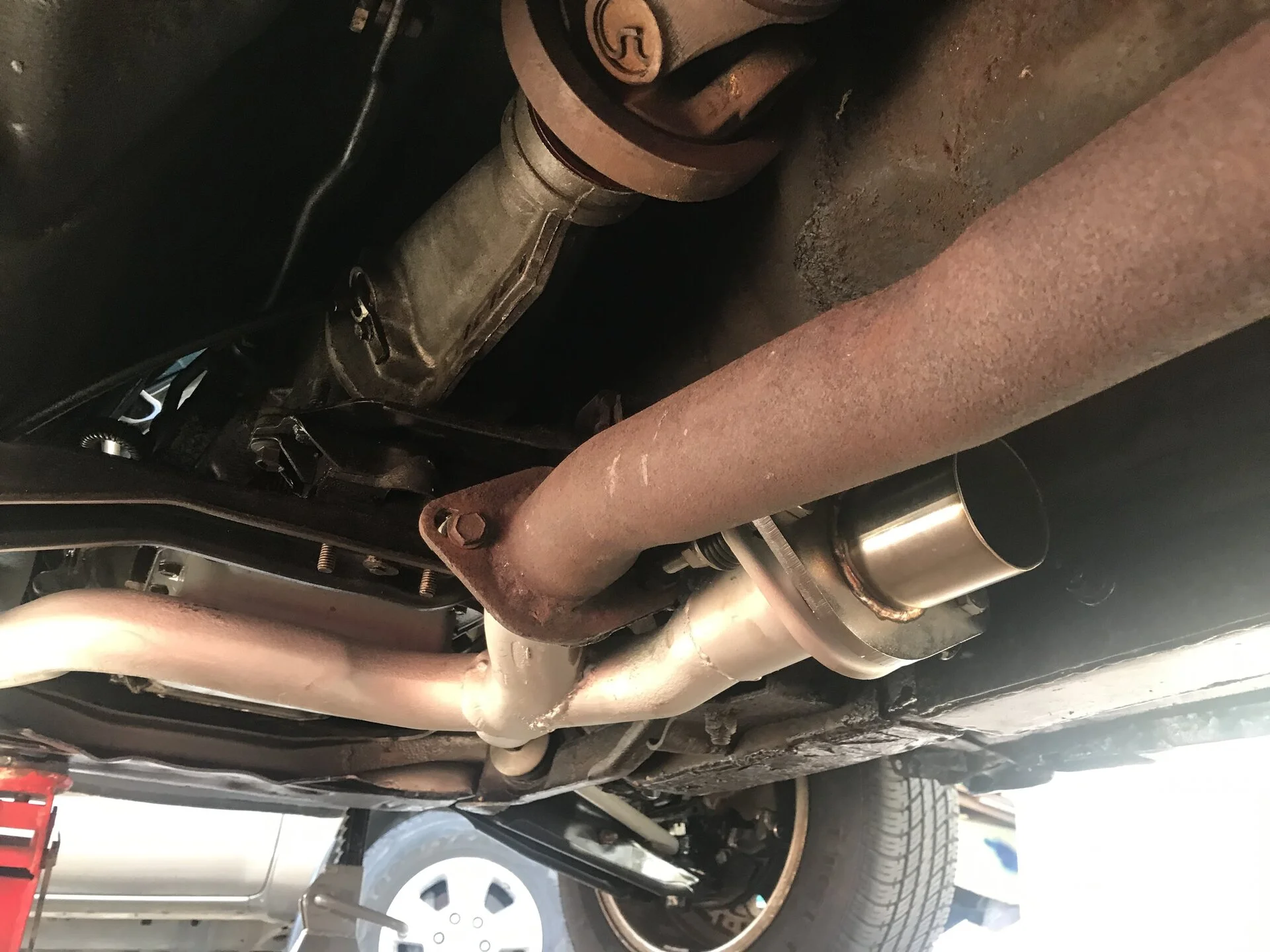

Next muffler location.

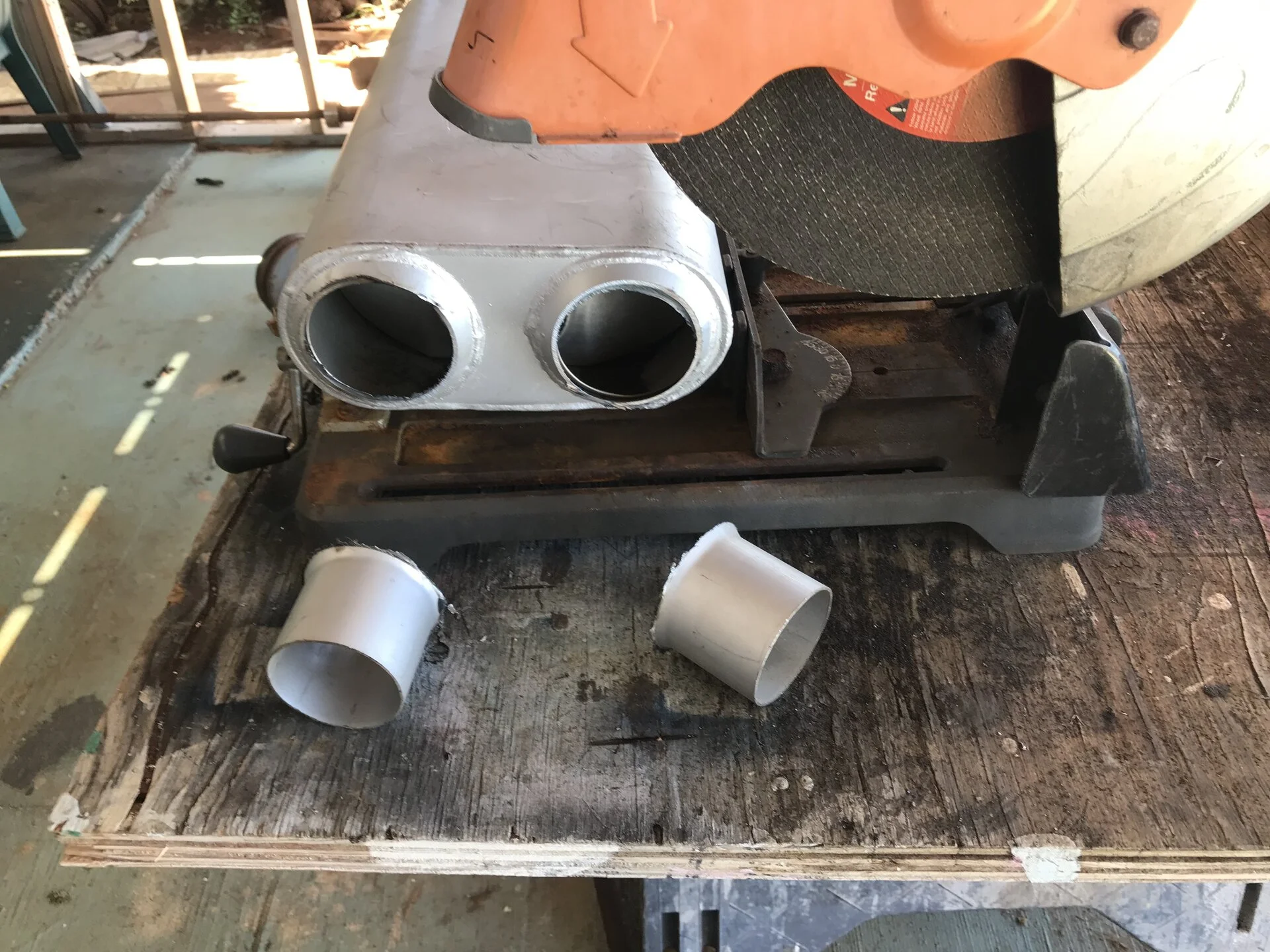

To get muffler back as far as possible,
I bobbed the ends off, welded em up, and hole sawed the top.
That was good for 5 maybe 6 more inches.
Might only count as a two chamber muffler now, LOL.
Then mocked em up in the Cobra on a block of wood.
Then got after shrinking and Lengthing these over axle pipes.
Comparison shot.
Hack and Chop an Hack Chop Hack Chop
After making and tacking both these the son came home and he proceeded to weld em up.
Yup he spent some quality time with the welder. Thats the good stuff.
I am sparing you the picture of my son in all his safety gear - welding. (you know shorts, slippers, welding helmet)

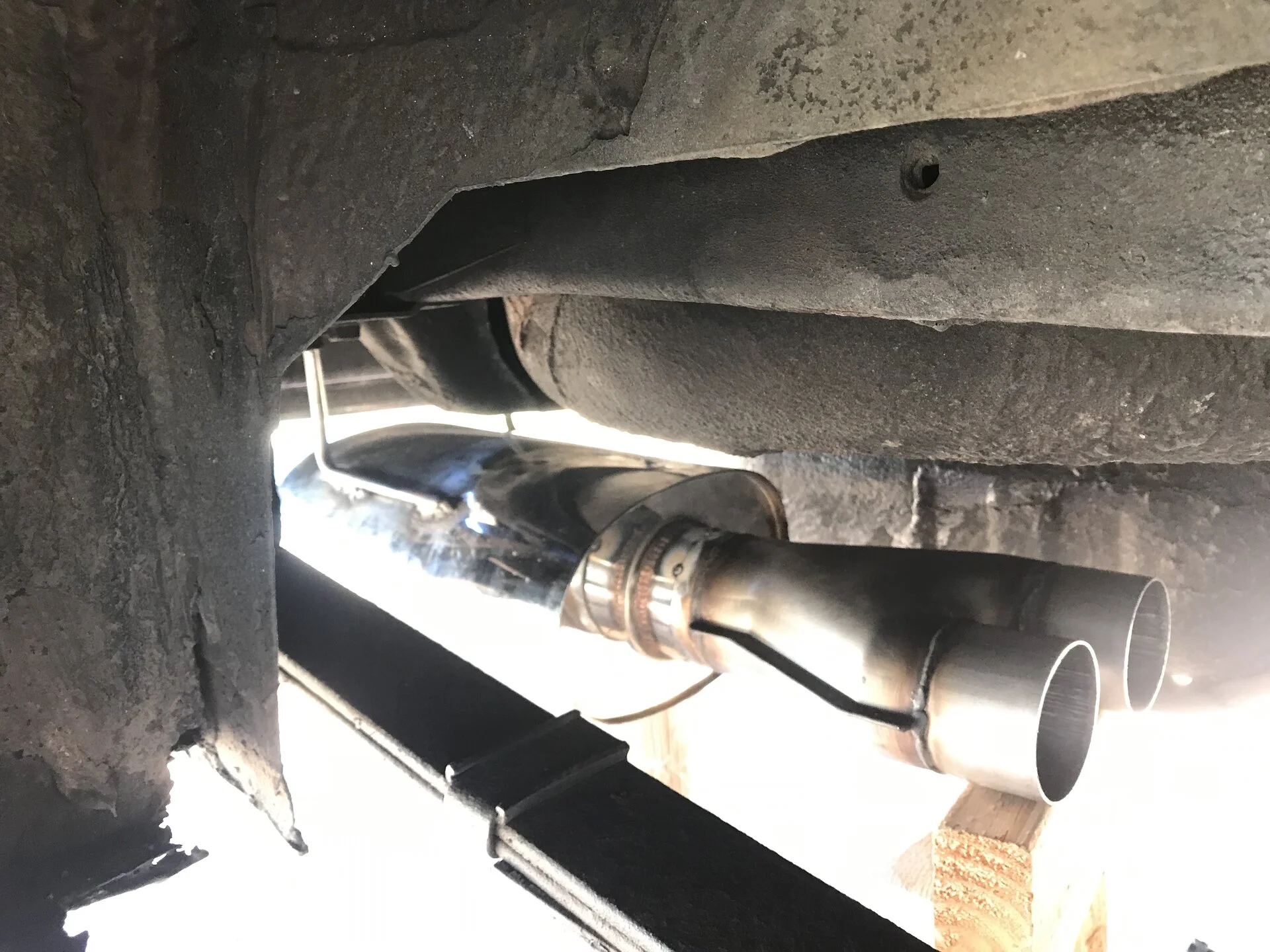

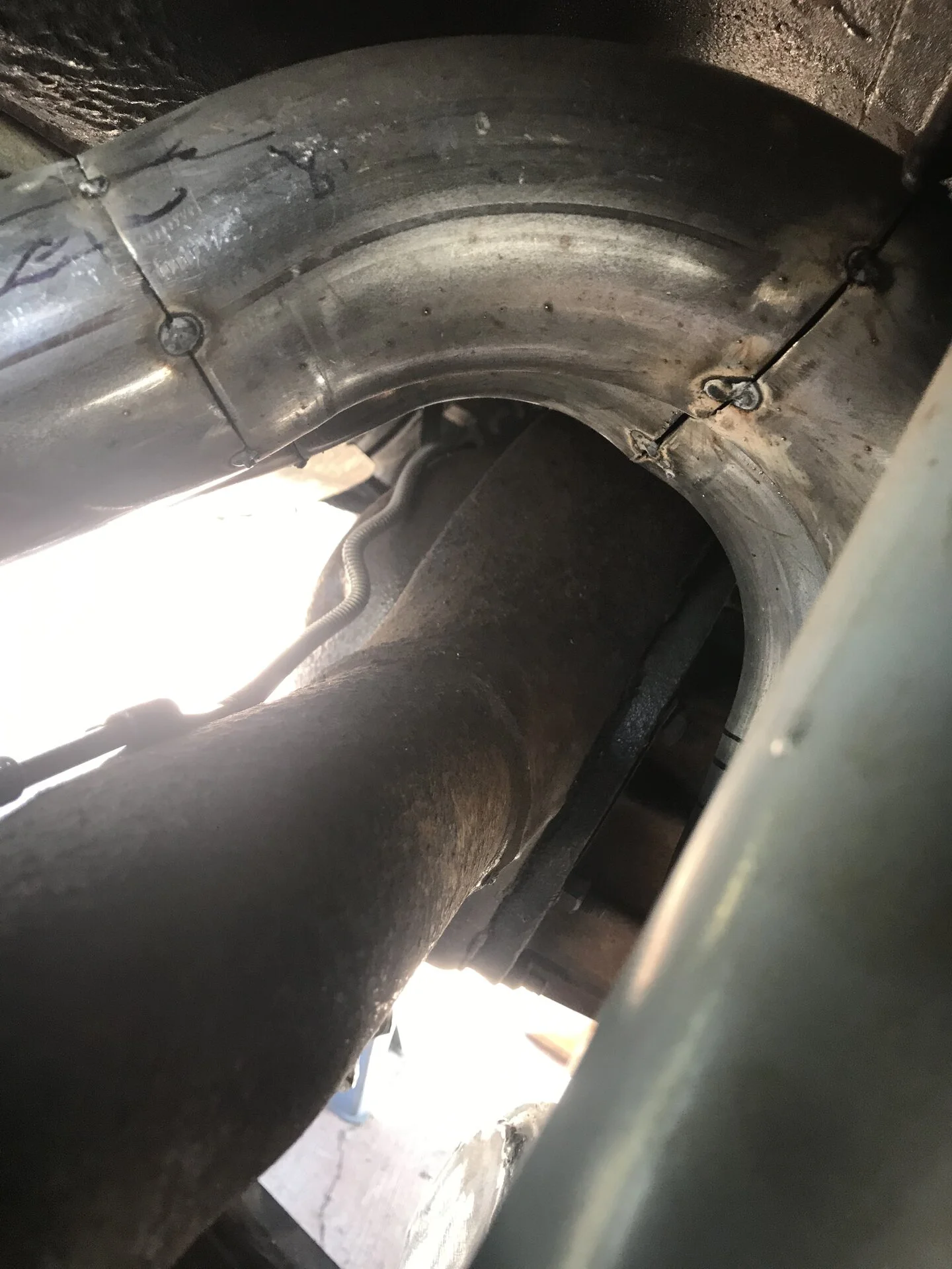

Its a tight fit to clear the floor and axle at the same time with 2.5 pipe, but is possible.

Removable tail pipe section is almost done, just got to weld up some more and a couple pinholes, clean and spray bomb it.
Little Lincoln is working like a champ! Shiny muffler is very thin and hard to weld to.
