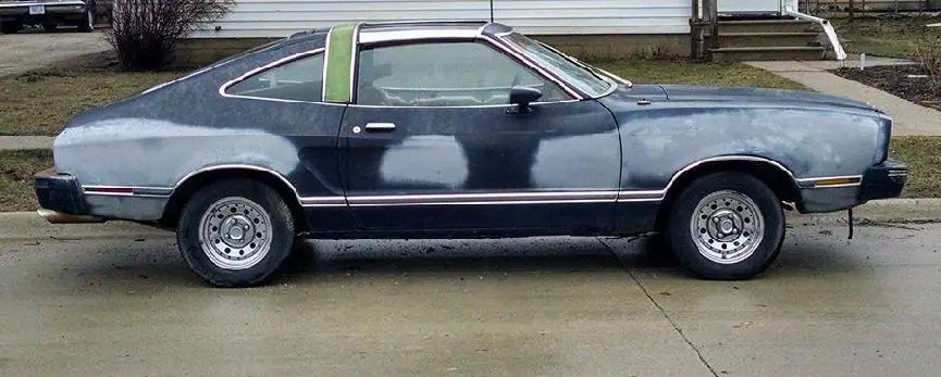

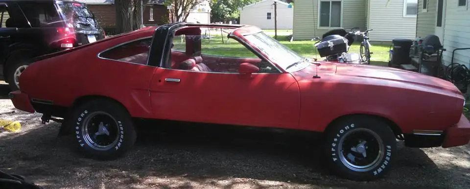

I've just spent the last hour reading this entire thread. I've quite enjoyed it. Getting the kids involved was great to see. Seeing all your progress makes me motivated to get to work on my project(s).
'78 t-top V8 4 spd A/C car from Arizona (rust free). This is the one that is being built
'78 t-top V8 Auto... kinda rusty... parts donor car.
Then we have the two cars I'm picking up over Memorial weekend for parts. A '76 and another '78.
I'll have another 4 spd and another auto and two more V8's. I ought to be able to piece something together.

Keep up the awesome work. Love seeing a II come back to life at the hands of someone that truly enjoys them.

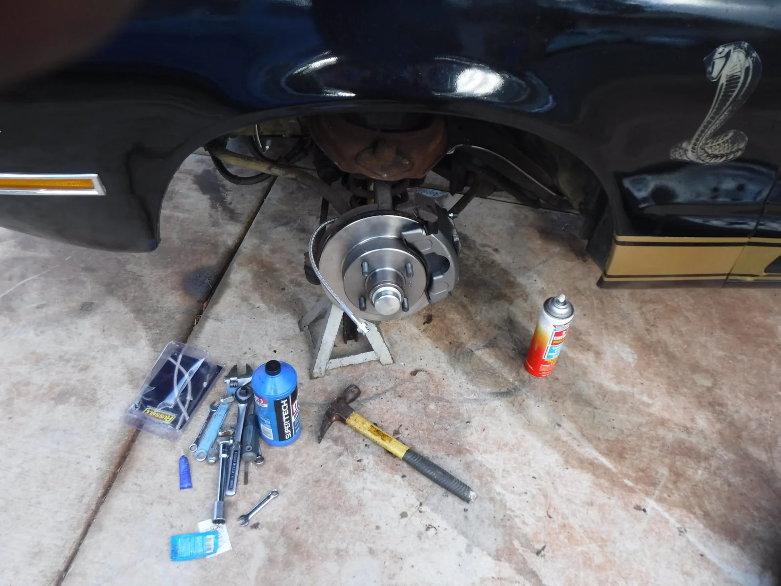

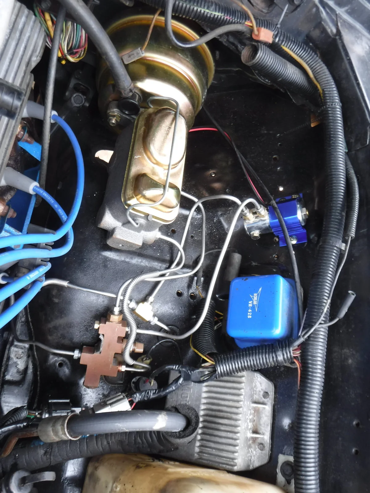

Almost got the brakes plumbed. SS lines and a Line lock are in, just need to wire and do something about the front calipers.
You know, now that I look at the picture, I should of pulled the ignition box and put the LL there. :oops::cautious: What ever.
As long as it works safely and reliably.

Right on IA_Dave, Thats a fine corral of ponys you got there.Is that 3 t-tops holy cow.
Yes, that is 3 T-top ponies.

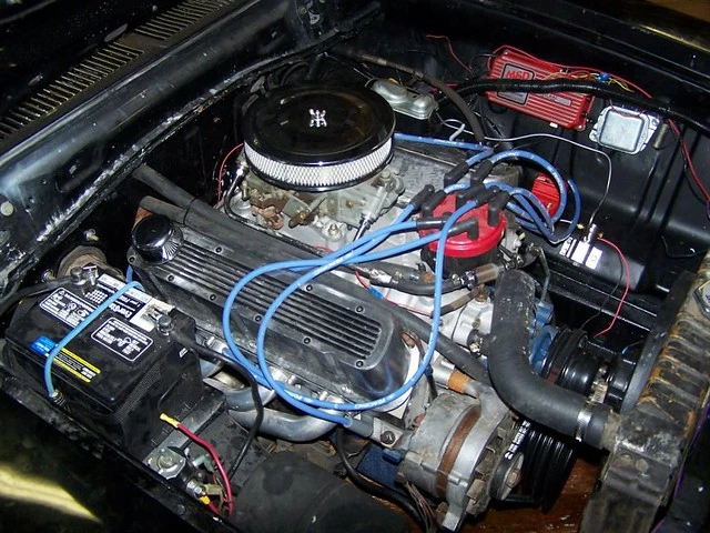

SInce my car isn't stock anymore AND I installed an MSD 6AL in that general vicinity, my line lock solenoid is kinda below where the ignition box looks to be in your car. Easy access to all of the fittings that way should I need to do anything with them.
Here's an old pic of my engine bay from way back when I first got her running again. It's the only one that shows where I placed the solenoid. :)

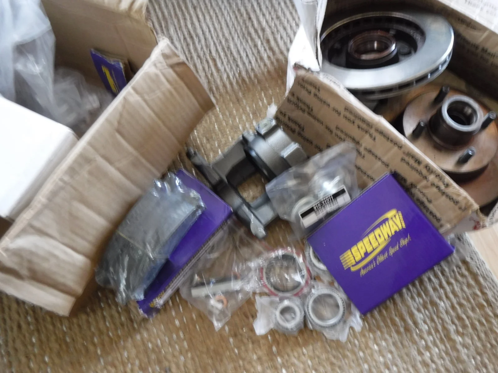

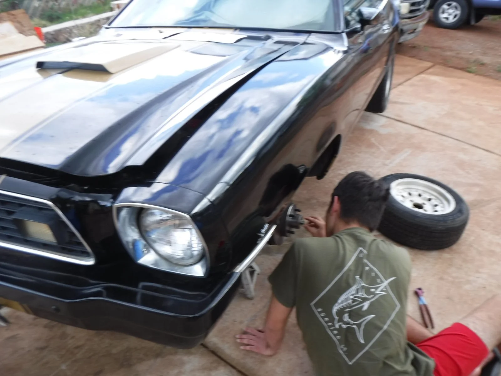

Front brake stuff showed up Sat. All from Speedway (like them a lot) except the rotors from Canada.
Rotors description said "Won't be shipped in the Shelf worn boxes" but the price was good.
For the lack of packaging on the rotors they arrived in decent shape.
Taught my son how to hand pack the new bearings.
New front brake everything is what counts but suspension needs a rebuild too.

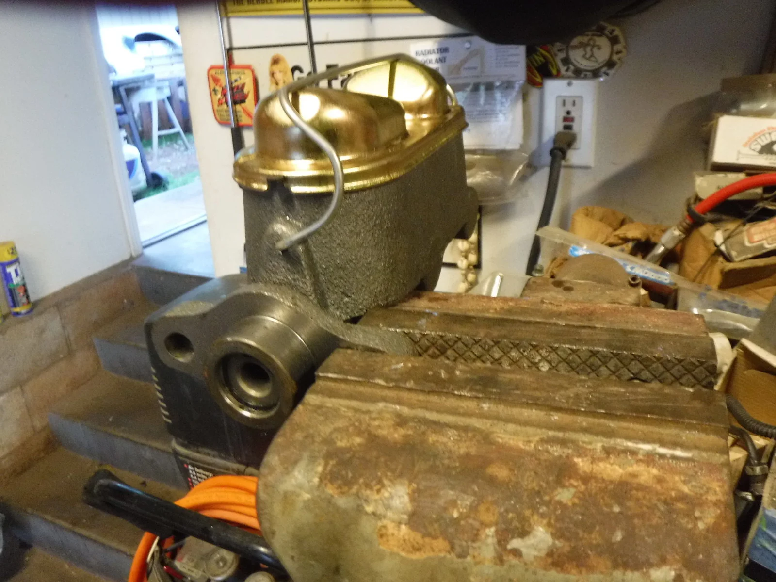

Had a hard time bench bleeding the MC
Front didn't even have fluid coming out of brake line port for the longest time.
Finally blew back into the port (with my mouth and tube) and bubbles came up and then it bled right up quick.
Not sure what was going on there, but feels good and solid now.

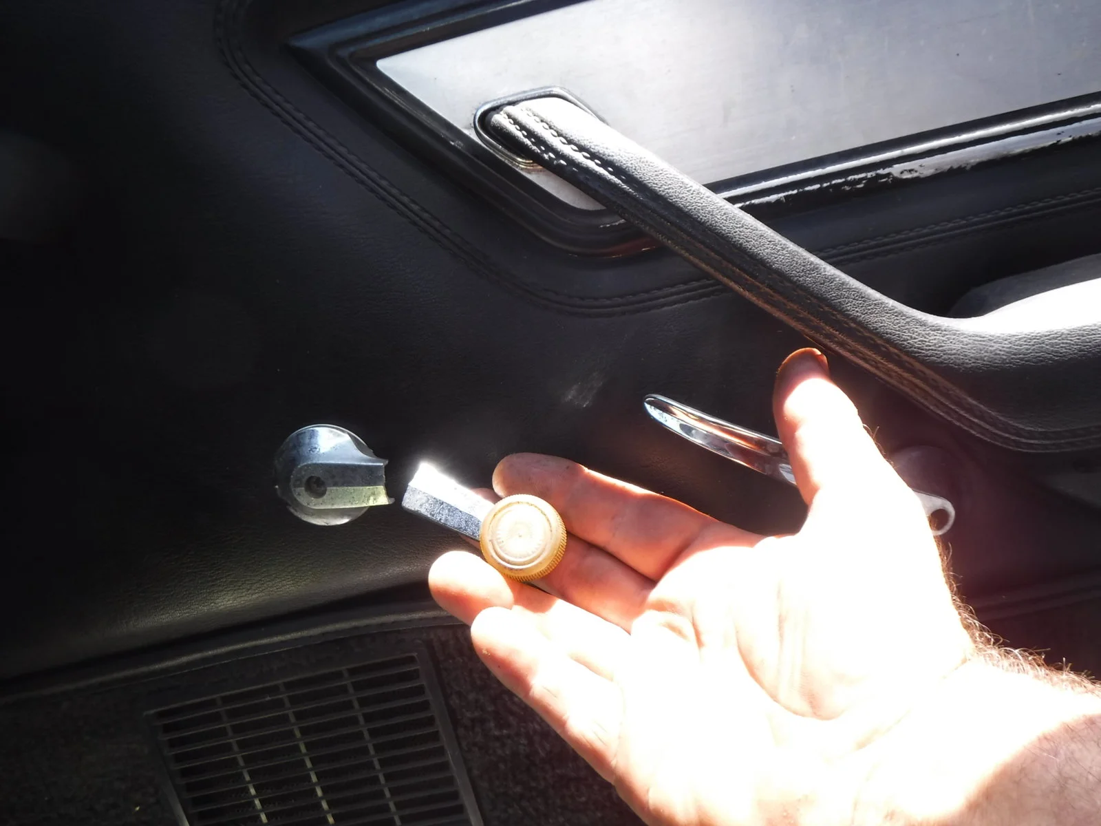

I opened the sunroof and rolled the windows down (I broke the handle right the heck off).
