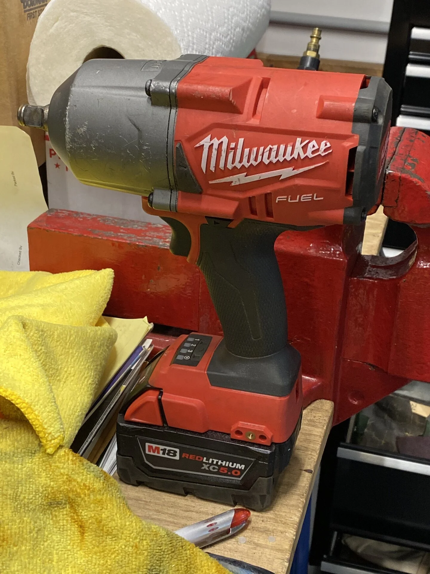

Assuming you're looking to get an air impact, my favorite Canadian had some good things to say about the more recent HF impact guns.
View: https://www.youtube.com/watch?v=jqWypTAG4Hw
I just borrowed this from my neighbor. What a beast.
Ran that pinion nut snug with ease.
Ill check out the video, but I actually was leaning toward battery. I really just want something that works like it should.
Before I go to Harbor Freight, I may look to see if dewalt makes one that takes the 20v batteries I already have. So many of them come as “tool only”, so that might make sense. I’ll price them out, but with the suspension work ahead of me, one of these will make it much more enjoyable!
They do: Amazon productView: https://www.amazon.com/dp/B0795Y49SQ/
It's on my wish list to likely be purchase fairly soon. I've been really impressed with the performance of my 3/8" DeWalt impact. Took it to a local yard a couple months ago where it zipped out head bolts with ease.

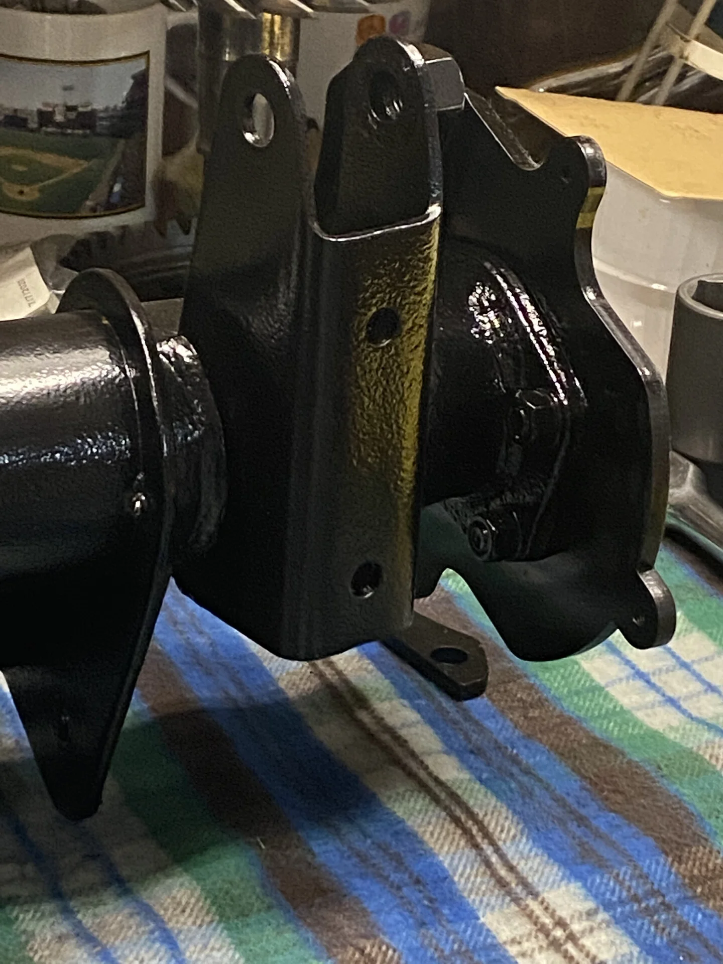

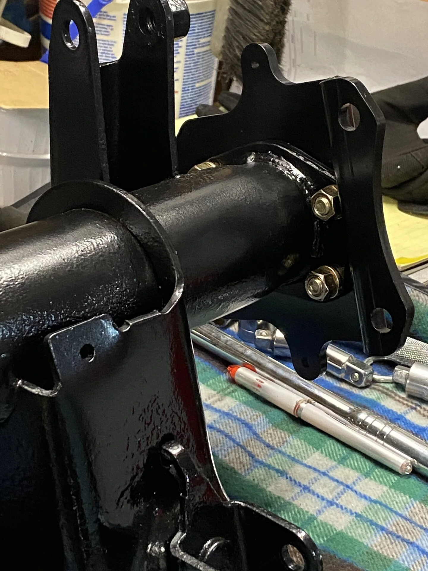

I was almost about to install the axles, and realized my NRC brackets had to be next. Now I’m debating on throwing some paint on that hardware. It’ll be out of site, so why not some more protection for it! Right?

I have the milwaukee impact and tons of other tools from them. the ratchet and small impact driver are very handy as well.
I have the 1/2 20v dewalt. DCF899H. Proabably comparable to the Milwaukee you borrowed. 1200ftlb removal. 700 ftlb tightening. If you have 20v dewalt stuff already I would consider it like you said.

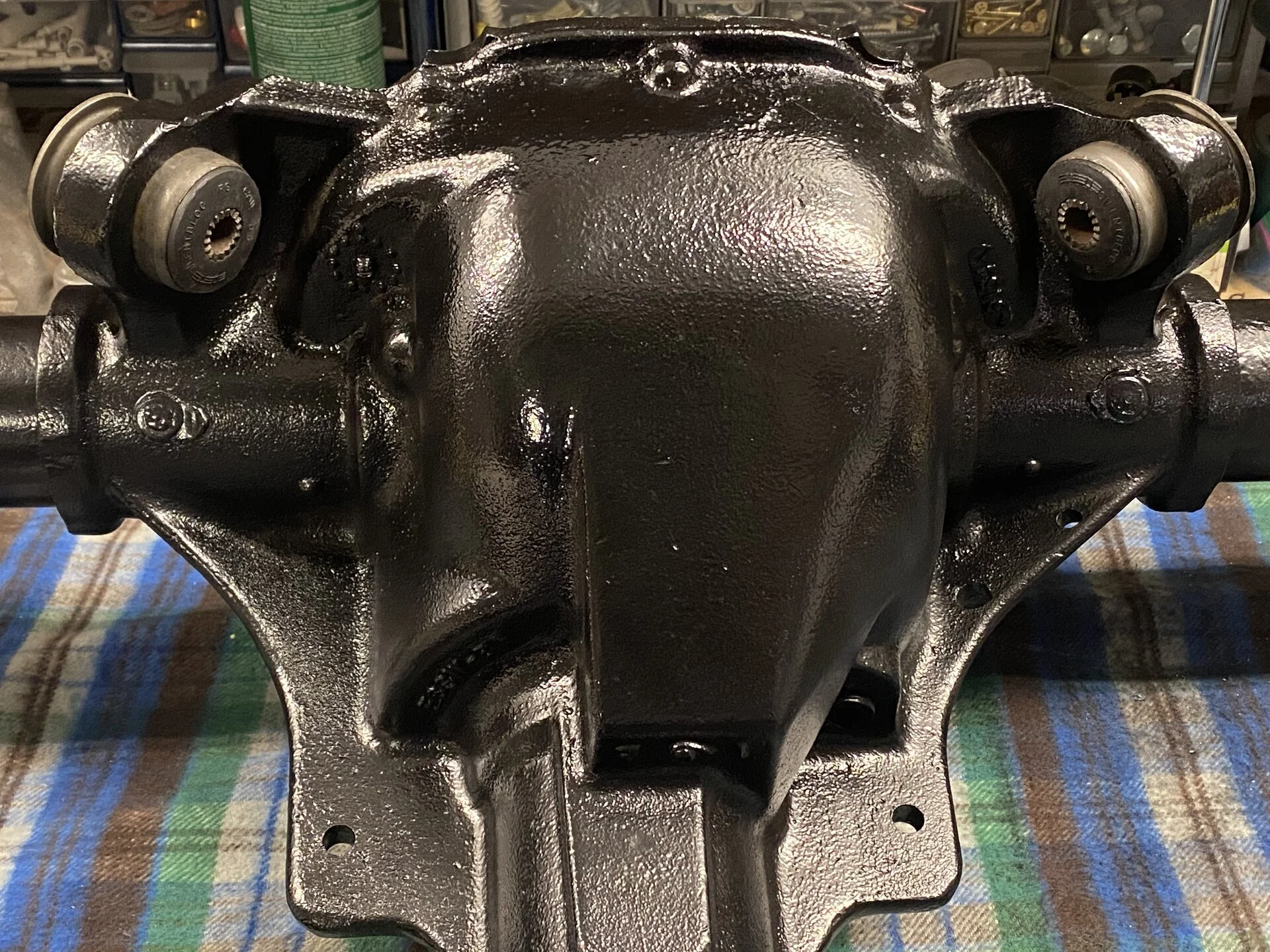

So as I sit here staring at this rear differential trying to figure out my problems (see that issue here) https://www.stangnet.com/mustang-forums/threads/cross-pin-trouble-on-rebuilt-8-8.919700/

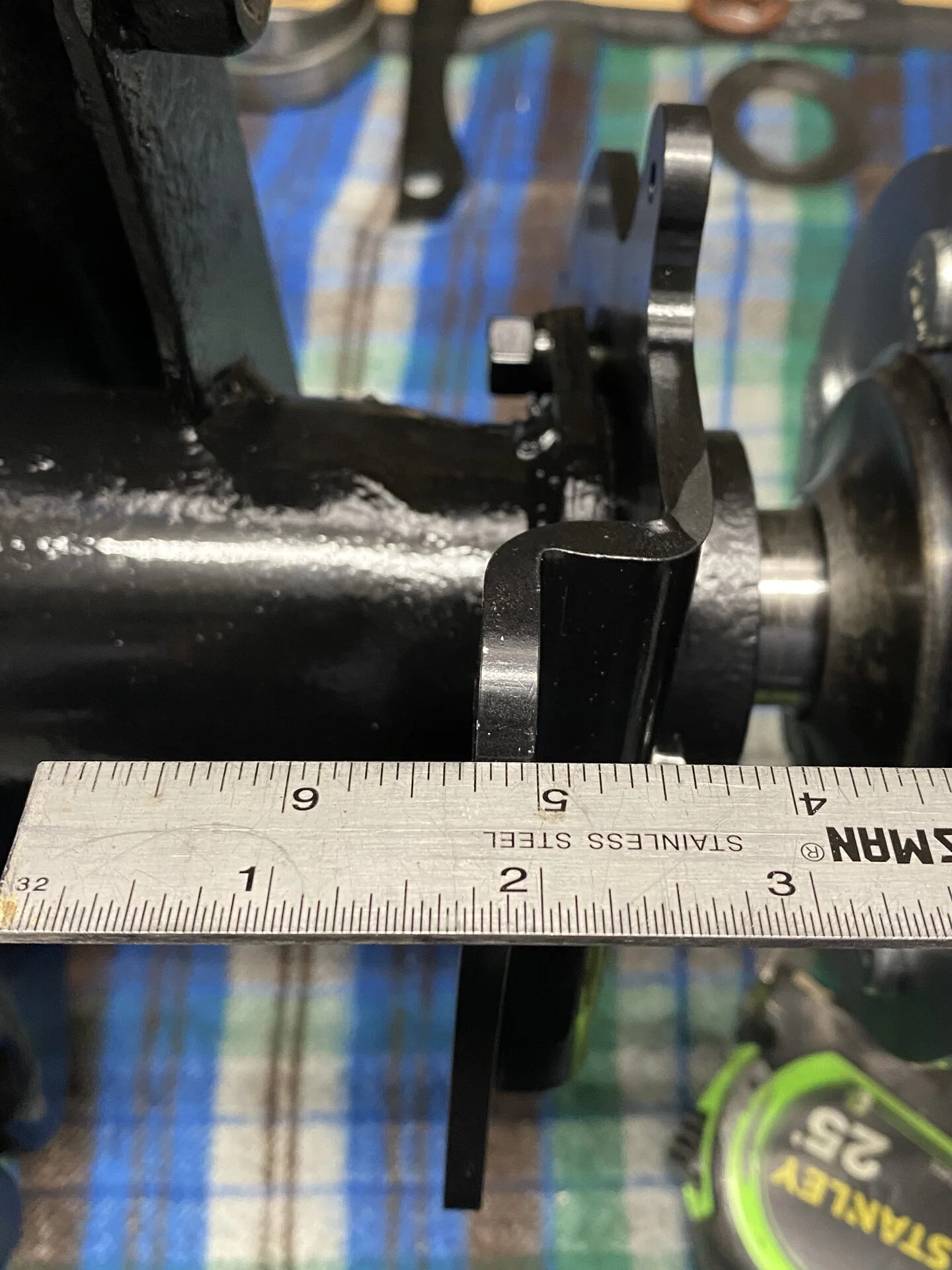

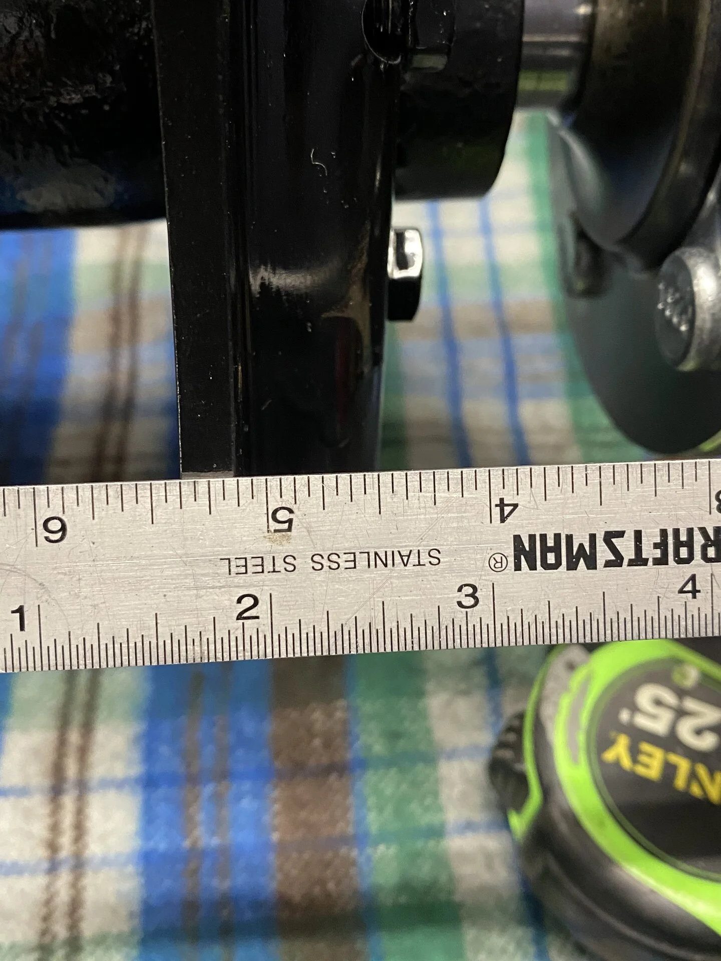

I notice that my NRC bracket is a little “off”
from top to bottom.
It’s an 1/8” off from top to bottom. Maybe that didn’t matter much to the drum brake backing plate, but I think I’ll figure out how to shim this plumb with the axle, before I go any further!

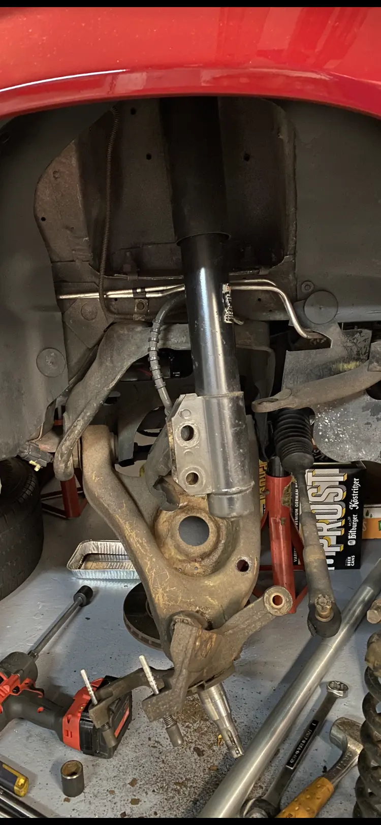

So while I wait to figure out my rear end issues, I decided to start taking apart the front end! It’s getting late, and too loud for impact, so I’ll finish this tomorrow!

I have a bunch of 20V Dewalt tools as well, including the impact. I have the older impact, supposedly the new 20V is even stronger. Either way, no complaints. It does 95% of what I need it to do. For that 5%, I pull the pneumatic impact out. But honestly, the electric impact was my favorite tool purchase I've made in a long time. It's sped up my productivity. Was debating picking up the newest 1/2" 20v impact and ebaying my old one. We will see

Got the rear back together today, and did a little more front end tear down. Then decided I needed to regroup, clean up the garage, get the tools back in their place, and boxed up some of the old parts. Can’t stand working when things get to be a mess!
Anyway...... I guess my last question on the rear end would be...... should I fill it up now, or wait until I’m going to use it. I’ve got a few more months of work before this car will move again. I’m thinking I should fill it, spin the gears/ axles, tip it up and down, and get things covered in oil.
