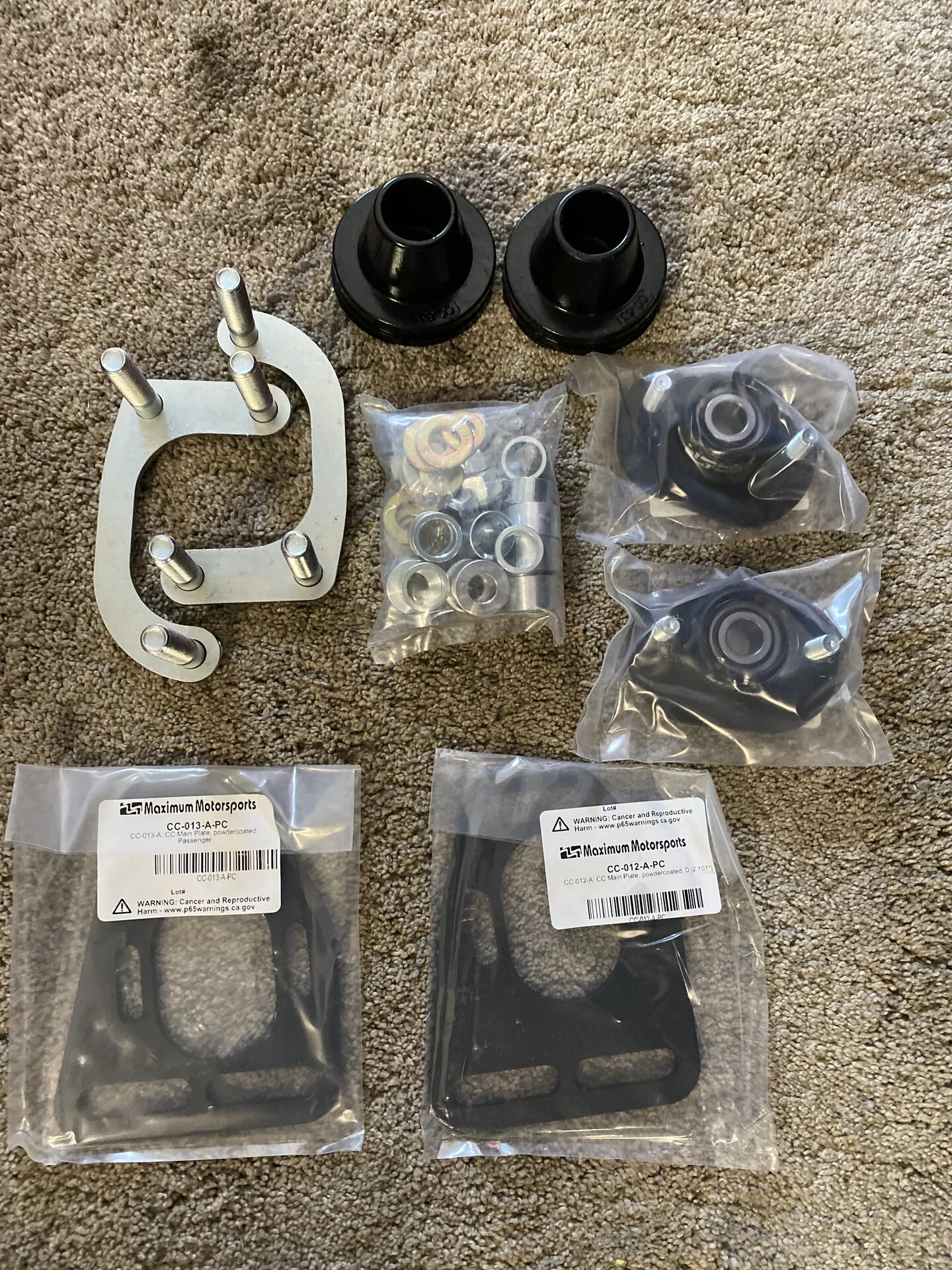

Gettin some work done!
but....... for the life of me I can not find the new strut bolts I bought (or maybe I didn’t) :shrug: Luckily I saved the old ones. I’ll get those switched out when I either find them or order more.

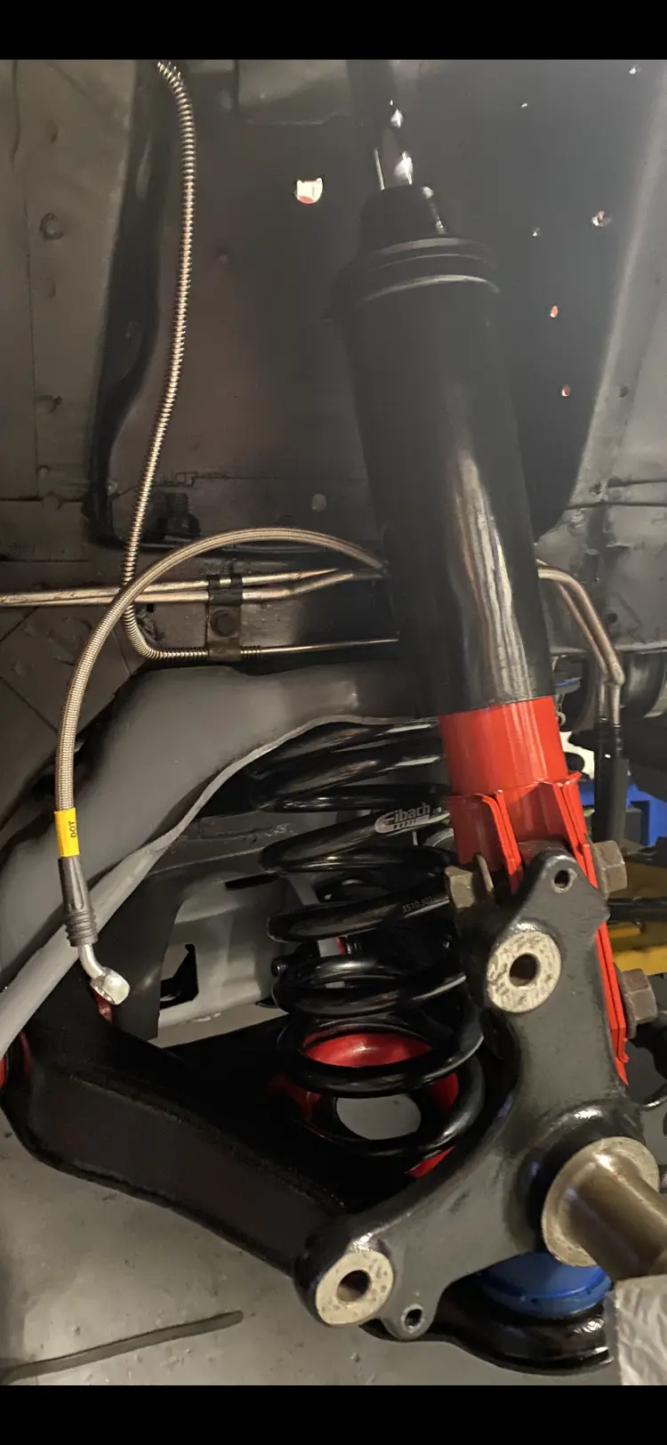

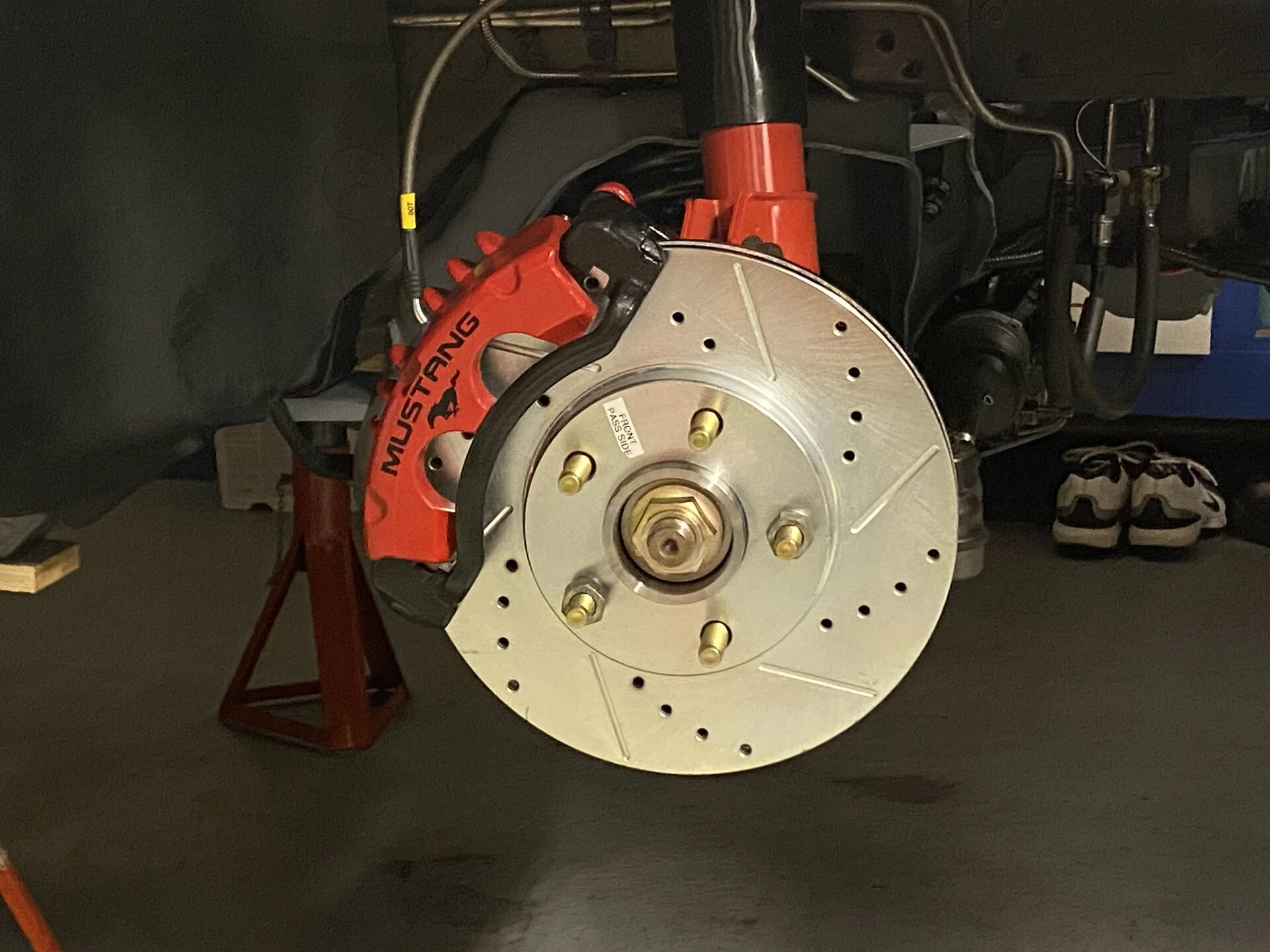

So close.... I can not wait!!!
and yes...... those are my golf shoes in the background :)
........ and yes, I still need to decide on some brake pads.
  • Love
Reactions: 1 users
You drive a VW with them shoes on?
  • Haha
Reactions: 1 user
CarMichael Angelo
10,553
9,147
63
Birmingham, al
m.imdb.com
You also need to swap the rotors
The vanes on the rotor are supposed to face the other way. I know the freakin thing is labeled as passenger side, but every other thing you read about slotted rotors tell you that that is a driver side rotor.
7991LXnSHO
wanna catch the space herp
Sep 1, 2010
5,385
1,734
194
Kearney, NE
Are there curved vanes inside that make a difference? With the slots and holes, I doubt it matters which way the pads pass gas.
I’ve seen other mfgs. call for them the other way, but should I question what this one calls for? Was it a Friday at 4:50pm for the guy that applies the stickers..... and I happened to get both of his wrong stickers in my order?
Rdub6
So while I wait to figure out my rear end issues
Dec 29, 2017
2,592
1,917
133
Long Island, NY
I can’t tell you how much second guessing i do on this thing already...... now I’m second guessing the labels on my rotors because of “do it thrice Mike” :shrug:

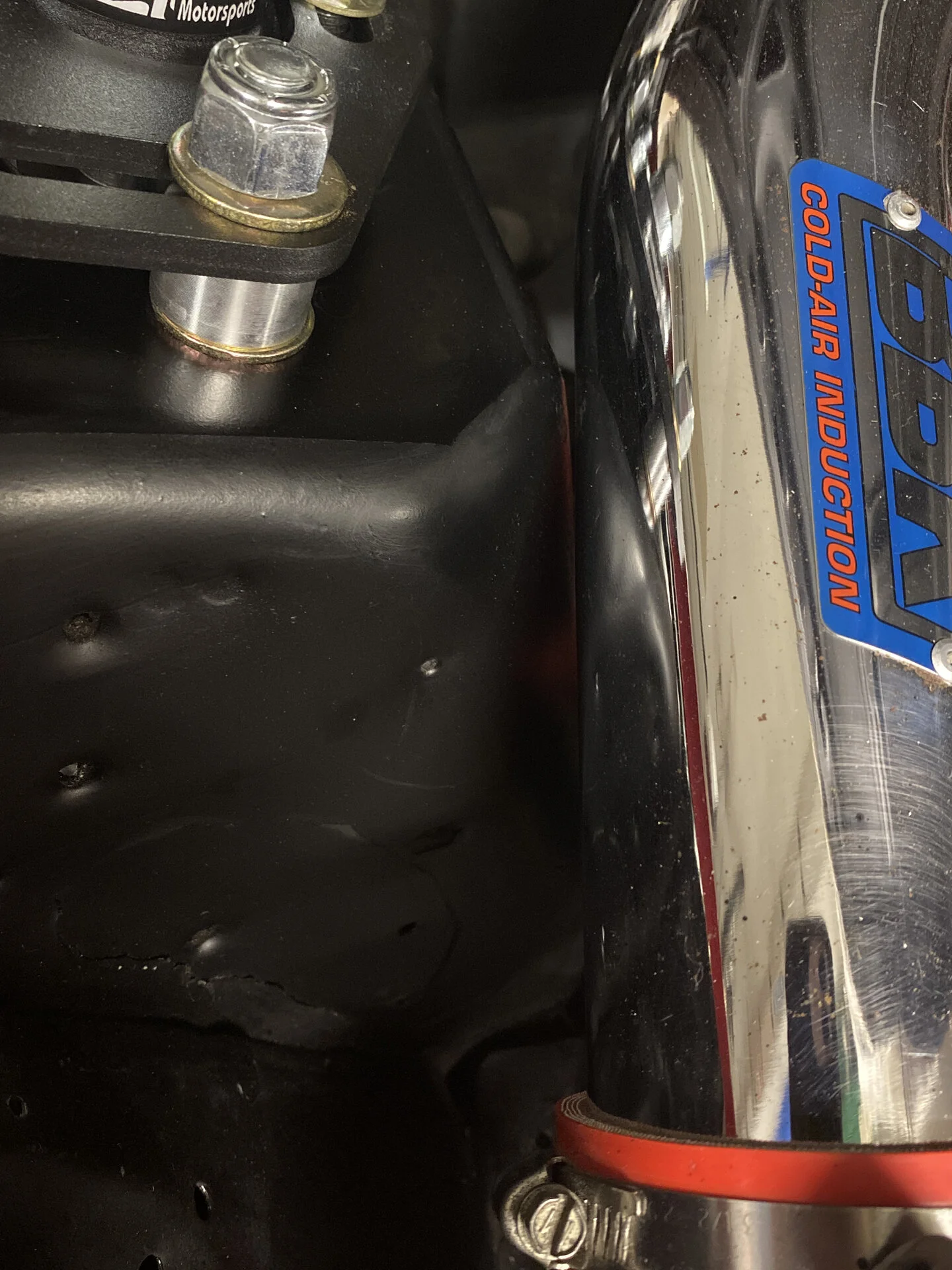

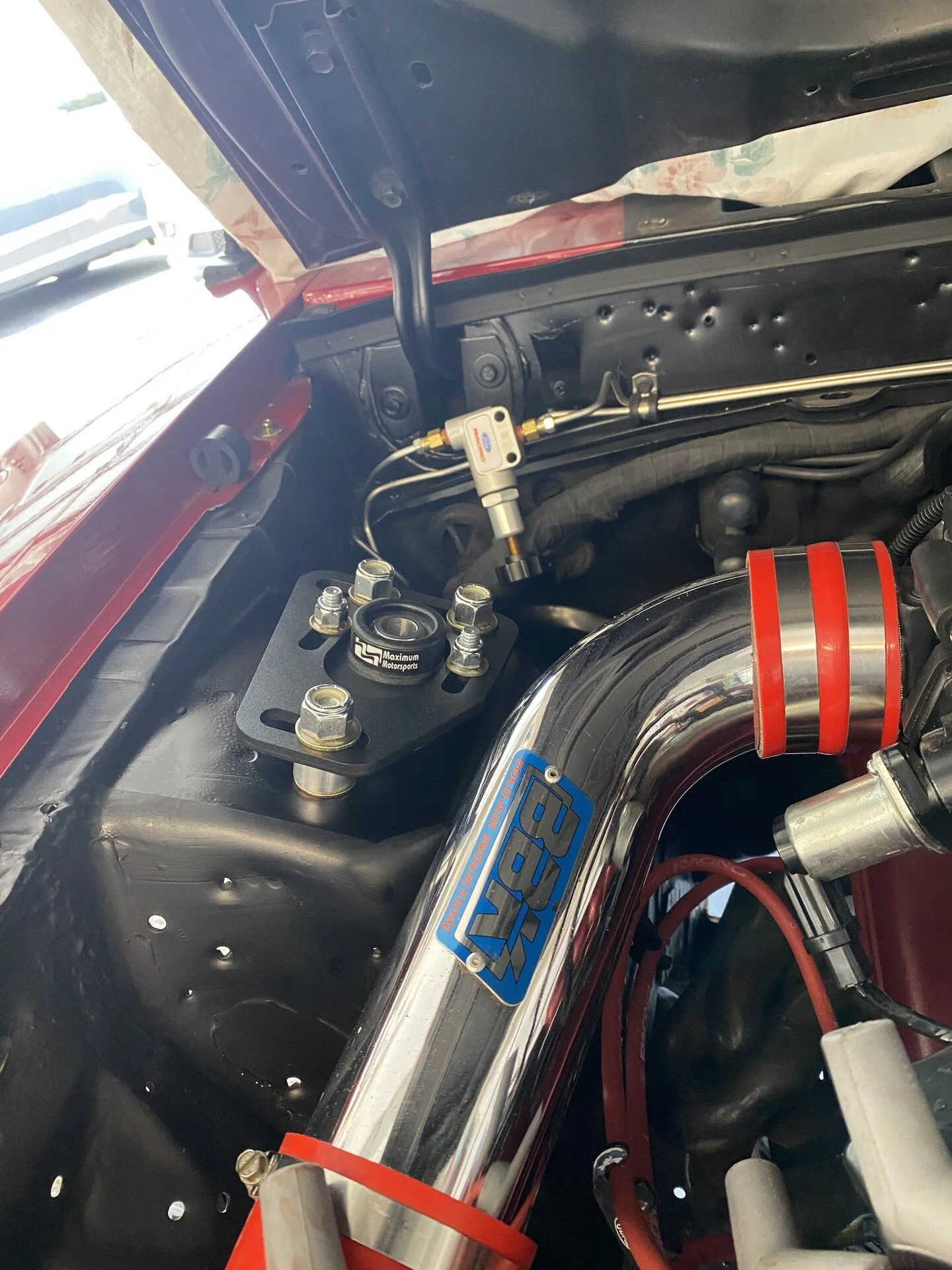

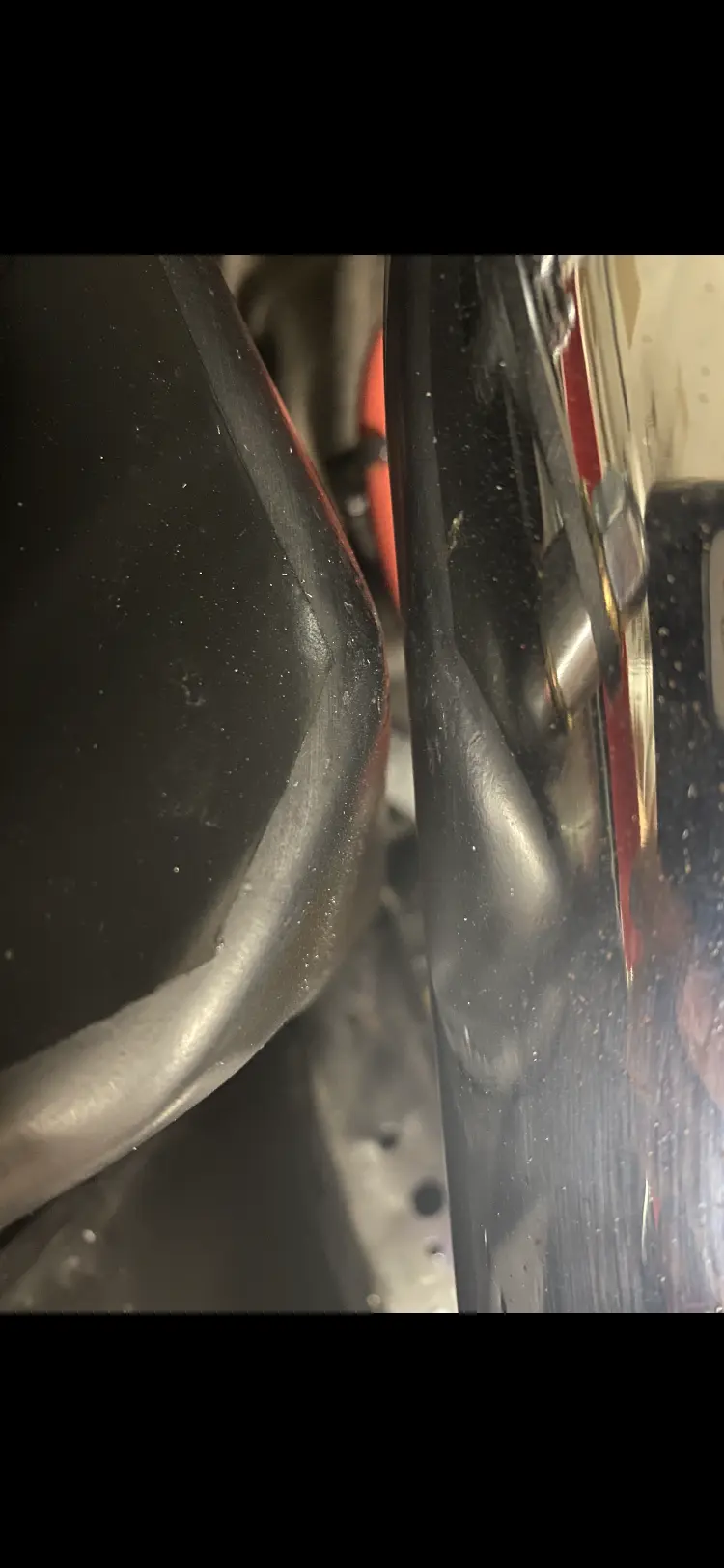

In the last picture, how is the BBK cai tube to strut tower clearance? Does it rub? When I last changed the TB, I ended up with the top tube pushed over as far as it can go for tower clearance. I have plans on trimming 1\4 -3\8" on the pipe to let the hose have some flex room if the mounts wiggle. but not until it has to come apart again.
Rdub6
Dec 29, 2017
2,592
1,917
133
Long Island, NY
I have about a 1/4” of clearance. You definitely need to push,
and tighten as you go along, to keep the clearance once it’s at the final position.

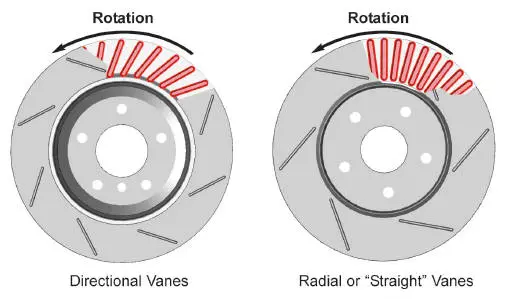

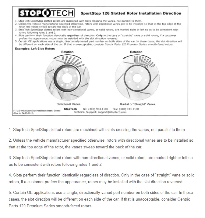

And for every one of those, you can find another telling you something exactly the opposite.
From what I understand, it should be more about the vanes inside the rotor that indicate which way the thing should go. If those vanes are oriented correctly they act like a water wheel, only instead of water, “ scoop” up cooling air that flows into the rotor, and back out through all of those tiny holes. Think of it this way, turn a fan blade backwards, but spin it the way it was supposed to spin…..it don’t work too good.
I pulled this pic randomly off the internet, and even it is giving contradictory info…Just dig around though,…for every one that’s right, you’ll find another that says it’s wrong.
At 50/50…it just doesn’t matter in the end I guess.
Rdub6
Dec 29, 2017
2,592
1,917
133
Long Island, NY
So the outer slots really don’t play a role in deciding the direction they should be..... it’s those “inner vanes”. Interesting!
Hoytster
I don't dare do that to my Knob
Dec 30, 2002
1,047
713
164
39
Cornwall, PA
Just from personal experience running Stoptech brakes on my old AI car, the picture Mike posted is the "correct" way. I can also tell you from experience, it makes almost no difference which way you install them.
90sickfox
Wasn't a pretty sight...and I've got big hands
SN Certified Technician
Mar 2, 2015
5,860
4,950
203
43
Mike noticed my rotors were on the wrong side, despite the fact the seller on eBay noted the way I had them. I swapped sides so vanes are as he pictured. I even argued with him about it...but now it looks better and calms my inner OCD.

CarMichael Angelo
10,553
9,147
63
Birmingham, al
m.imdb.com
I’ll bet it doesn’t make one rats red bunion hole of a difference…but there’s alway a right and wrong way to do something. I’d think you’d wanna do the right thing.
Rdub6
Dec 29, 2017
2,592
1,917
133
Long Island, NY
I’m going with the stickers that were applied to my rotors. Chances are, they won’t ever see the speed, and braking from that speed, to make a difference........ but they look cool! :)
