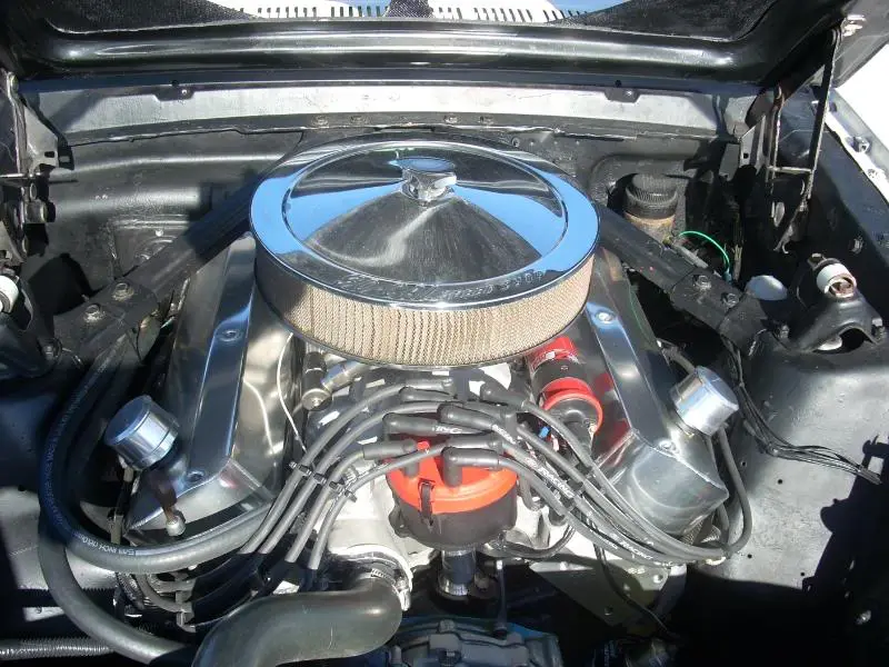

I have a pre-EFI mustang with no engine installed in a special edition vintage race car with somewhat of a historical racing specialty car, a monroe handler.
I want to keep it looking old school and historical in nature so the average person would not notice the motor upgrades to a '96 late model long block... just seeing an old era correct 351W if they did not know better.
I have a 351W from a 1996 F-150 that was EFI, less the intake and heads.
I have a pair of GT-40p heads to replace the heads and a 4V intake manifold. I have also swapped out the oil pan to fit for my application and will be running a set of hooker headers super comps modified ever so slightly to fit the altered plug alignment with this combination.
I am looking for a vintage racer kind of scenario so I have the accessories from a 79 thunderbird 351W, specificially, I will go with the a/c, p/s, alternator, timing chain cover, water pump, etc.
I will be running a high performance agressive cam and have a Holley 3310-2 4V carb ready to roll with some modifications on it.
This motor is a roller cam design so I can't run the distributor I have kicking around from another '79 351W without changing the gear.
So now for the meat of my questions:
Q1:
I have plans to use a distributor out of a 1985 (or similar) F-150 with the 4V carbed 351W. Will this dizzy work well (or at all for that matter) for me?
Q2:
I was wanting to know about the best choice for a "mechanical" fuel pump for this motor on a high performance street application. Which parts would you recommend and why?
