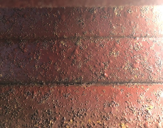

This picture is from in the trunk looking up at the hard to access areas. I have to assume this is the closest I might get to the original color. Considering it is definitely not Signal Flare Red(not orangey enough) or Vintage Burgandy(not dark enough) I would have to say the original color was Candy Apple Red. Agree? Disagree? I can't guarentee that this part wasn't repainted after the fire, but I would think it would look better if it was. It's been mostly in a garage for 14 years since it was painted.
Oh, and VIN is 6F07T144758, but I know that doesn't help. Maybe someone can help me narrow down a production date though :)

Ford painted underneath and some other spots with slop which was leftover paint mixed up to a red oxide color.
Looks like slop to me.
