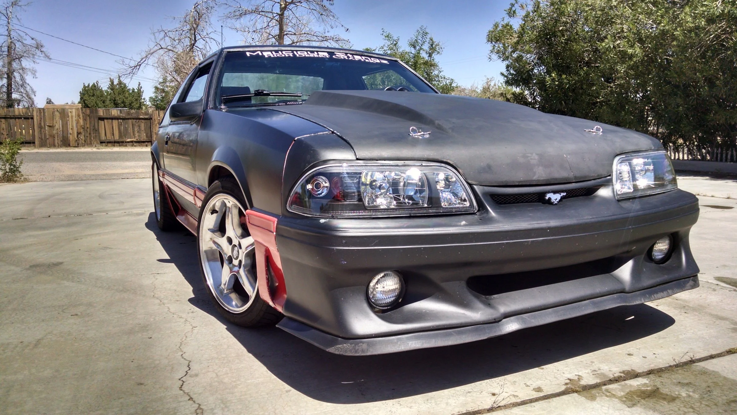

I bought an 88 Ford Mustang GT with a 5.0 and 5-speed I quickly learned it had 1992 upgrades
