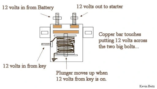

I have another question: can the starter solenoid only be wired one way? I mean if I have to use one specific side for battery and the other for the starter?!
I've gone trough my pictures and when I bought the car the starter wire was on the left side (to front of car). Now I wired it vice versa (like it is on my 66 coupe).
LILCBRA
Dec 6, 2005
2,387
1,401
164
48
Marietta, Ga
I don't think it matters, but I could be wrong. I mean it's just a switch, it's either on or it's off. For what it's worth I wired mine as yours was stock, battery to the right and starter to the left. It seems that most illustrations on Google have the battery on the left and the starter on the right though. :shrug:

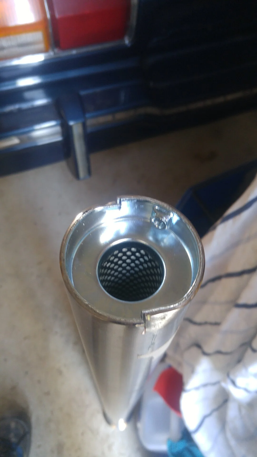

The mufflers are some magnaflow knockoffs (where for 4 years on the shelf) and now they are sold from Holley and are called Flowmonster and use the same part number as magnaflow...
https://www.holley.com/products/exh...lass_pack_mufflers/flowmonster/parts/11226-FM
I hope that the car is much more quite, when dialed in. It's insane loud. Much louder than my 66 coupe with glasspacks and side exhaust exit.

So they're essentially glass packs, just with an oval case. At least that's what I take away from the description on the website. :)
