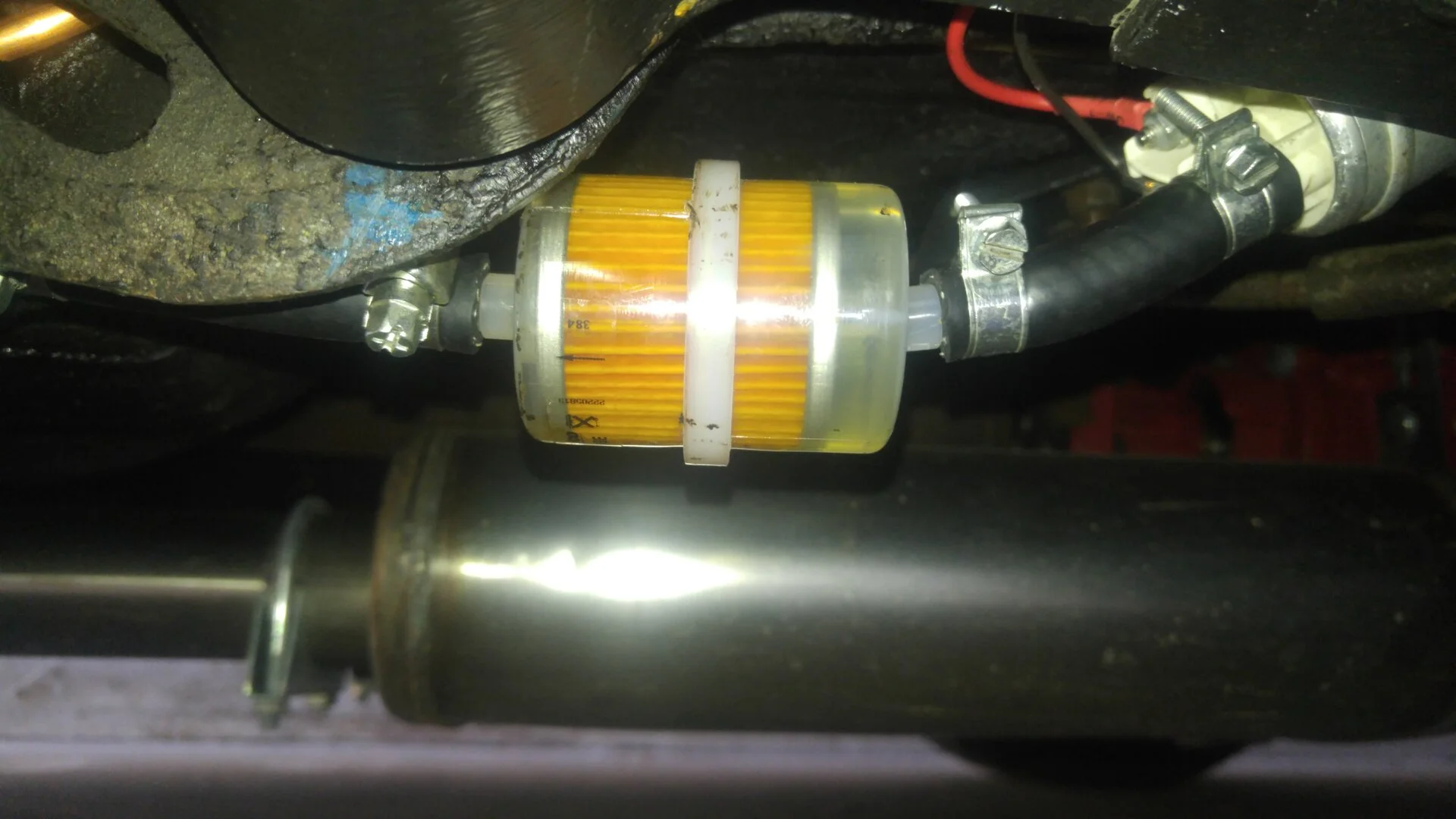

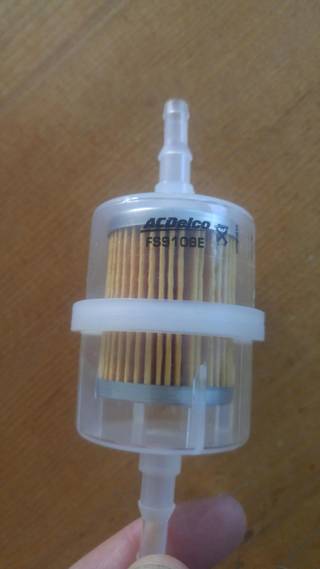

The new setup works till the fuel filter looks like this:
If it's new it looks like that:
It seems that the plastic brackets that hold the metal part of the filter element collapse or something like that. How ever it seems that fuel can not pass the filter anymore... or not enough. Engine was knocking when accelerating and started to stumble again.

I'm still thinking what went wrong. This filter looks just curious. The car was around 1 hour running in idle and perhaps 15 minutes of driving with this filter. The filter was new!!! I checked 5 times what the filter is doing in this time...

I'm still at a loss as to what you're referring to? The top picture looks to me like the view of the filter inside is distorted because you're looking through liquid. Otherwise it doesn't look like there's anything wrong with it that I can see. I mean the metal ends of the filter wouldn't grow and it's unlikely that the plastic housing has shrunken, if that's what you're looking at.
:chin
Perhaps it looks distorted because of the liquid like you say and something different is going on.
The first couple times when I was accelerating, the car ran fine. And there was no stumble or knocking. 10 minutes later it ran bad. Any ideas what else to check? Needle&seat?

The filter and pump look close to the exhaust, can you monitor fuel pressure while driving around?
Make sure the filter is flowing the correct direction.

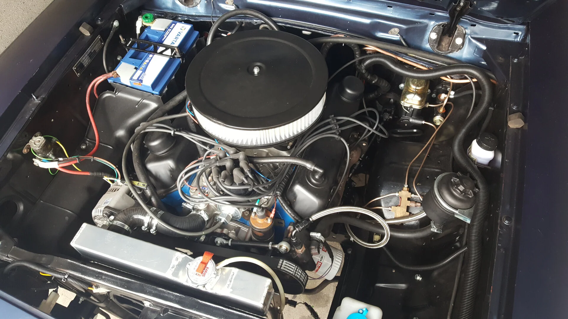

I started the car and it was idling fine. 10 minutes later it was impossible to get consisted idle. The fuel bowls where cold compared to the rest. I changed the spare ignition coil I had with me in the parking lot, but still crappy/no idle when warm/hot. Then I "drove" home changed the pertronix 1 and still have no idle. I opened the fuel bowl level plugs and there was fuel dripping out. I have no fuel pressure gauge, but I think the carb gets enough fuel and it doesn't get hot (on the picture above it looks much closer than it is).
I removed the carb and cleaned the bowls, idle circuit and etc. I set primary and secondary transfer slots to spec.
I will test in a few minutes if its running again.

It is idling to high, but I also need to check the ignition timing to get max mechanical advance and the RPM where max mechanical advance is in. I will do that with a friend.
Never thought that it is a dirty idle circuit, because everything was new except the tank but there was always a filter between tank and carb. I hope everything is now clean. Fuel filter still looks good and yes @LILCBRA your right, it just looks odd because of the refraction of different liquids.

I also have re-torqued the intake manifold bolts, perhaps this was the real issue. I'm still thinking what it was and why the car ran okay, when cold (with choke)...
If i remember correctly I used a print-o-seal intake gasket. I think the settle a lot, after the first few heat cycles.
