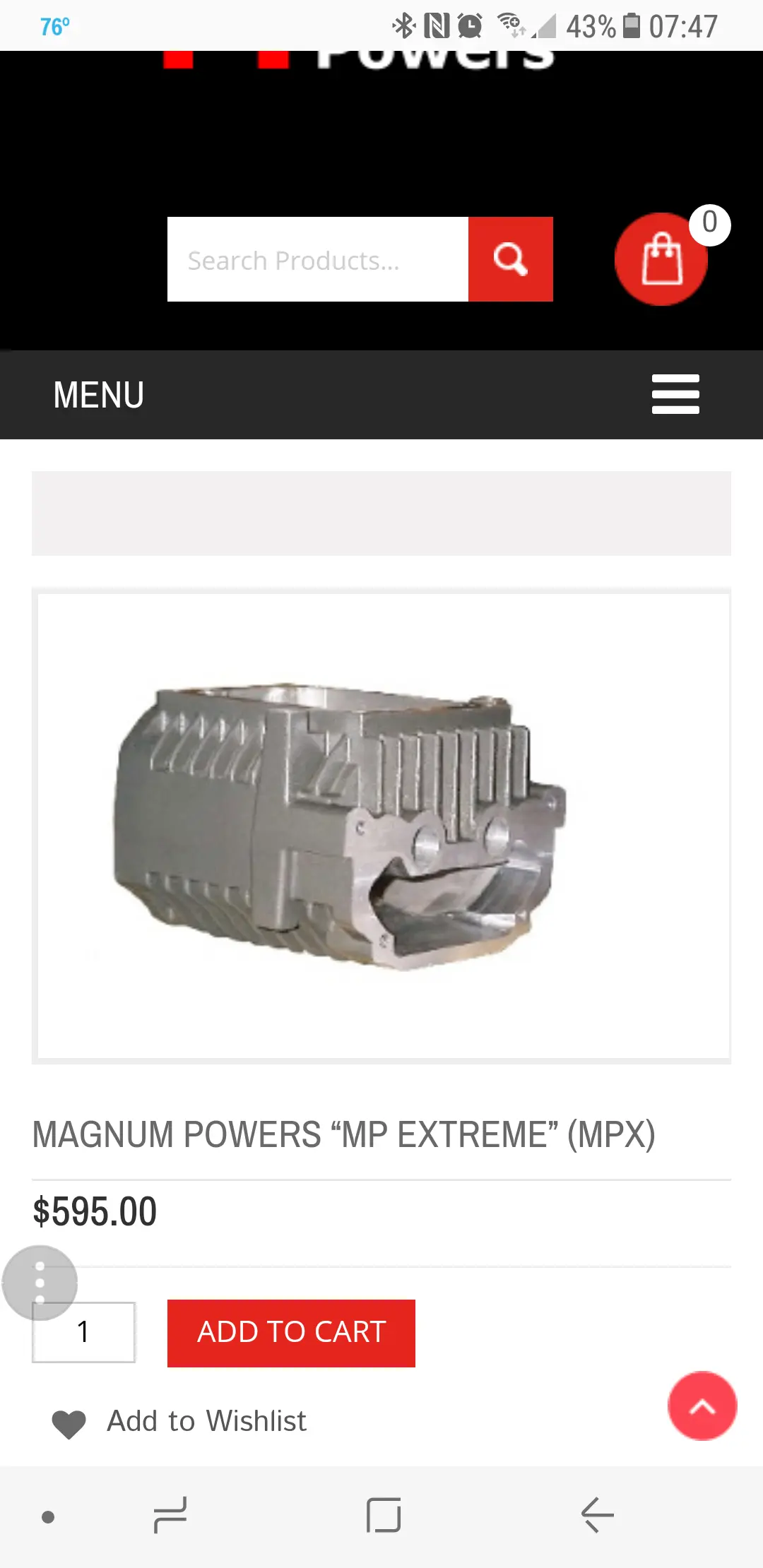

While they are spending your money..... I think you need an mpx90.
this is the end all of m90 blowers you can't possibly get anymore out of it.
Honestly, if I had the money I would get it too.While they are spending your money..... I think you need an mpx90.
Rebuilding the snout is easy if you have access to a press. Then you just need the mpx90 case and all your stuff goes into the new case. You will need to make/buy a inlet howeverHonestly, if I had the money I would get it too.

That's easy. The SC he has for that motor will fall on it's face at 325hp..... ported...
The mpx90 flows so much friggin air (for an m90) that people make 380-400+ hp with the right pulleys... Not to mention that it's more efficient so makes more boost turning slower with less inlet restriction, all that makes lower inlet temps.

If I had $4500 extra that MPx case would already be in my possession.
