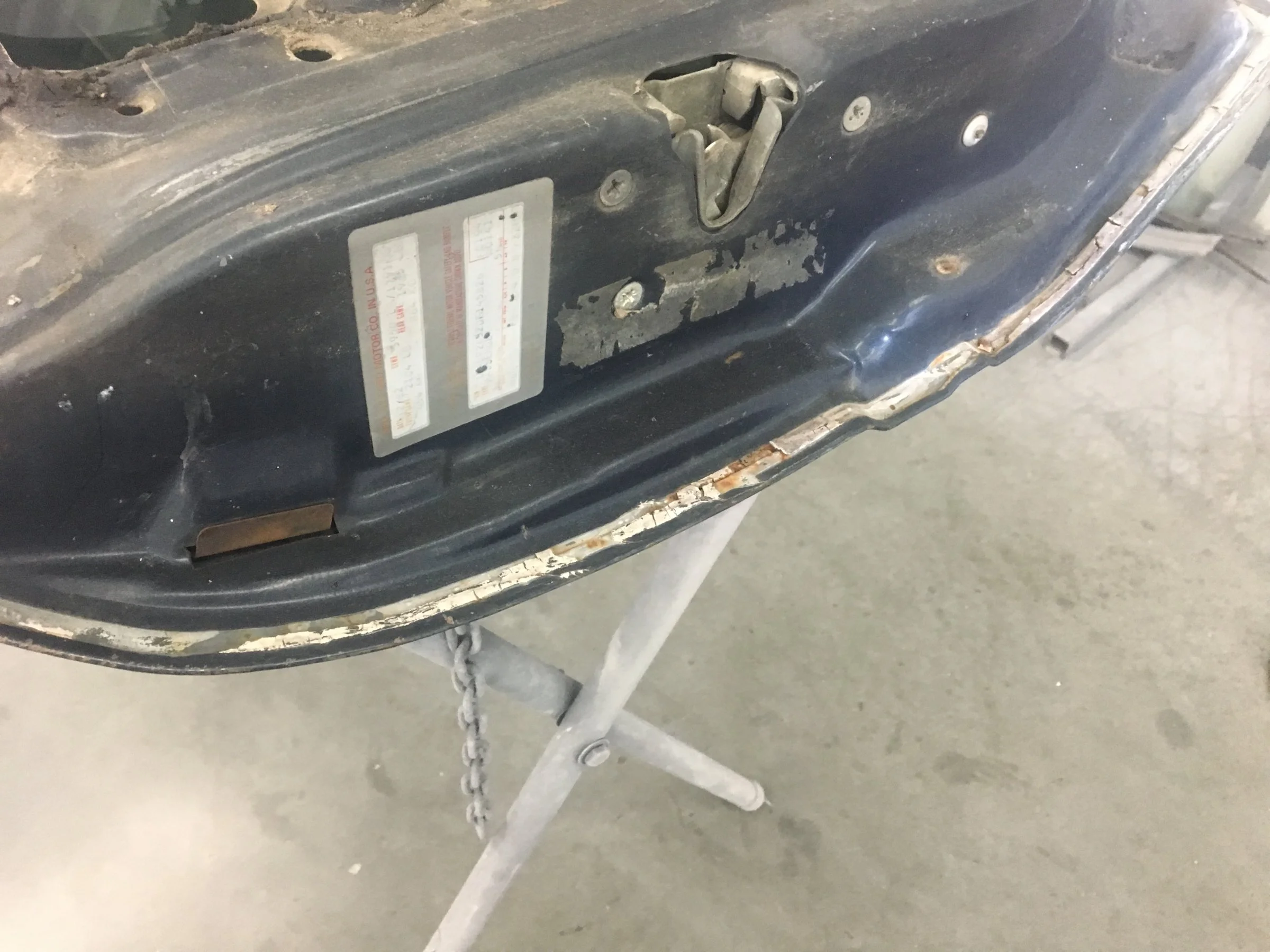

You've mentioned seam sealer numerous times. At what point does it need to be replaced?

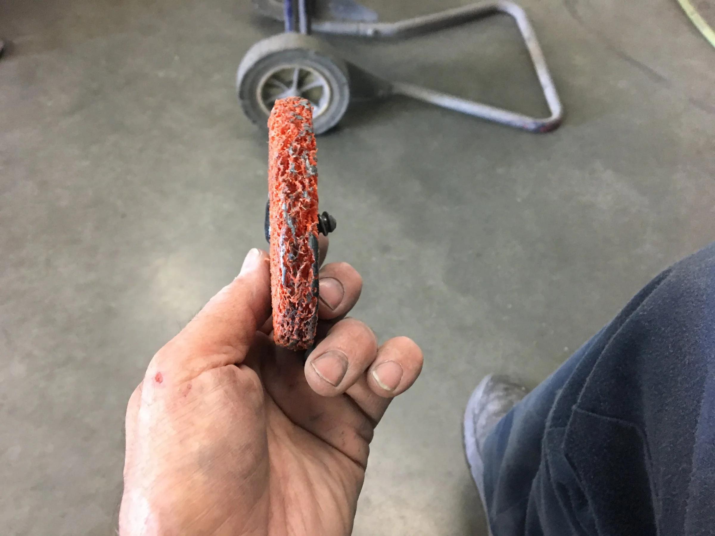

Here's a picture of the old crap. I might spread it today, I'm thinking I might do some of the bodywork instead though.
I used a fiberwheel to remove it.
I just need to put it on there before I paint it with the final finish. I'll post some pictures of it when I do it. I'll use a flowable seam sealer.

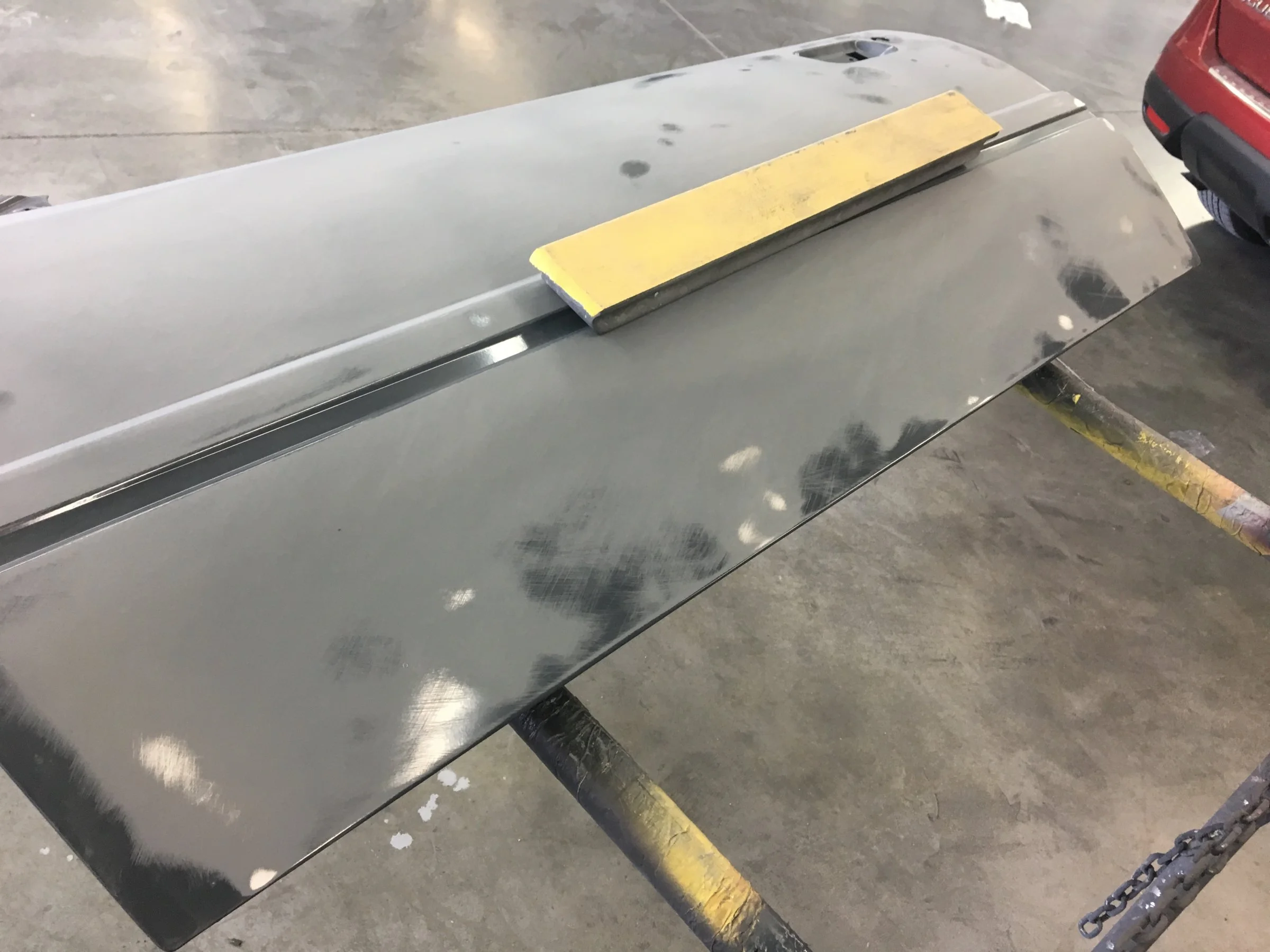

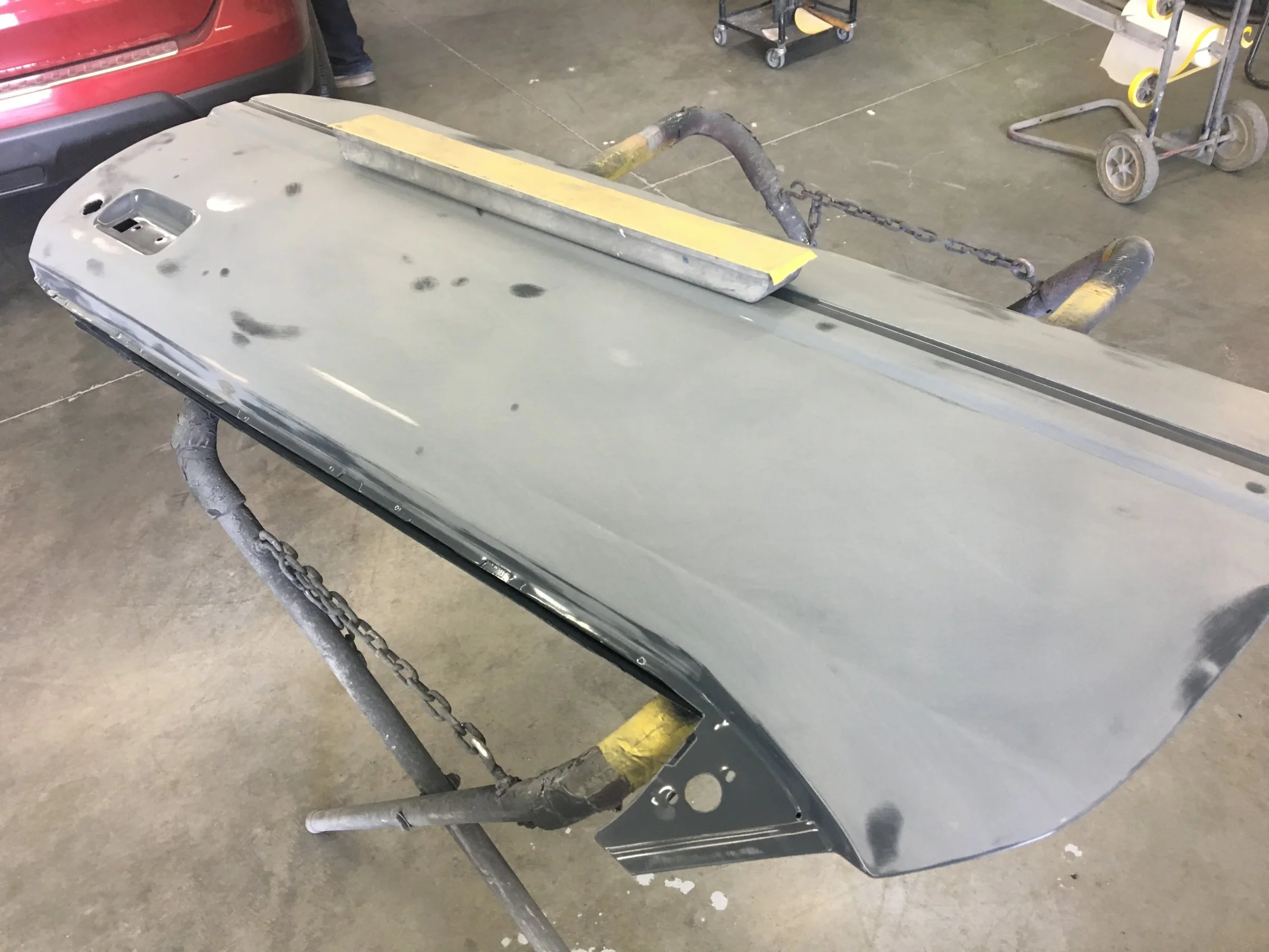

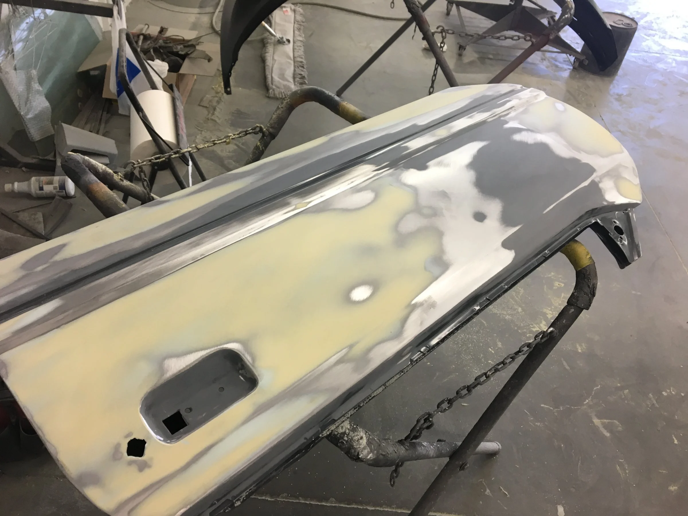

In primer with an initial blocking with 150 to see what really needs the extra attention.
Not bad at all really, I'll only need to pull a few dents and around the door handle.

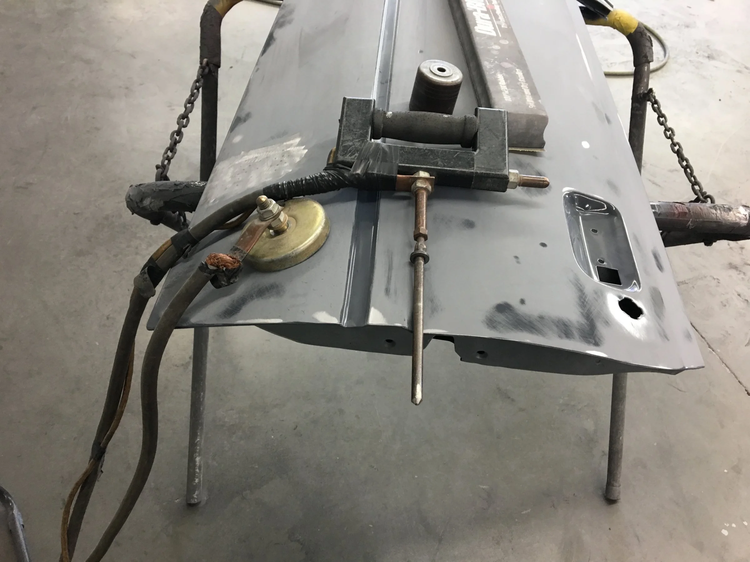

Ok, pulled out the worst of the dents.

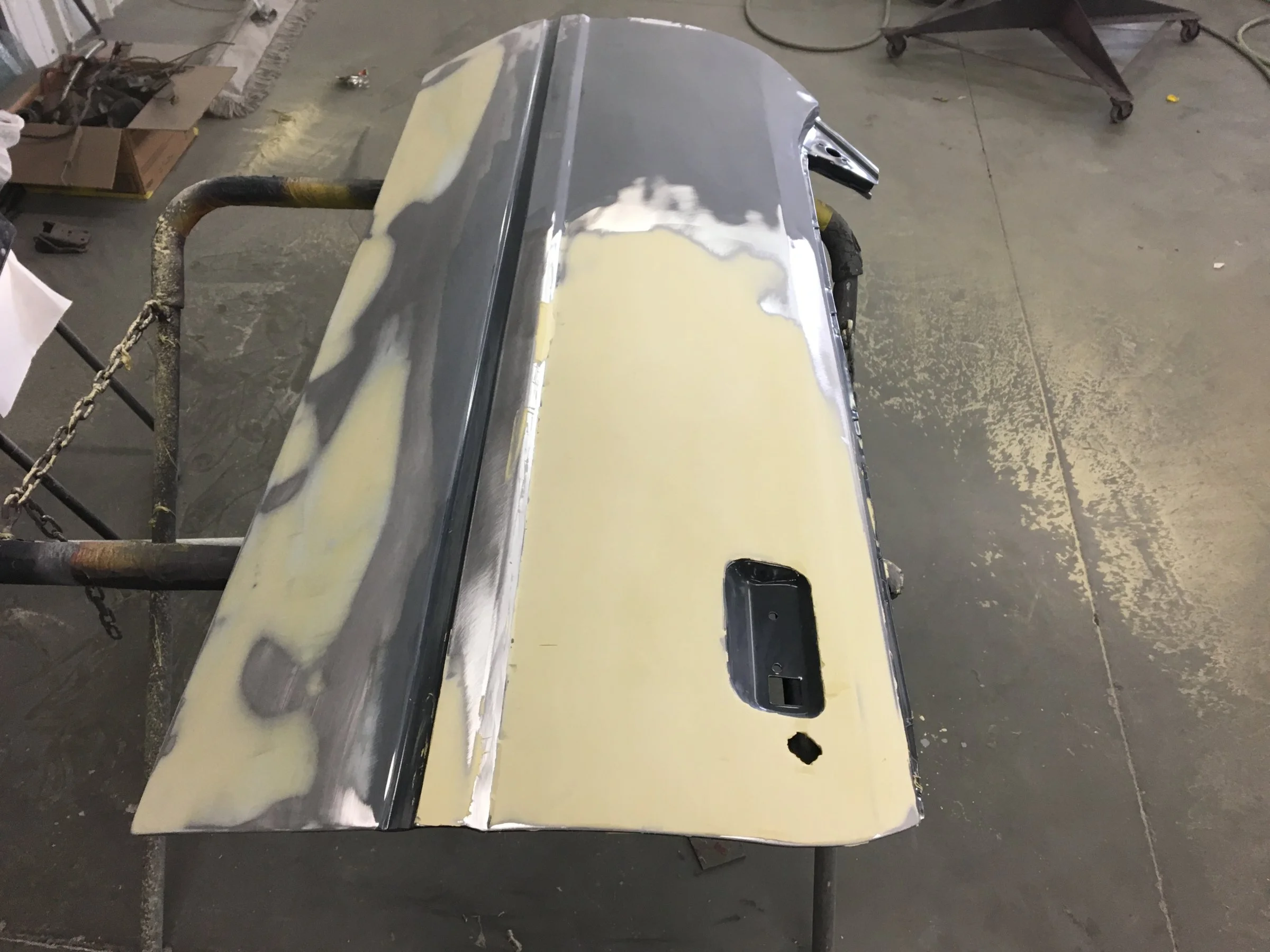

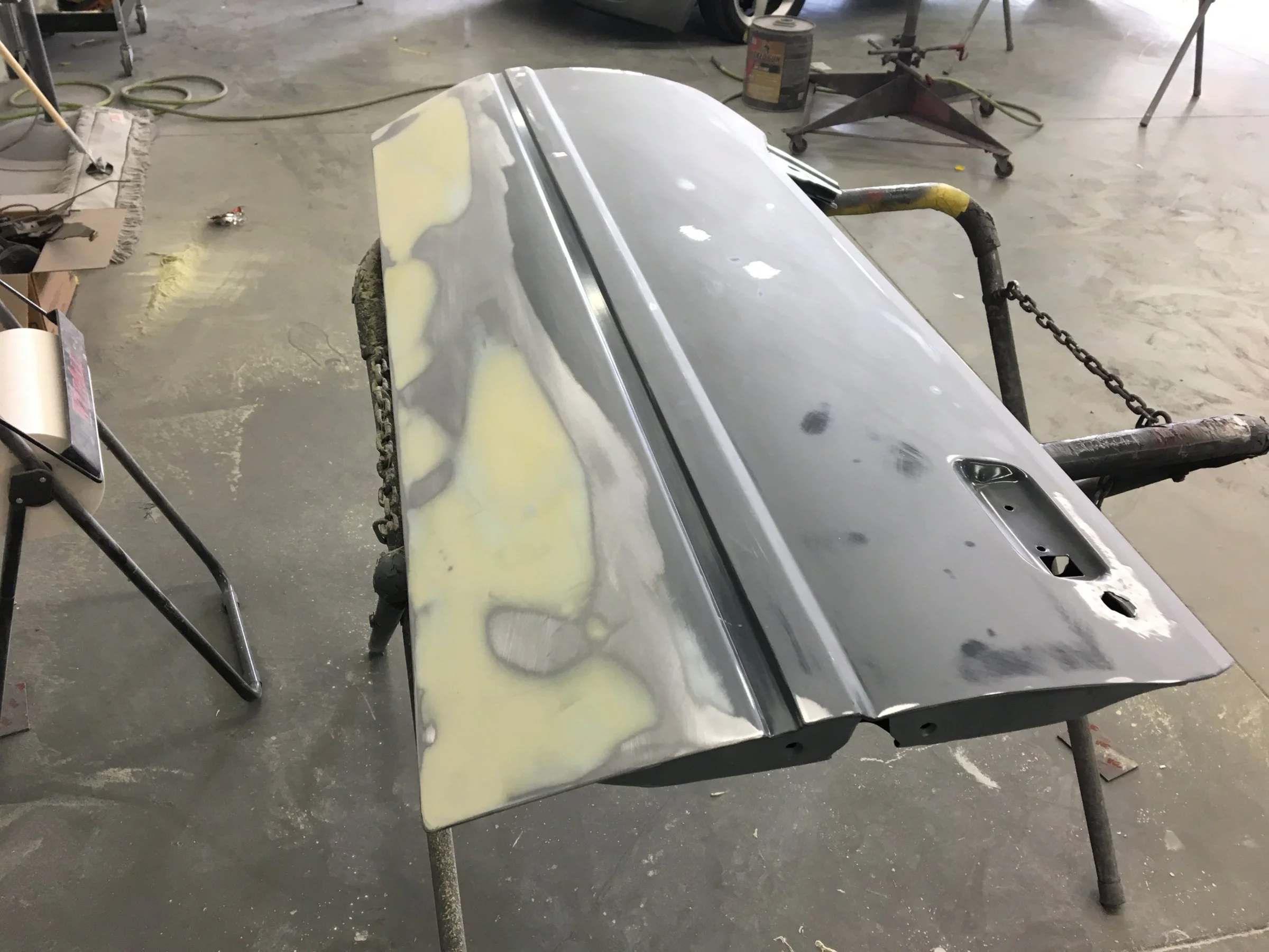

Then I mudded the lower. It blocked out very nice. Those fox lower door waves are no more.
I had a little more time so I ground the primer out of the way around the door handle and slung some more mud. I'll block it out tomorrow.
Hopefully tomorrow I'll finish the bondo stage and be able to get it back in primer.
What kind of magical dent-pulling device is that?
It's similar to a spitznagel gun except for the fact that you don't weld on nails and hook up a slide hammer. The electrode on the handle micro welds to the panel and you slide the provided weight up the electrode. This pulls up on the electrode and the attached panel. Then a quick twist of your wrist and it's free from the panel to go to the next spot. Great device.
