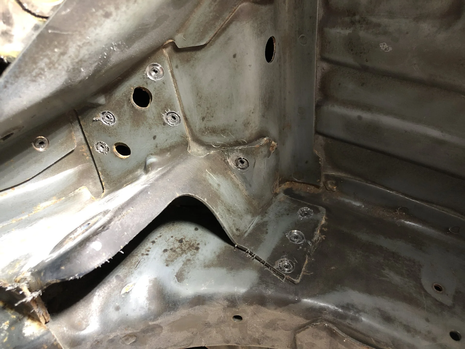

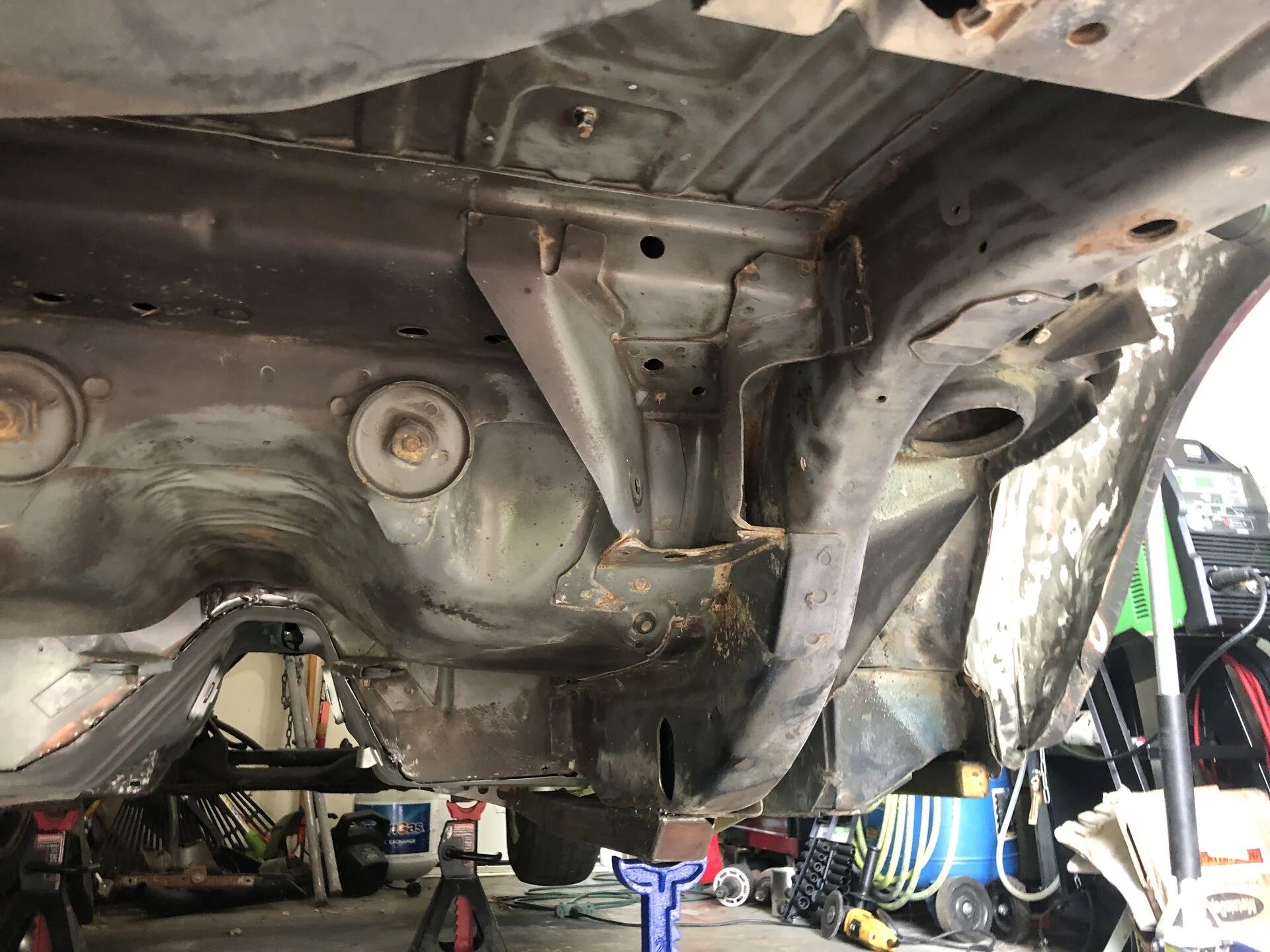

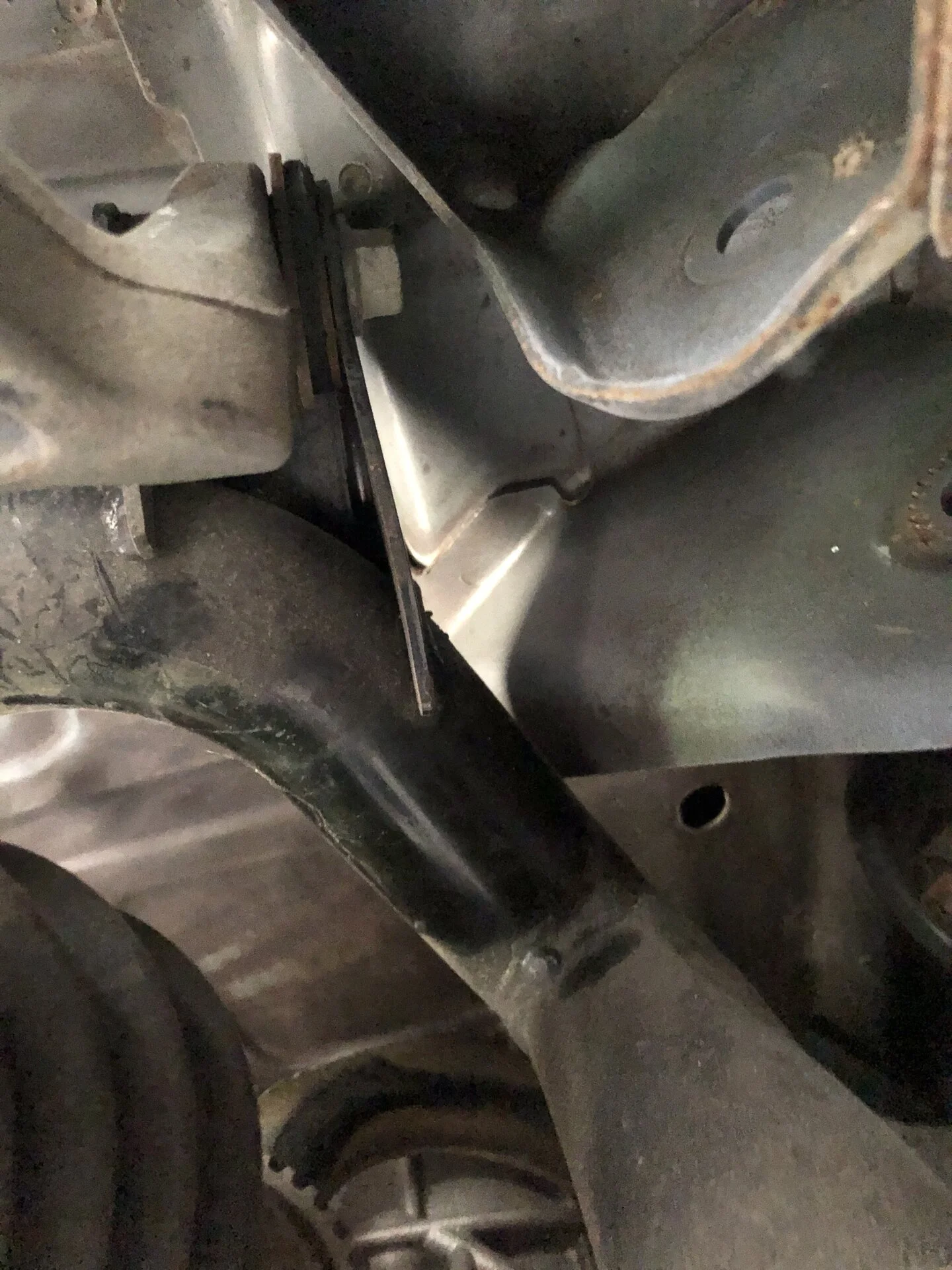

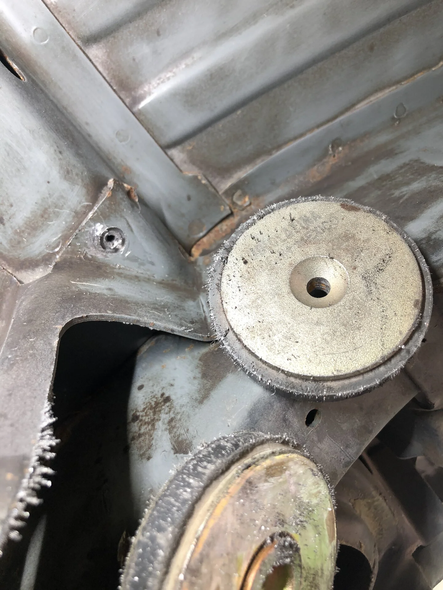

So out to the garage I go.......I have a mental problem I’ve decided.....I’ll cover that one towards the end of this post..... :nonono:
Anyways, What the goal for the day was to remove the right rear uca mount. Sounds like that would be easy, right? Let’s GET OUT THERE AND DO IIIIIIIIIIIT! Yep, let’s get right out there and do it........:nonono:
First, here’s a picture of the clearance between the irs frame and the uca mount, I’m not sure if there’s an eight of an inch free space there or not. There is clearance though, so why remove it? Because it’s ugly and unwanted, just like I was as a child:cry::cry::cry:.
Now to drift back towards the car...Here’s that brace looking all innocent and heck, “just pull me out of here real quick like Dave....”
So first off, I slap some old speaker magnets around the area to help avoid the metal shavings battle.
Back to the beginning of the post, my problem. I start off with wanting to remove these brackets whole, Idk why, It started with Doby and continues here. After using the old spot weld cutter for the first four welds (there are 21 on this side) I realized that maybe I wouldn’t be removing this bracket in one piece. This is some seriously thick metal the brackets are made out of. Yet I persisted in my delusion and went after the tougher to get to spot welds on the inner part of it. So ten spot welds cut and it took me an hour and a half and my hands hurt.
Now that I rid myself of removing these pieces whole, tomorrow I will pick up some cut off wheels and grinding wheels for my die grinder. This rat bastard bracket WILL be off there tomorrow night and it can be in tiny little pieces for all I care!
Why not tonight you might ask? It started raining and half my body was sticking out of the garage as I worked on this.
