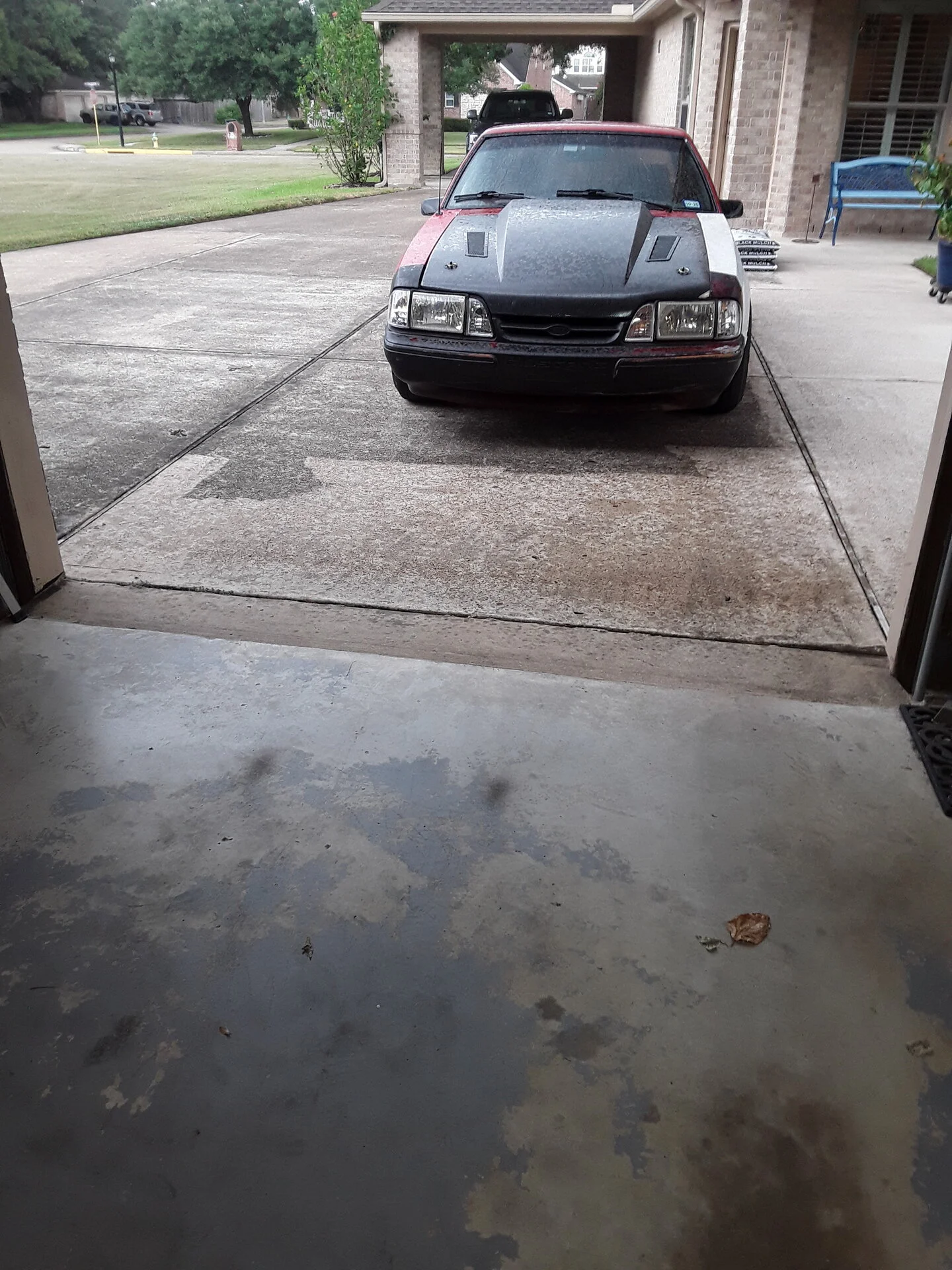

Put a new starter in. It starts faster. But the hot start issue still persists, apparently. Also ran the computer ground to the battery. Just cuz that needed to be done.
Also had my old 3k rpm cut out problem arise again. The new fuel pump did fix that for the last 6 months.
The ear was broke on my old starter, and the internal ms didnt look much better. Gear teeth were fine though.
Was all excited b/c rain came and thought i was going to get to drift. But failed when the 3k cut out arose. Smh. Lol.
