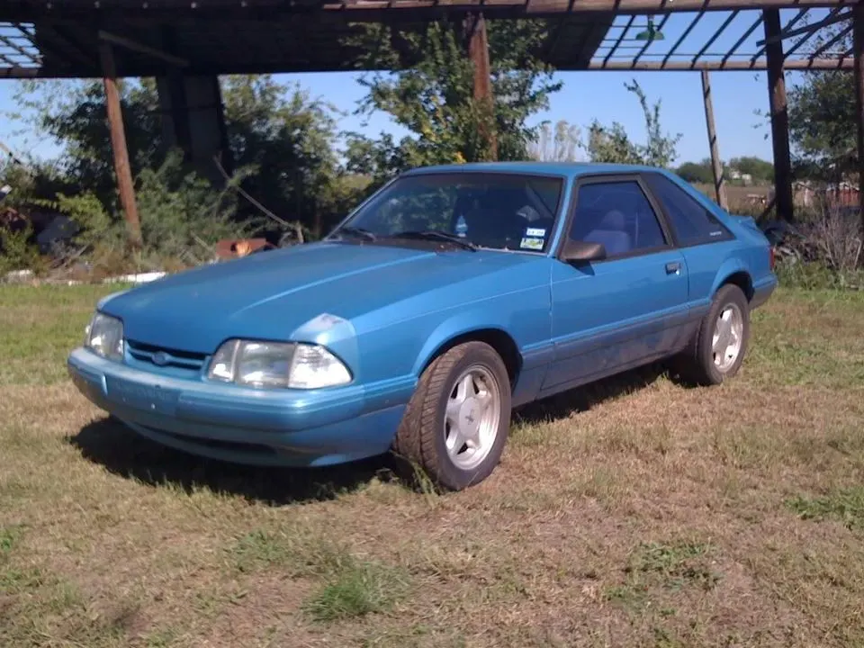

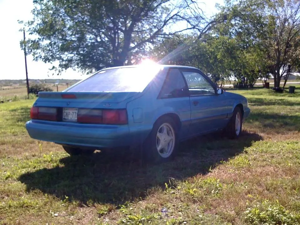

looks fairly clean.
another good upgrade to do is the 3G alternator - give you 130 amps and over 100 at idle - very nice and fairly easy mod especially if you have a stereo in the car.
Mar 15, 2011
185
17
looks fairly clean.
she only has 55k miles, and i do have a component system and HU. i need to pick up a 10" and amp. not a fan of massive dual 12" "im a 17 year old punk and like to blare my bass" style. just need a little bass to even out the high's of the tweeter system
