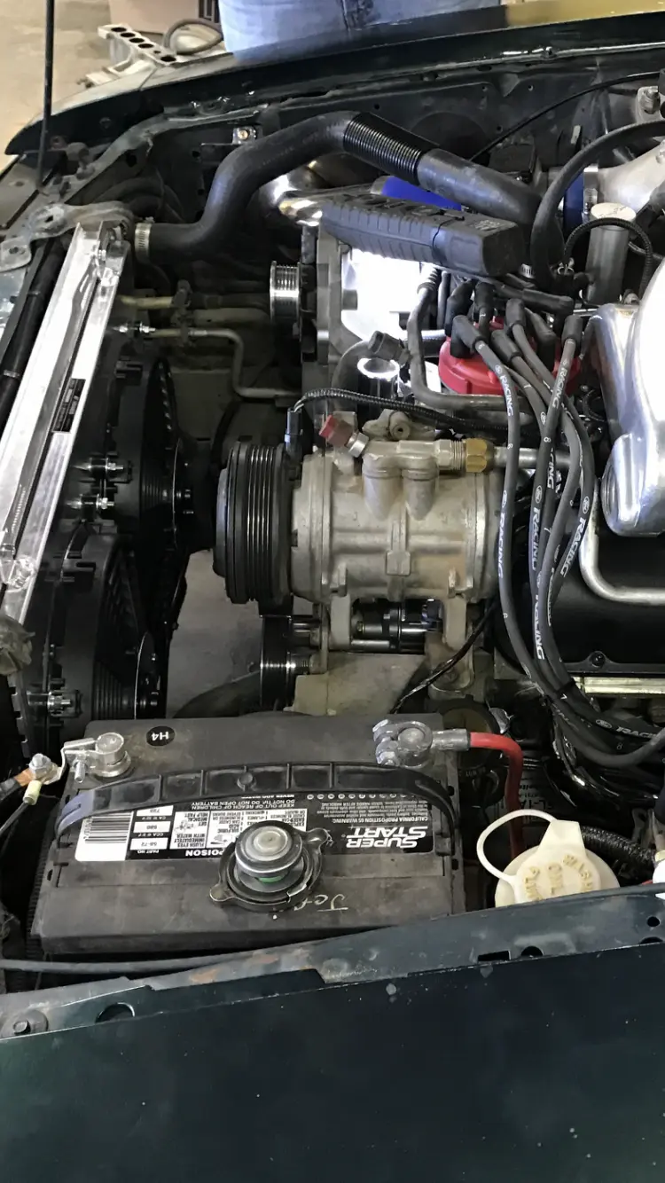

Also grab a pic of your mass air sensor and the part number. Have you unplugged the mass air sensor to see if it runs any different?
I'll get a better that's when the new motor is inCan't really tell but it appears your ground wire is kinda puney, is this the current condition of the engine or old picks of when you were putting it together?
Ya grounds r there it was just a bad pic it's the same size as the powerOk, this is going to take some testing. Need to find out what changes when it starts running bad, first we need to make sure the fuel pressure stays constant, thats going to require a fuel pressure gauge that can be read on the fly. Also need to check voltage on the fly, and not with the stock gauge.
