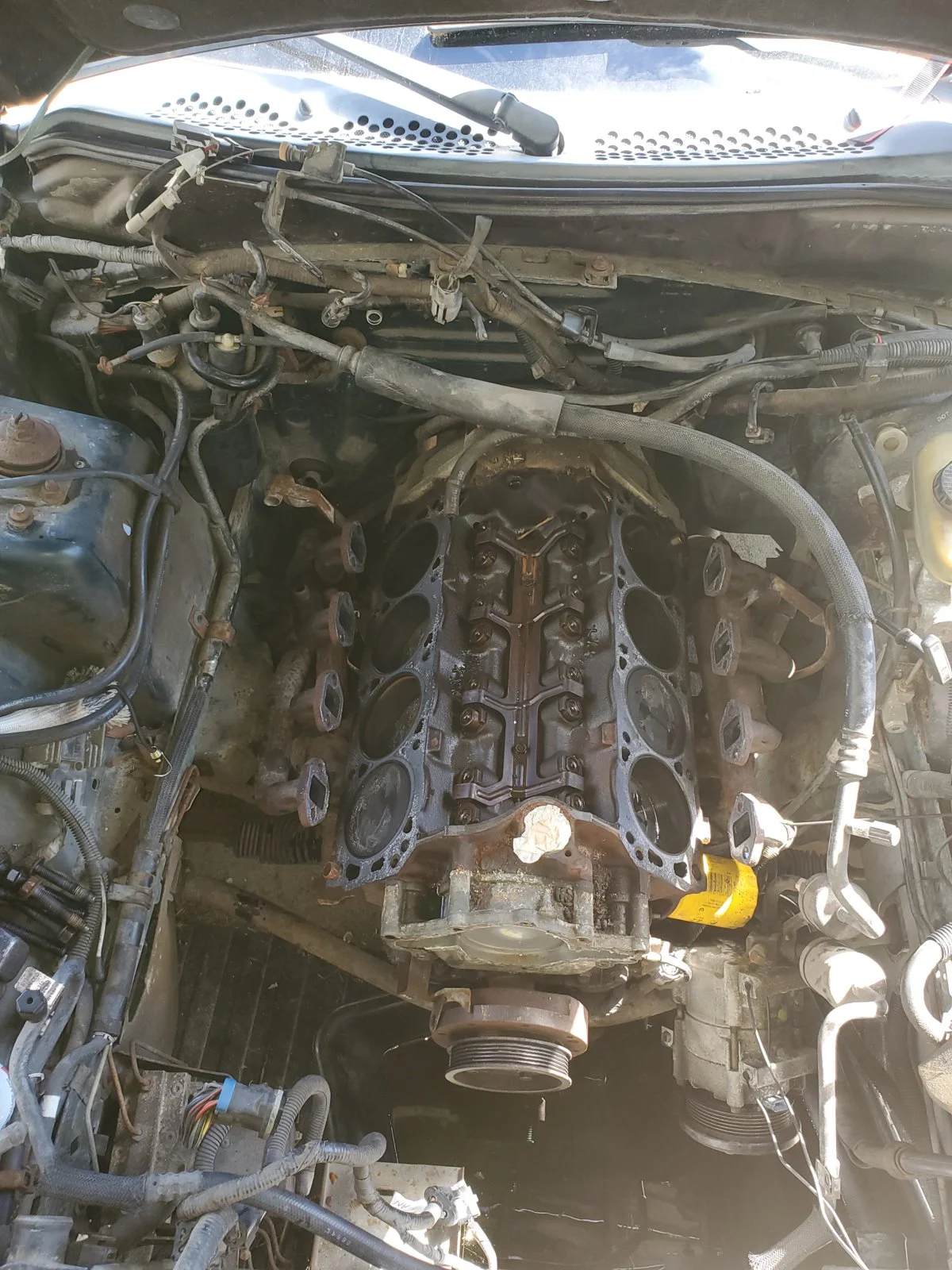

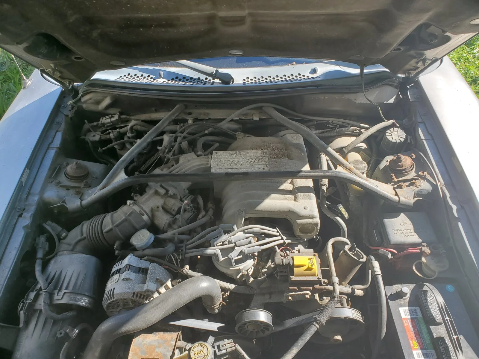

Here's what I started with:
All tore down:

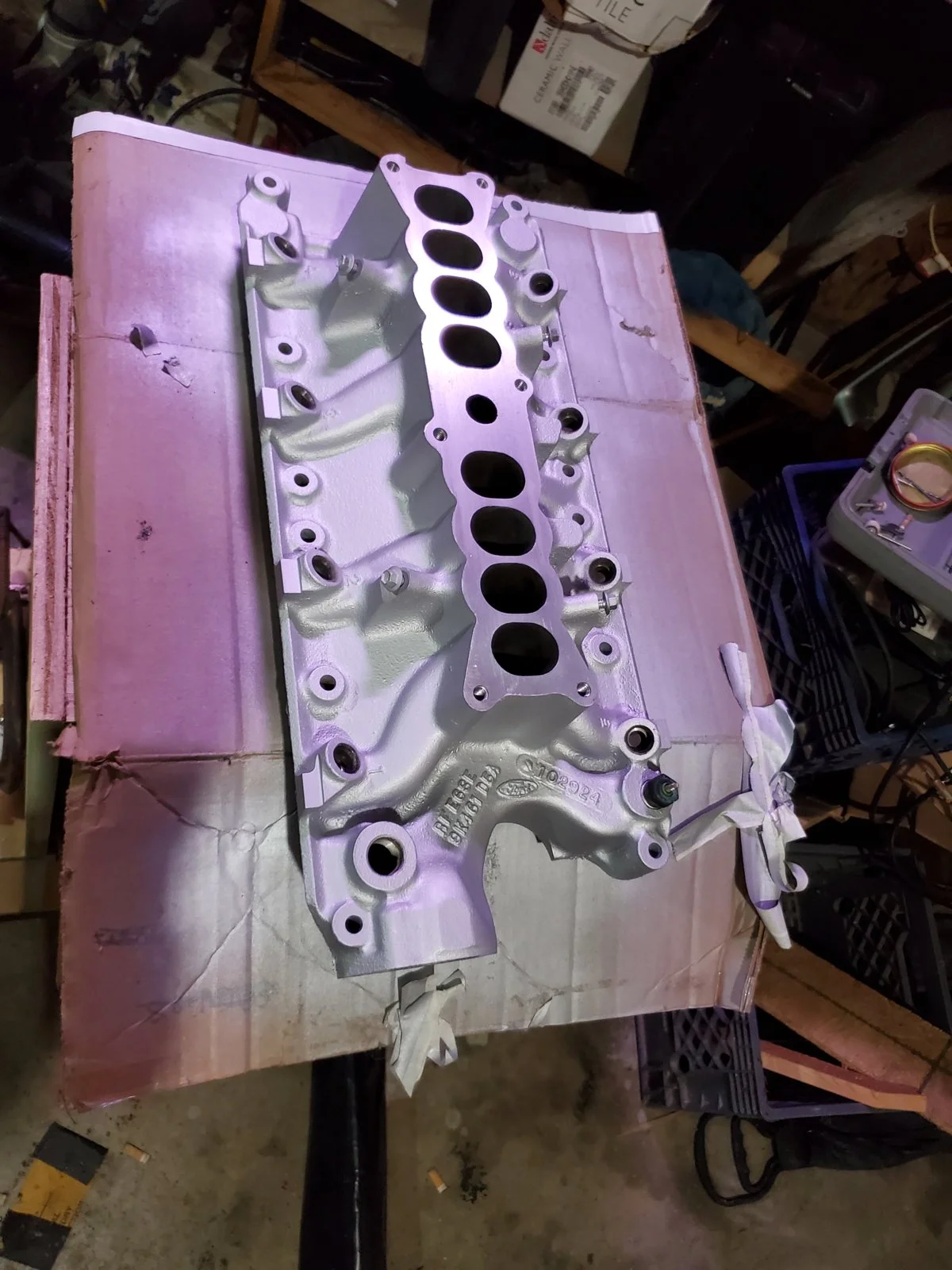

Starting to sandblast and paint:

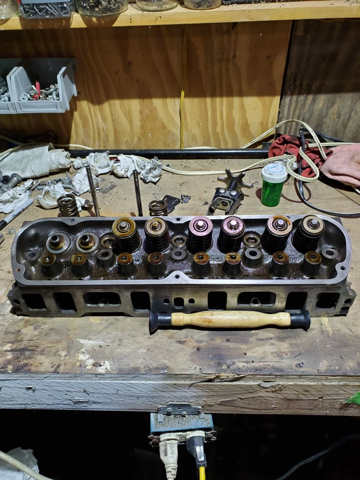

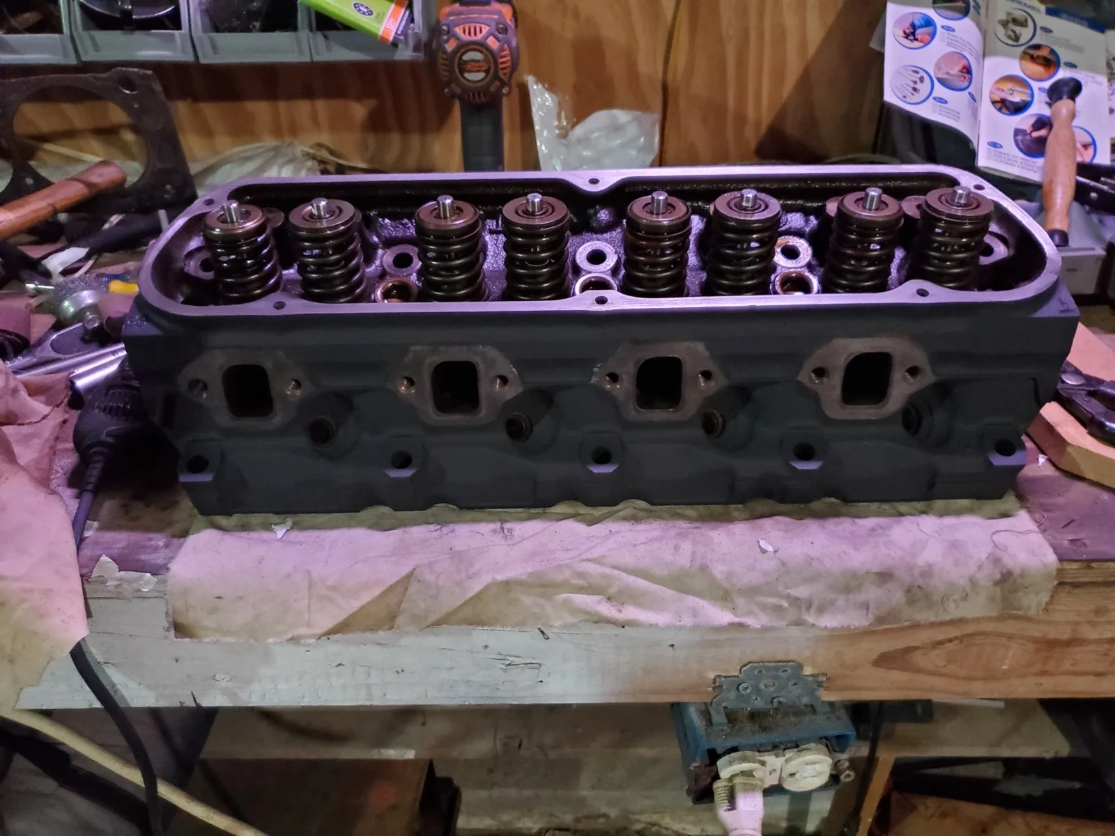

Lapping valves and cleaning up heads:

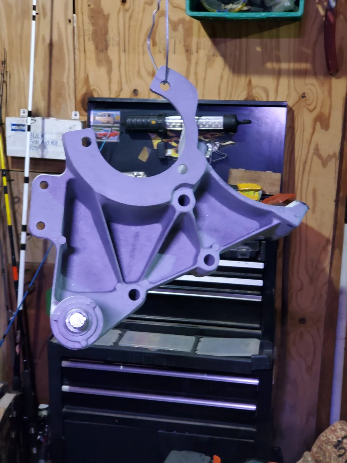

Flat black for the heads since they were outta gloss:

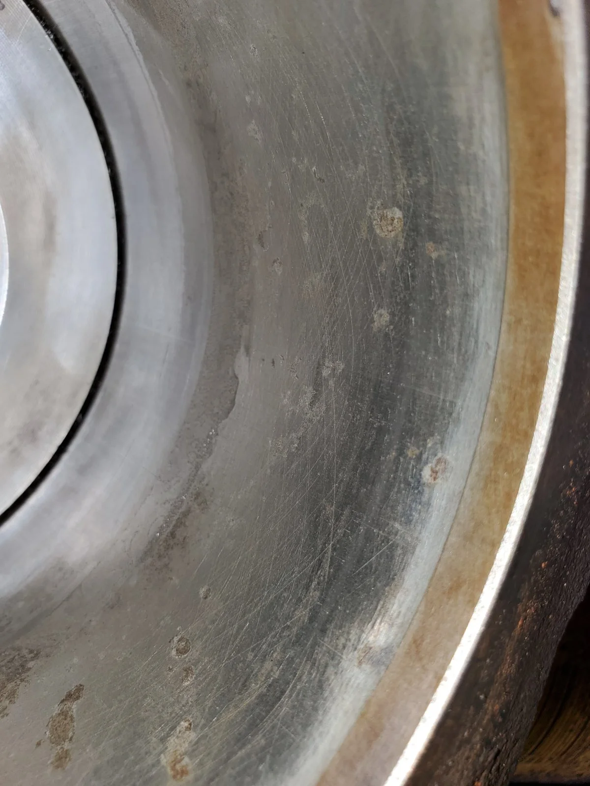

Also had a bit of a hiccup, didnt get all the coolant out of the cylinder and had a little corrosion in cylinder #5. But I'm just gonna run with it because hey, budget build man.... broke dad here.

That first picture got me a little aroused. That's a totally unmolested SN. All original parts just dirty and corroded as nature intended. It all looks good so far. Don't sweat that little water spot in the cylinder bore; it won't amount to anything.

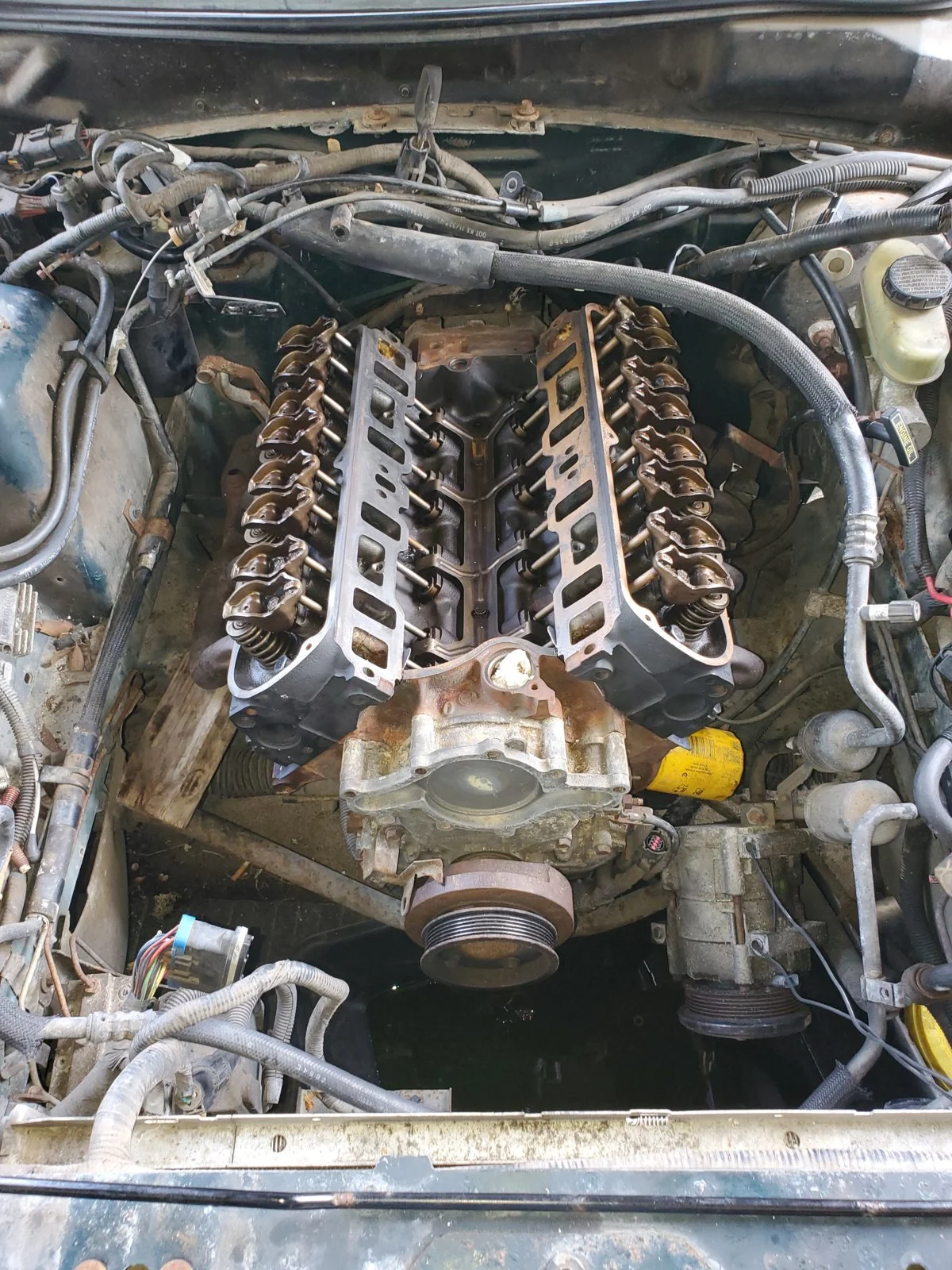

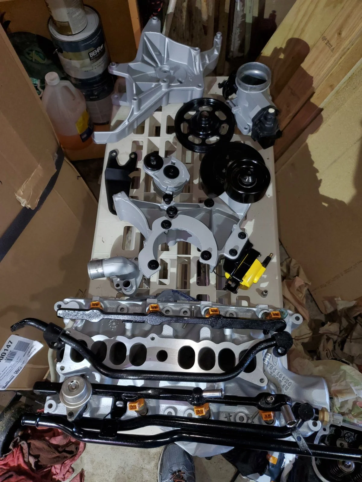

Hey guys, Been kinda crazy around here the last few days and havent been able to get much done on the mustang. I did manage to make it down there yesterday for a little bit while the septic guy was here. Got both heads on now.... on the right side haha. Got push rods and rocker arms put on too. Ready for valve covers and lower intake manifold now. Got a little surface rust to clean up on the drivers side head where the intake manifold gaskets go before I put it back together. You guys got any recommendations? Or will it be fine... it's not "feelable". I should make some decent progress tomorrow if things go as planned. We shall see.

The correct procedure would be to take the head back off, and use a rust dissolver to neutralize the rust, then re install the head. The reason being is that if you apply any chemical to the head and let it sit while it's on the car, the chemical will get into the valley.
I am not going to recommend that route. I always tack all my gaskets anyway. The tack will contain any rust and seal the irregularities. Just cover the metal surface in this stuff and stick the gasket to it.
