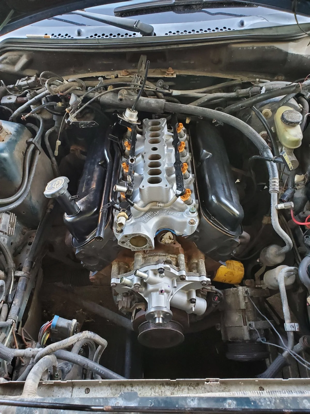

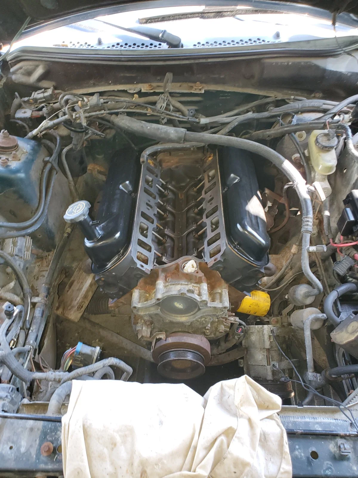

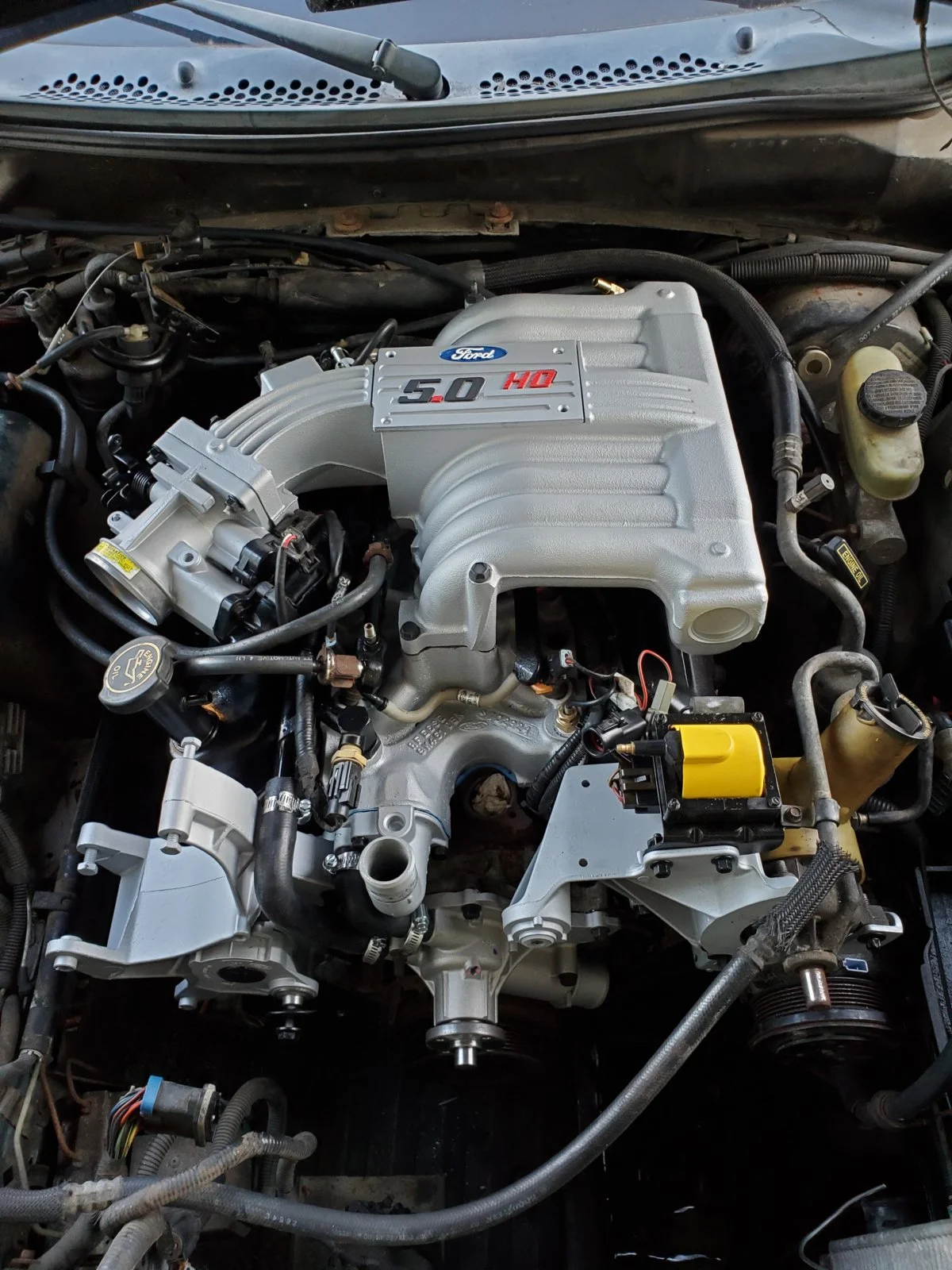

What's up guys! Had a fairly productive day today working on the mustang. First thing this morning I ran to auto zone and grabbed some of that gasket tack and some more black rtv. Started of putting on the valve covers and getting the exhaust manifold bolted back on.

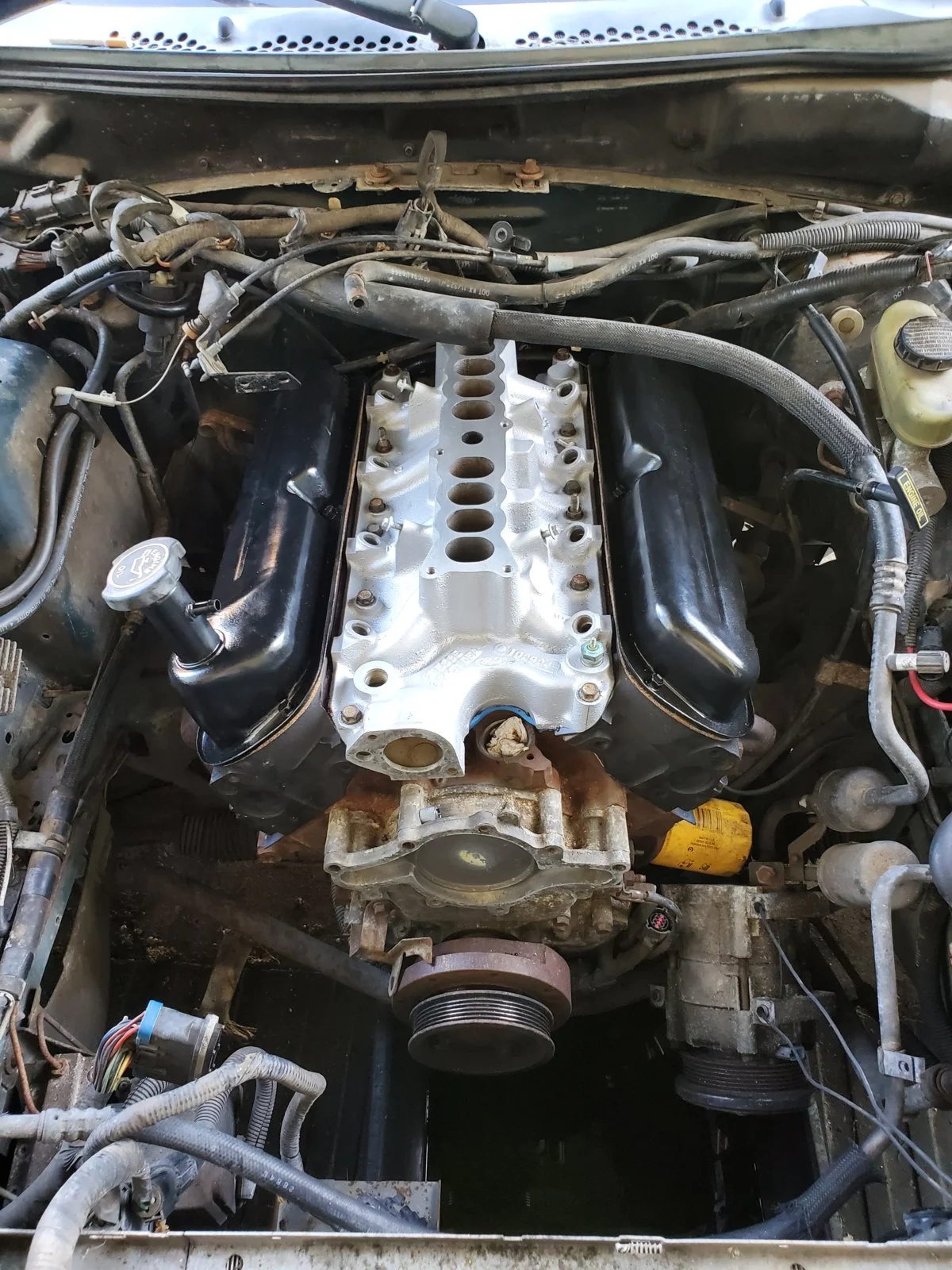

Then I moved on to the lower intake manifold
Next was the water pump, heater tubes, and injectors
I think tomorrow I'm gonna go ahead and change the oil filter then put my accessory brackets back on. Then run wiring harness's and work on the upper intake manifold and vacuum lines. I can see it coming together and I'm getting excited

Lookin good.
I don’t know how many times you’ve done intake manifolds, but make sure you go over the final torque sequence over and over again until nothing moves anymore. You would be surprised how many passes it takes before everything settles and the bolts stay tight. Usually it’s like a half dozen times.

Well I've never done one before. But did I go through the torque sequence till they all clicked... took about 3 or 4 times I think. Hopefully it doesnt leak, I used that gasket tack on the heads and manifold and rtv in the corners and under and on top of the rubber end seals. Guess we will see what happens.

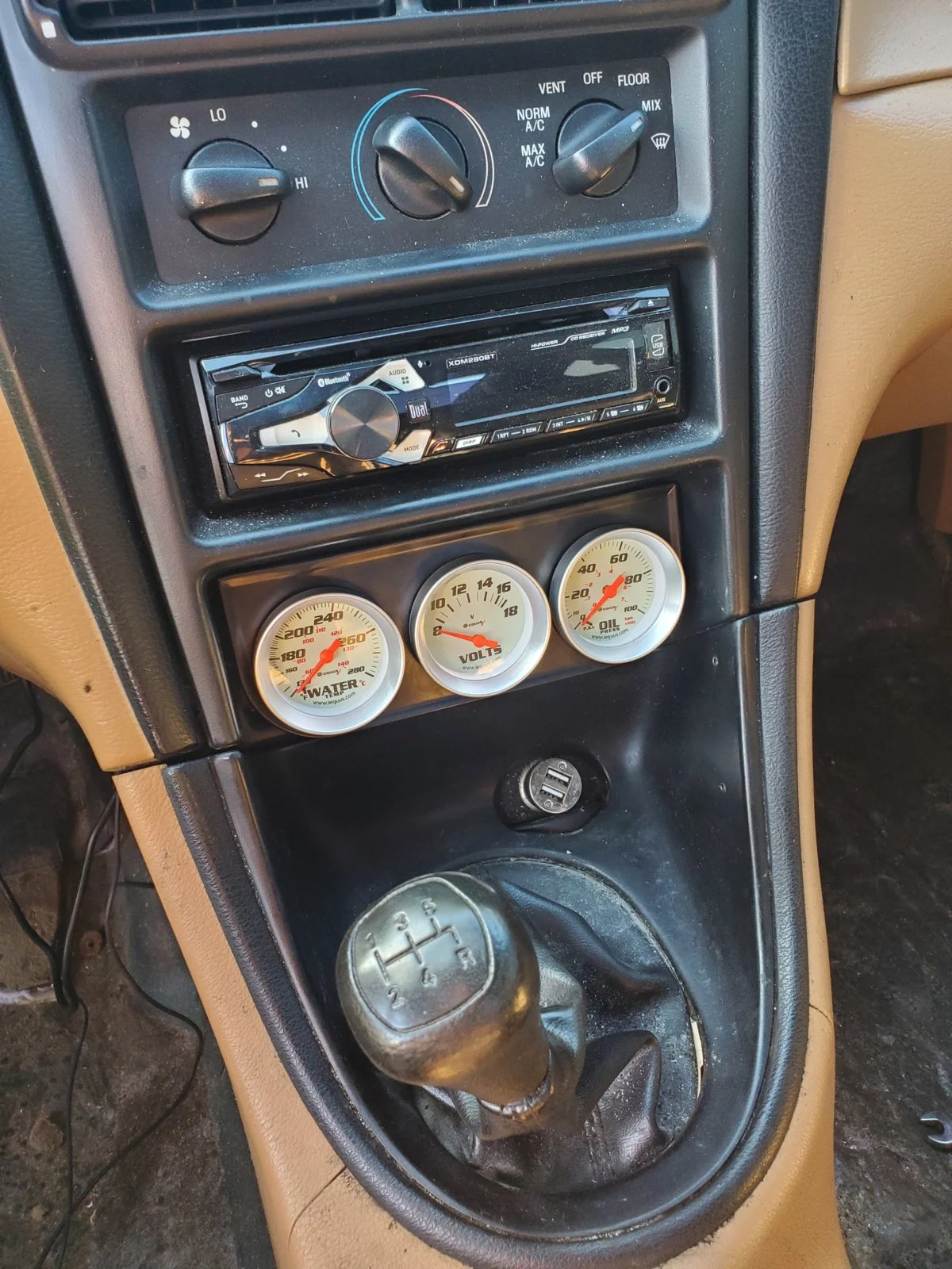

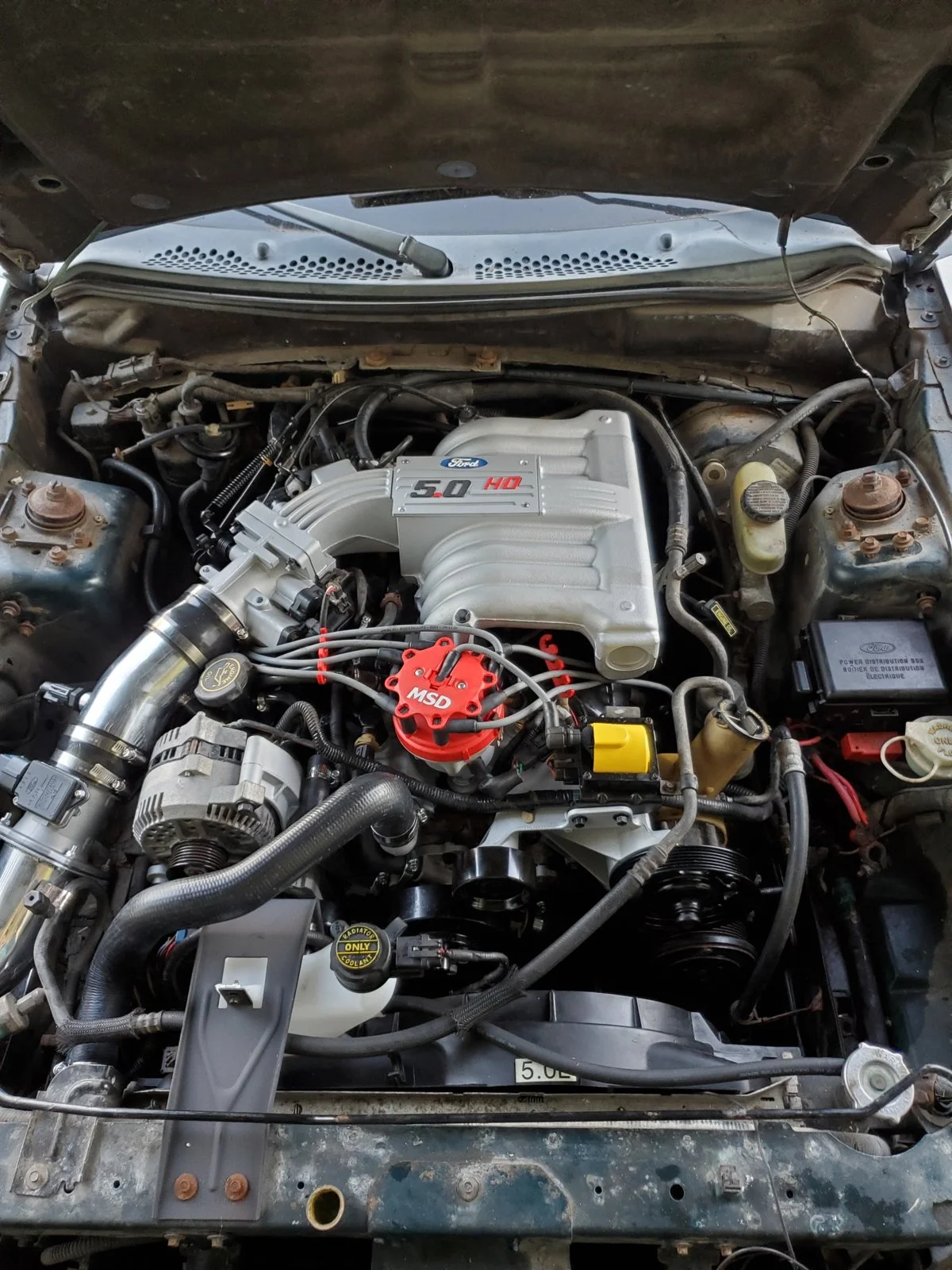

Well guys another day down. Put a pretty good dent in it today. Started the morning off getting an oil filter and some vacuum hose. Also picked up a 3 gauge set with water temp/voltage/oil pressure. Got the gauges hooked up and the drivers side injector harness ran, then the power steering and ac bracket got put on.
Then I moved on to the other accessory bracket and the heater hoses, along with the passenger side injector harness. Upper intake was next along with the throttle body and a bunch of other little crap here and there.
So far I'm liking it. Let me know what you guys think.

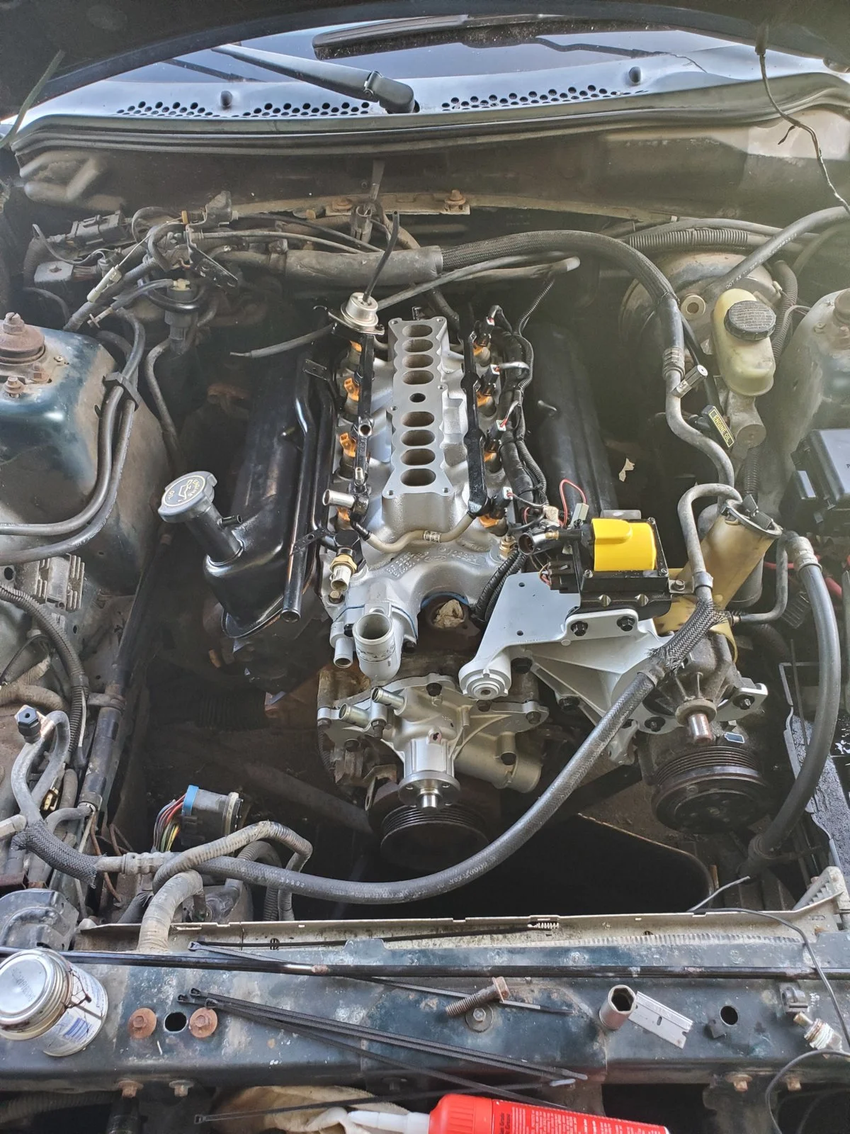

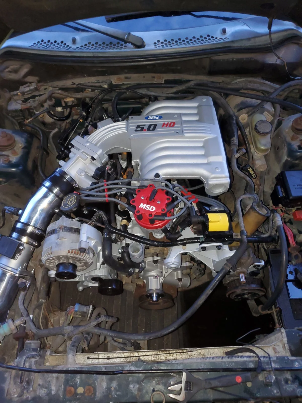

What's up everyone. So today didnt seem near as productive, although I did get alot of little things done. I also got my alternator cleaned up and installed along with my el cheapo intake and the throttle cables.
Since a storm rolled in I took the time to clean up the distributor and paint the base. After the storm passed I installed the distributor and plug wires.
Tomorrow I need to get plugs, a new dist. hold down(I lost it somewhere), and a shorter belt (deleted smog). Tomorrow I will work on the accessories and get my fan put back in. Also need to pull the fender and finish vacuum line to the charcoal canister and put the filter on the intake. Hoping I can try fire it up tomorrow night.

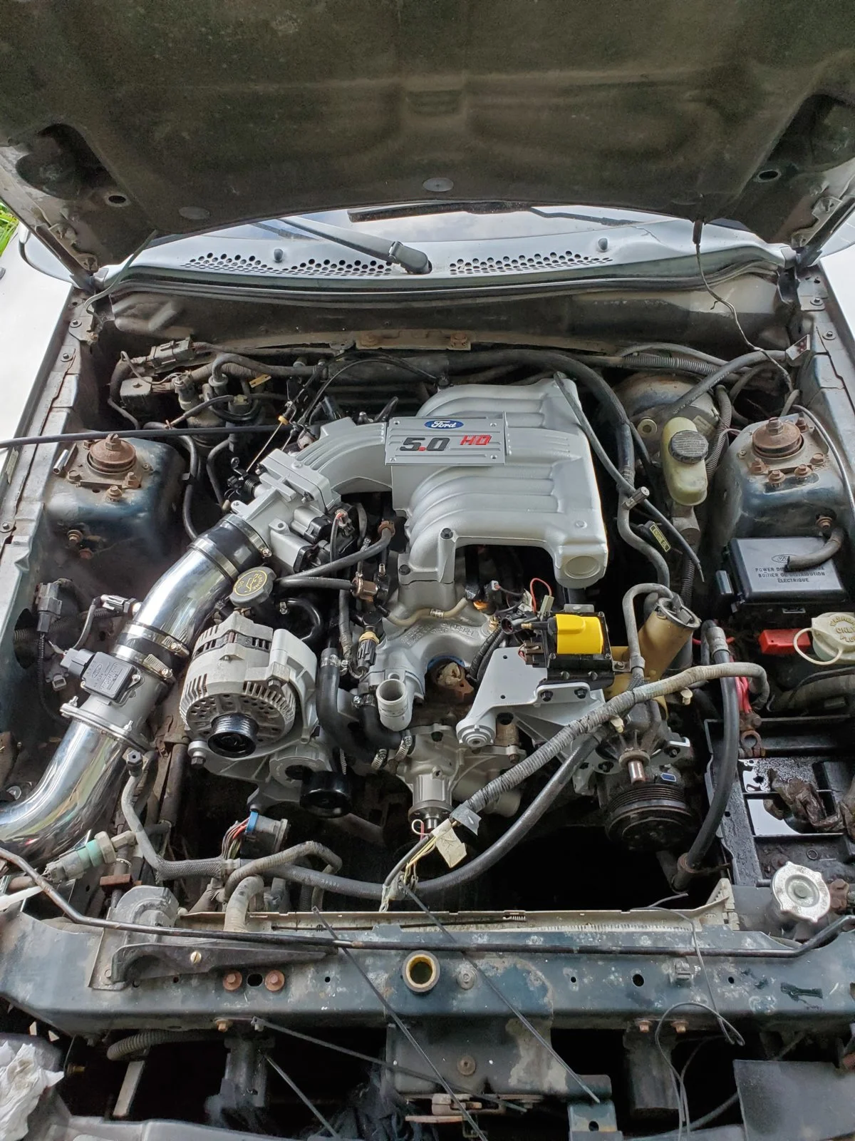

OK need some help.... got her started. I was 180 out on the distributor. Now I let her run to operating temp and she kept going so I shut it down. When I opened the radiator cap water was still cold. I have a 180 degree thermostat and a reverse flow water pump. This is the belt routing I used since I deleted the smog.
Is my water pump running backwards?
