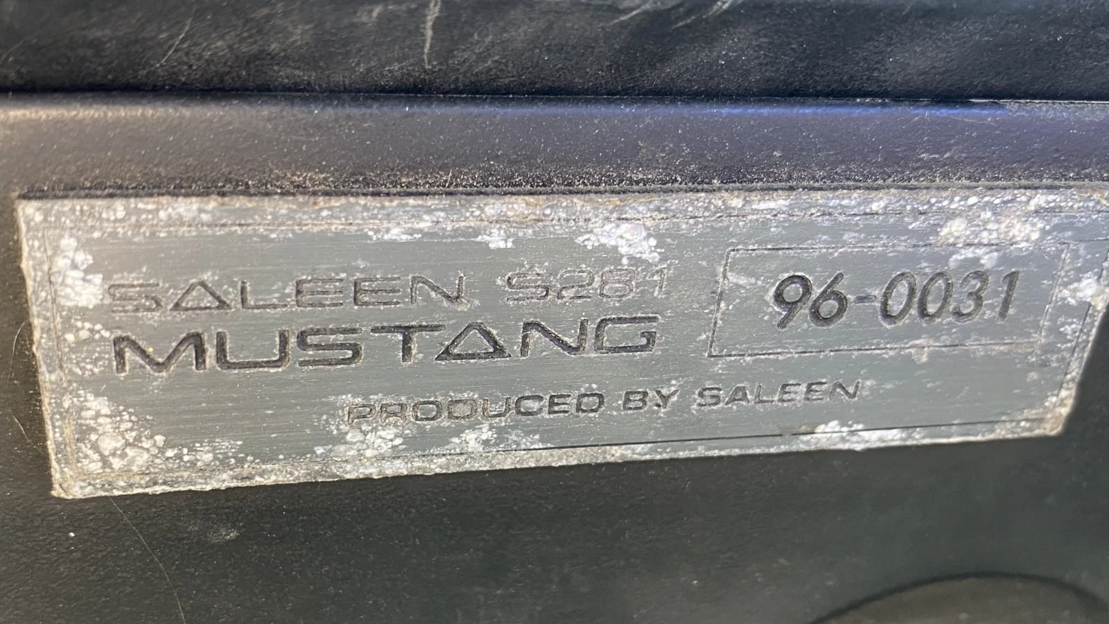

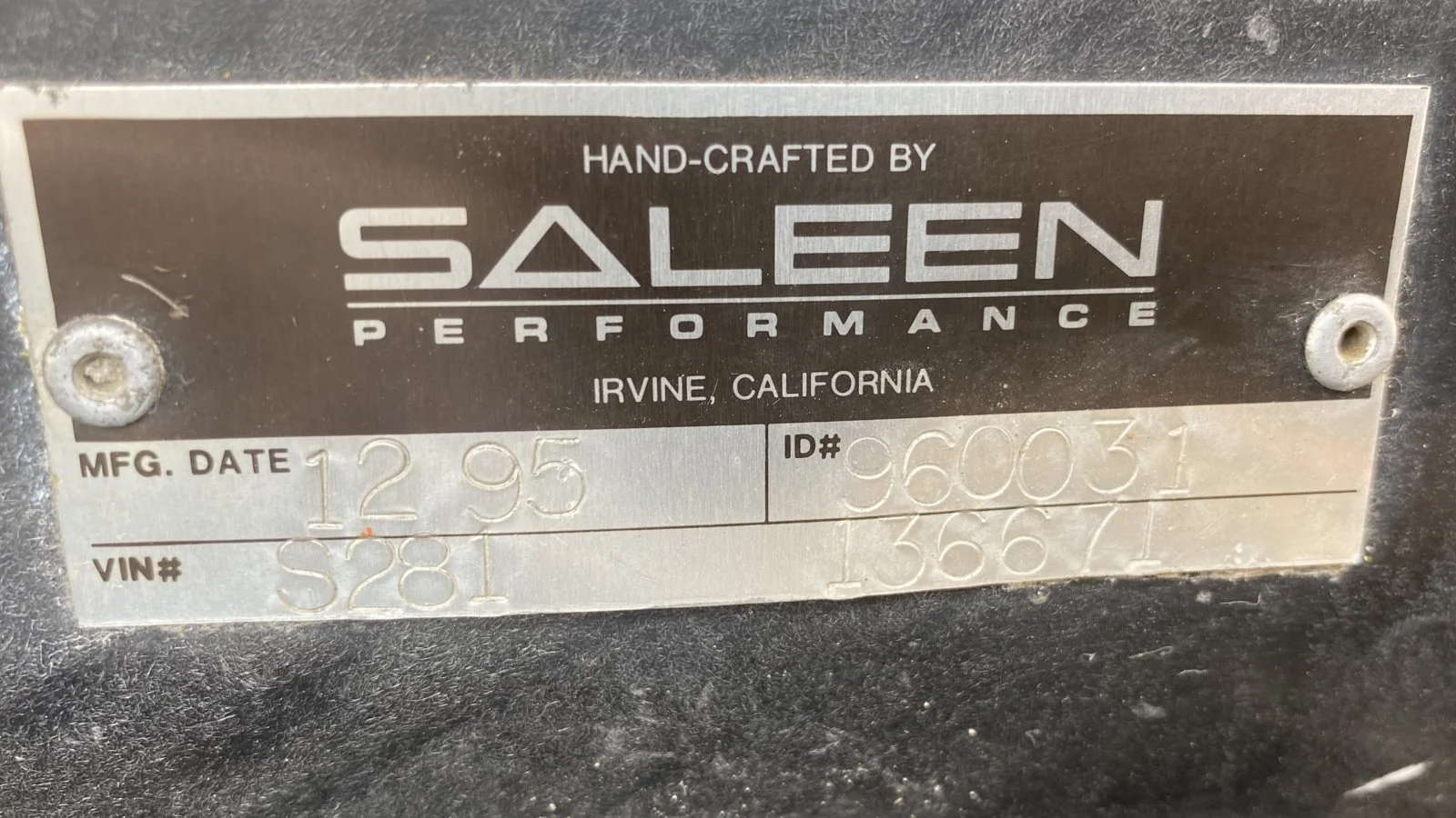

A few years ago I posted a thread here about a 96 sn95 drift project. Both the engine and transmission needed to be rebuilt which is why we were first thinking of doing an ls swap. The car had a Saleen bodykit on it but I first thought that it was just a clone. Turned out that it is a real Saleen S281. I found a plate in the interior with the saleen stamp, build number, and VIN. A similar plate was also placed in the engine bay above the firewall. When I put the car on a lift I saw that the car also had Saleen suspension. The interior was already reupholstered by the previous owner and the original seats were gone, but the floor mats only had covers which I removed and I found that they were S281 floor mats. The plan changed afterwards. I didn't want to ruin a Saleen more than the original owner had already done before. I finally decided to restore the car and not to turn it into a drift car.

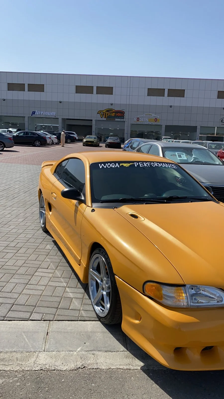

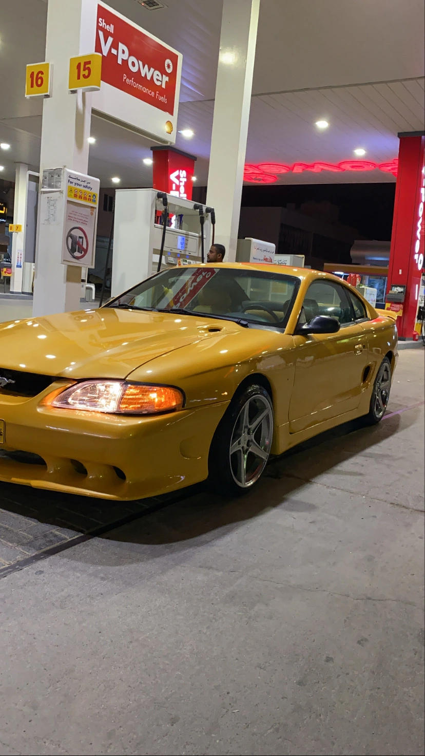

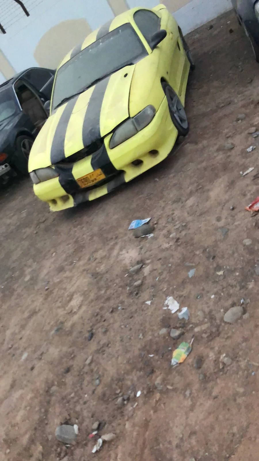

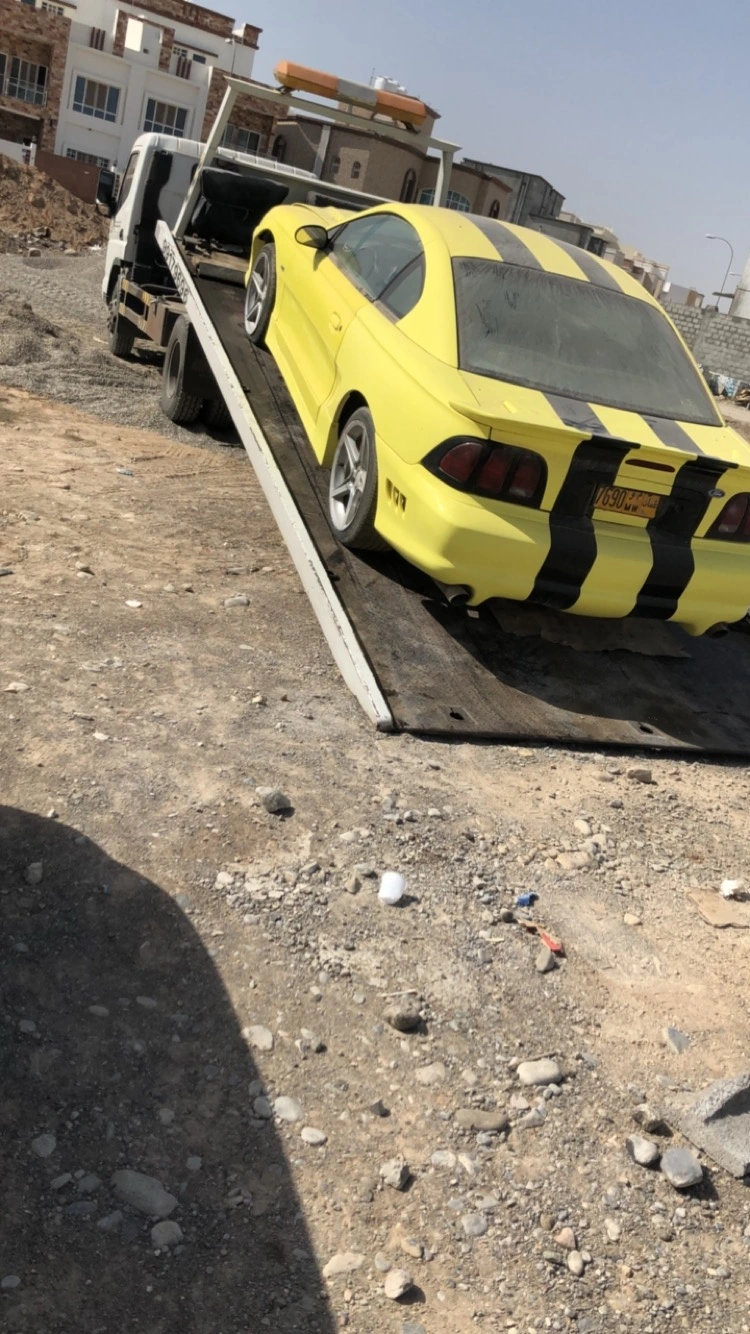

The car was originally bright tangerine but the previous owner repainted it with a very horrible shade of yellow with 2 thin black stripes (also painted on). The car had overspray everywhere (headlights, taillights, rear glass, fender well, engine parts and wiring). I decided to repaint the car with Yellow blaze tricoat which looks amazing. The headlights were replaced, taillights only polished, remaining overspray was either scraped off or painted over with a matt black rattle can. As for the interior, the car was supposed to be sent to a professional shop to be reupholstered last month. The plan was to strip the cracked dash and peeling door panels and apply new black vinyl/leather lookalike, the front seats were going to be reupholstered like the Mach I seats and the rear seats were going to be taken out and just have plain carpets instead. This had to be delayed unfortunately due to the shop closing because of COVID-19.
Estimated total cost until now: ~ $6k -$7k
Now for the pictures:
Buying condition:
Current condition after getting the car to a driveable and not ugly condition:

Just curious, what’s the bumper number off the car?
I wasn't sure at first, had to look up where to find it as the stickers were already removed as the car had been repainted multiple times. According to what I found on the internet, it is the same as the serial number in the plate in the dash and interior. The number I have there is 31.
