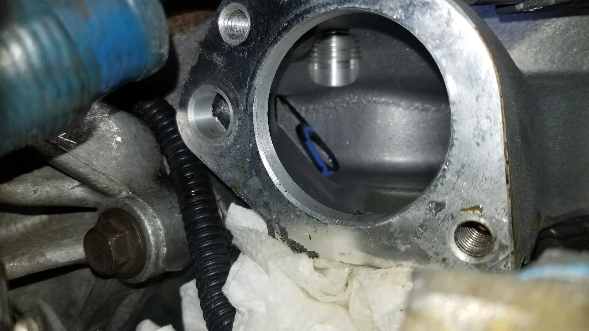

Best pic I could get, to the thermostat housing apart to replace the gasket, looked inside & saw that, can anyone tell me if that's normal? It's a piece of gasket, its attached but it's a strip of gasket that isn't between anything.

Looks like it could be part of the intake gasket that squeezed out ?
Whatever it is shouldn't be there, others will take a look and chime in as well.

See if you can snag that gasket with a bent clothes hanger or the like. May be a piece they cut off from the water port (felpro). However,if it continues to leak,take it back.

I was able to have my friend stop over & look at it, he said it was nothing to worry about, just the way the gaskets made, fits more than 1 intake, figures the shop I had do the work forgot to trim it, he knows foxbodys well & all cars for that matter, he's got a 10 second 87 fox that he built, I would've had him do the work on my car, but he hurt his back & had to have surgery.

Hi monkeybutt, how bout I put a new thermostat gasket on & its still leaking, its leaking from the intake side, dry on the housing side, my friend told me to call the man that did the work, & ask him about GM stop leak, that never leaked on me before,as long as the thermostat is in there right & I believe it is, guess its cause it's aluminum,(intake).
