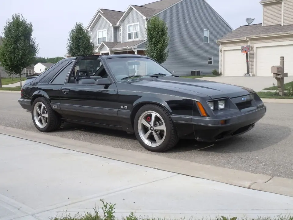

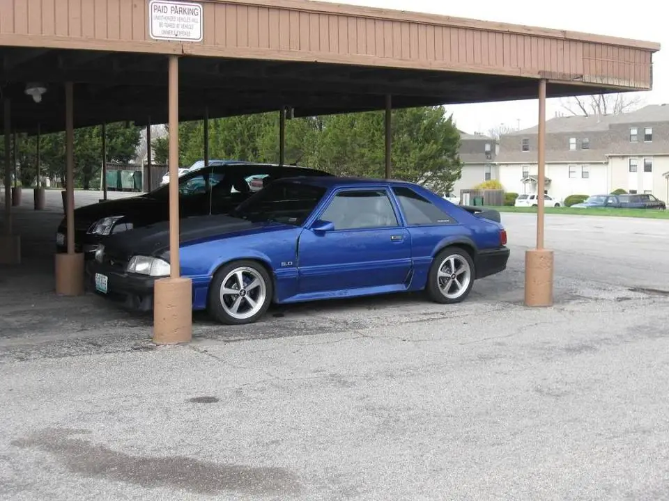

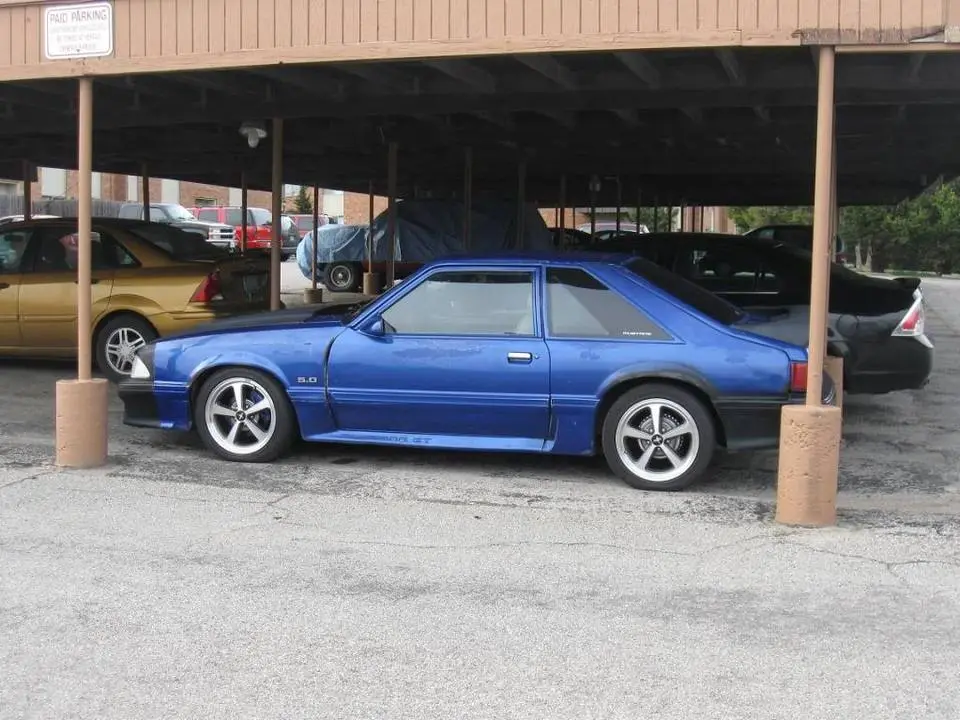

Mike!...There is an "easy" way. My rears are the AFS 17x9s, my fronts are an original set of Ford Racing Mach 1s, which are 17x8. The FRPP 17x8s are a perfect frontrunner for these cars. The grey paint AFS wheels are a nearly perfect match to the FRPP originals, you can't tell any difference once they're on the car.
The only problem is, the FRPP Mach 1s are no longer sold new, BUT I still see mint sets pop up on ebay from time to time, or on various Mustang forum classifieds.
Yep! And oddly enough, my car is a lot like Boss 351's... :D

'04 Cobra brakes, front and rear. 94-95 spindles, North Race Car brackets for the rear brakes, Yukon 5-lug Fox length axles.
