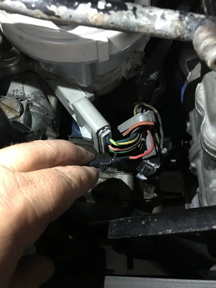

How is it that you know how fast a spotted ape runs?Well, I don't want to speak too soon, but the car is running. I rebuilt the distributor today, checked tdc, checked timing again, and nothing. That rotten so and so would not start. I did piddle with the timing more, and found something very interesting. When revving the engine, instead of timing advance, it was actually retarding. It took me a few minutes to recognize what was happening, and I thought, what the??!! That mark is going the wrong way!!!!
So.. Off to the google machine where i found this:
http://forums.corral.net/forums/5-0...g.html#/forumsite/20549/topics/1073990?page=1
There was a wire going into the tfi for whatever reason, was energized when it wasn't supposed to be. How this happened out of the blue, i have no clue. I pulled the pin out and taped it up, fired up and ran like a spotted ape.

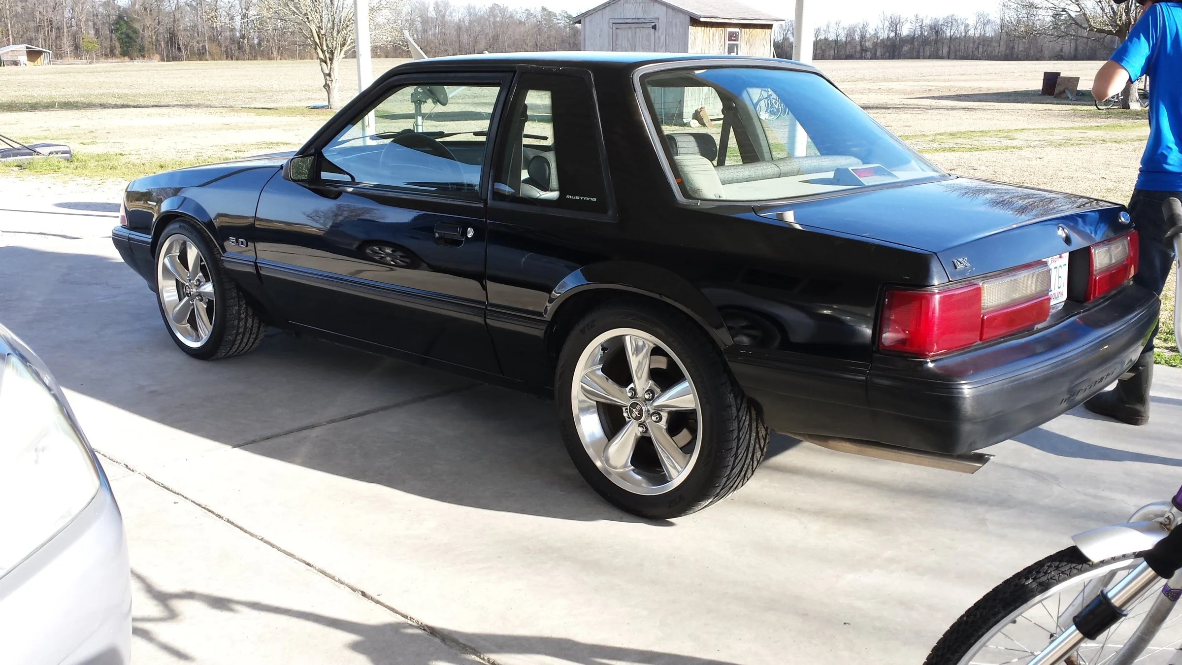

very nice... what rims are those?
Wait.....I thought those looked just like yours (here's your opportunity to pic whore)?They look to me like chrome bullitts. I've got the 2010 GT style. Close, but not exact.
Are those 18x8.5 ?
Thank you. 18x10 rear, 18x9 front.
Nitto NT01 275/35-18 rear, nankang 265/35-18 front.
