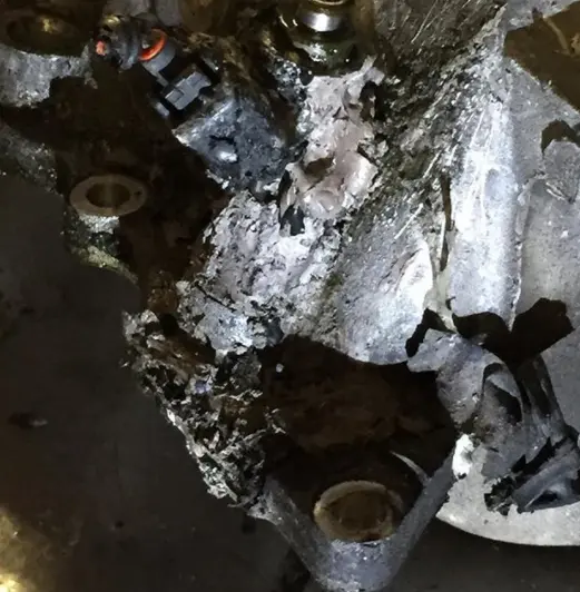

I have a 2001 Cobra convertible that I purchased at auction through Copart. It was a repossession, and it has 145,000 miles.
I've just now gotten it to run. The car was (and still is) a total mess. See the picture below for some of the things I've been dealing with -- that's JB Weld fixing a fuel leak. There was also a quart of gear oil spilled in the passenger compartment, the engine bay, hood, and fenders were painted black with flex seal, amongst other tragedies.
The next issue I have is that the car doesn't run well. At idle, it burbles like it has a miss, and the car shakes. Driving at low throttle inputs seems to work well, but, if you try to increase throttle, the car sounds strange and wont accelerate. It's hard to explain, but it reminds me of how my 75 Nova runs when the carb settings are off. The car also stumbles when you give it gas off idle.
I've researched this a lot, but it seems like these issues can be caused by a variety of items. I have made a few attempts at fixing my problem.
1. Brand new fuel injectors (from eBay, supposed to be an exact replacement for factory)
2. New alternator
3. New battery
4. Replaced IAC
5. Replaced TPS
6. Replaced PCV
7. Fixed vacuum lines and checked for leaks using cigar smoke (I actually found one)
8. Cleaned throttle body
9. Checked coils and found one that looked a little rough and replaced it
I pulled the coils off of the plugs while the engine was running, and each of them was indeed providing spark (could hear the arcing). I also pulled the injectors one at a time, in each instance, the idle got worse and recovered when the injector was plugged back in. I've been hoping that the car will throw me a bone and give me a check engine light, but no such luck.
My next plan was to replace the fuel filter, then the EGR, but at this point, I'm just throwing parts at the car. I have a datalogger, if there's anything I can look at to help figure this out.
It's important to keep in mind that this car is a total unknown, and it was severely mistreated. It doesn't however, seem to be burning oil, nor was there coolant in the oil. I think it's safe to assume that anything I haven't touched hasn't ever been serviced (why I am looking forward to changing the fuel filter).
Any thoughts on what I shoul do next?
