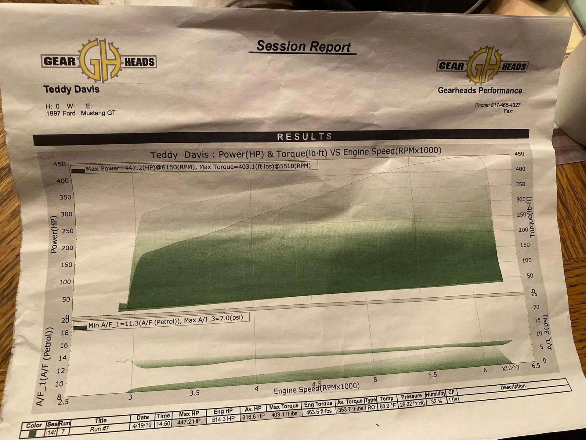

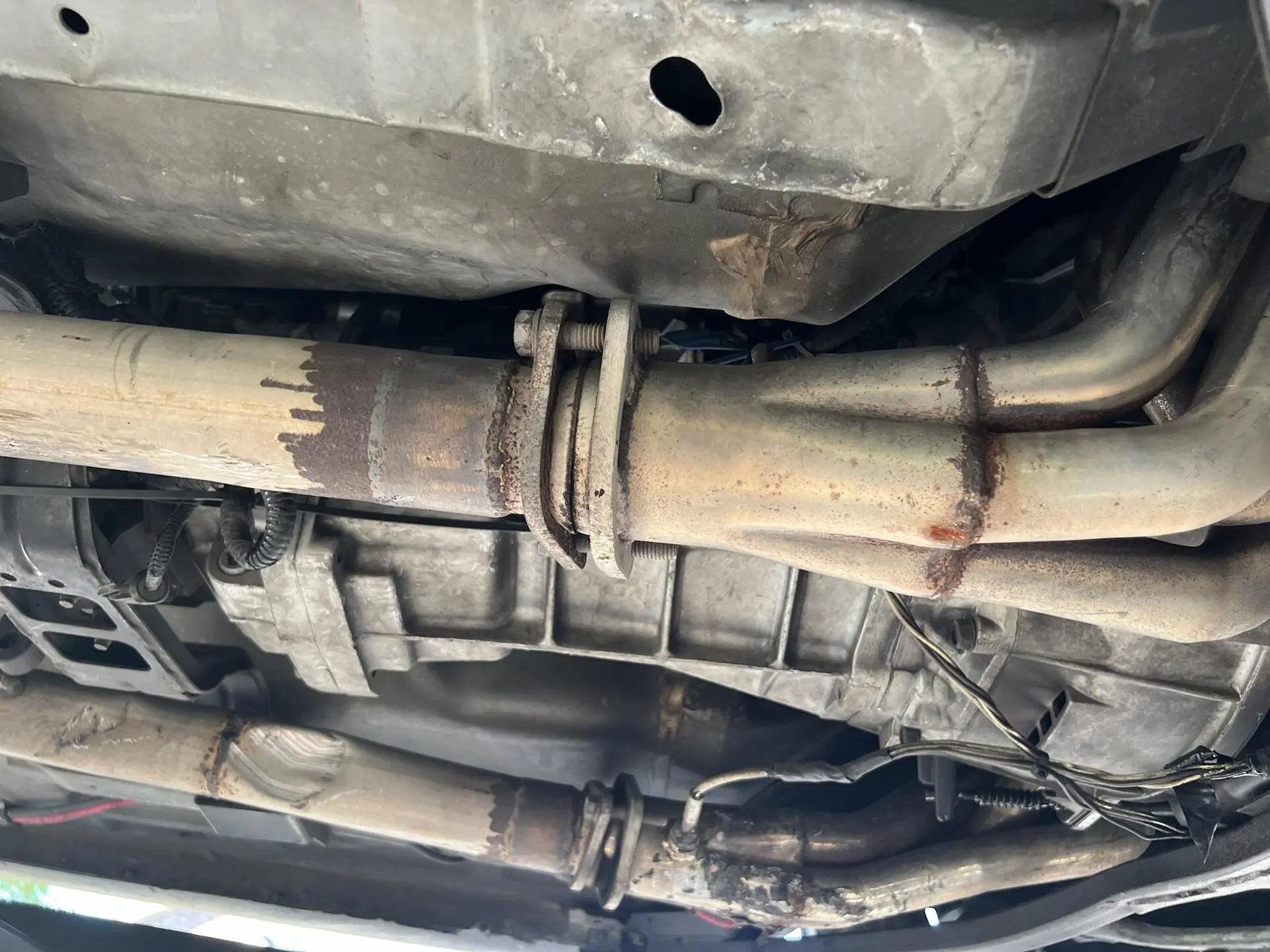

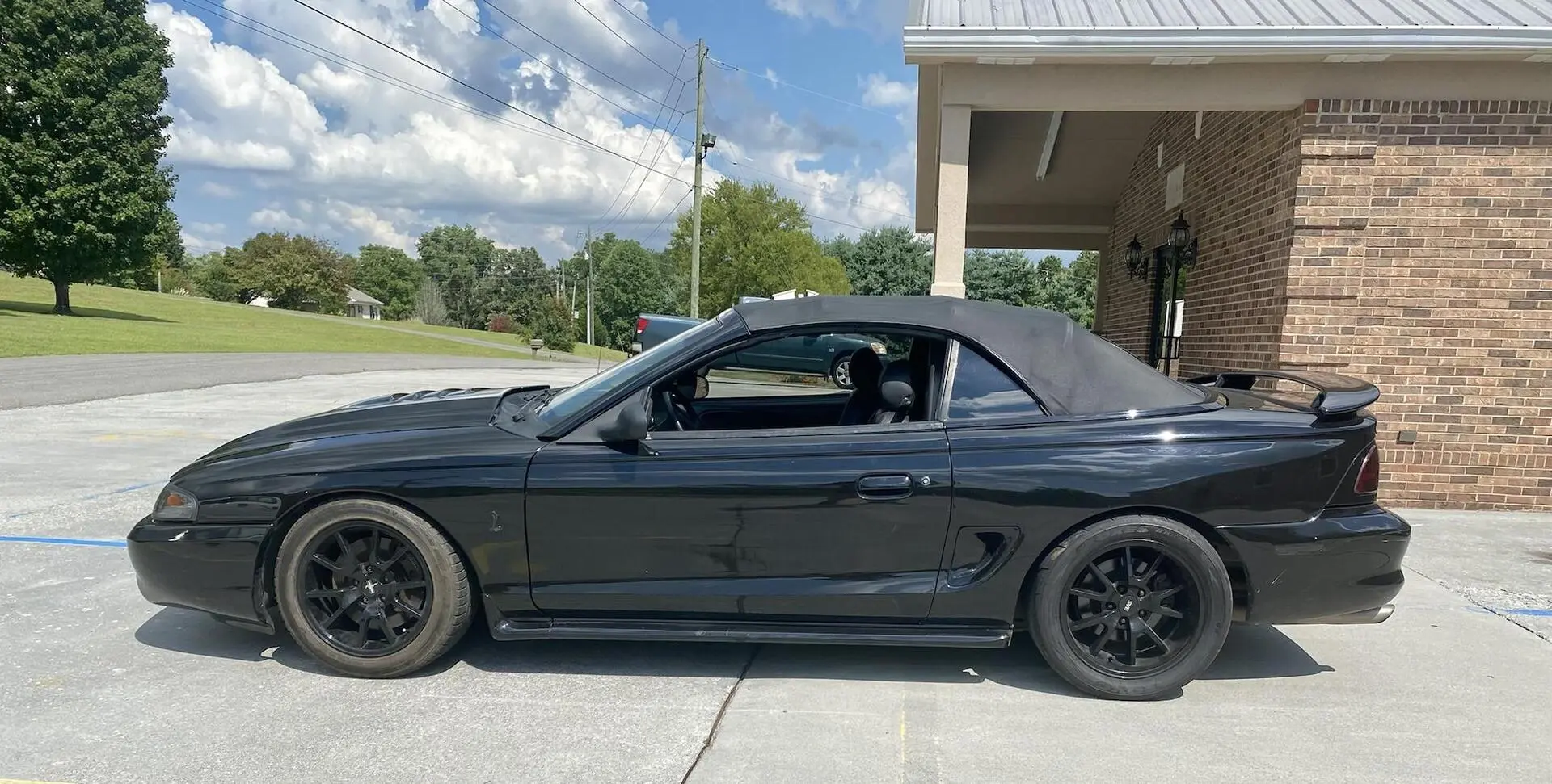

This was last week when I shipped the Cobra to Kevin, nice healthy 4.6, just needs a good cleaning, detailing, and a few new gaskets to make sure it stays nice. The car had previously been tuned at Gear Heads and showed 447/403 to the wheels, but the dumbass previous owner also wanted to "pop flames".
Anyway, car arrived safely, and I've already got my old 302/T5 setup sold and have an offer on the Cobra roller so I should make out pretty good on this drive train deal.
I am planning to buy the Holley system and a fuel system from Glenn's that should support up to 1k HP even though I never intend to go that far... it'll never be a fuel issue. Plus with the Holley it will get a full tune and not "pop flames" so we're guessing about 500ish to the wheels is the plan.

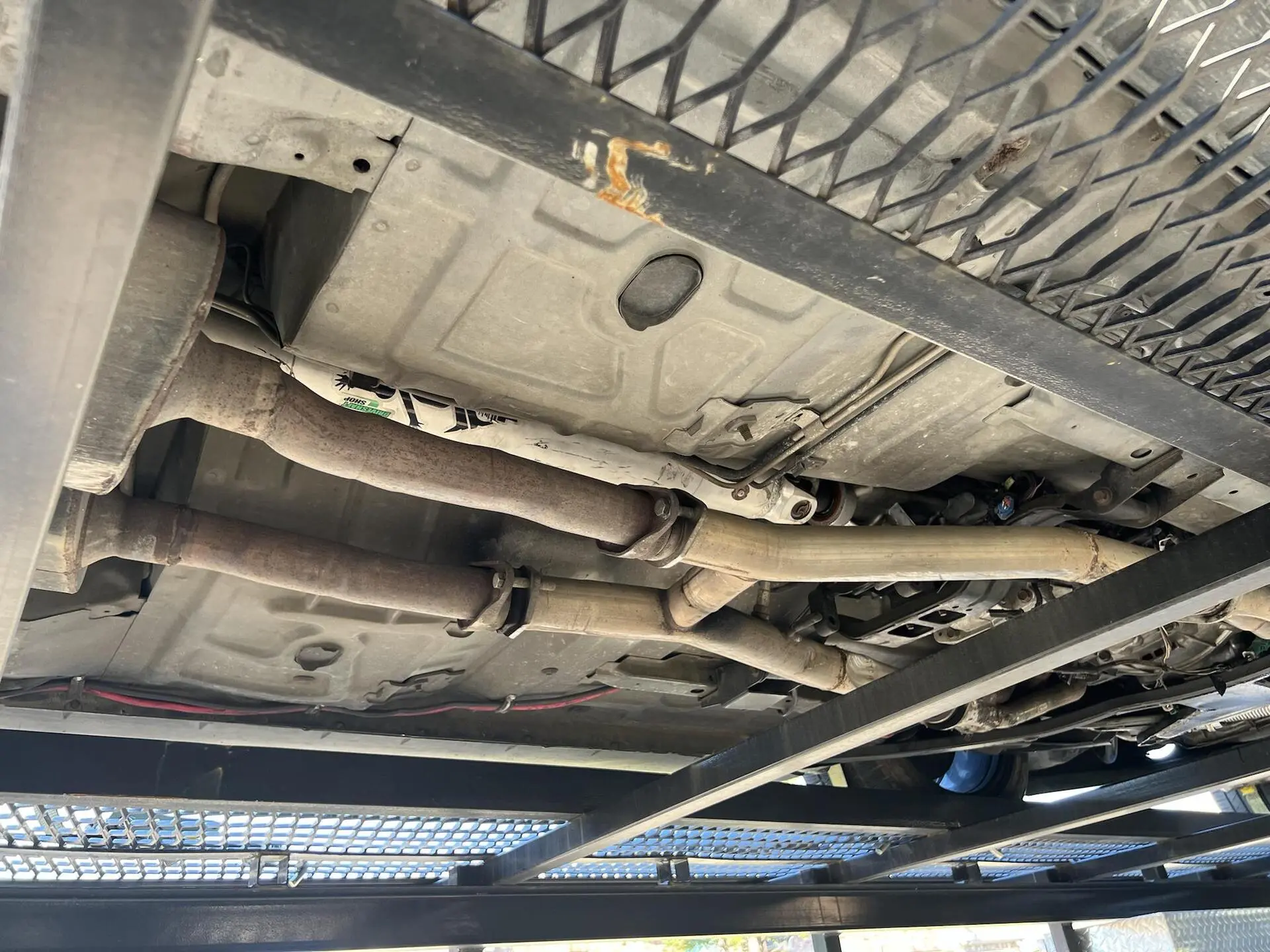

Also it's nice to see under the Cobra and notice that there's no nuts holding the exhaust together, ANYWHERE. :suicide::rolleyes:

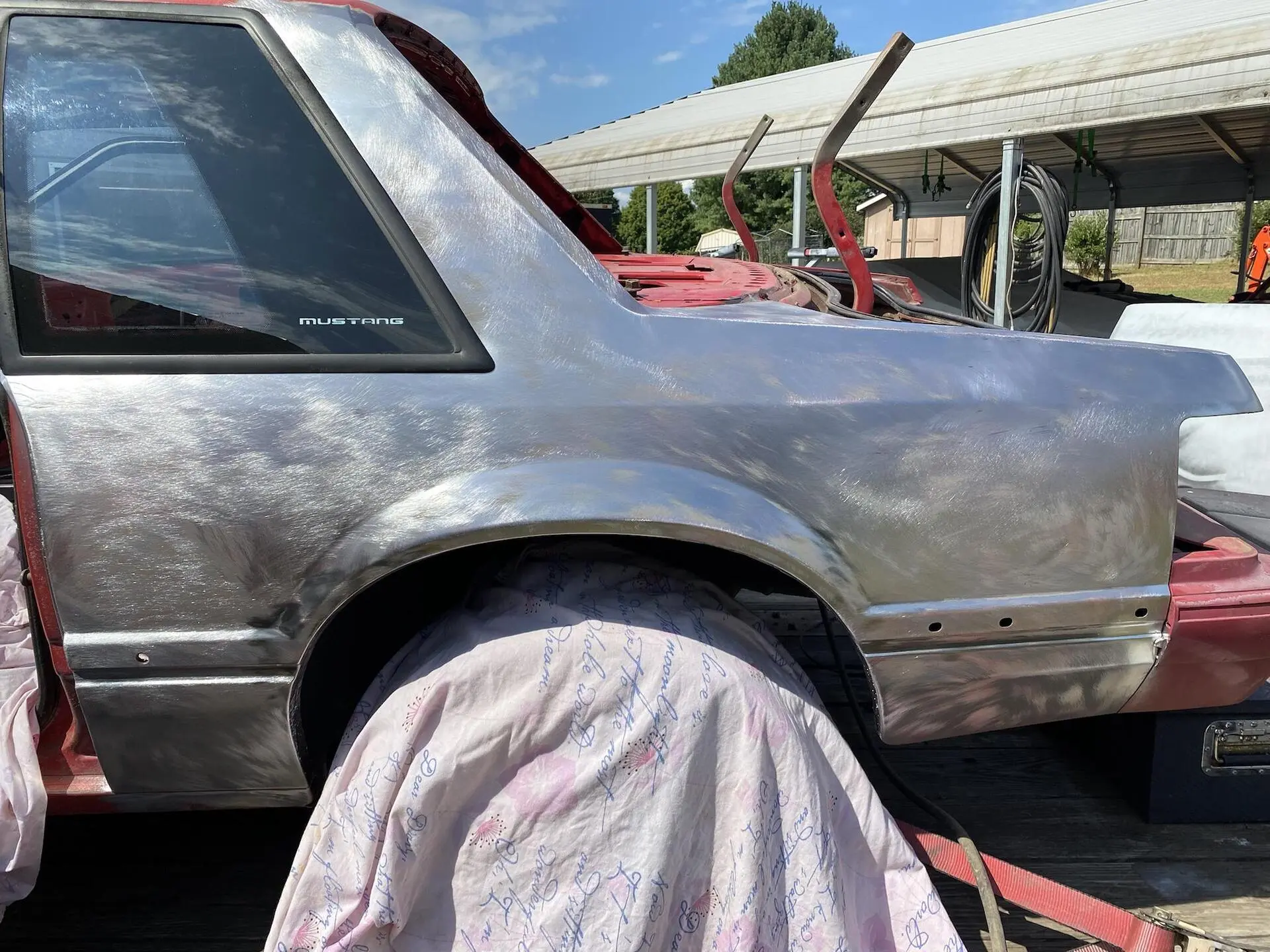

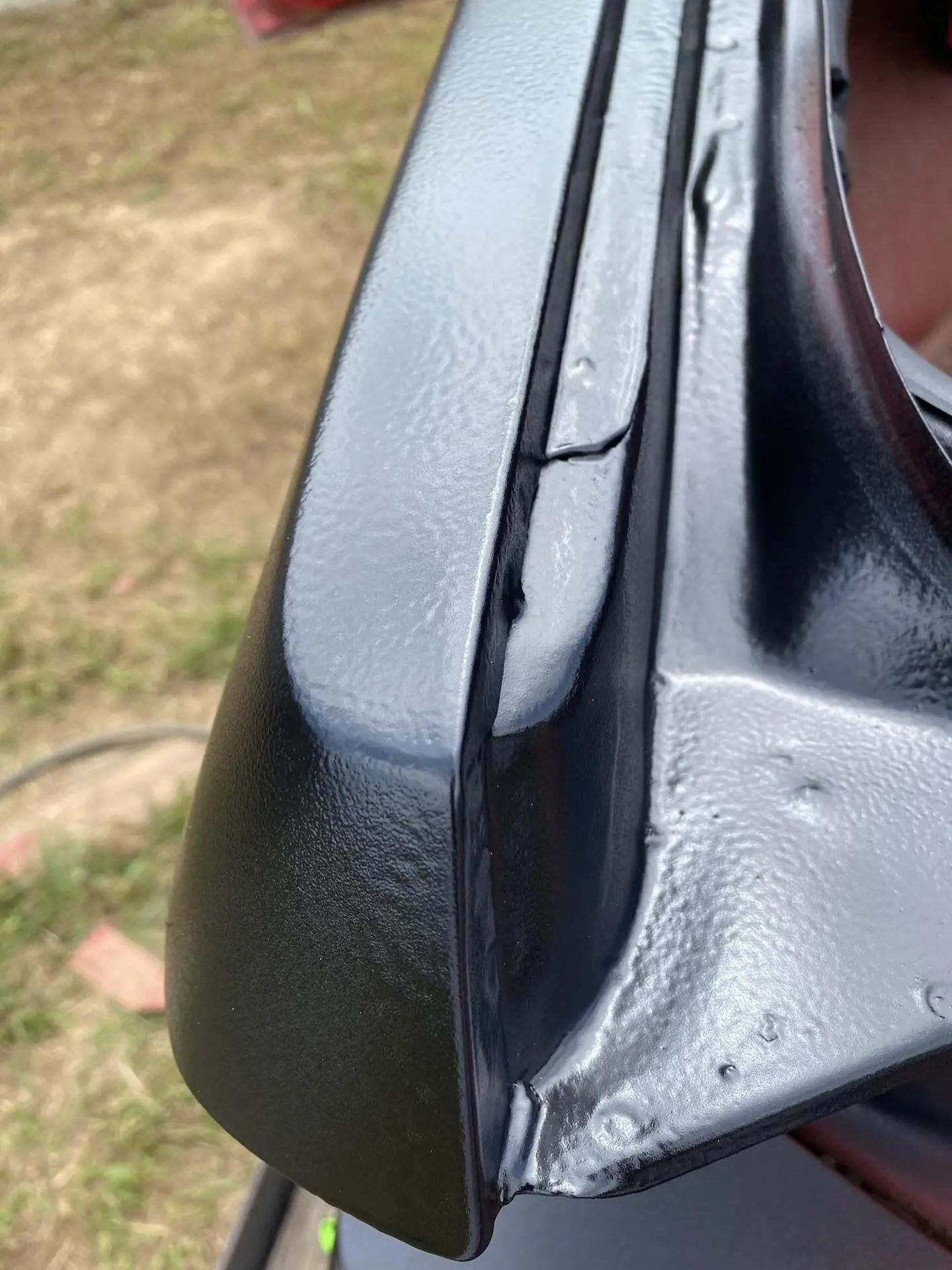

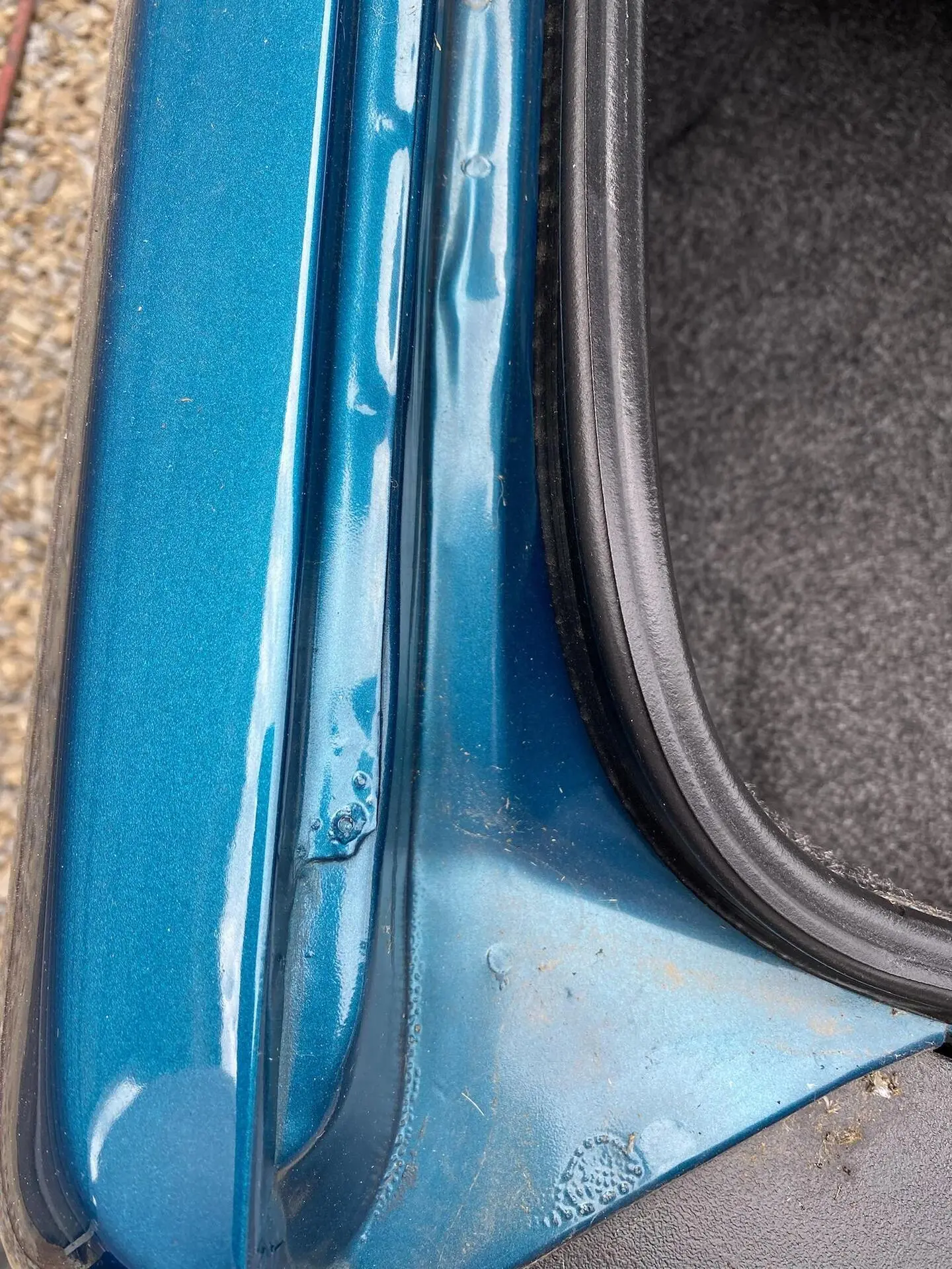

So this was a big week for my three cars I have at Kevin's... First off the 97 Cobra has a buyer, and he's not in a huge hurry so we don't have to be on a time crunch to pull the engine and he will give us a deposit. Between the prices for my 5.0 drive train and the sale price for the Cobra roller, it means I have the 4.6 DOCH, aftercooled Vortech supercharger, built T56 and accessories to put in my coupe for about $3,000 out of pocket, but I will still need to buy the Holley EFI as well as the fuel system (I don't know about or trust the fuel system in the Cobra so it will start fresh), so likely another $3500-4k for all that but that isn't bad AT ALL.
Kevin gave the Cobra one final shakedown on the Dragon to make sure we don't have to worry about anything mechanically.

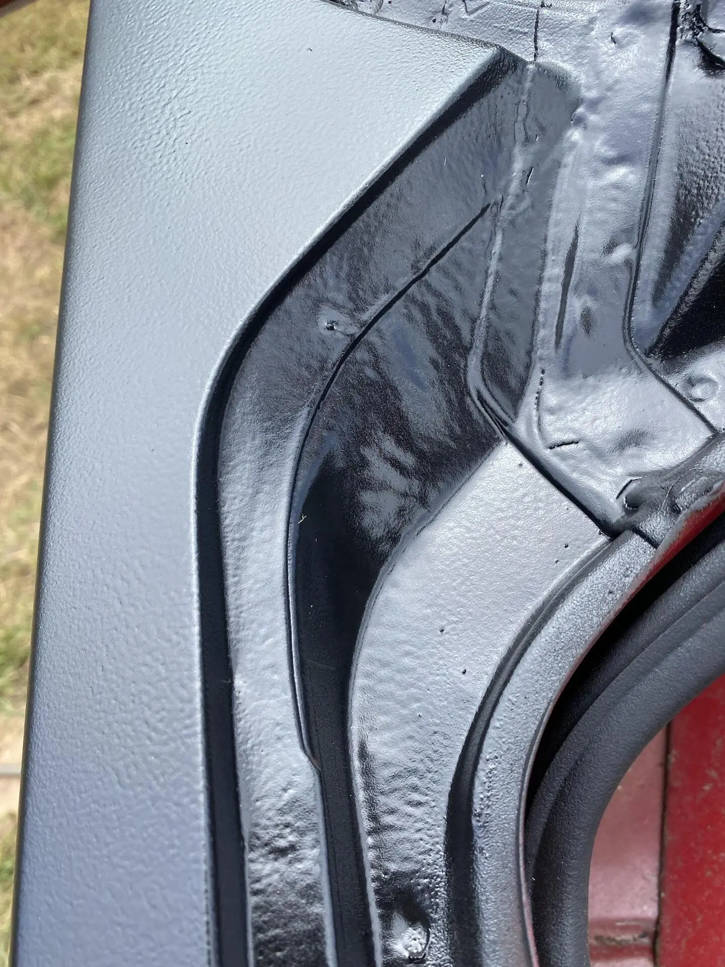

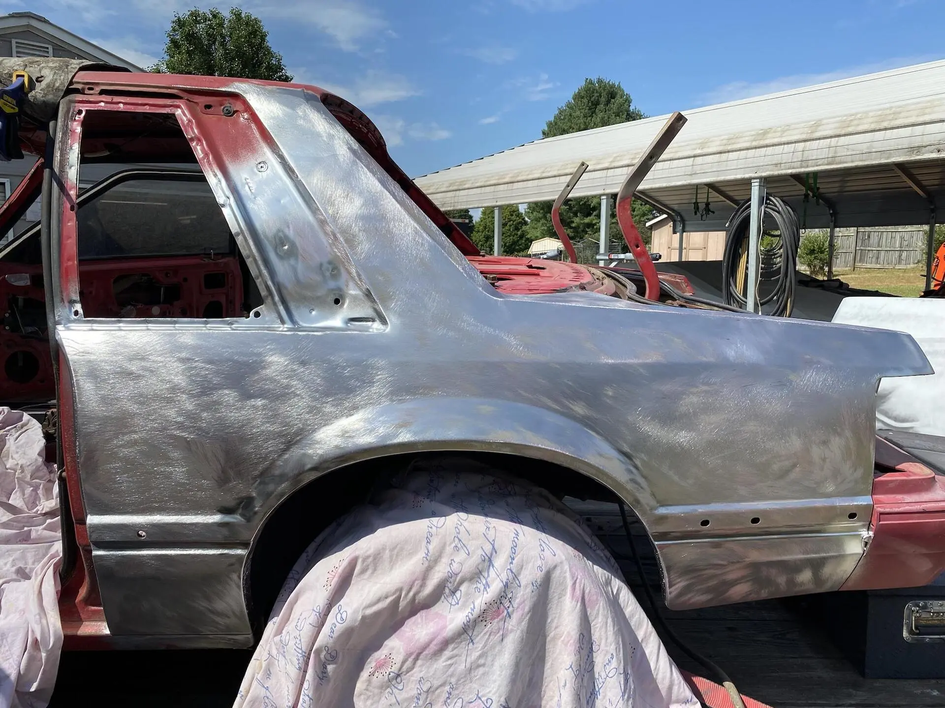

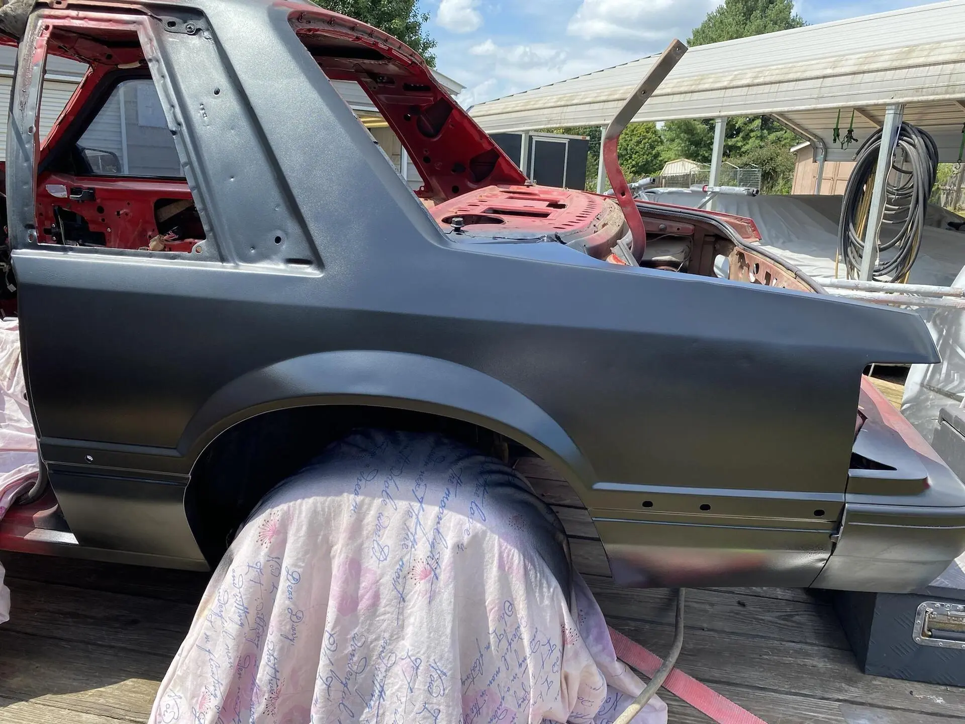

This week's plan was to get the driver's rear fender and inner structure fully installed and welded in, and have it in epoxy. As Kevin said in his text to me this morning, the best things in life need no explanation.
And here's how it compares to his reef coupe that has not been repaired. Some fantastic work here and a huge milestone for the car.

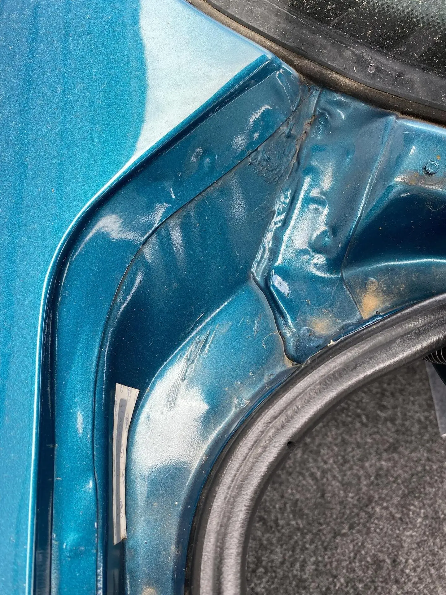

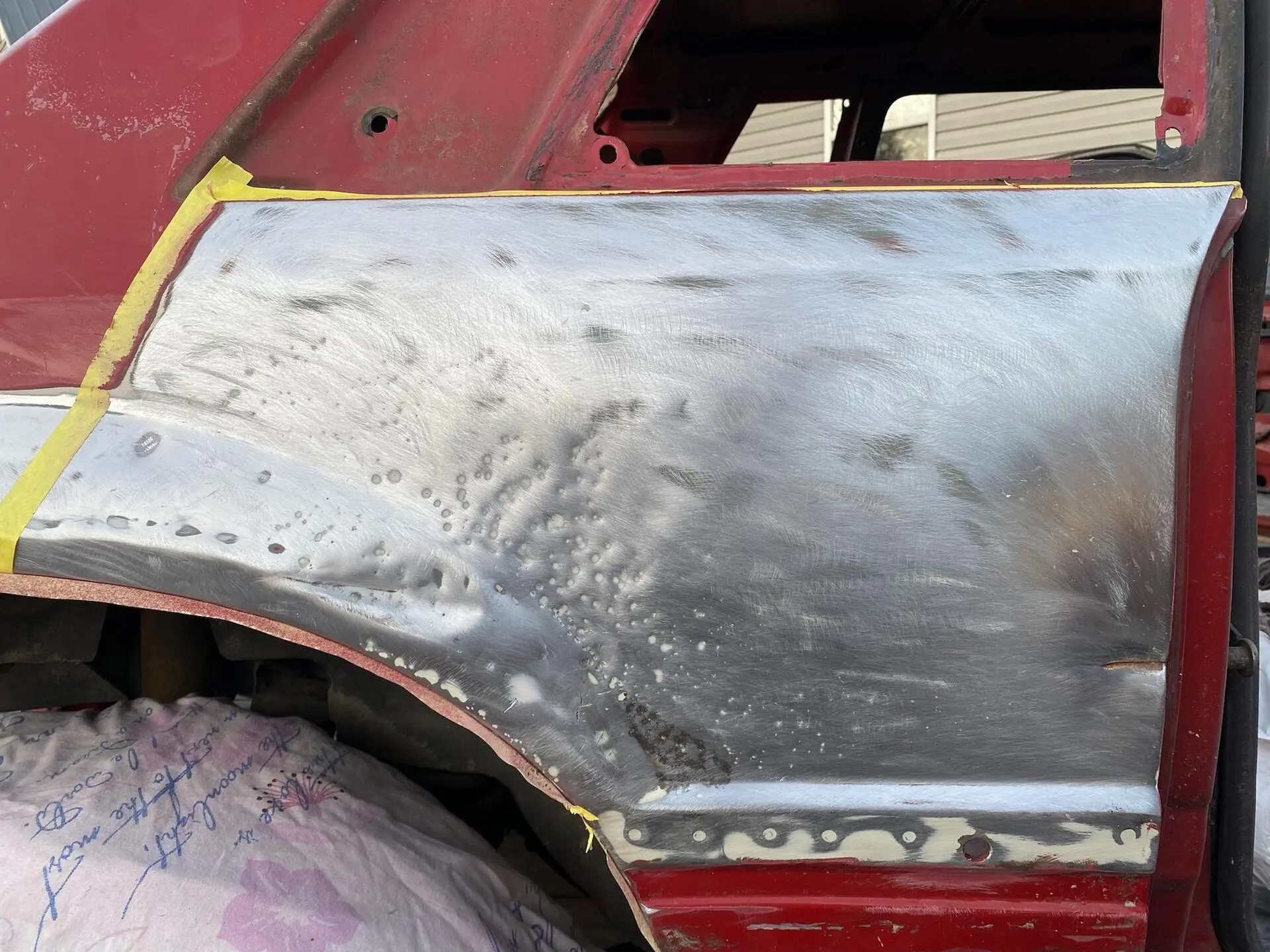

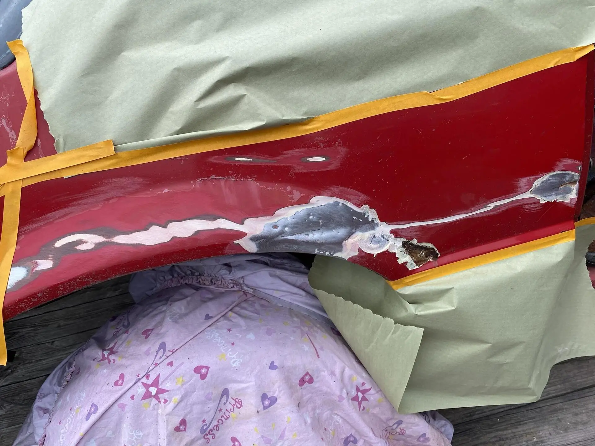

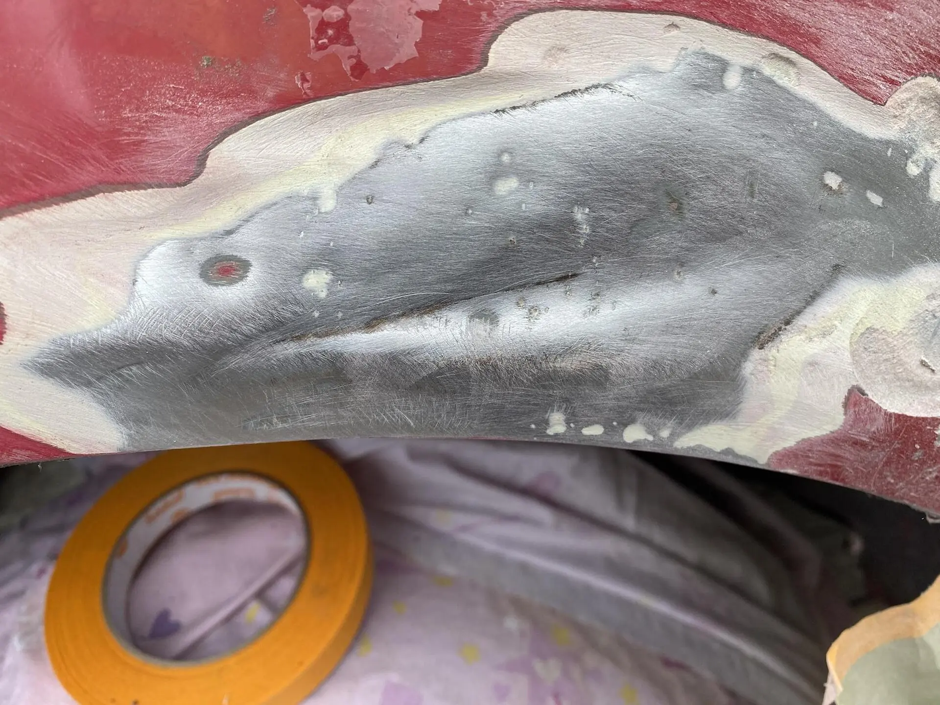

Unfortunately, the passenger side rear fender which we *thought* was good and straight... well, ummm, let's just say it belongs on this car and isn't surprising. It too will be getting replaced, luckily we have the other from the donor car, but we don't expect anything more than a reskin as the inner structure seems to be ok, at least we think so at the moment.
