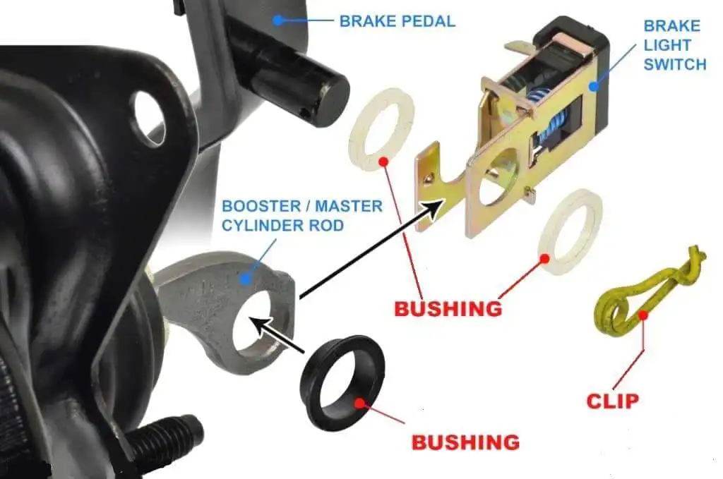

Can anyone help to find a diagram or video on how the assembly looks for the brake switch on a 1989 mustang. I bought the plastic washers the were missing and now I'm not sure how to put everything together I didn't take it apart. origenaly brake lights would come on when pedal was engaged. I found out it was missing a few parts and I'm not sure how everything should look once it's put together.
