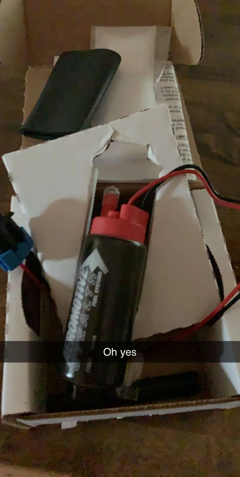

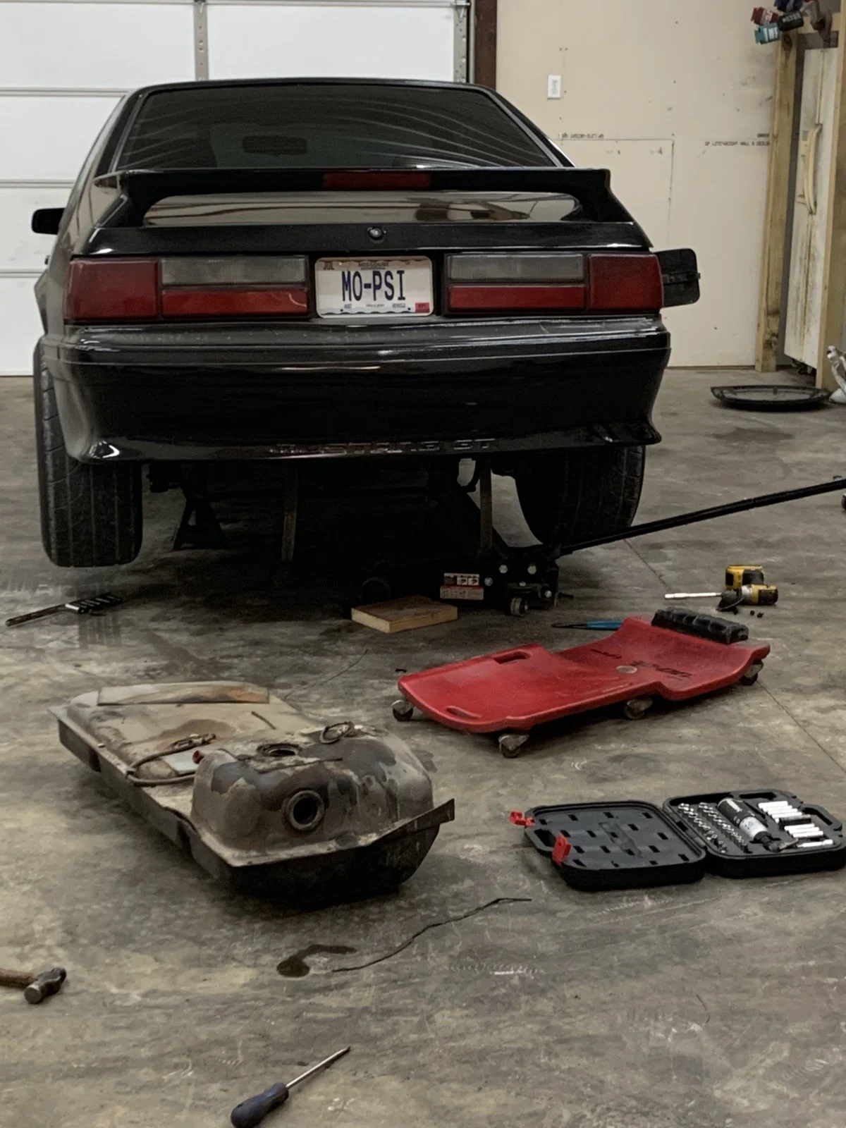

ok.... ill try a pump first. at full boost t should go to 45 i would think since there wouldnt be any vac.
i was reading through my manual last night trying to remember if i could only use low or high impedance injectors on the microsquirt
Anti_Hero0932
5 Year Member
Jan 29, 2012
406
180
63
29
LaGrange, MO
alright sweet. so if need be i can use the ford racing 60s or something if it ends up being the more expensive problem. id just have to buy a harness adapter

I hope this addresses the fuel psi issue that you were having. Then you should be getting some more bandwidth out of those injectors.

ME TOO!! time will tell i didnt get it done till 10:30 last night. i had a bunch of stuff to do after work.
ill try and drive it maybe tonight and see what it does.
