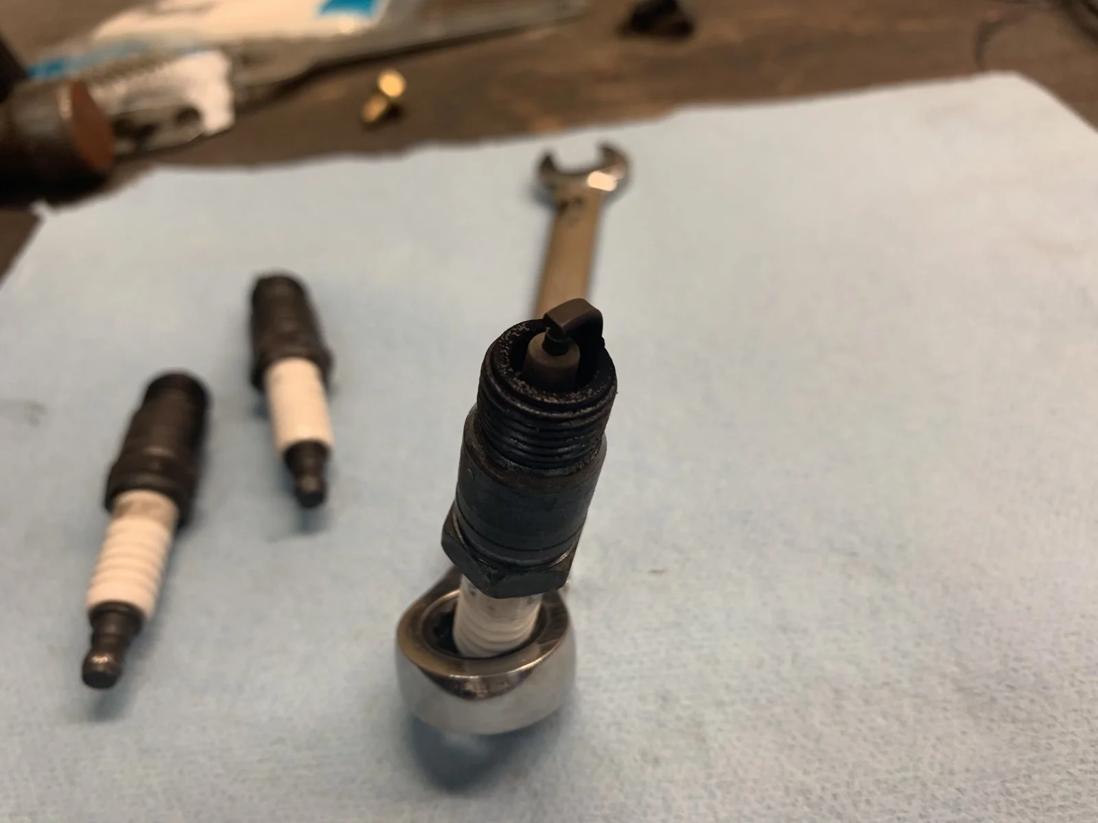

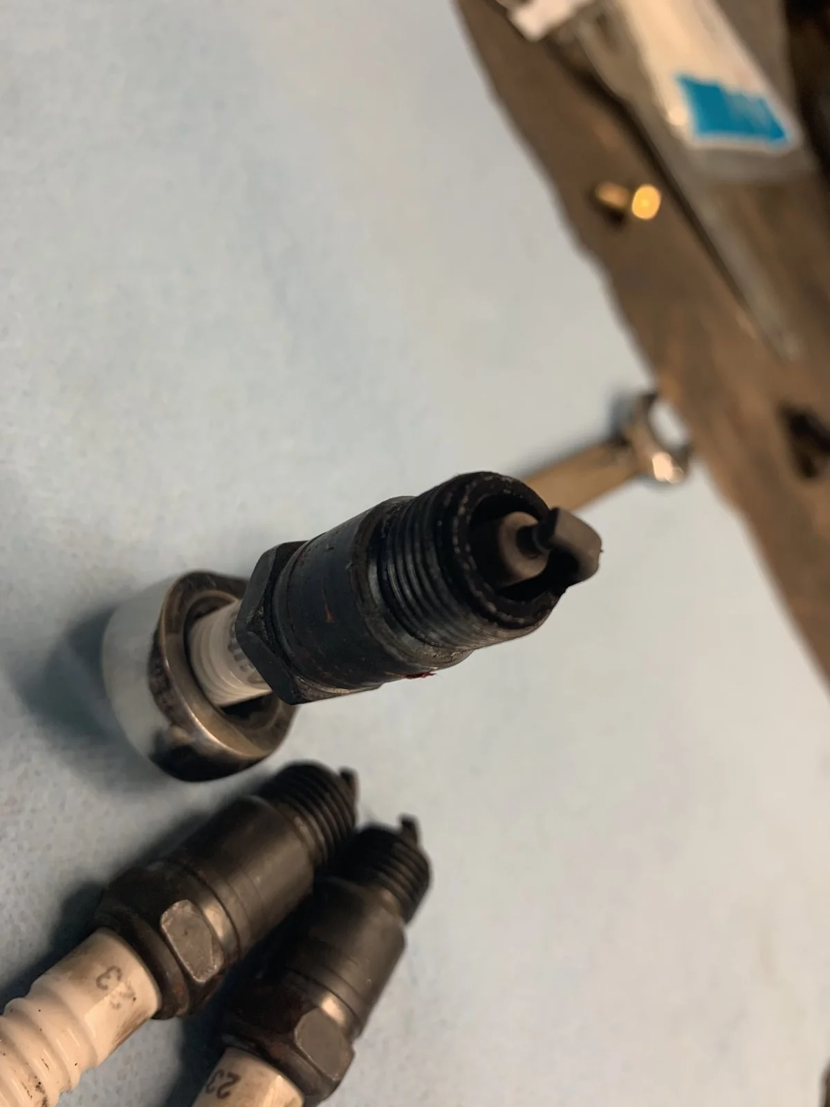

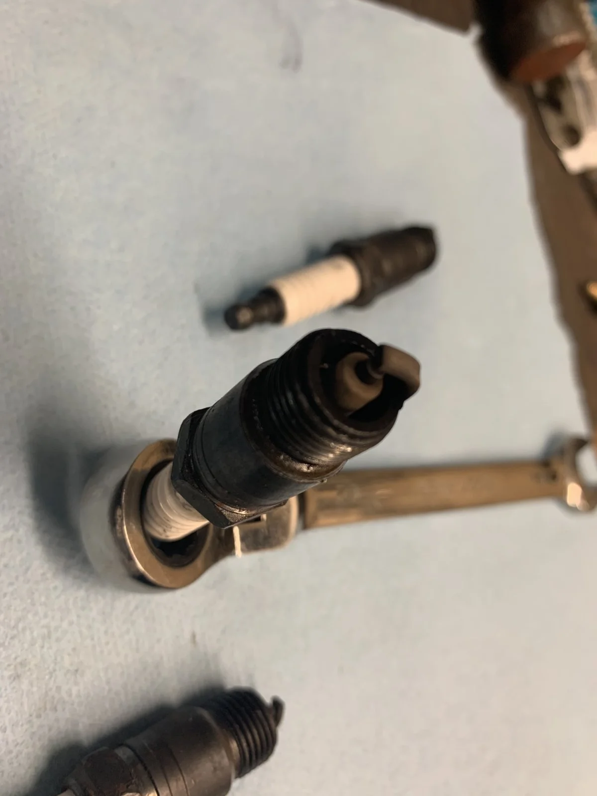

Looks to me like you have some kind of missfire at 4800... likely where you are making peak cylinder pressure at around 11psi. your timing is up around 23* she is making great power and the injector duty cycle is around 80%
Pull a couple of plugs and post pictures of them for me, if they dont have any signs of detonation we may need to look into getting a hotter spark to the plug. If we do show any signs of detonation, [small specks on the plug] we will want to go to a cooler plug or pull a few degrees of timing.

ok will do that tonight. its like a miss almost so you could be right. i did put a pretty cold plug in it to begin with.
also when im getting on it and let off the gas almost everytime it wants to die unless i rev it up and clean it out. not a real big deal to me. i just want to get this miss figured out i know it will run damn good once its fixed.

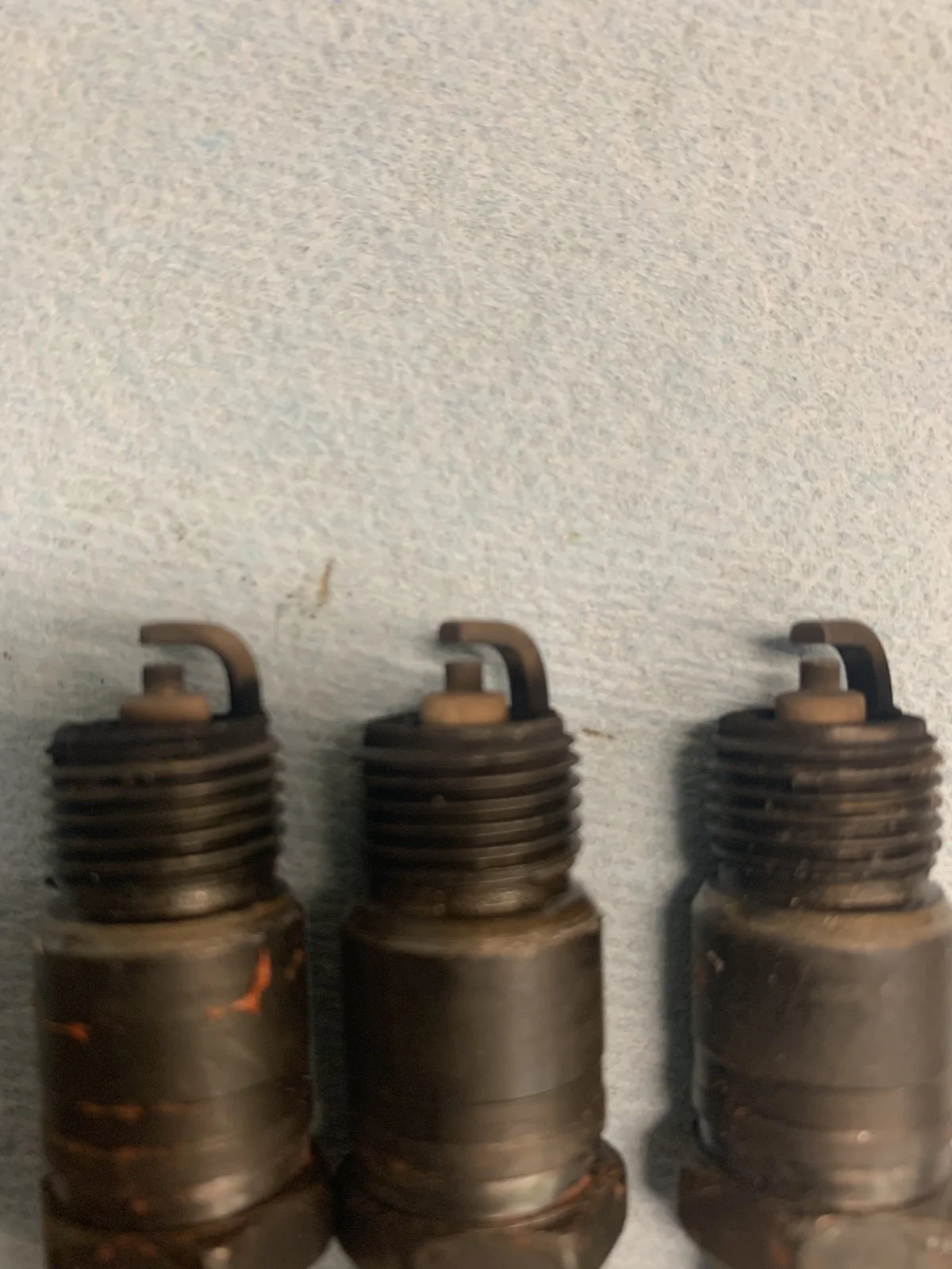

In short yes they could be. The plugs tell me that the car is burning a small amount of oil and is a tad rich at cruise. Fat under boost (we want that)... the porcelain should not be pitted or rough but it should also not look glazed.
Plugs tell me misfires but I cant see specks of silver in the porcelain. Silver or shiny specks are usually detonation.

got the plugs changed. gotta get some time to mess with the tune and now its raining.... i did notice the plugs had a pretty big gap in them to (the old one) i gapped the new ones at .30

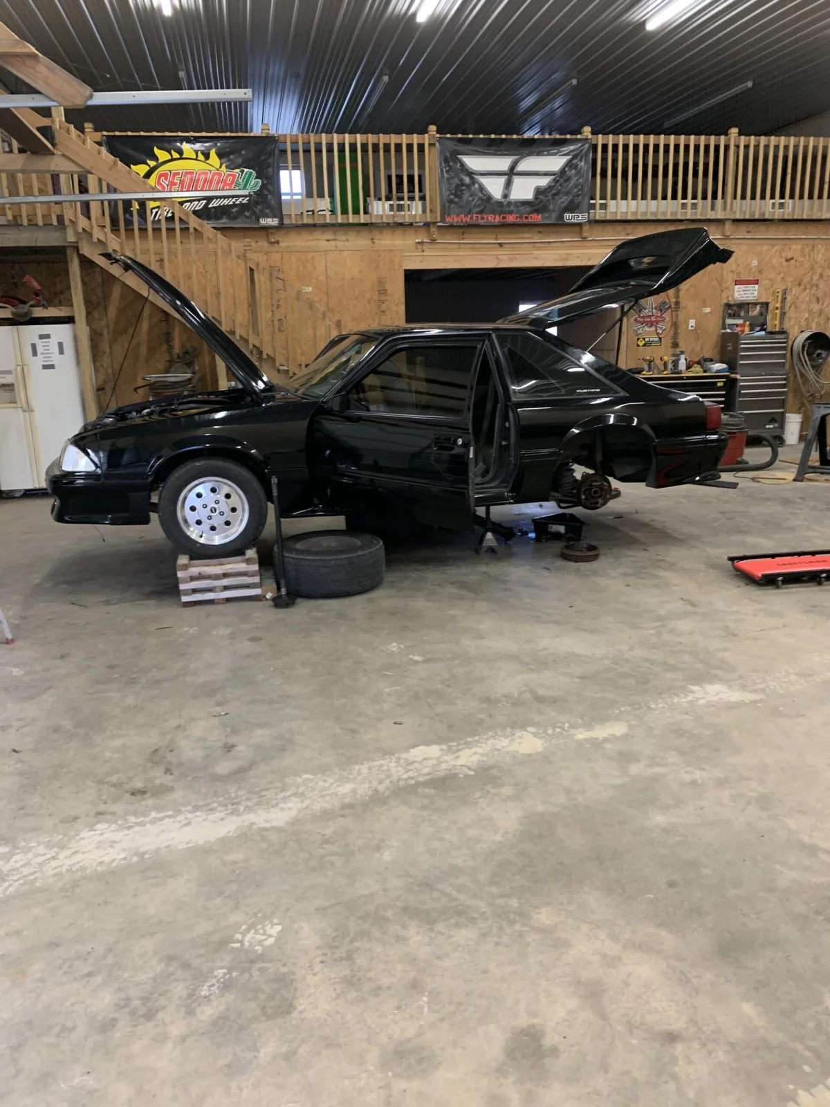

Getting someinterior work done. My driver side seat belt won’t retract anymore, the passenger side works half the time. Changing the gear out for a 3.55. Also putting some plywood in the hatch where the spare tire cover was. It’s a half moon shape now so wanting that to look a little nicer too
