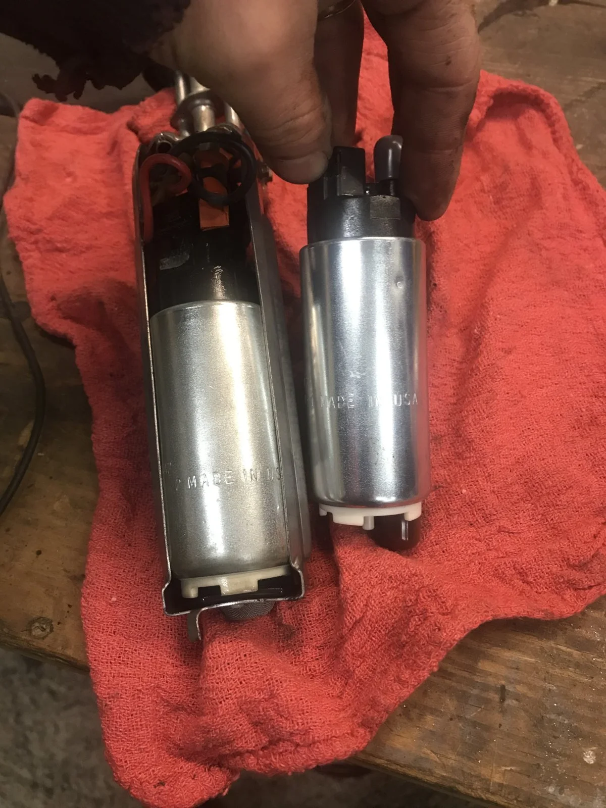

Yup....separate those fans. Two relays....two 12v power wires and fuses...two grounds....split ground trigger to ms and you should be good to go.

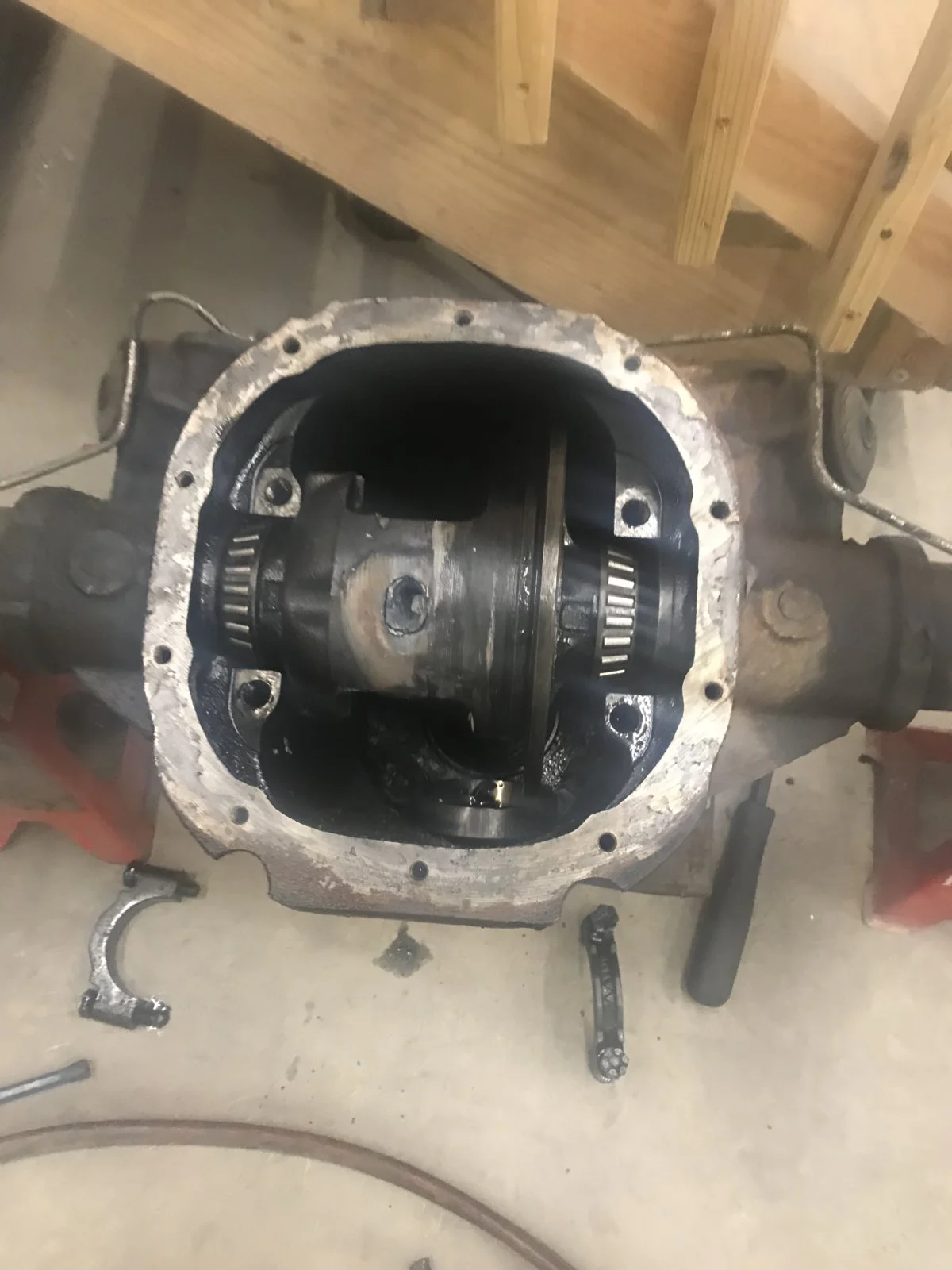

Well that sucks! If you have a small magnet the pin may come out, you can try tapping that shaft on each end to loosen it up just don't hammer it hard.

I tried everything. I took it out of the car. Just gonna go buy a factory drop out and put it back in I think. I just ordered Tubular control arms too. Figured now would be the time to do it I’m already there

The 8mm screw in pin broke. You'd have to drill that thing to get it out. Really small metal bit and a screw extractor. It's a pain in the rear.

It broke and the pin was twisted the it actually bent the 8mm bolt as well. It’s pretty well toast now that I’ve beat on it. I think I found another one tho so we are good. Just needs to stop snowing so I can go get it
