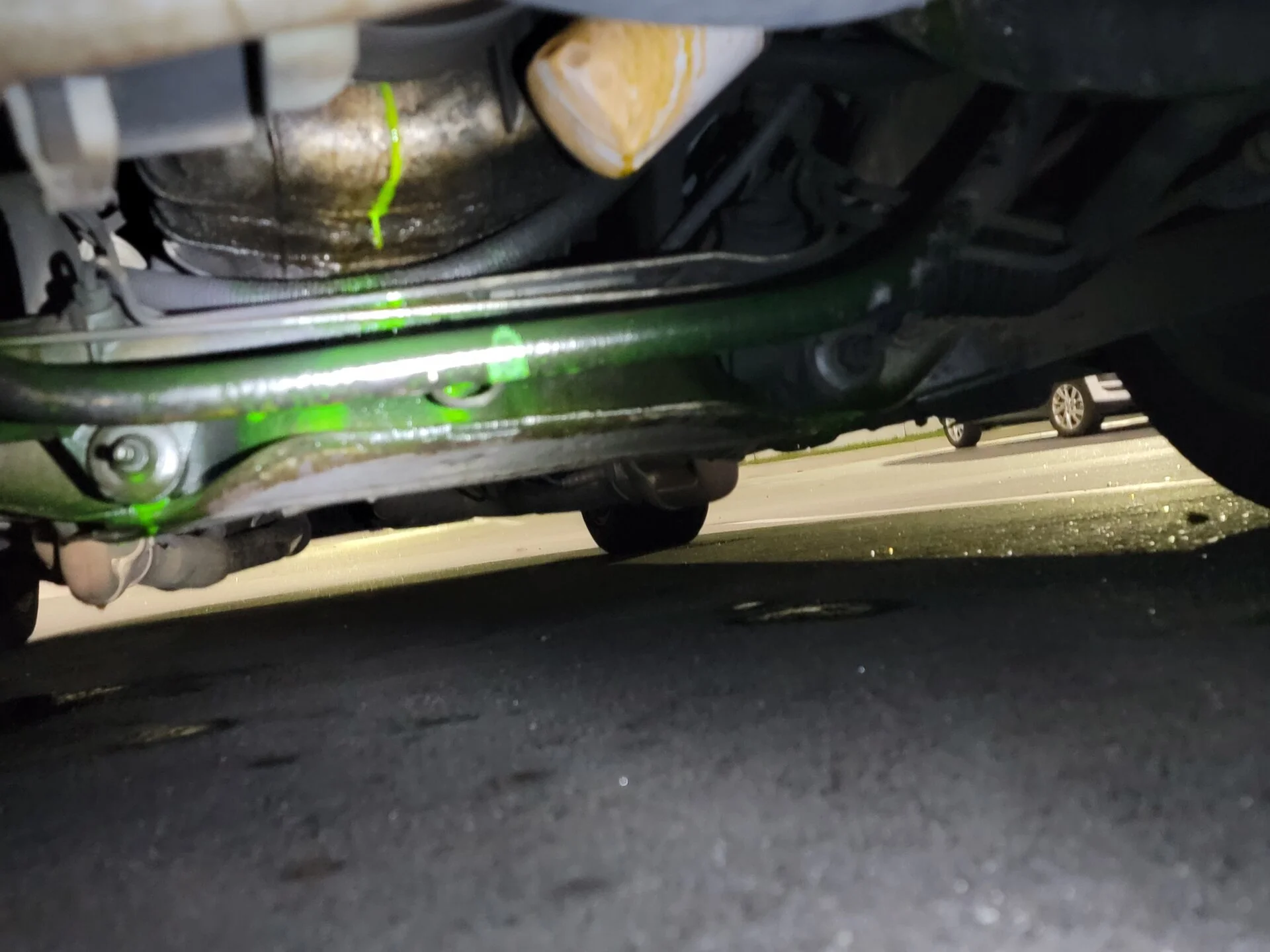

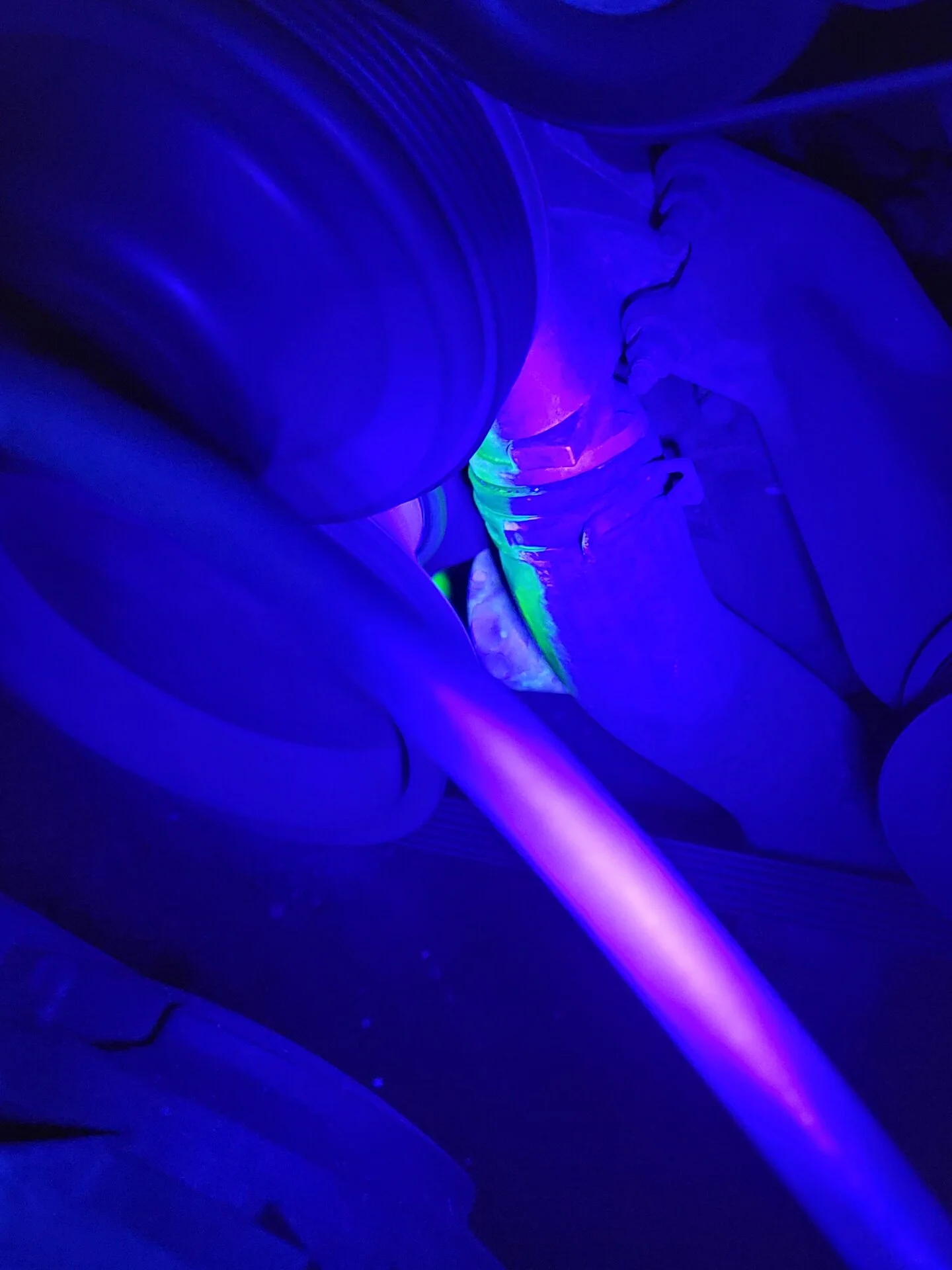

Alright. So after a day or so of driving. This is what I have. It looks like the water pump has a leak at the seal there. But would that cause all the issues I seem to be having?

Leaking water pump does not cause idling issues and does not "burn oil."
The 2 major engine tests that were suggested really will put an end to all your questions.
For example if the engine has excessive wear, then putting money into a new water pump doesn't make any sense.
Yeah I know it is time consuming.

The water pump is leaking so pressure could be escaping through there, IF it really is a blown head gasket. Does it overheat? Is it able to drive 100 miles without overheating? Obviously it will fail the coolant system pressure test.
This really is an "educated guess" based on the info you have provided, more information is needed, so I stand by my previous post about doing the 2 major engine tests.
