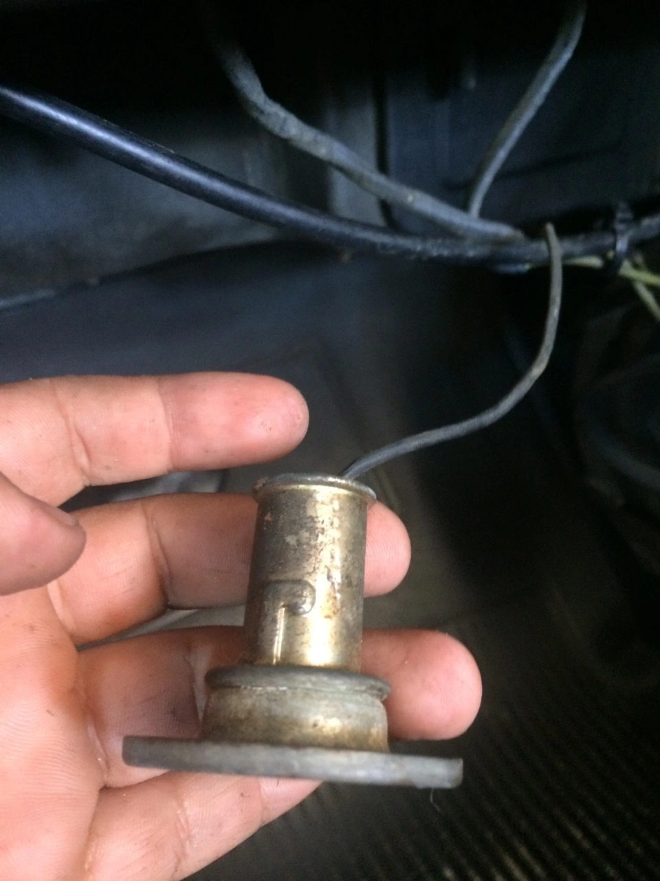

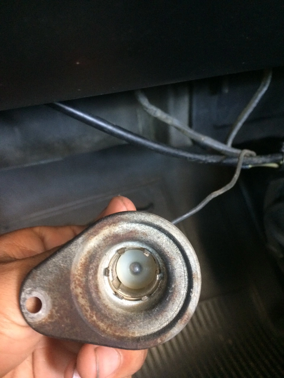

That light socket is just pushed into that mount ,pull it out and glass bead ,wire wheel or sand the bracket and paint them dull silver and they will look like new . If you look under the bottom of the dash you will see where they were bolted
