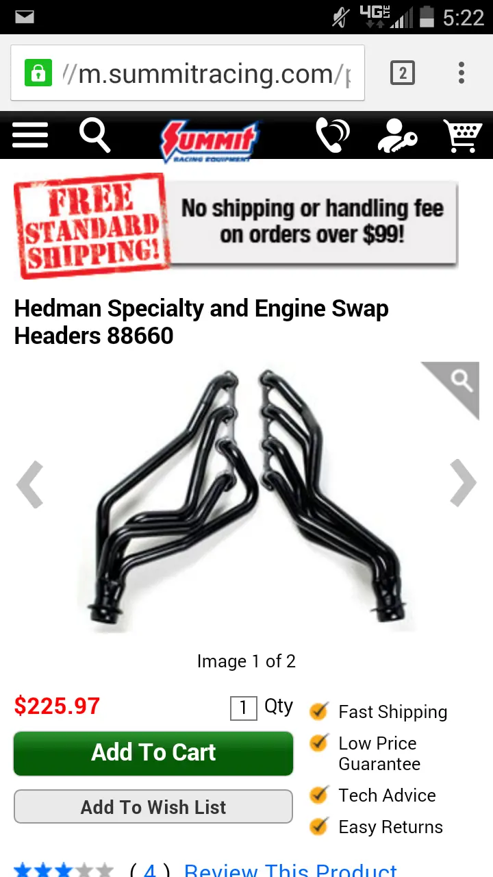

The headers can be a PITA. The bottom of the firewall needs to be clearance with a BFH sometimes. Tubes have to be messaged a little sometimes. Make sure you have a good starter when you put the on.
Its crazy- the swap kit has gone up to 1k. I'm not sure what accesorie brackets you'll need...if no one answered that question already.
