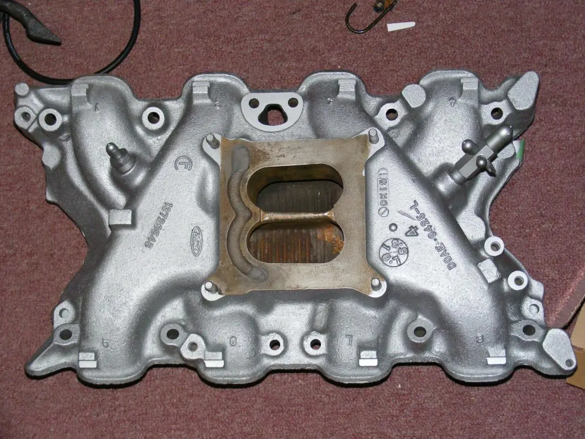

Well I'm keeping the stock heads {4v closed chamber}but they have some machine work to do for the roller rockers on them.I ported them myself.I am keeping my stock intake also but had a friend of mine did a little customizing for me {view picture}. They will balance the engine and install my new cam kit {comp cams extreme energy}.here are the specs for the cam

I was told I would get over 400HP but we'll see.I have a Quick fuel q series 750 cfm carb going on there and a petronix ignition system.Hooker competition ceramic coated headers and flow master 40 series to complete the exhaust.I plan on getting AFD heads eventually with an air gap intake.But this is my first {real car hahahaa} so I want to do this in steps and see the progression of improvements and power.It's also easier on the budget.I also have drum brakes on all 4 wheels so I don't want to much power until I do the conversion to disks up front hahaha. So I guess it's a mild build but ready to receive more power. Here is the pic of my intake
