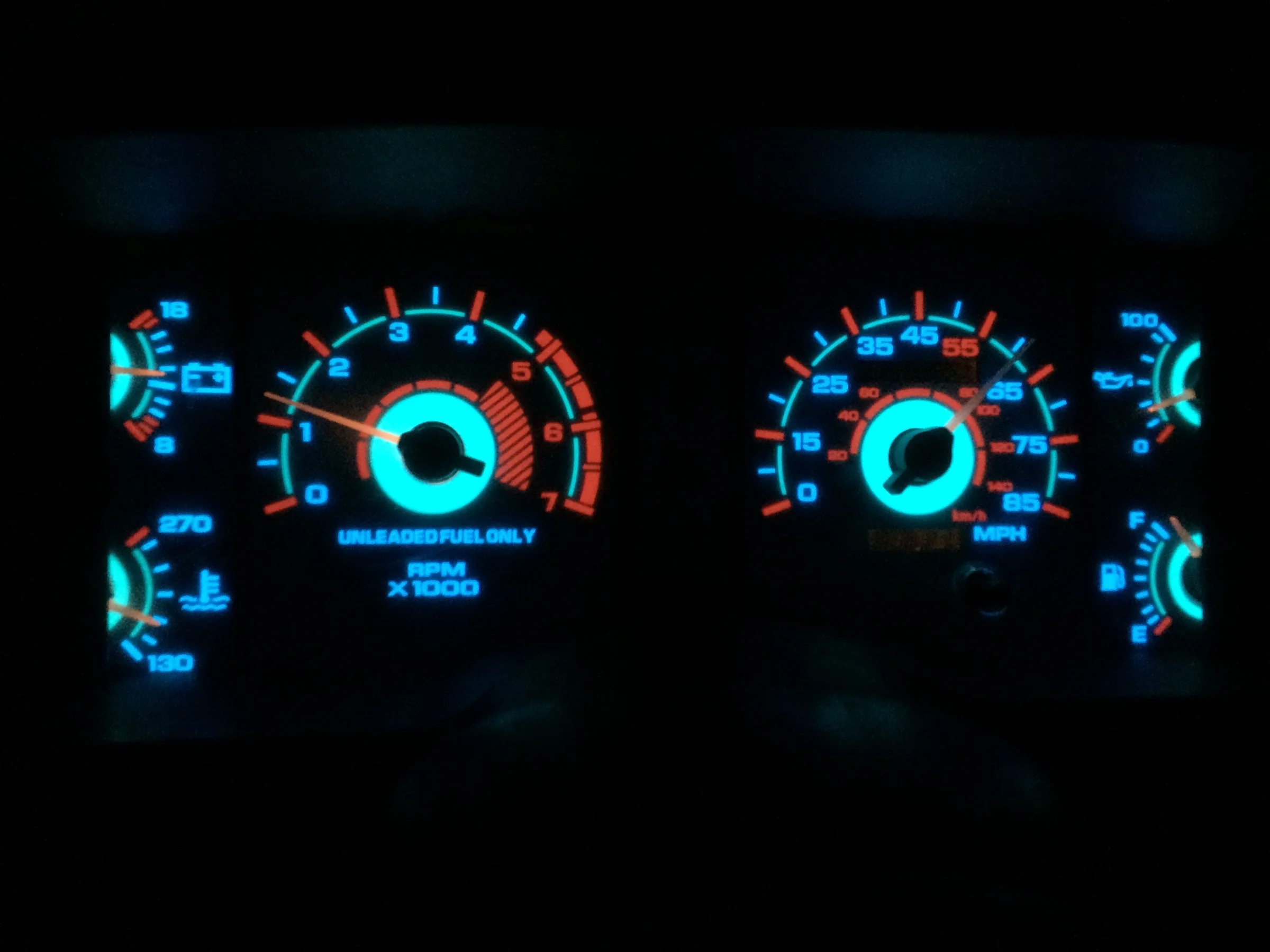

DOH! lol Regarding the thermostat, 160 is too cool. I'm running a 180, but some suggest running the stock 195. My engine is on the A of NORMAL of the stock temp gauge most of the time. When the car is in heavy stop and go traffic for a good while during the summer, it reaches the middle of the gauge at the M.
