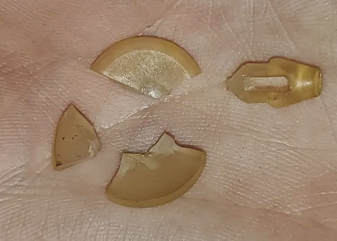

Hey guys, there is small clip/bumper between brake pedal and sensor that activates the brake lights when the brake pedal is depressed... so that clip/bumper got broken and fell off... now break lights are constantly on... any idea what is the part number for that clip and where I can buy it?

Call the dealer parts department. If its a clip it'll be really cheap.

I called ford dealer... dude on the phone suggested replace the whole pedal... do you know the part number for that clip?

Junkyard near me doesn't have any mustangs...
Ford dealership doesn't sell this clip/bumper at all... it is one funny place... the only solution they offered is to pay a few hundred bucks to replace the whole brake pedal...
I found a generic set of clip/bumper at Autozone... none of them fit... so I cut one of them with scissors till it fitted in...
